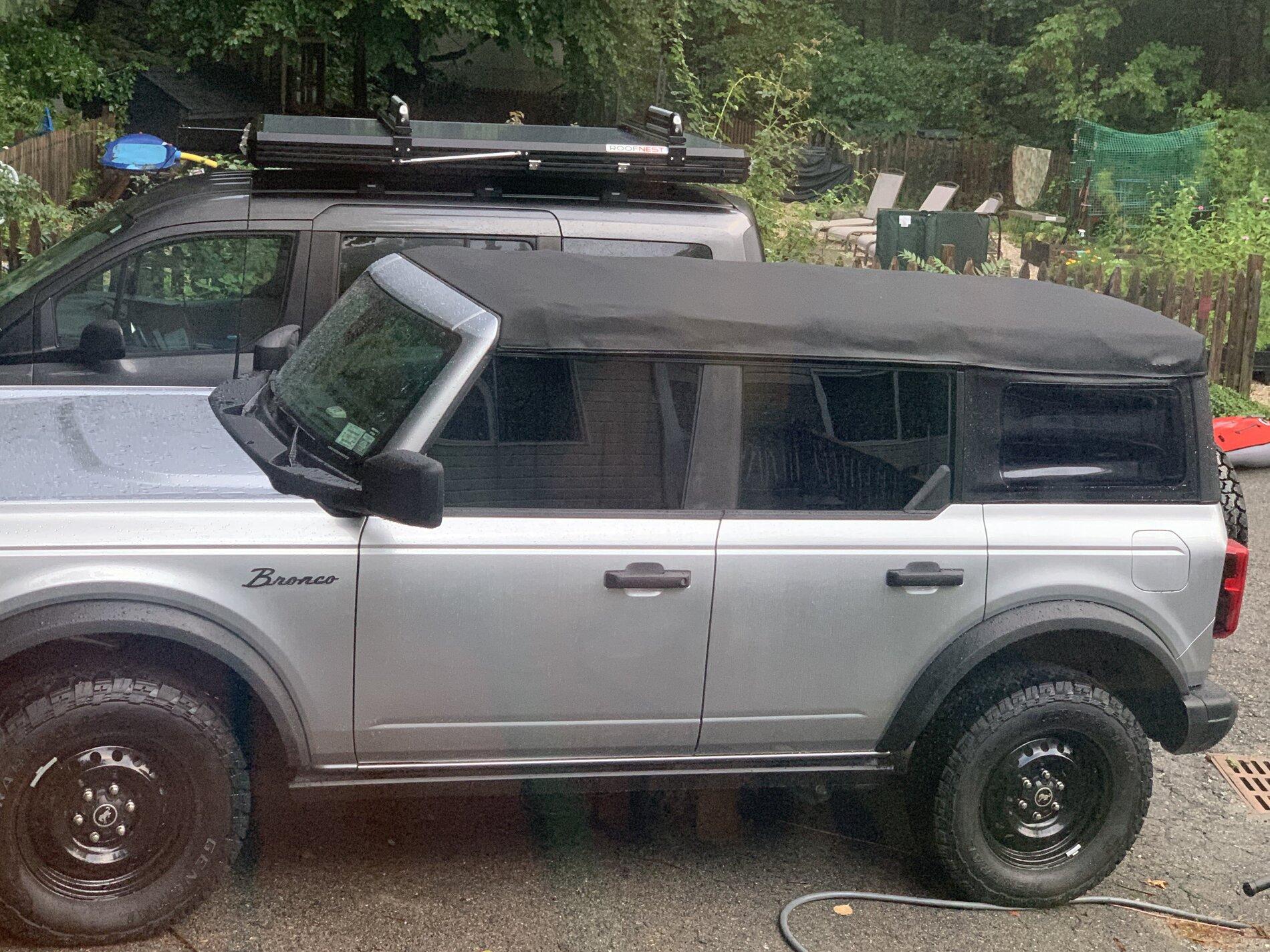

Has anyone here used a ceramic coating or something similar? Never have had soft tops before, and is there any tint you can put on vinyl? I live in Phoenix, Az and heat here is brutal
I’m getting an XPEL ceramic coat next week. I’ll report back. Right now it looks like a wet sock in the rain.
Damn that is some TINT!! Did the soft top window come that way, or did you have something done to it to get it that dark? Did you also tint the rear door windows?
Only tint I added was to the front (also xpel) to match the rest.

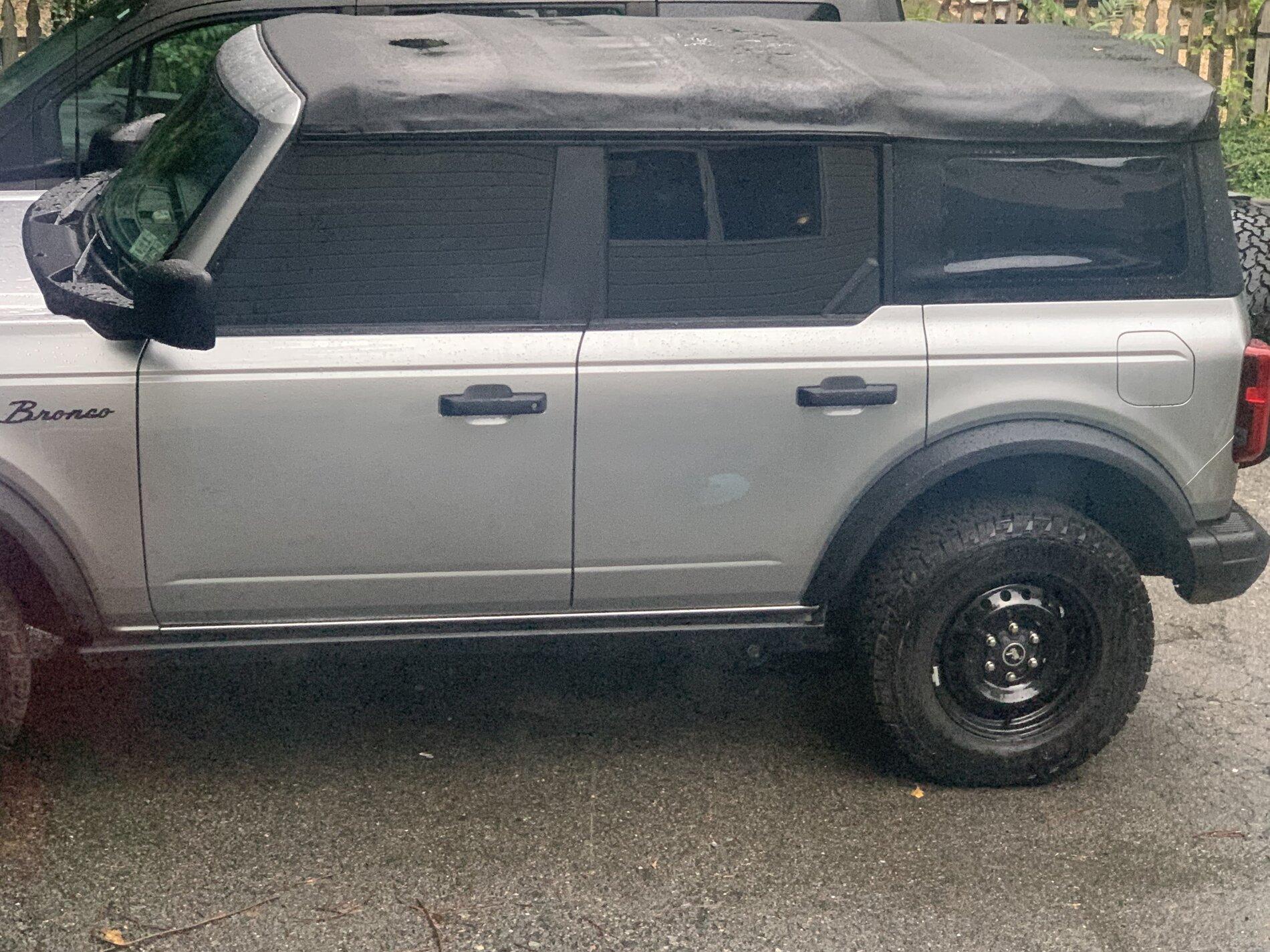

I’m considering a carport. Just out of ease of keeping snow off of it and protecting it from the elements. But, I don’t think it’s necessary. Just don’t use a scraper on the plastic windows.
So, the top no longer looks like a wet sock in the rain. I’ll report back with the product used by the detailer. He did an amazing job on the ceramic. The product for the top wasn’t XPEL as I originally thought. 12 month applications. I’ll likely do it myself moving forward. He’s sending me a list of chemicals that I can DIY.
This is after hours and hours of downpour.
I'd love to know the products you use. I officially switched so hopefully that helps my timeline.
That's quite the improvement over your wet noodle picture earlier! Looks good!
