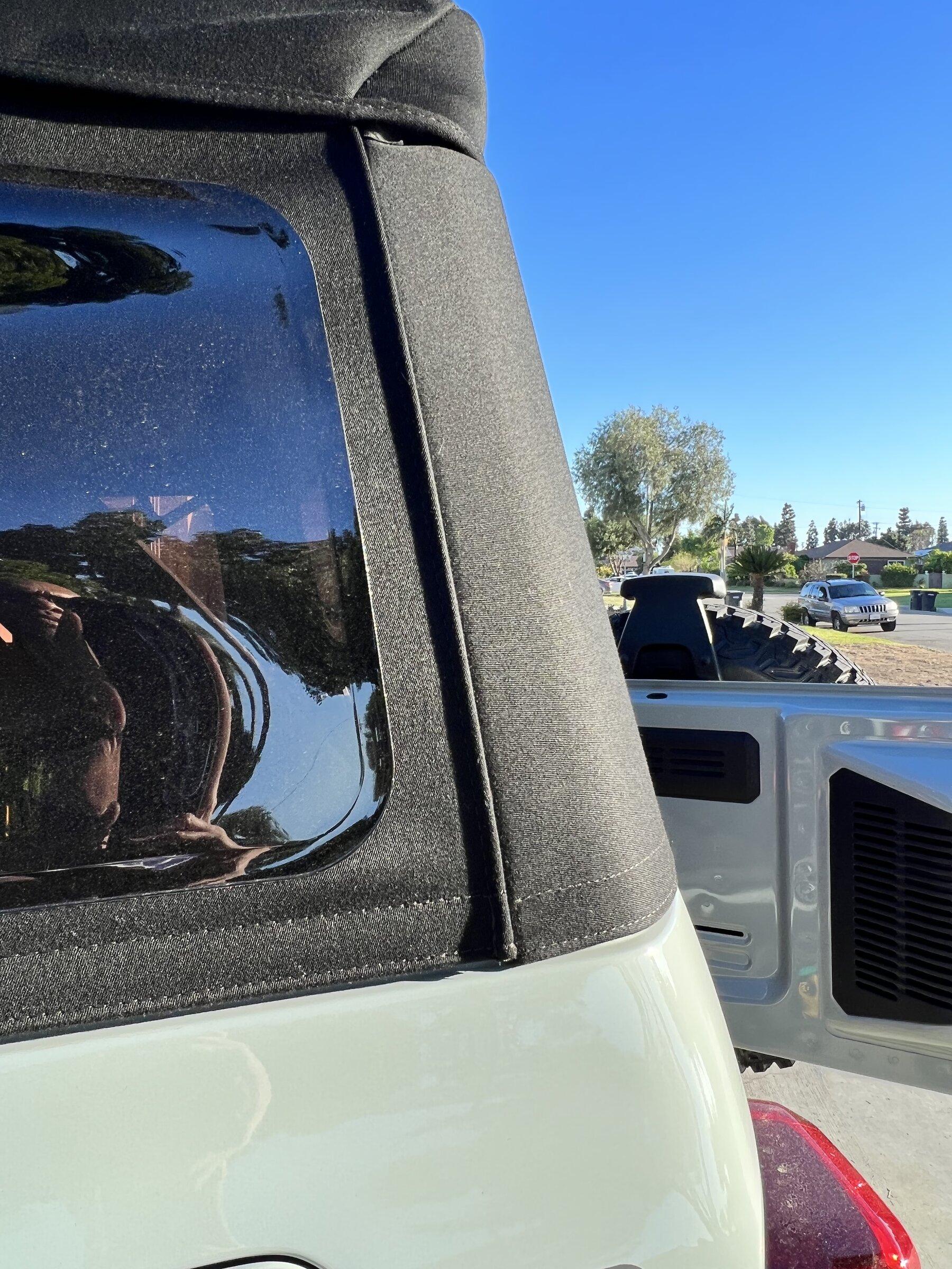

So I took mine to a upholstery shop and it cost me $25 but it’s full functional and way stronger than factory clips.
Ford Bronco Soft top broken tabs B2EBD4B5-B0F3-4EC5-946C-6703B899E25C
Ford Bronco Soft top broken tabs E4774719-4FCC-4BBC-A9C9-62484F5B5174
This looks really great and really secure! Looks like a much better fastener than the original solution

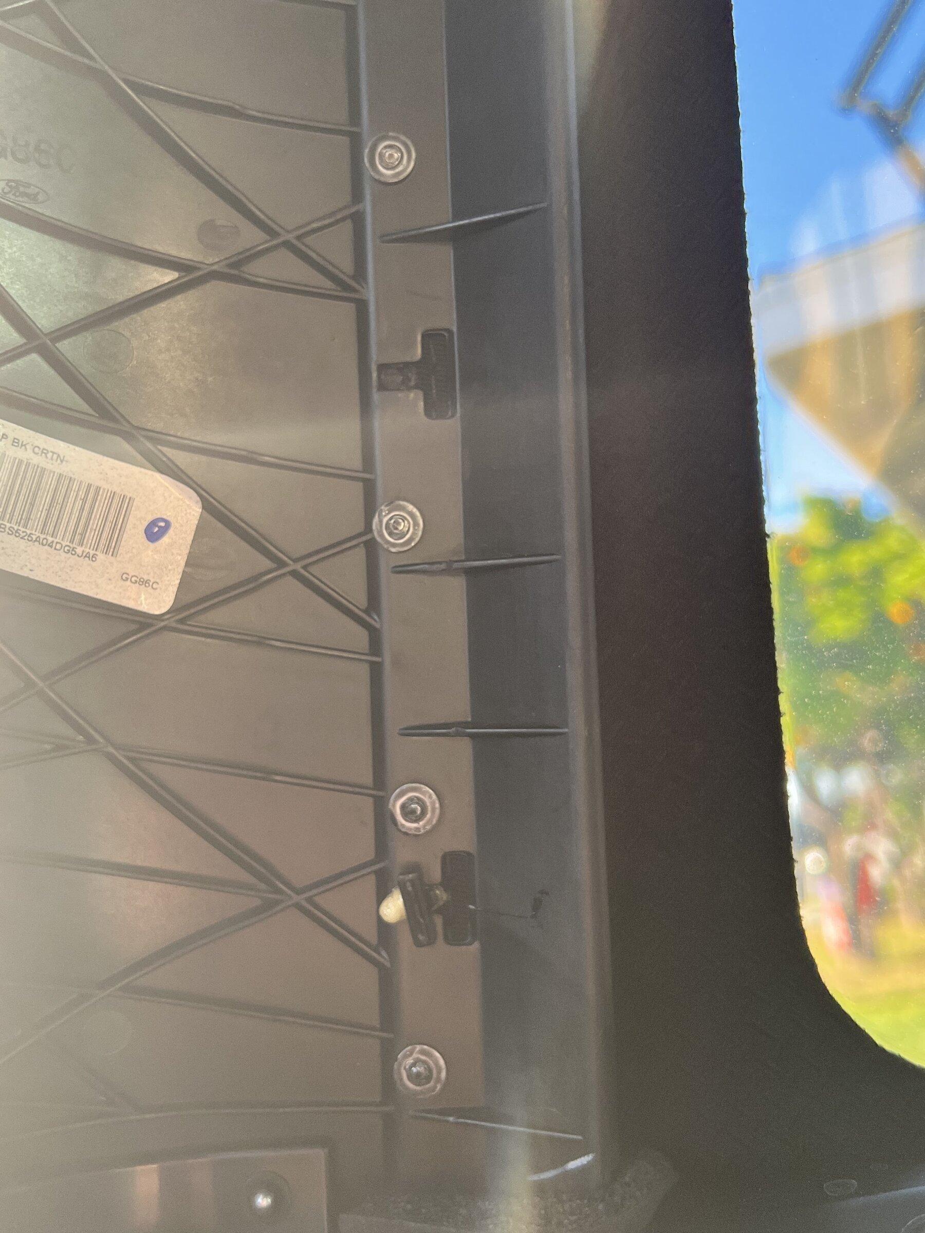

I'm in the same boat. Took the top off this weekend, didn't notice anything at the time I removed it, but couldn't get it back on properly. Noticed I had 2 broken clips on the top of my back panel on the drivers side. I'll have to take it by the dealers and see what they can do for me. Bright side, had a blast going topless this weekend, just a drag to have to deal with finding a fix for this now.
Ford Bronco Soft top broken tabs 20220522_174227
Hi there. This doesn't sound like an experience we want you to have with your Bronco. Could you please send us a PM with your VIN and the name and location of your Ford dealer? I'd be happy to look into how I can assist you with this soft top concern on my end.
