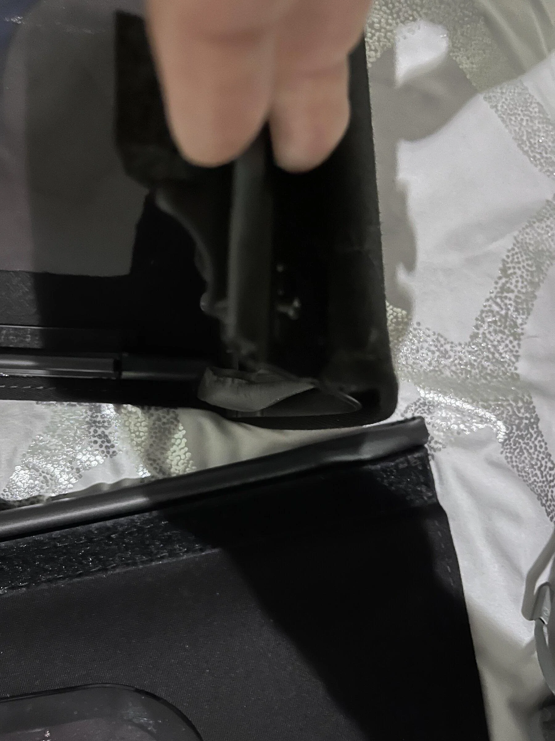

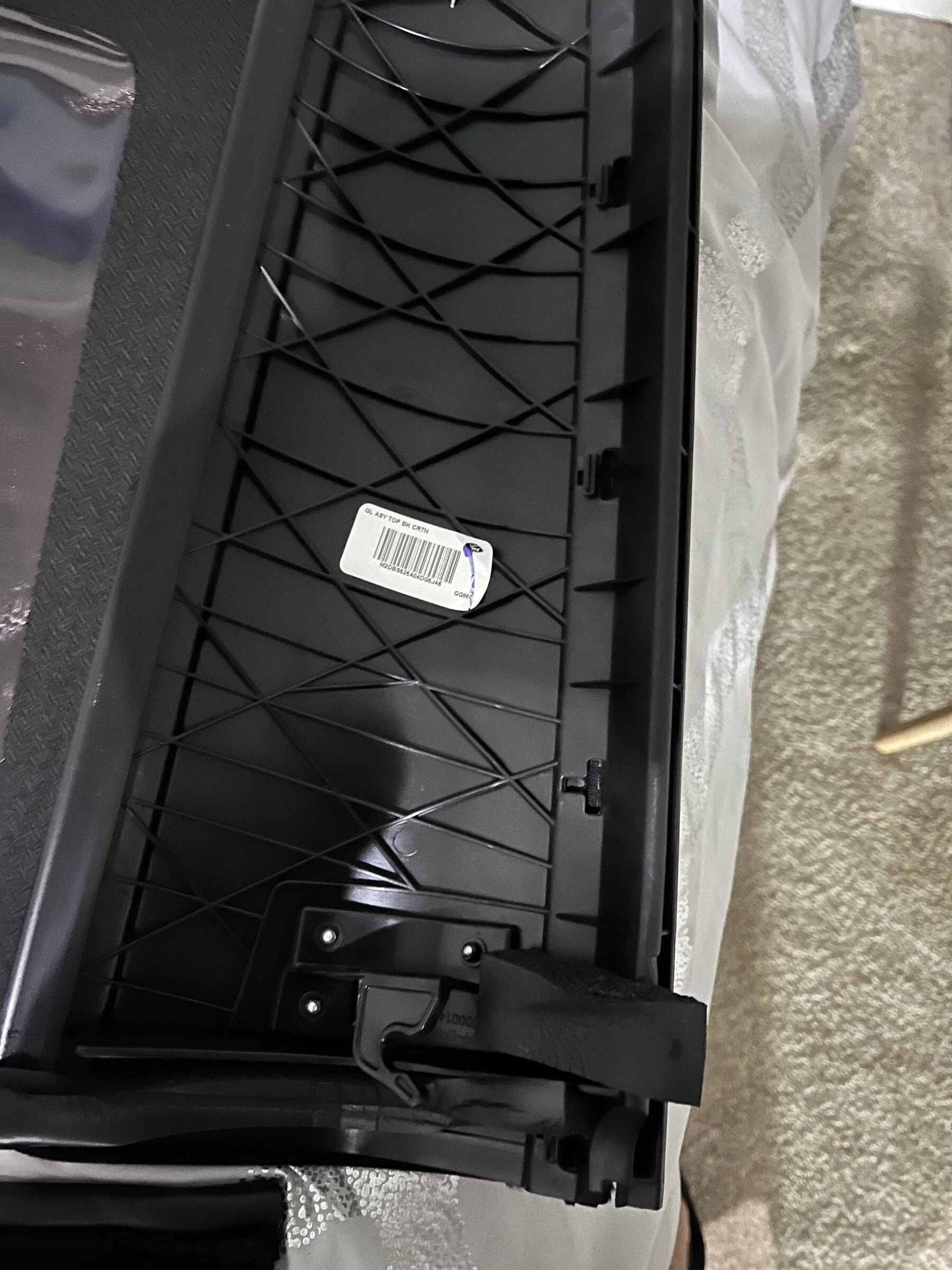

Same thing happened to me today. Followed everything to a t and was gentle as I could. Still snapped all 4 on the driver's side. I stopped after that. Idk what ford thought when putting these tiny clips in. Here are some pics of mine after I put the side windows back in.
