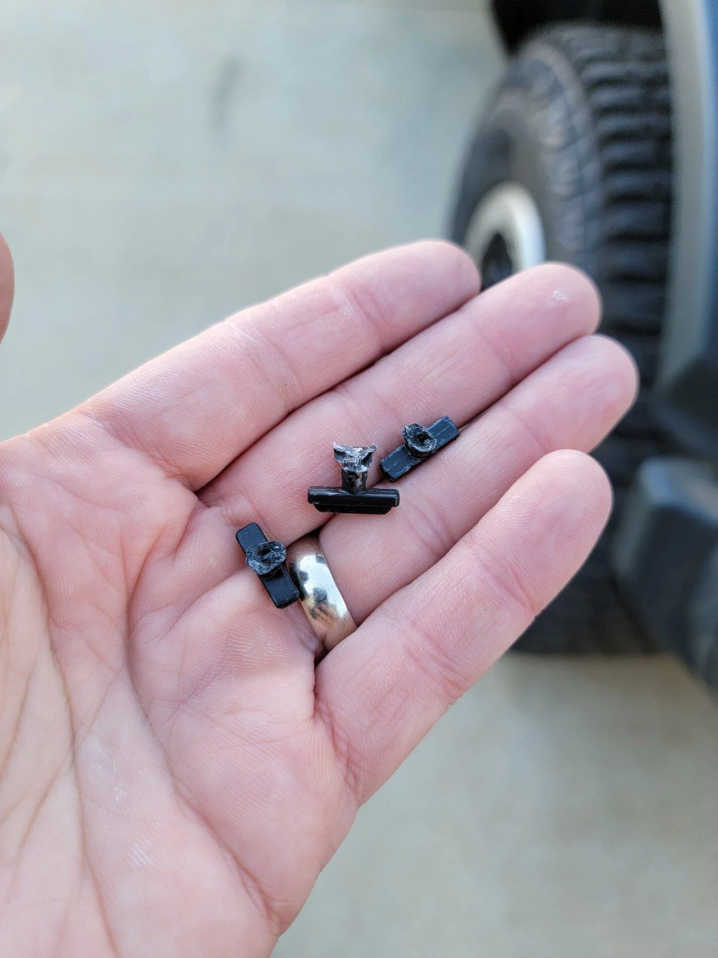

Same thing happened to me today. Followed everything to a t and was gentle as I could. Still snapped all 4 on the driver's side. I stopped after that. Idk what ford thought when putting these tiny clips in. Here are some pics of mine after I put the side windows back in.

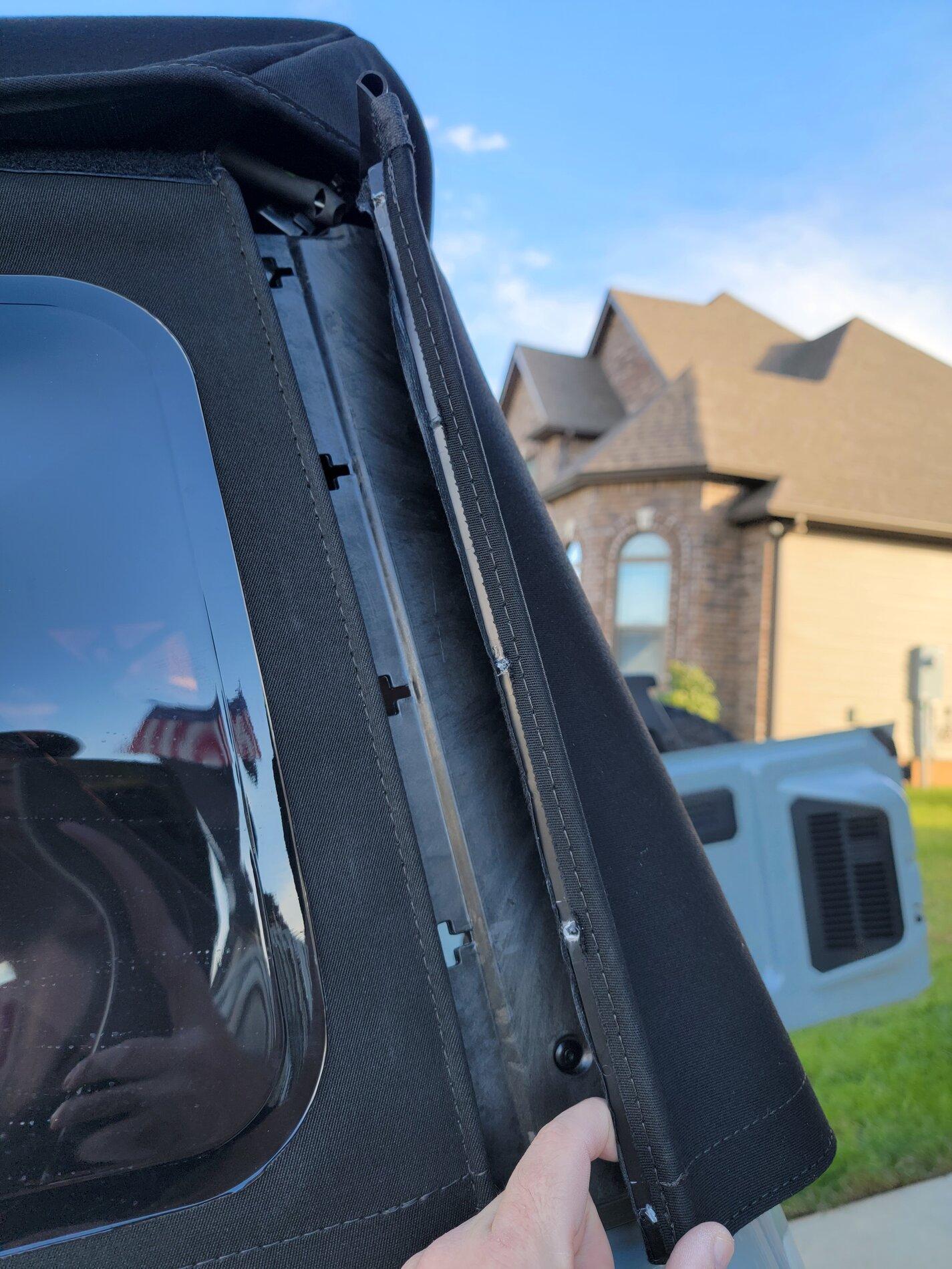

Don't peel the back corners of the rear window. Just give it a little pop on the bottom and kinda gently pull the top corner down a little and out. Bronco nations video looked like they just pulled it which is why many of us are dealing with this issue. I watched this video and I did exact thing he did and worked great. Idk what the dealer would do but I'd suggest watching the video I did below.

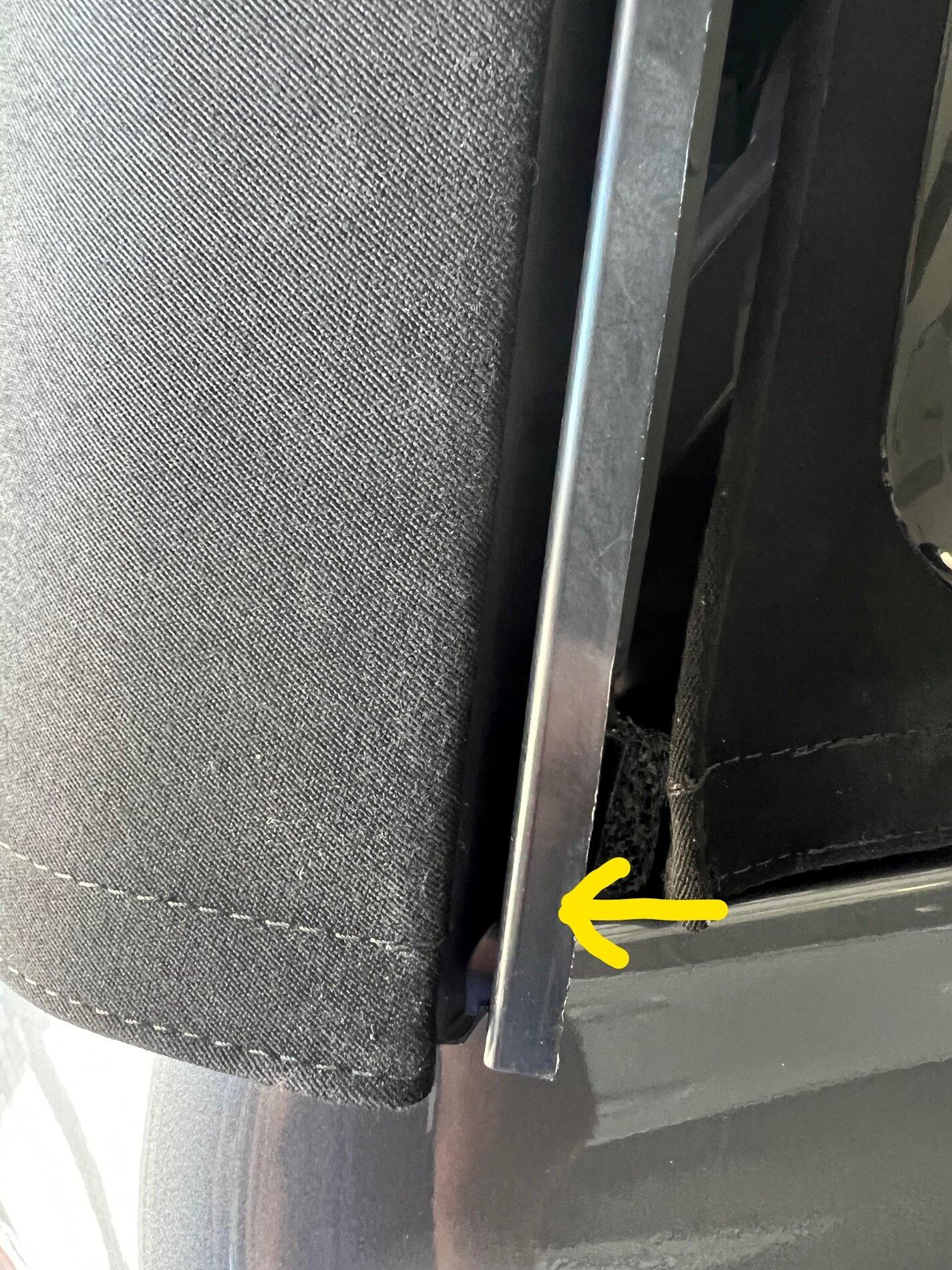

- The proper method is to remove the side windows first.

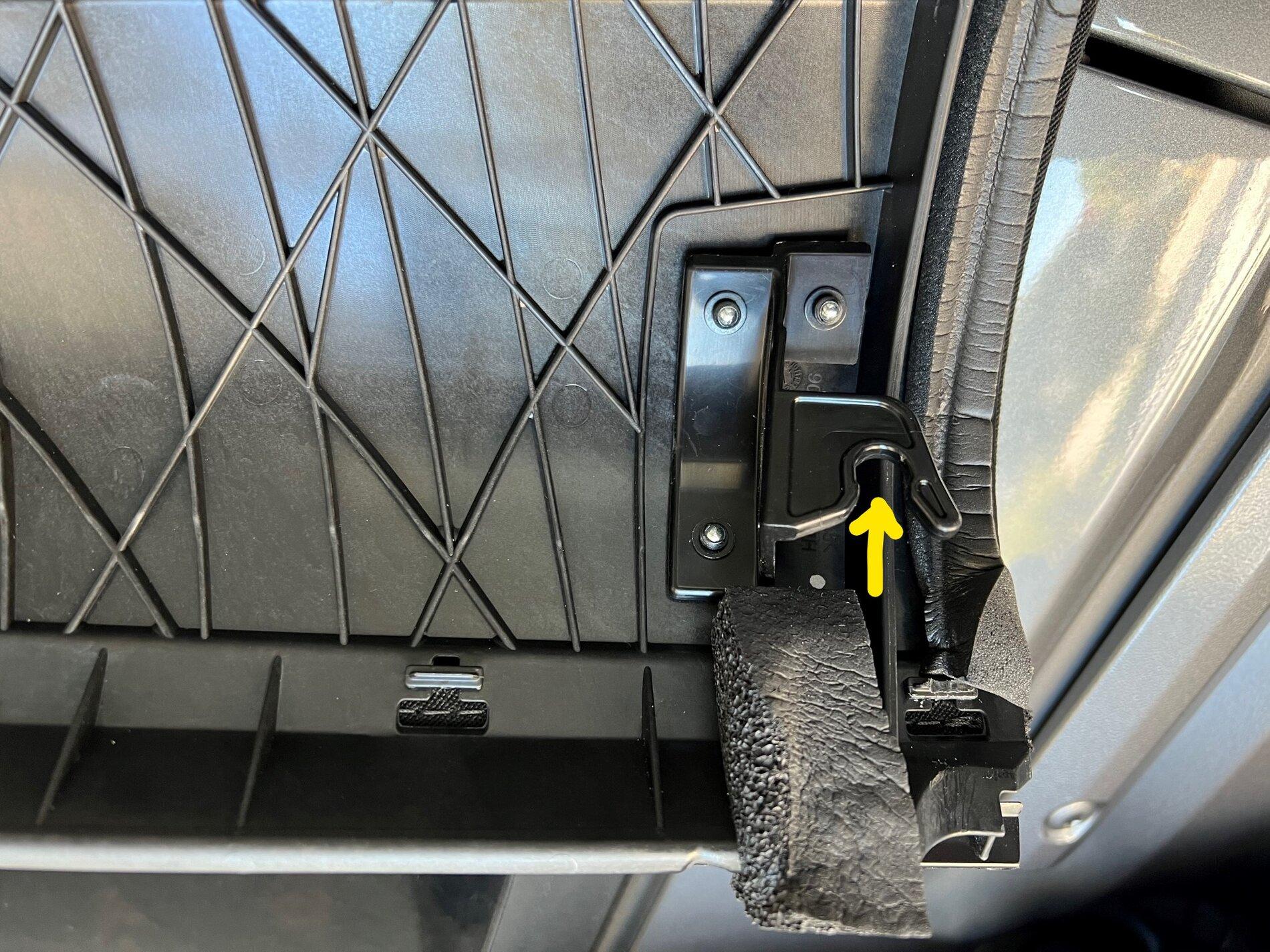

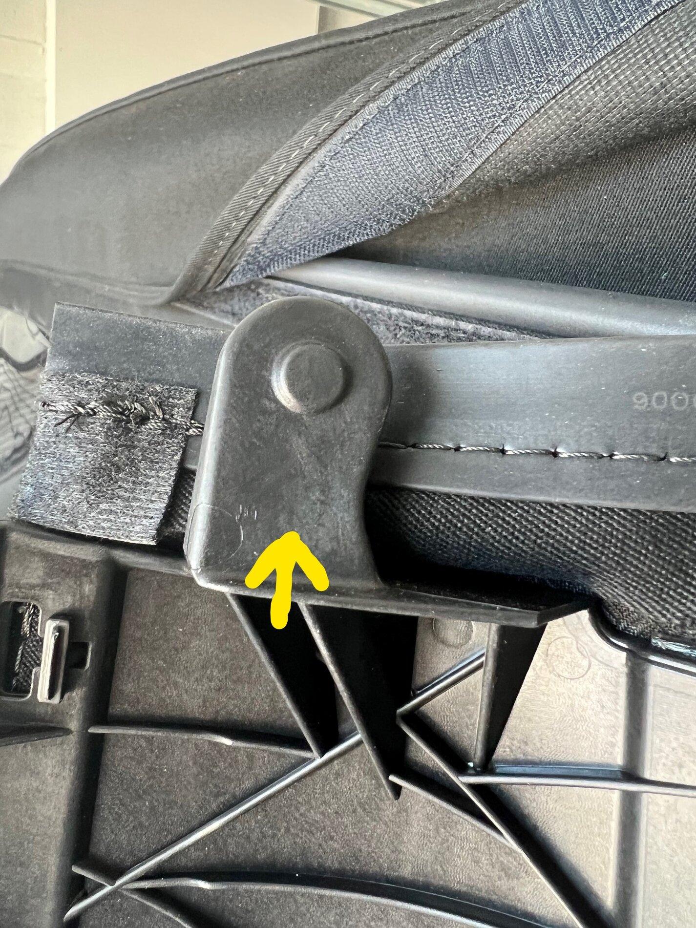

- Then to remove the rear window you gently pull outward on the bottom right (or bottom left if you start there) rounded plastic pillar. You do not pull at the canvas itself. There is a plastic seam (where the side windows slot into) and that's the correct pull point (at bottom). You pull from the bottom because there is a catch on the pillar that snaps into the slot on the bottom of the rail (see pictures).

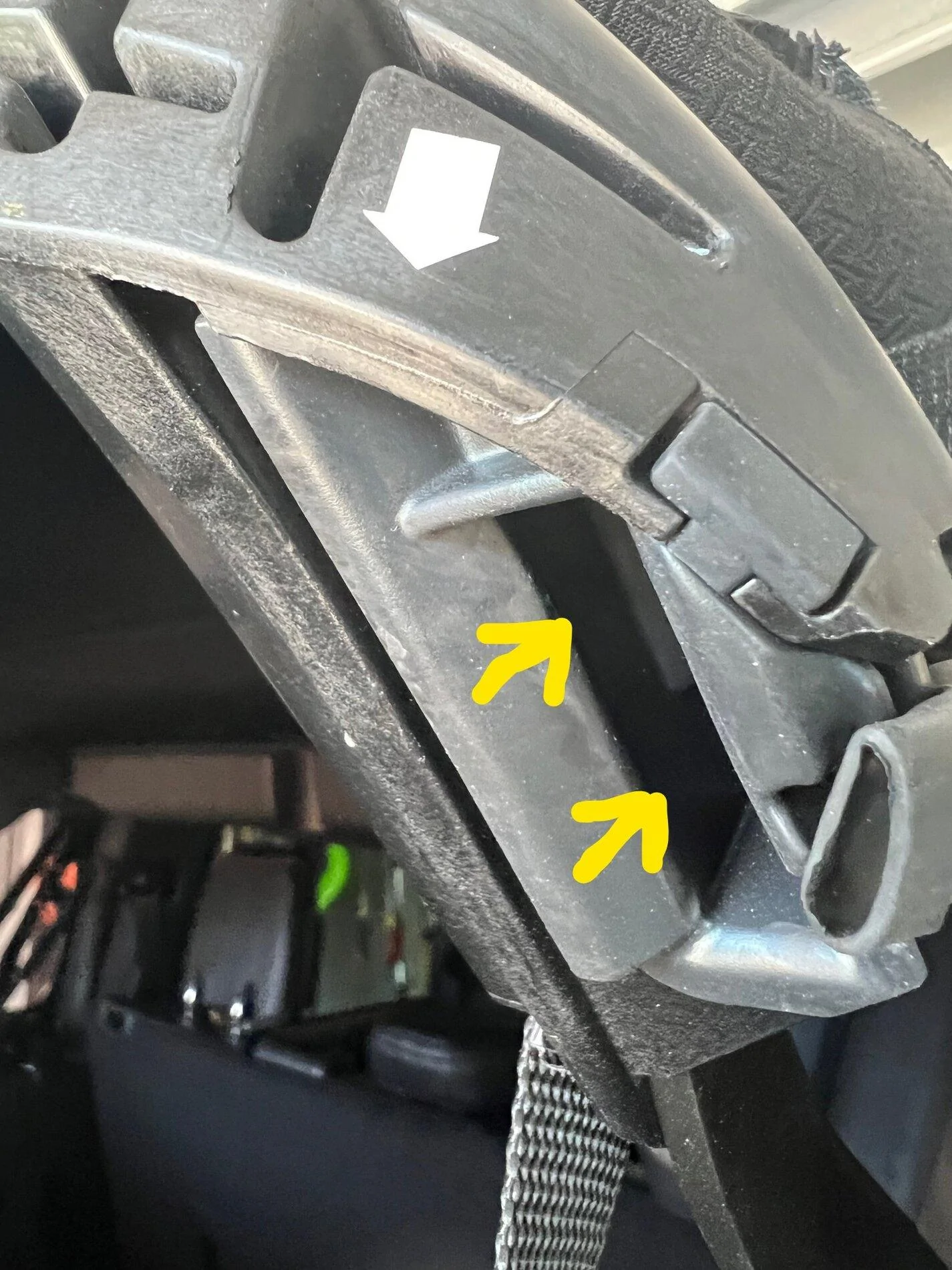

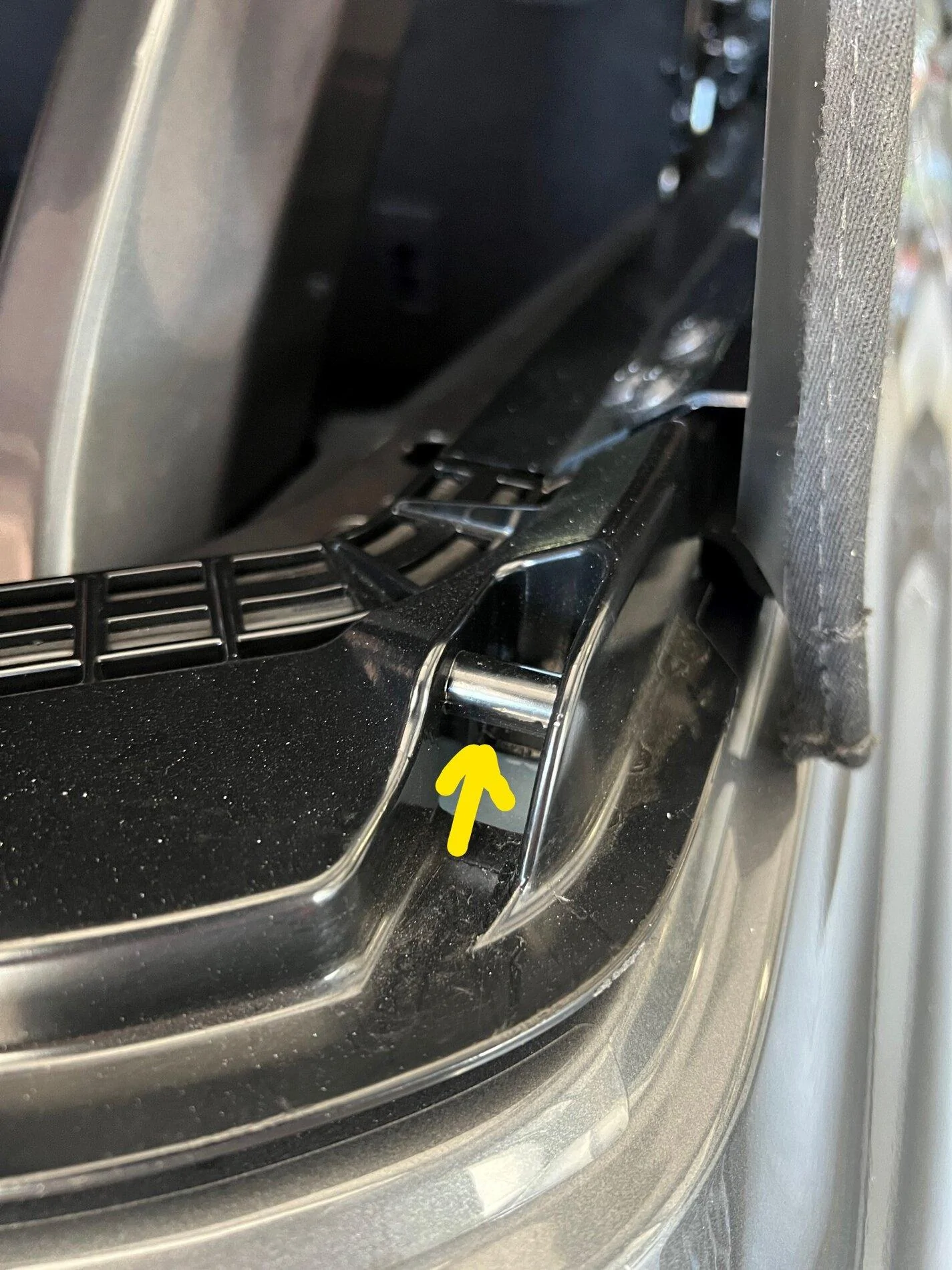

- Then the top of the side pillars slide down and out of the slot that is shown with the arrow.
- To reinstall it you start at the top, pushing the tab into the slot with the arrow and then push in the bottom until it snaps. See pics.
Pull Here First (Outer Edge - not pulling the top's fabric)
Ford Bronco Soft top broken tabs Top 1_LI
This hook will pull out of the snap that is part of the metal frame of the Top (next pic):
Ford Bronco Soft top broken tabs Top 5 - 1
Here's the snap on the metal frame:
Ford Bronco Soft top broken tabs Top 4_LI
Here is the slot at the top for the upper part of the rounded rear window pillar to slide into:
Ford Bronco Soft top broken tabs Top 3_LI
Here's to top of the pillar that has a tab that fits into the above slot:
Ford Bronco Soft top broken tabs Top 2 - 1
Bronco Matt
