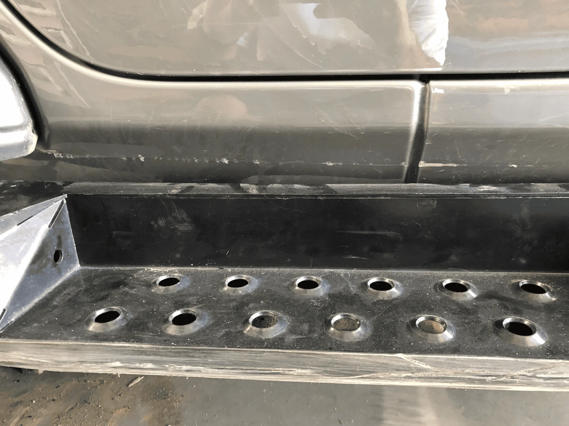

People under-estimate the strength of the pinch seam on the vehicle - remember that in a uni-body, it serves as the frame. The lateral support arms for the frame mount also create pockets where you can hang up on - instead of nice longitudinal sliders, you have now created lateral catch points. In the photos above, I would not call those "sliders" (regardless of what the manufacturer says), they are strong running boards.

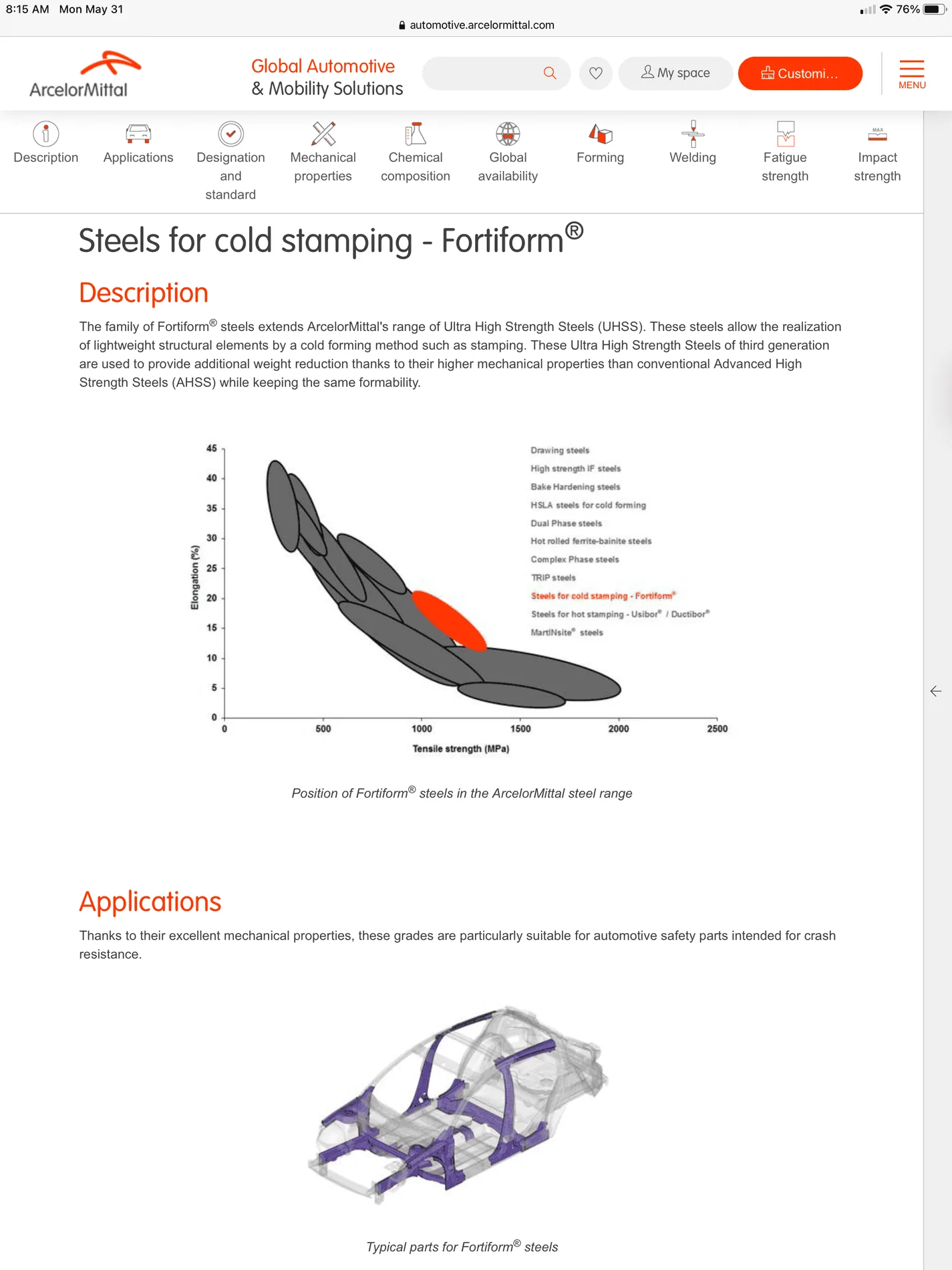

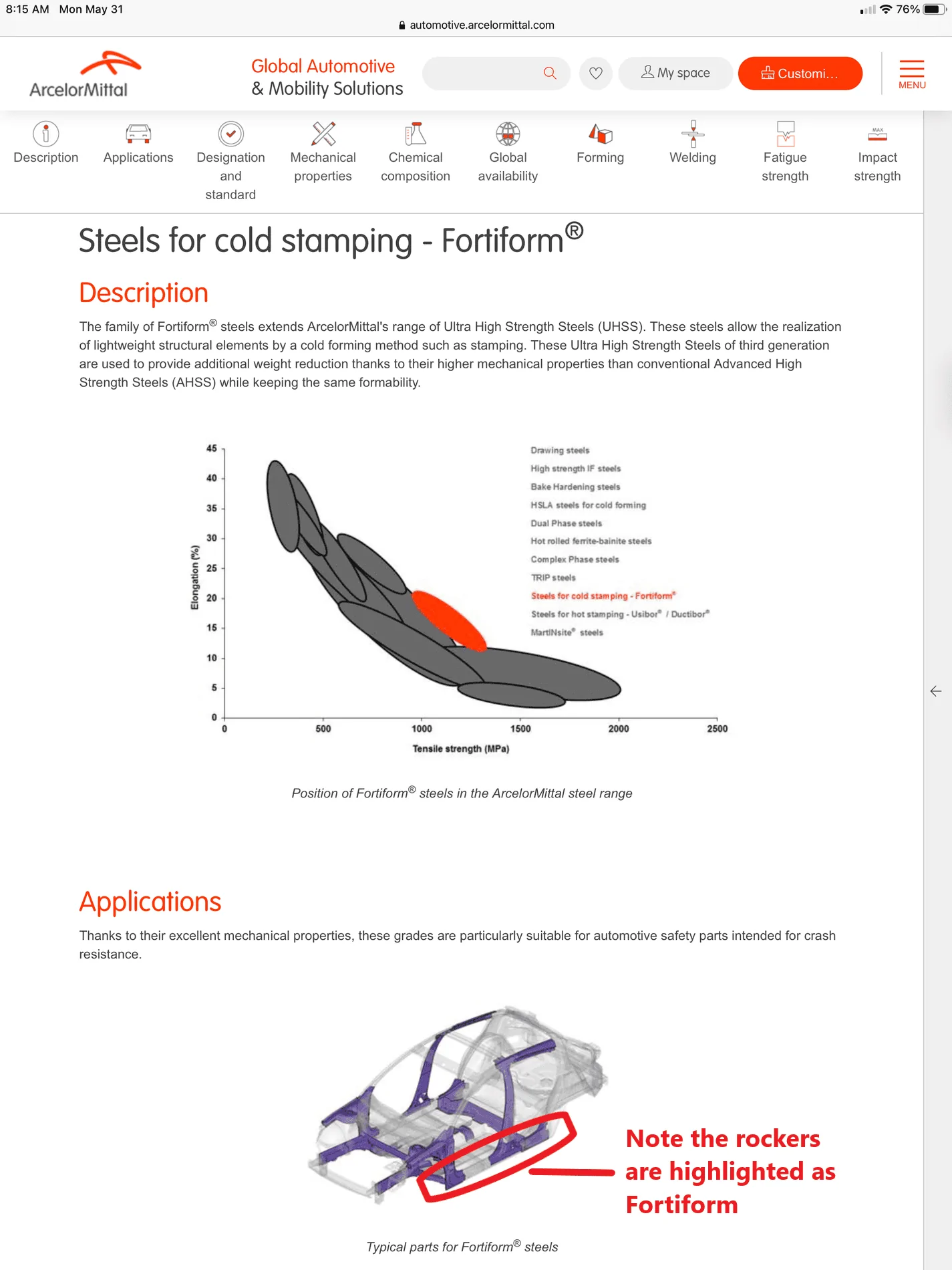

Also, food for thought, there is a good chance that the rocker panels are made of a high strength steel (e.g., Fortiform 980 GI grade).
Excellent point.
Conversely these parts might remain intact and hold their shape long past when another part would be damaged beyond repair…
I was thinking that if the rockers on the big bronco are also boron, and they are performing well, that might be why ford felt comfortable attaching the sliders to them.
Interesting thought. I did some digging and located the following information about the Fortiform 980 GI grade steel. Note the rocker panels highlighted in the Applications diagram at the bottom.

The lateral support arms for the frame mount also create pockets where you can hang up on - instead of nice longitudinal sliders, you have now created lateral catch points. ), they are strong running boards.
that was my first concern when I saw those posted a while ago (plus the crappy welding). They lower clearance and create nice bars to hang up on rocks and keep you there. If you happen to slide and get a good rock in between those bars, good luck getting going again. Would need extra armor plates in between those arms, even more weight and places to catch and keep dirt and rust. Not convinced by that design.
