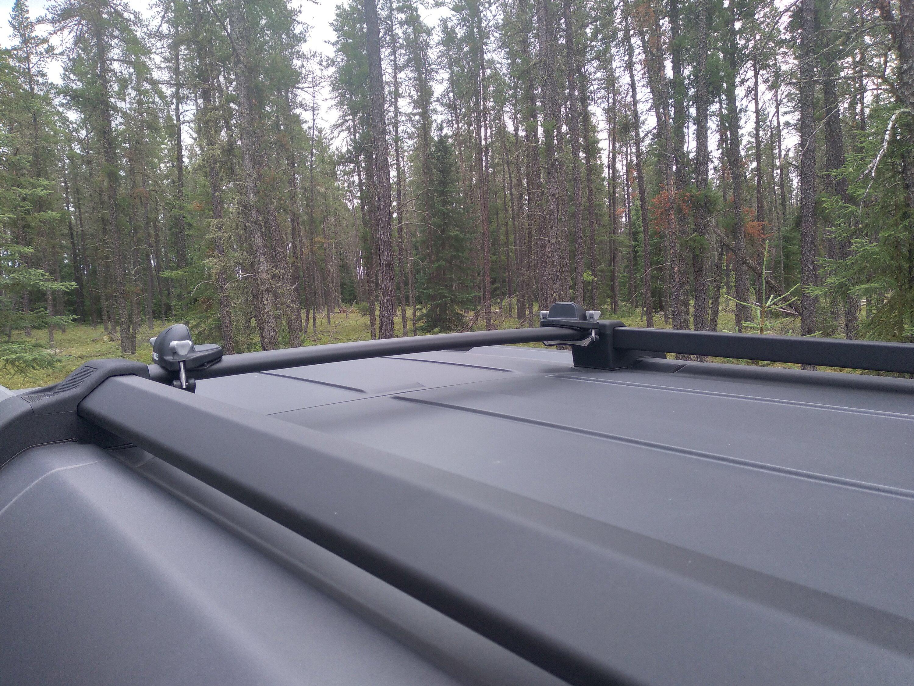

I currently own 5 Fords with Sirius subscriptions. My 2023 Badlands Sirius loses reception several times per mile in very clear areas....very annoying as I know it should not do that. My other 4 Fords barely ever lose reception...maybe only under a bridge or heavy cover, but rarely. Is anyone else having issues like this? If so, is there a fix for it?
Same thing with my 2023 Outer Banks. However have the OEM roof racks so the sat antenna is right under the aft rack. Funny though, the problem isn't as bad driving north or south and is very frequent driving west or east. Must be the orientation of the antenna on top of the roll bar. Hoping the problem clears up when I take the roof rails off for the winter. I do see there is an antenna extender available for F-250's and was going to talk to my dealer about moving the antenna from its current location from under the roll bar. PS: and having my canoe mounted I get no reception at all.

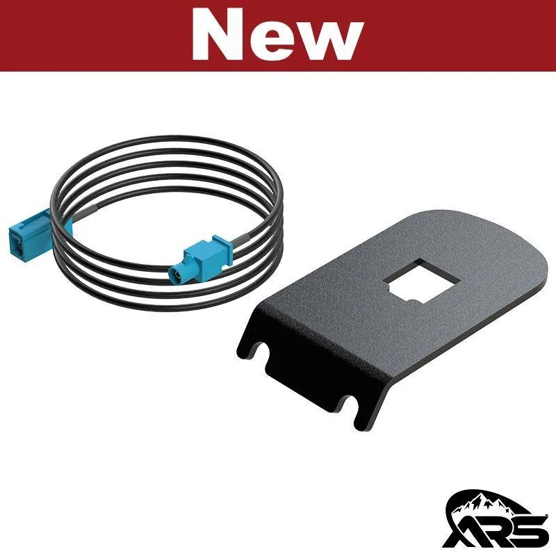

With my trailrax and the fact I will never remove my hard top I used this kit. Had to modify the mount plate to bolt to my rack but no more issues. 40 bucks and about an hour.
I’m picking up my new rig this weekend and installing the TRMR next week. Do you have a picture of where you mounted it, and how you routed the wiring?
Thanks!
