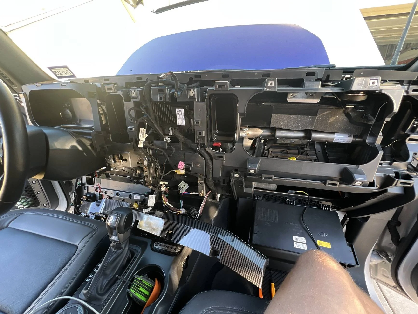

Well the whole front dash is off. I followed the sirius antenna from the back to the splitter and there are not any disconnections anywhere that I can find.
Makes me think the splitter itself must have gone bad. Guess its off to the dealership.

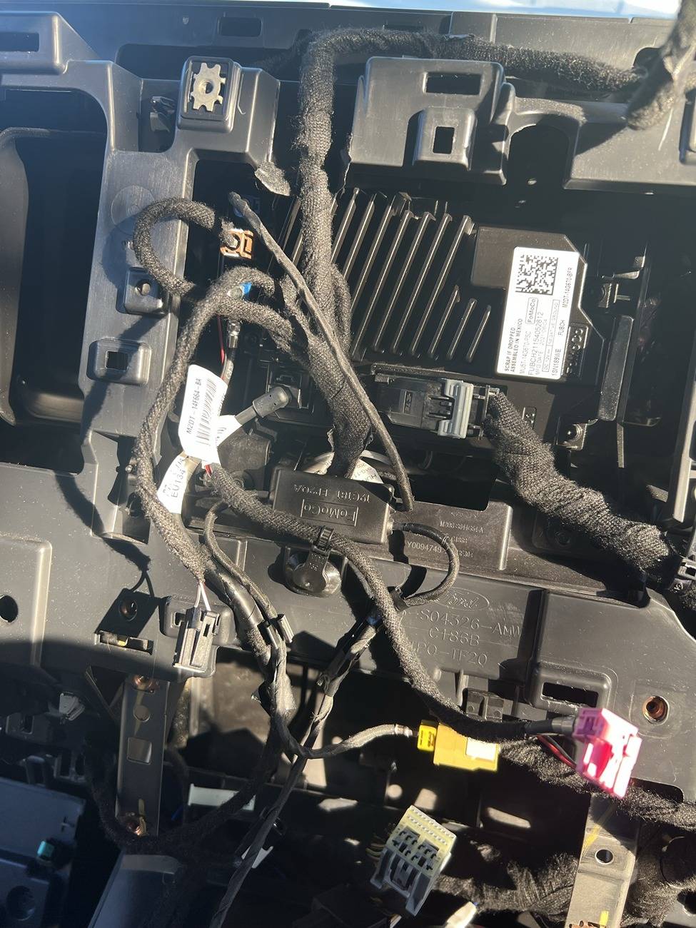

Here is the dash removed. In the picture you can see the splitter which I am guessing is the culprit. Open to any other ideas or places to look for loose cables.
