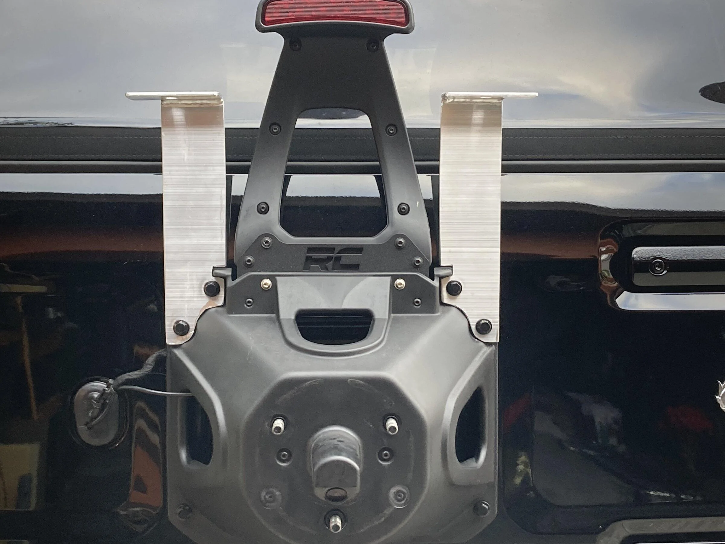

My mount will be metal with a horizintal top plate for the NMO mount. This plate will be 3 inchs by 3 inchs max. It is bolted to the tailgate.
Is this a DIY solution or something you found? Any pictures?

My idea is DIY stolen without shame from Mtap.
https://www.bronco6g.com/forum/thre...ve-vhf-gmrs-frs-etc.34238/page-4#post-1146312
Mine is going to be steel 12ga or perhaps 14ga sheeting.
I am going taller to clear the spare tire and using a slightly larger horizontal top platform.
Also planning to use rubber bumpers on the back side and a small piece of paint protection film.
