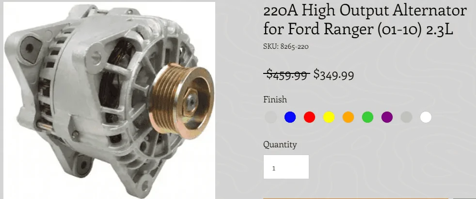

I was told there was a big batch of alts that were missing parts, spacers is what I was told. I have contacted Ford and they’re trying to figure it out. I don’t understand why Ford won’t let me go get an alt and have the dealer install it and reimburse me for it. I’ve done it that way last May with a water pump on a grand Cherokee. I don’t understand how an alt can be $500-700 on the web?
while it was there they replaced the front drive shaft, battery and driver window relay. The thing I was sweating was the driveshaft as they said there wasn’t an eta.
Fishwrinkle
Jan 17, 2023
272
242
12 GC overland 5.7, 18 GC srt 6.4
That one is 20A less than the OE
