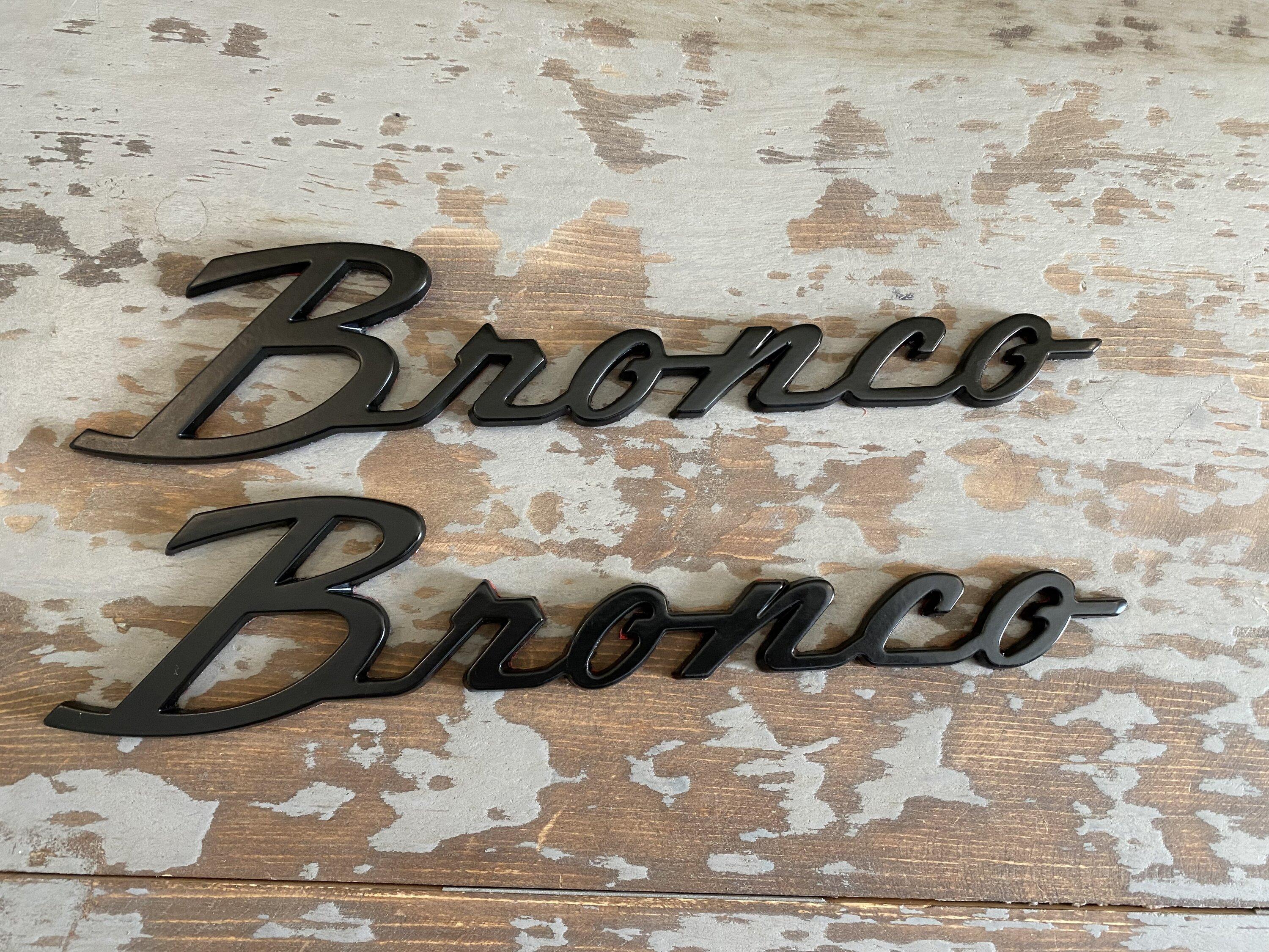

good afternoon! I grabbed the script emblem from bronco graveyard; removed the posts; touched up resulting bare metal. Now, I'm curious if someone can give me the best/correct adhesive to apply to the back for installation. Found this, https://www.3m.com/3M/en_US/p/d/b40065949/, but it seems too good to be true. Two reviews; one great/one terrible. Thanks for any feedback. Cheers!

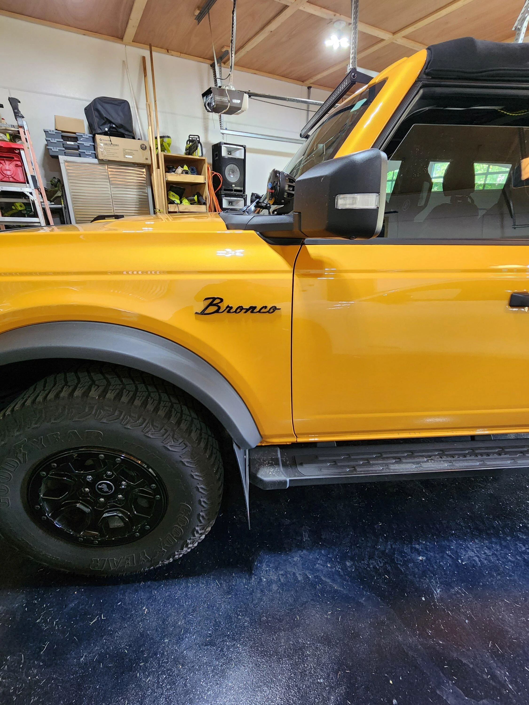

I order the black chrome script emblems from CJ Pony Parts, removed the mounting pins (not drilling holes in my baby) and used this to mount them https://www.3m.com/3M/en_US/p/d/b40069527/. I filled the back with resin to form a nice flat surface then custom cut with an Xacto knife. So far so good they have stayed in place through the tail end of a Minnesota winter and a crap load of mud.

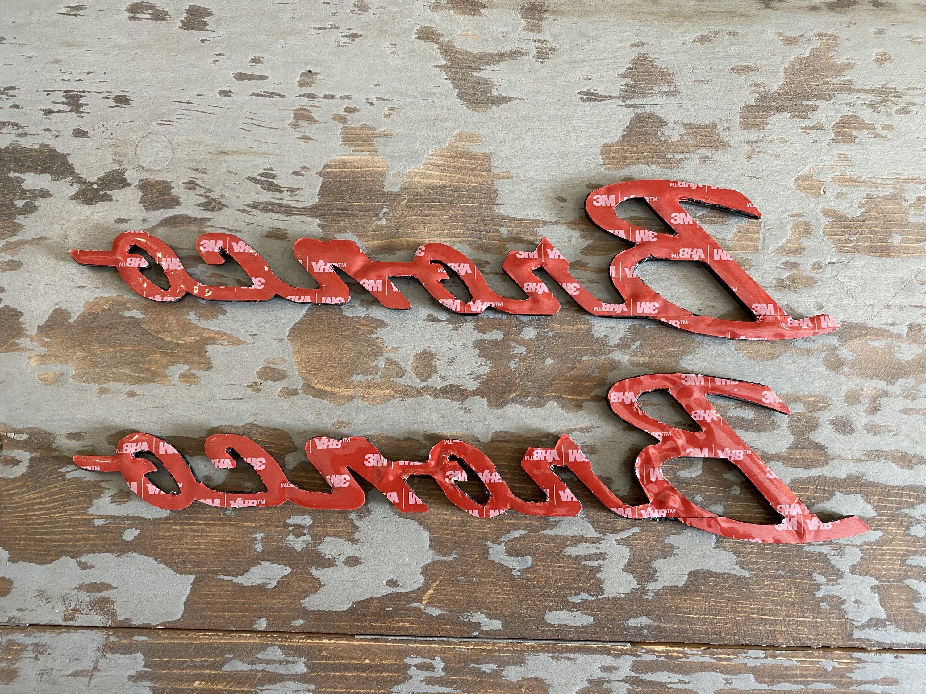

Thanks to all! Just finished this project. Pretty tedious adventure! Bought from Bronco graveyard, cut pins, touched up with auto paint, filled with epoxy, backed with 3m VHB, trimmed with xacto + nail scissors(killer tip Jack D!) Now, i resume the wait for something to mount them on😂(build week this week🤞)
