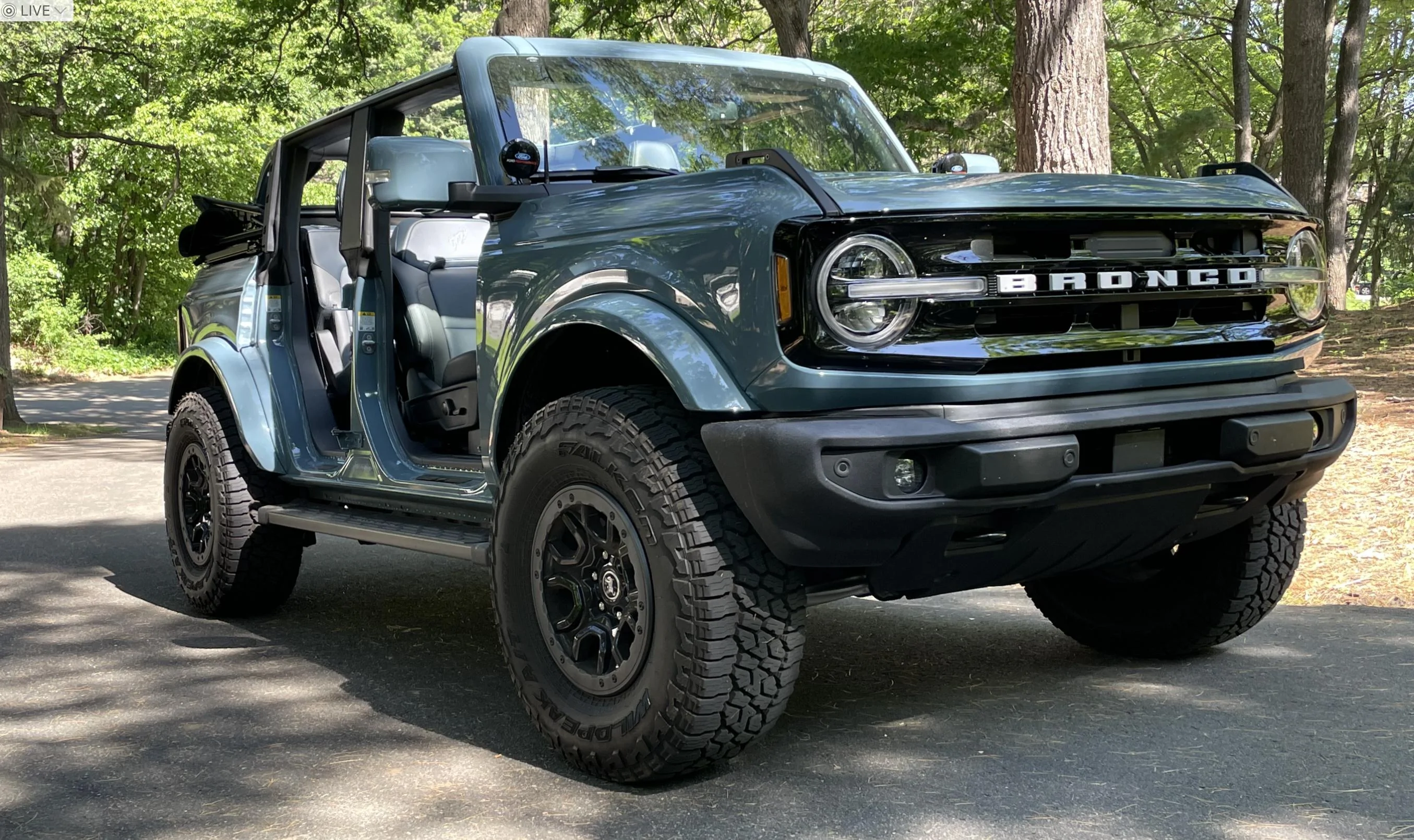

I have a non-Sasquatch with Sasquatch wheels I bought locally for $1,100. Tires and leveling kit with installation was about $2650. I sold my OBX wheels and tires for $750 so about $3,000 to get the Sasquatch “look”.
Ford Bronco Sasquatch seems like alot$ 6EA96D95-4158-4A7E-B646-5A7FF5C9AF54
IMO, the Sasquatch price is worth it even though the base Bronco is capable enough for the off roading I will do. I got impatient last December and wanted my Bronco sooner and dropped Sasquatch and the MIC top for my second order from the same dealer and without those constraints it arrived 123 days after I placed the order.
