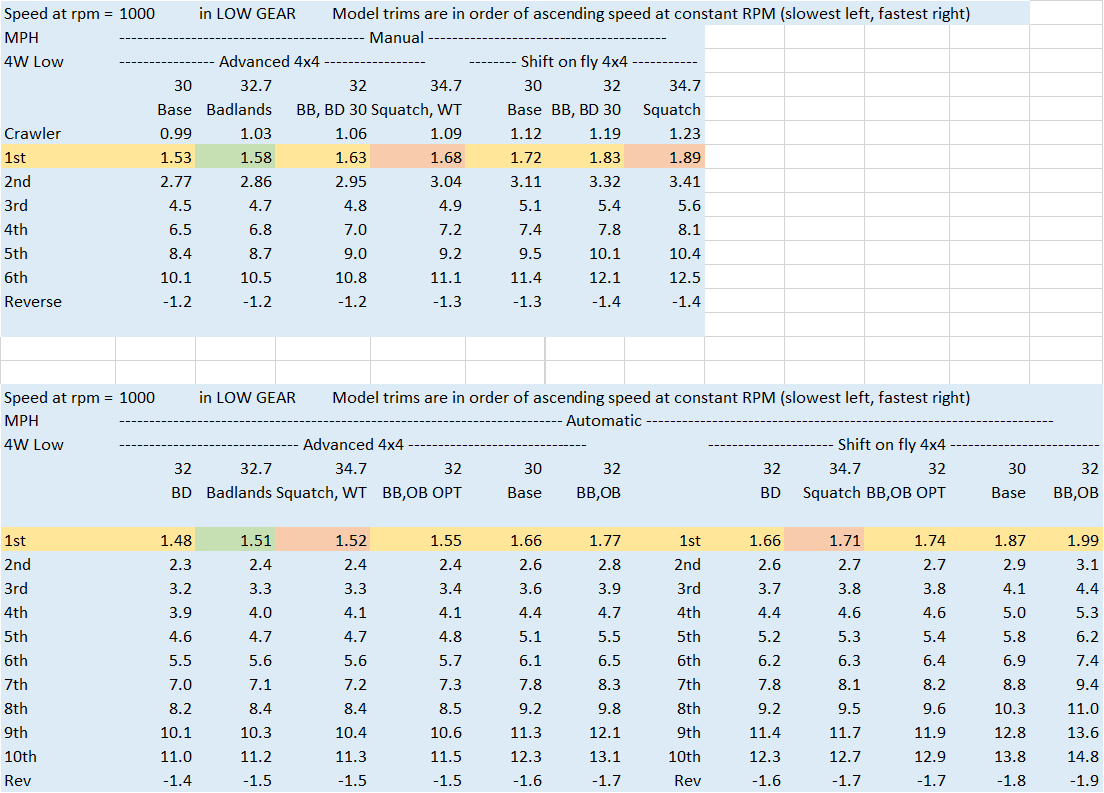

I do NOT understand what 'benefit' you think you are getting from the Sasquatch 4.7? PLEASE look at the attached table! With manual transmission, every other trim can crawl slower than Sasquatch, which needs 4.7 just to try and keep up!
For the automatic with Advanced 4x4, even given its 4.7, Sasquatch cannot match the slower crawl speeds of the Black Diamond or the Badlands, albeit it's close. MORE IMPORTANTLY, if you Squatch a lower trim WITHOUT upgrading to the Advanced 4x4, Badlands BLOWs AWAY Sasquatch in slow crawl ability!
Now I see,,, the ONLY WAY Sasquatch 4.7 gives a crawl advantage is when you upgrade an automatic Badlands to Sasquatch to get the 4.7 and THEN REPLACE 35s WITH 33s. This will yield the slowest crawl speed Bronco you can get.
4.7 on Sasquatch IS NOT A BENEFIT, rather a requirement needed to offset large tire circumference.
Change my mind!
Change my mind!
It’s hard to follow your point. It seems you are saying that the autos have lower crawl ratios than the manuals. Of course they do. They have to, because the effective crawl ratio of an auto is much higher than what’s listed, because it doesn’t stall. Most people will double the actual ratio of an auto to compare to a stick and look at actual crawl ratios on the trail.

In looking at those numbers, on the automatic side, with Advanced 4x4, the Squatch would be going 0.01mph faster than the BD at 1000 RPM but SLOWER than every other trim except BD (the person you quoted is mentioned an auto). Badlands is not listed on the SotF side of the table but the only one slower than the Squatch is the BD. The reason the Badlands is barely different is that it has higher gears (numerically lower) in the rear end and smaller tires (33's vs 35's) So no, the Badlands does not blow the squatch away.
On the manual side, yep, its faster than everything but if you're in C, it's slower than any of the autos by a wide margin.
I was replying to the guy who wants automatic transmission and wants Sasquatch for the 4.7 gearing. What I said is clear, it makes no sense that one would want Sasquatch because it has 4.7. 35" tires need that low gear ratio to be able to crawl
1. This is not an underpowered Toyota.
2. Transmission gears matter too. Pretty likely that 1st gear in the 10 speed is lower than 1st gear in the 5 or 6 speed that the Toyota has.
3. I'd put 35's on my F150 in a heartbeat if I had a lift, I've got the 6-speed and 3.55's and I'm pretty sure it would be just fine. Yeah, I've got the V8, the 2.7 puts out as much peak torque and more at lower rpm so...
Badlands is not listed on the SotF side of the table because Badlands comes with Advanced 4x4! AND because Badlands has Advanced 4x4, if you put Sasquatch on a lower trim automatic, Badlands will BLOW AWAY squatch without the upgraded 4x4 system, but I ALREADY SAID THAT. Please read more carefully before disagreeing!
Change my mind!
Cheshire, you are correct that the deeper gears only offset the larger tire diameter, what you aren't taking into consideration is the advantage the larger tire diameter gives you offroad. Take the black diamond's not quite 32's vs the 35s on the squatch, now try to roll them each over the same obstacle. Try rolling over a log, climbing a ledge, or getting a tire on a big rock. The larger tire will always have the advantage, and the throttle bump to get over that obstacle will be much less necessary. Tire diameter offroad is king if everything else is equal.
I agree with you 100%, but this topic is about gearing. A lot of people say they want Sasquatch for the 4.7 gear. The 4.7 is there to alleviate some of the negative effects of having a large 35" tire. There is nothing special about 4.7, it is merely necessary to accommodate large tires.
Big tire advantage off-roading is un-questionable, but folks should beware of getting a lift and installing 35s on lower end model trims. People who lift the Base (for example) and put on 35s w/o the Sasquatch gear and w/o the lower gearing in the Advanced 4x4 will find themselves disappointed.
Dude, calm down, yep, I missed that sentence and was not aware that BL came with the advanced 4x4 either (that actually makes me more likely to go BD). My apologies.
If you're planning on going 35's anyway, I think Squatch does make sense. Add 35's to all those trim levels without Squatch and look at the numbers. And I've seen several members say they may Squatch and go down to 33's (which probably gets them close to the ratios that automatic Jeeps have)
Change my mind!
The benefit I was referring to in my post was for highway driving with 35 inch tires or perhaps 37's.
Does the 4.7 gearing not come into play there?
