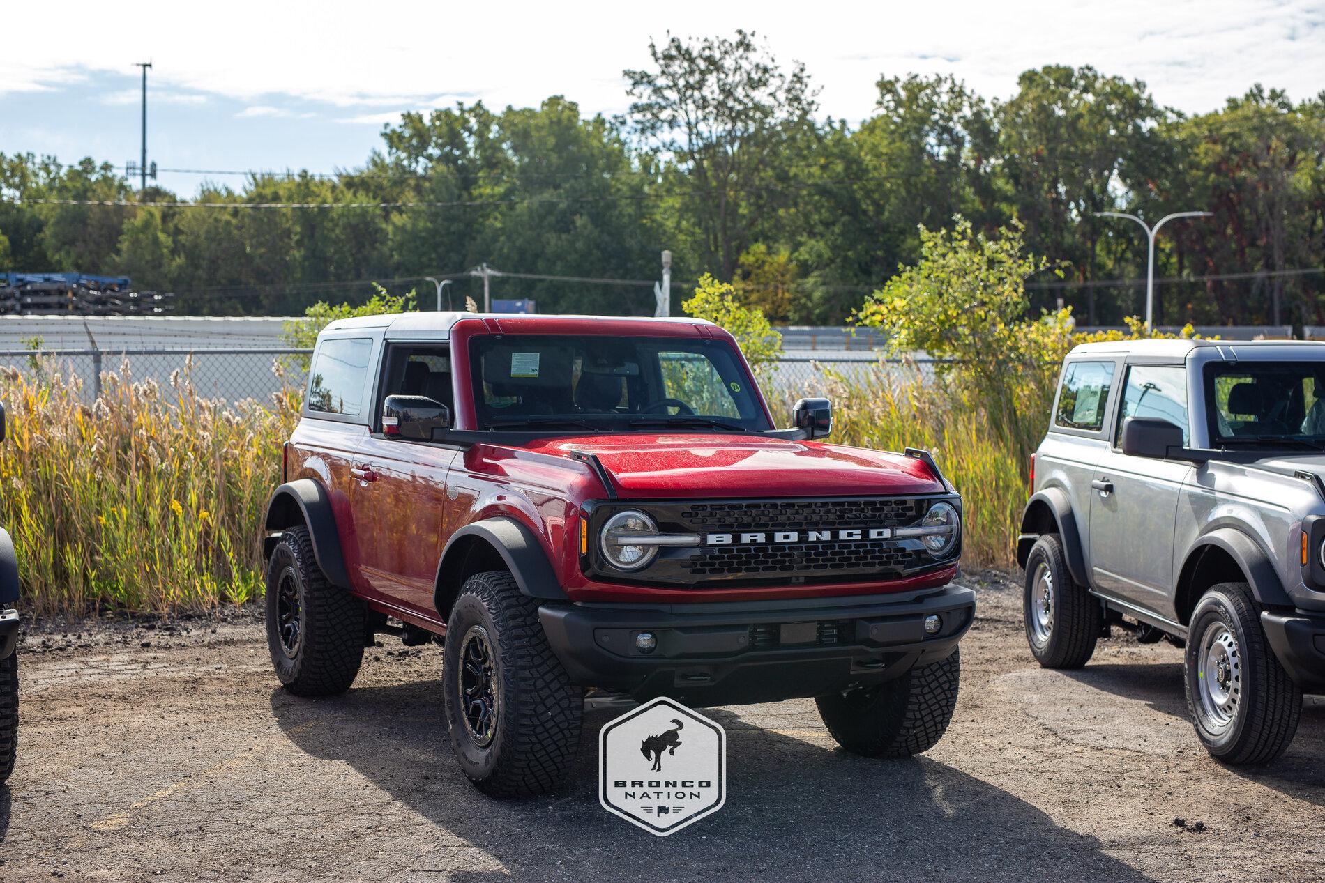

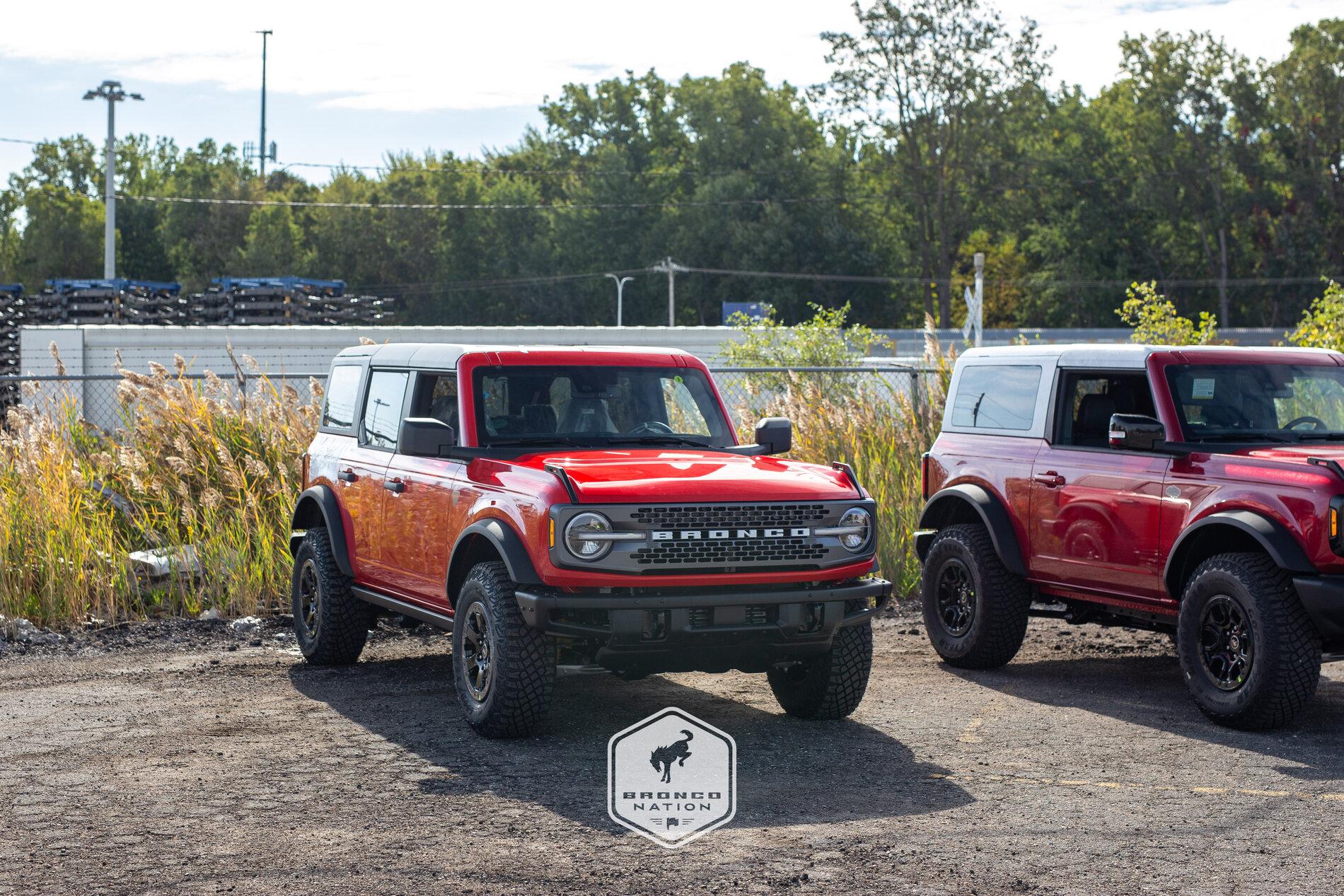

Good news is, both of these look fantastic (badlands vs wildtrak with Sasquatch) so I don’t think anyone will be upset not getting Sasquatch. Although those that get Sasquatch might be a little happier ;-)
Ford Bronco sasquatch on badlands really worth it? 1602459720504
Badlands no squatch vs:
Ford Bronco sasquatch on badlands really worth it? 1602459755767
wildtrak
