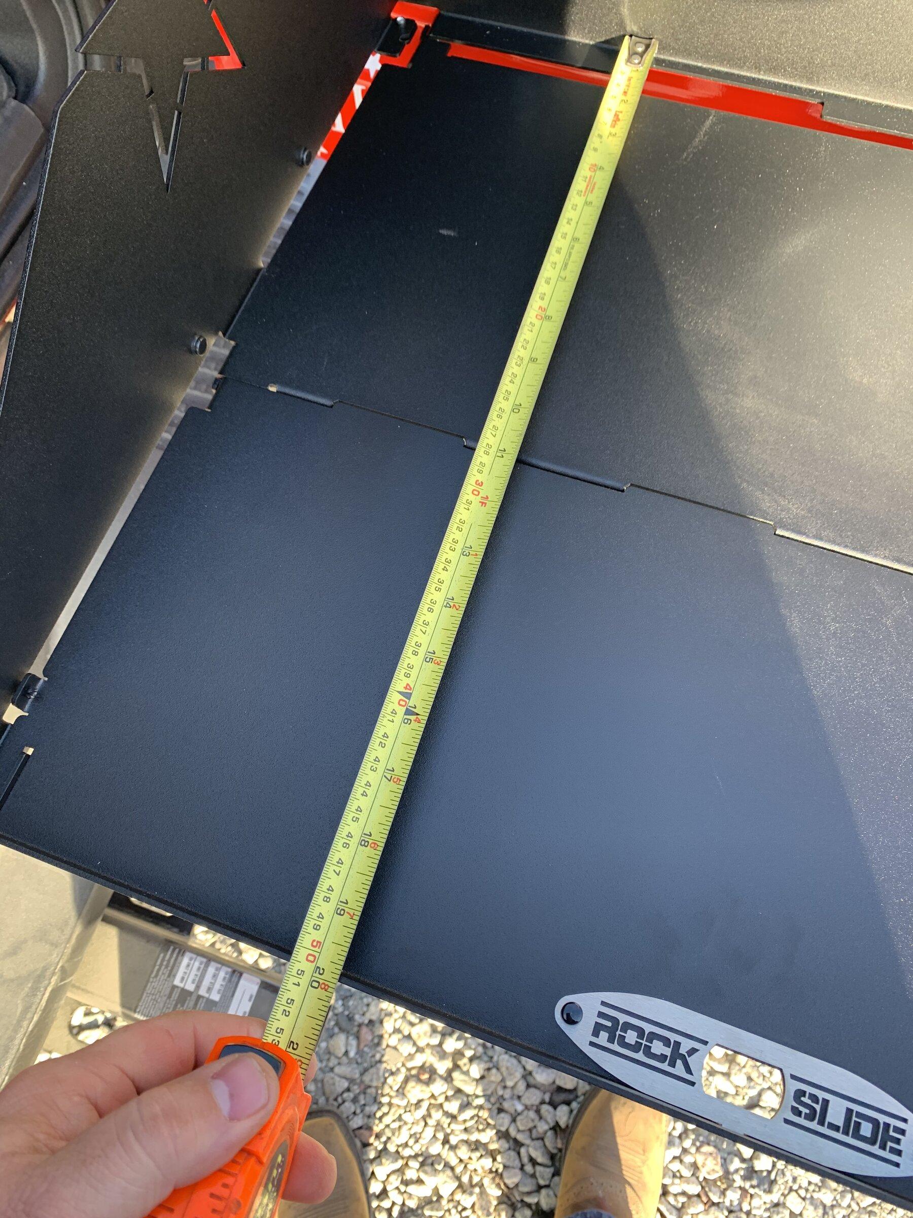

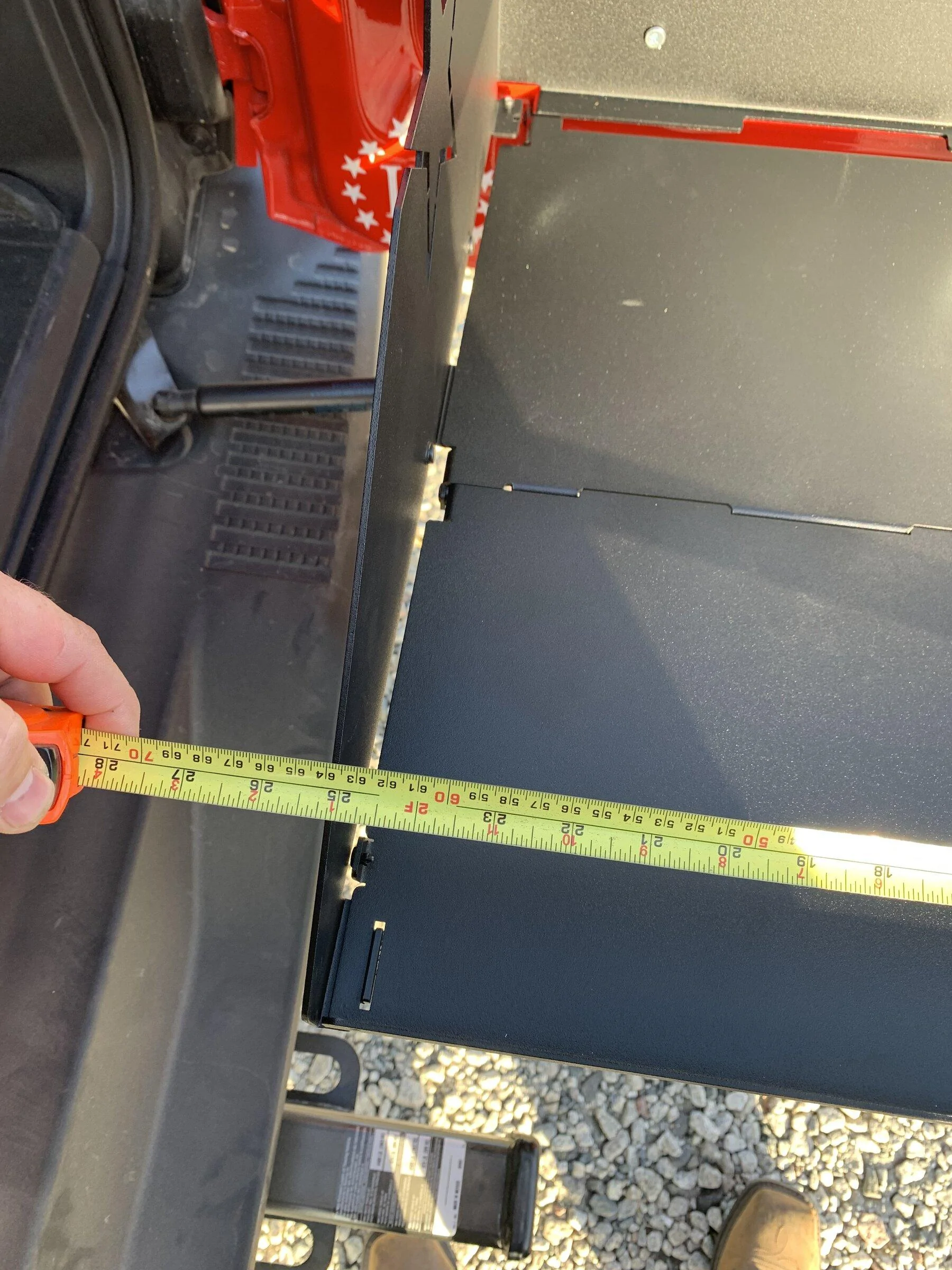

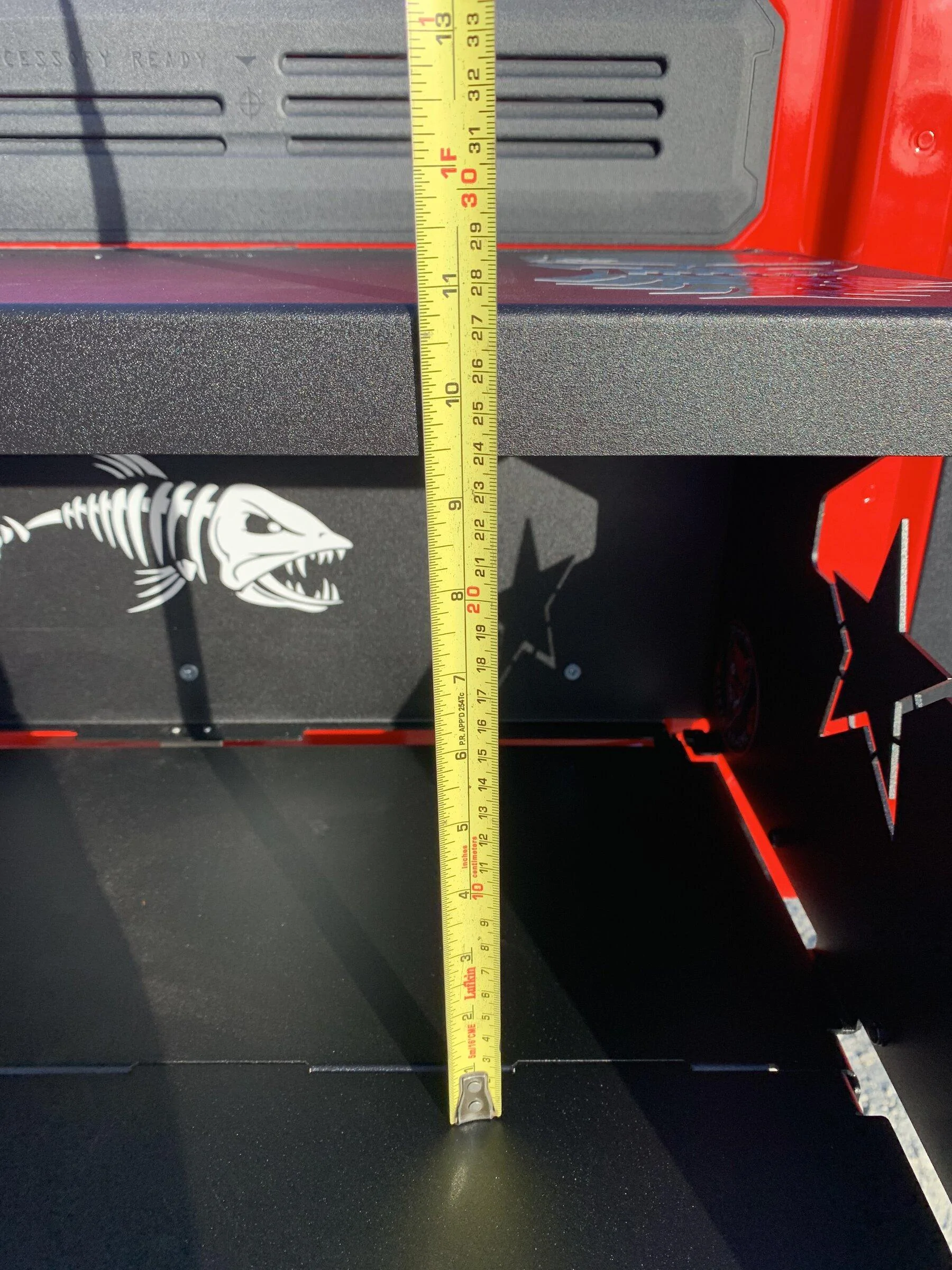

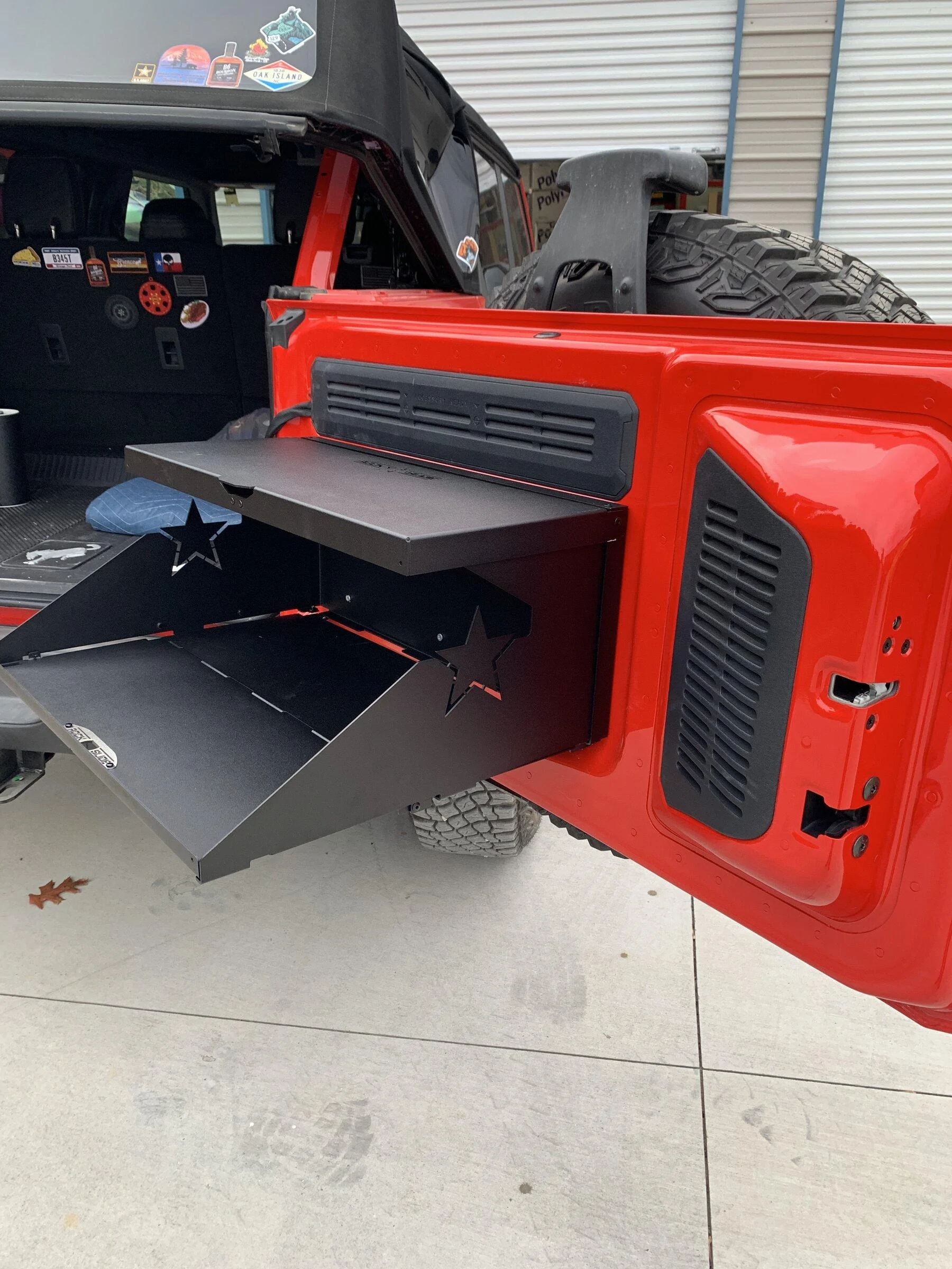

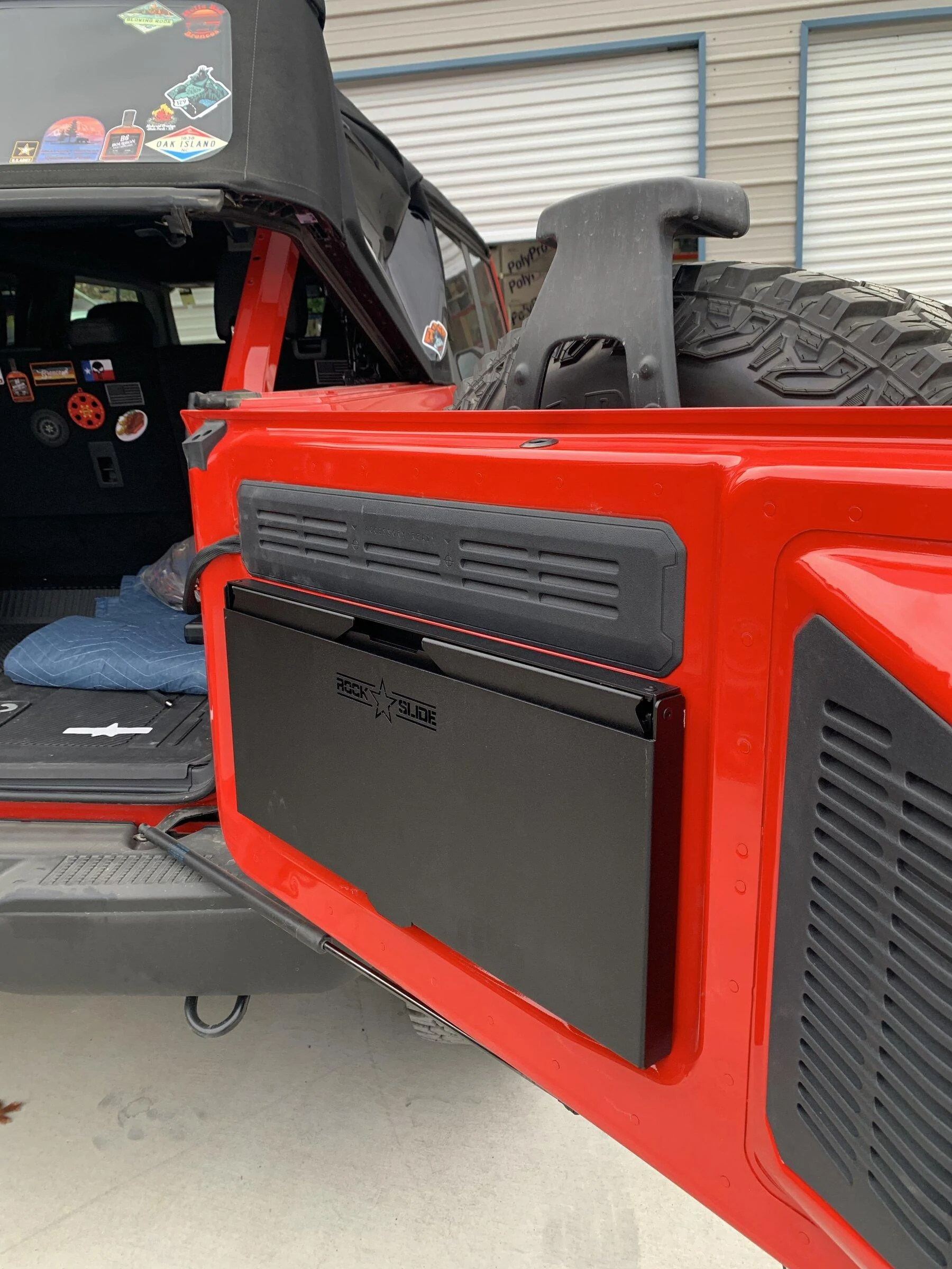

Install was a breeze.
Instructions were for a JL/JK but pretty straight forward install with a bit of common sense.
Included hardware sufficient, screws aren’t too long so no worries about poking through to the exterior gate shell.
It did rattle a bit but I put rubber bumpers in strategic places and no more rattles, even on bumpy gravel.
I am very happy with it, highly recommend it.
Super handy with two levels of flat surface. Plenty big enough for that 17” electric Blackstone for all things bacon.
measurements pics included below.

For the self tapping screw in the upper right hand corner, did you have to shorten it at all or did it go right in?
I watched another install video and they had to shorten theirs, I'm wondering if the same happened for your installation?
I already purchased, should be here tomorrow.
One more, could you post a pick of the placement of the rubber bumpers?Edit: I see the clear rubber bumpers.

My specific question is did you find that the screw in the upper right corner came in contact with the hardware from the 5th wheel carrier?
In the video installation I saw there were no issues with any of the screws piercing through, the only issue was that one screw location being problematic.

No issues, I used them all as packaged.
Others have asked why I didn’t bolt it with nutserts.
I always figure if it fails I can go larger, but not smaller with the mounting hardware.

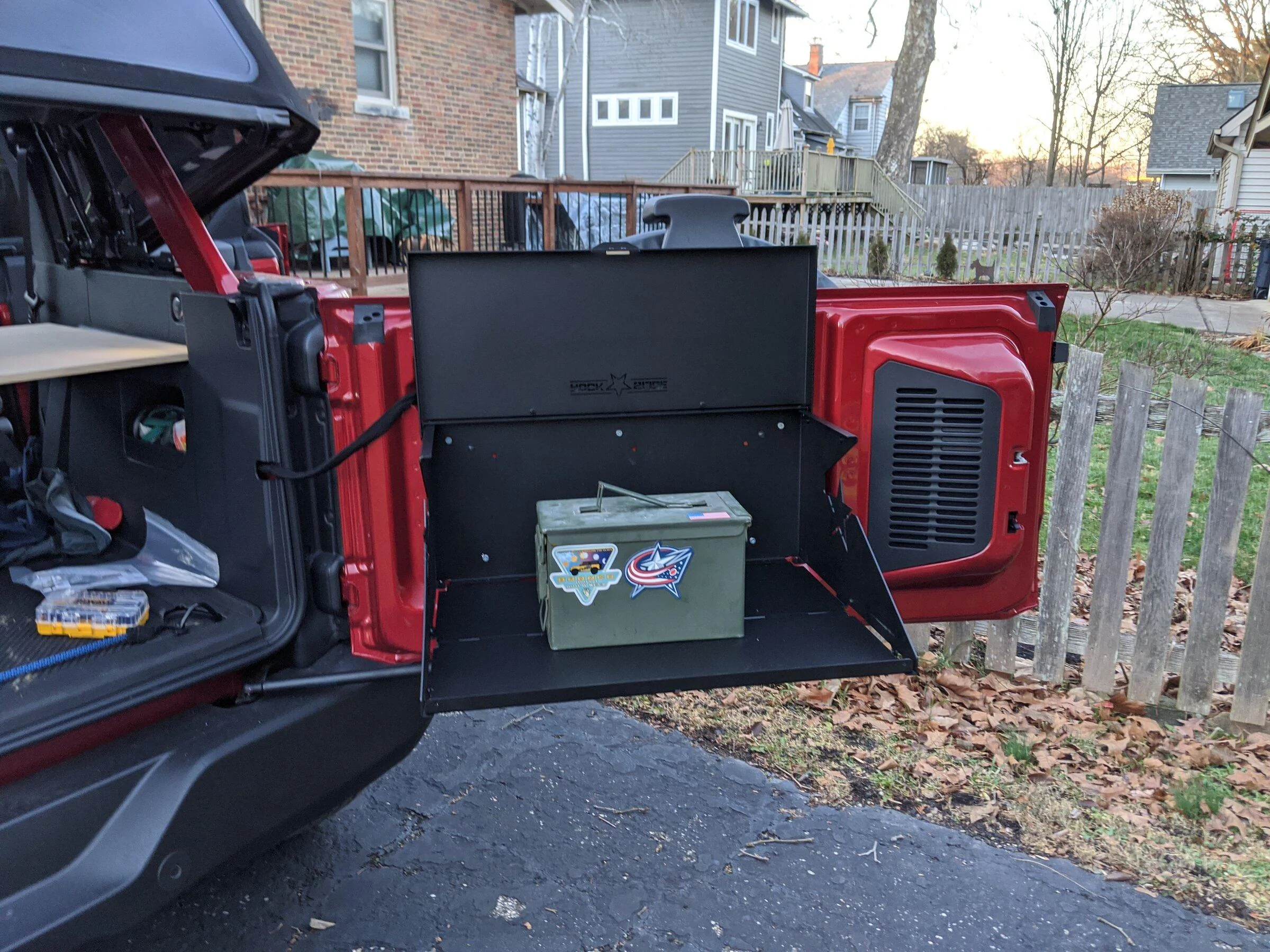

It looks great and I love the two platform approach, but I don’t think I could live with the large stars cut into the side pieces. The stars are 1. Stupid looking 2. Dangerously pointy on top for a kid’s hand 3. Compromising strength on the otherwise stout looking bracket (Which I’m sure is already plenty stronger than the tailgate itself).
CowboyKid
Nov 9, 2021
116
144
Washington State
2022 Bronco 4DR
Agreed on all counts: Branding at the expense of the product is bad business. But the star point can be rounded off with a little cutting and filing, which I plan to do. The rest of it is a great design except for the fastening which I suspect won't age well, and the lack of an adjustment to help level the table to account for rake in the rig and/or uneven ground.
A number of people have the view that the tap screws worked good for now and you can nutset it later if necessary. But I think it will be necessary, so maybe will just do that from the start when I'm motivated, rather than annoyed later.
As for leveling, that's something I'm not sure I will really need but will figure out. LIkely not a big deal unless you are cooking on a stove that can't be safely shimmed, in which case the stove probably should just go on the ground or on a rock or a stump or something. Would be curious if anyone else thinks that's an issue with this table (and tables generally) and whether it really needs to be addressed in the installation or not, and if so how.
