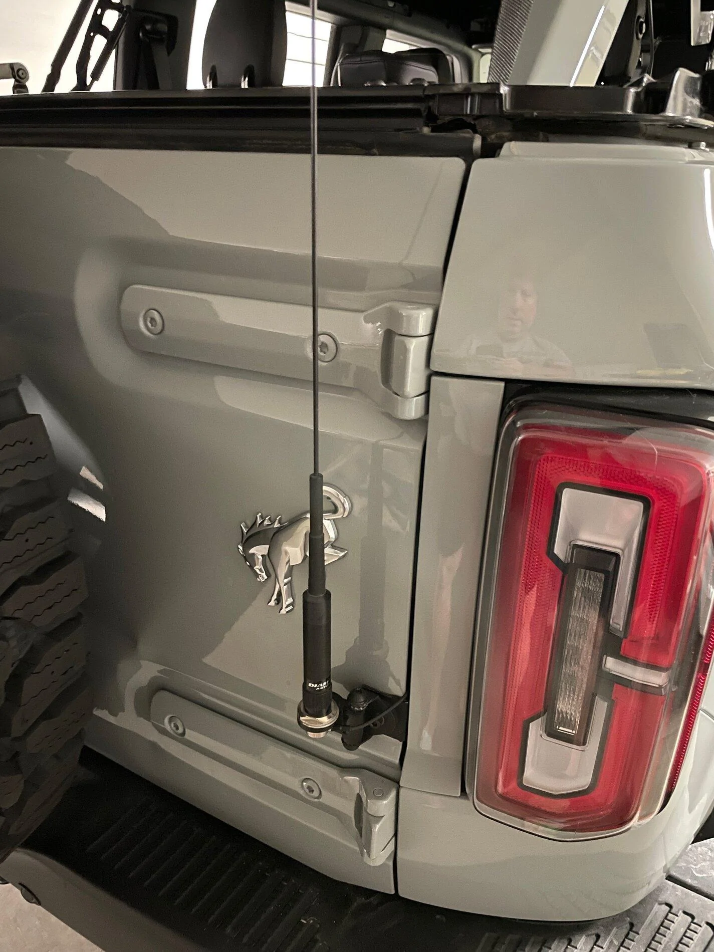

I'm not sure what the permanent situation will be, but for now, I am working with this a trunk lip mount. I'm leaning toward running the feedline through one of the grommets under the floor, then following the frame to the front and mounting to the hood for long-term.
I have a trip next week and I was tired of using a HT for mobile comms.
Also, I'm going to have to remove this when it goes into the body shop to fix the transit damage, so wanted something temporary.
Do these lip mounts cause and paint damage or marks if were to remove?
They have rubber backing on the outside part and a metal plate on the inside part, so generally, no, but if you're worried about it, there are other options. :cool:

Did you mount this against the body or on the outside of the spare tire mount? I put it on the outside, just removing two bolts and mounting so it's not against the paint, but it pressed against the spare tire like that. Really didn't want it flat against the paint on tailgate. Maybe do the wheel spacer like someone else did on one..
