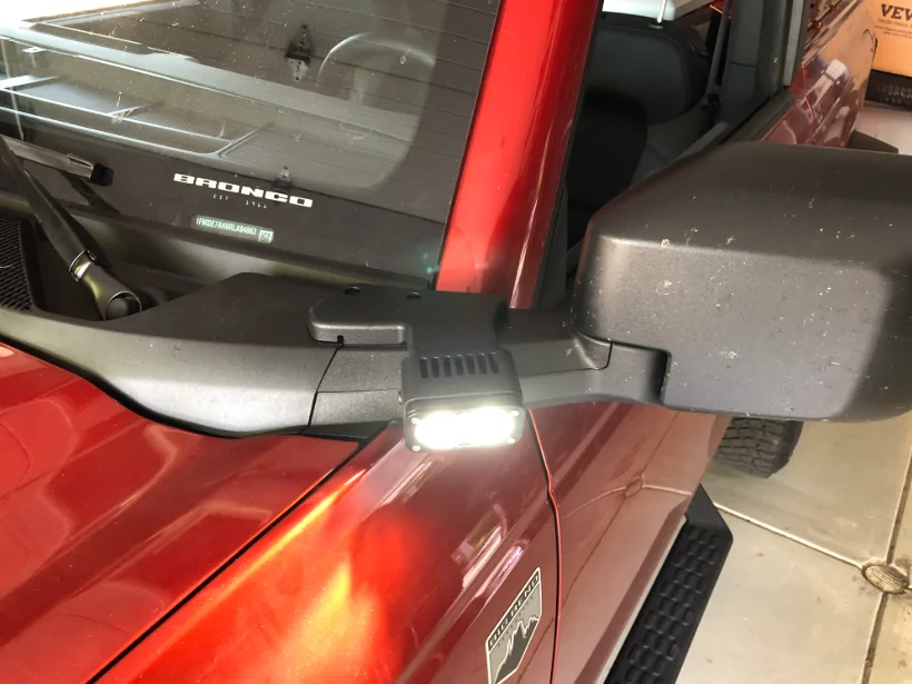

I know you asked about bigger options but don’t leave smaller options out of the equation. I’ve used my flex era 3’s up there and the difference wasn’t worth the wind noise to me.
The flex era 1’s provide plenty of spill lighting. Especially when used with my bumper lights.

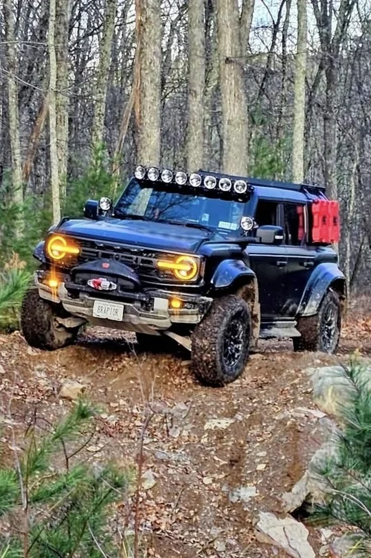

I decided to install 6” KC’s as an iconic ditch light and really like them.

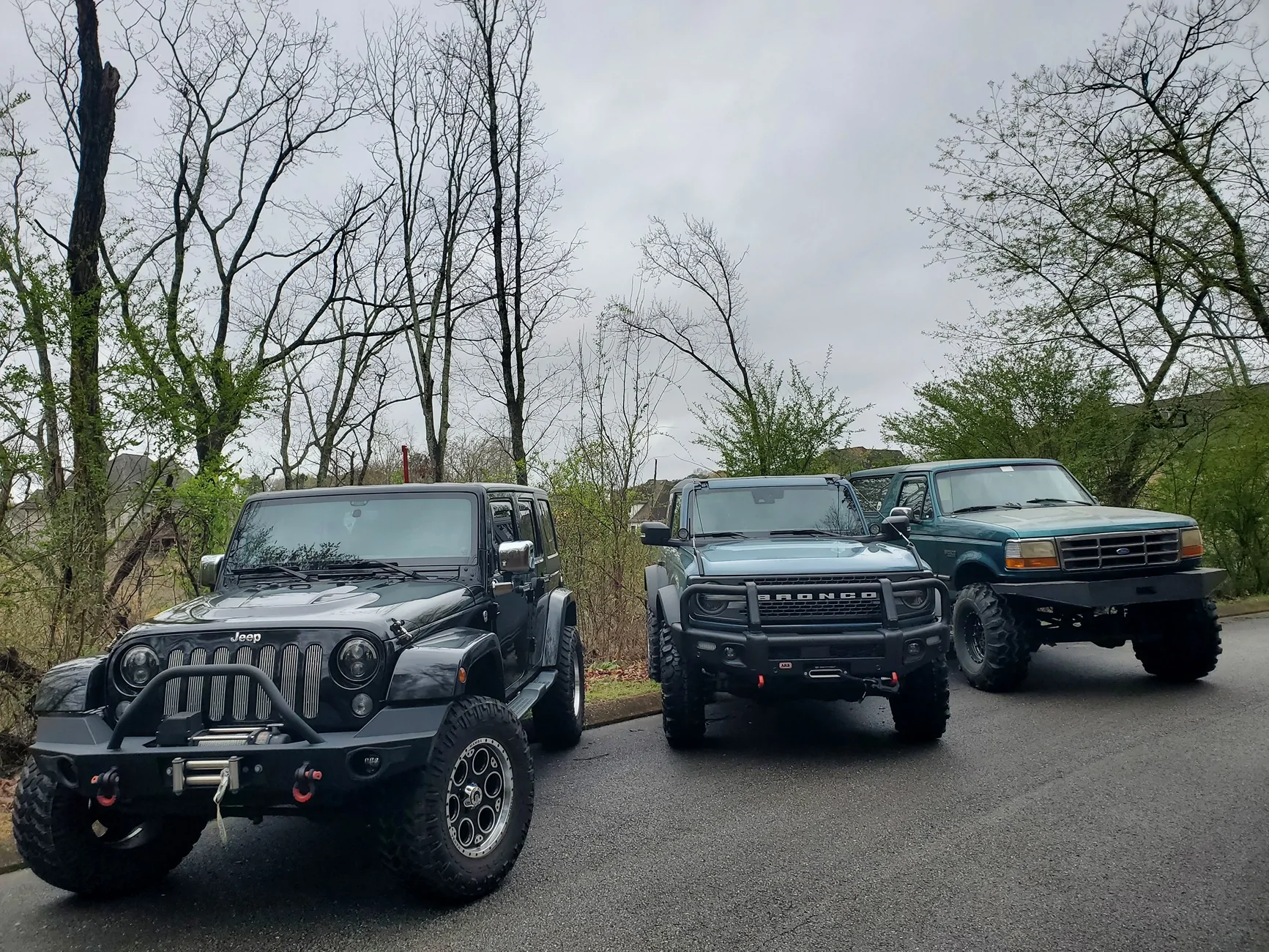

No good picture of my ebay cheapies that are excellent. You'll have to zoom in to see them. (it's the one in the middle:ROFLMAO:)

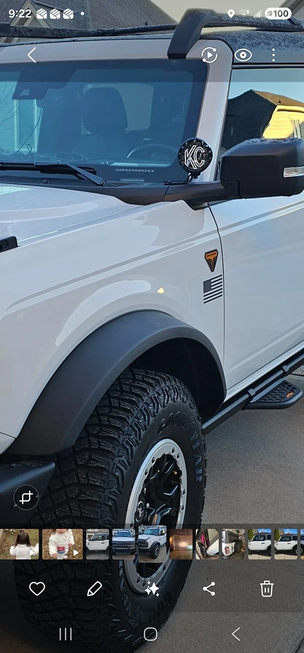

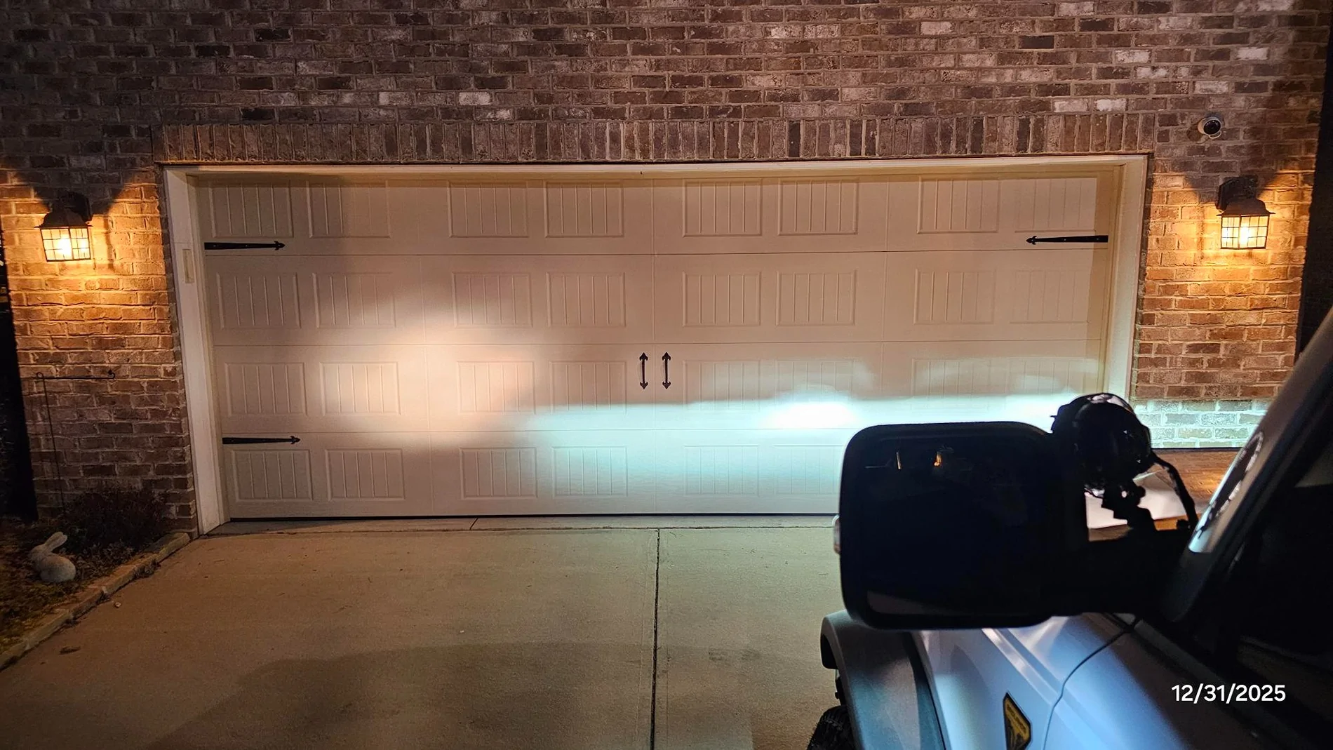

I got the 4" KC halogen for the old school look - not impressed and wouldn't do it again, but I do like the look with the white logo on my white Badlands.

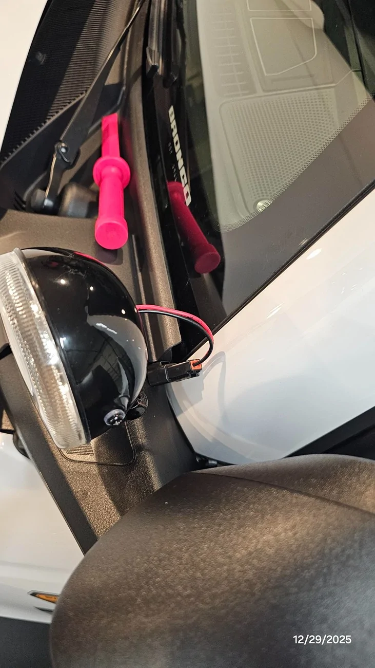

Their leads aren't covered (you see red and black individual wires), the leads are only 8" long so they either stick outside by the light (and in a funny way) or you have to splice yourself (I did) and use heat-shrink. Also, the underhood wiring harness provided is about 18" too short for the bronco between the two lights, so you have to splice that too. I hooked them to separate aux switches to have more flexibility (looking right but not blinding another car). The lights are old school soft yellow and factory-direct they sent spots instead of what I ordered, but I couldn't tell that from the packaging and only after I turned them on when the job was done.
I called and they said they could have provided me an extension for the wiring harness (I selected Bronco when purchasing), they said, "Yeah, the leads are short and old school," and they just offered me 10% off LIST price on another product, which was more expensive than just buying from normal resellers. Since I had spliced the lights they wouldn't take an exchange. I questioned, "Seriously, only 10%? I can buy them from 5 of your authorized online resellers for less than that," and they just said it's what they could offer. I wouldn't do business with them again for the hassle and service. I have some Oculus for the modular bumper fogs.
Lights themselves are quality.
I did get the bronco ditch mount accessories, and they are perfect and very solid. You might order just those and get a different light.
You are right, those white logos look really good with your Bronco. But yeah seems like a hassle with the wiring issues.
