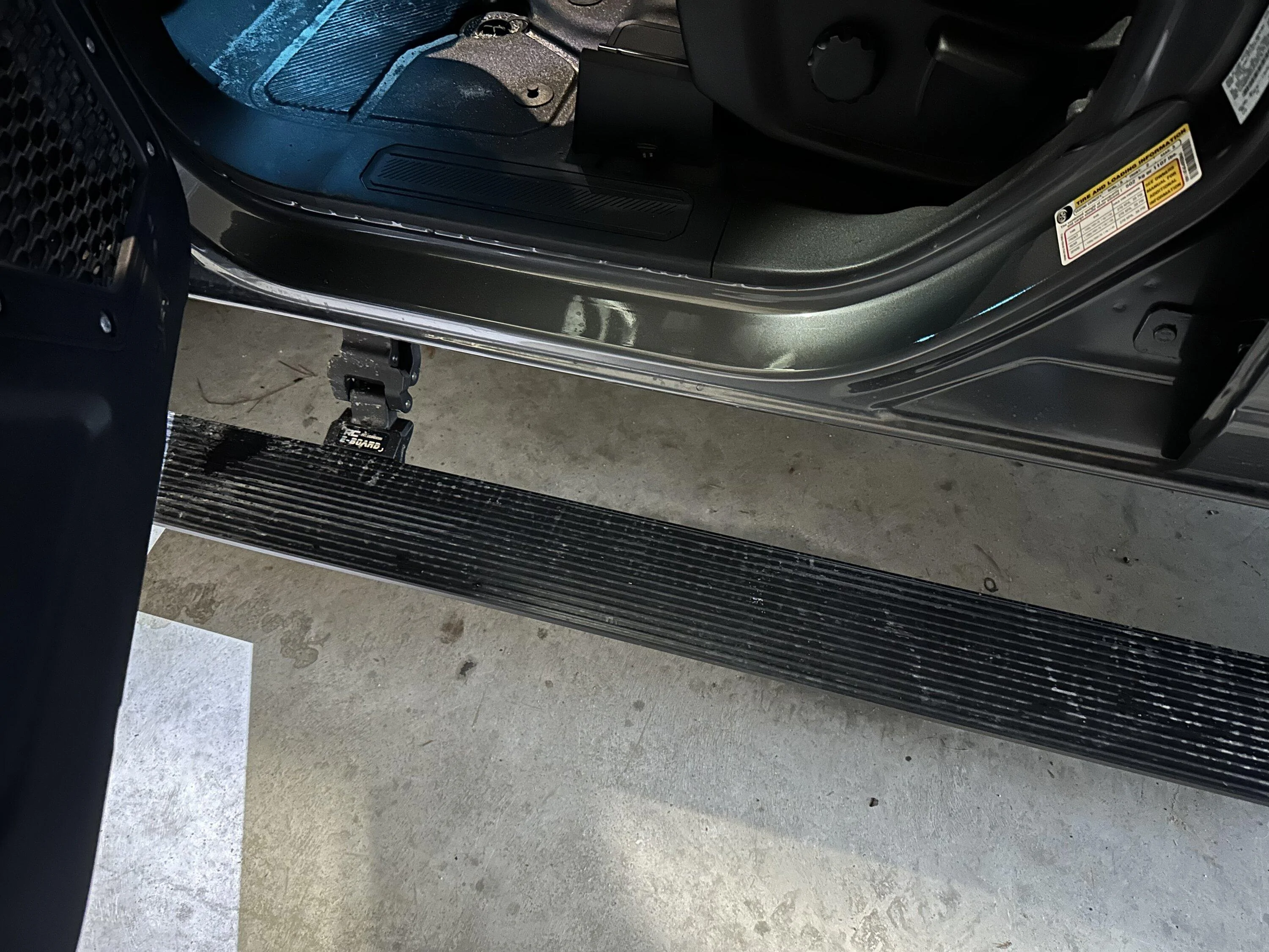

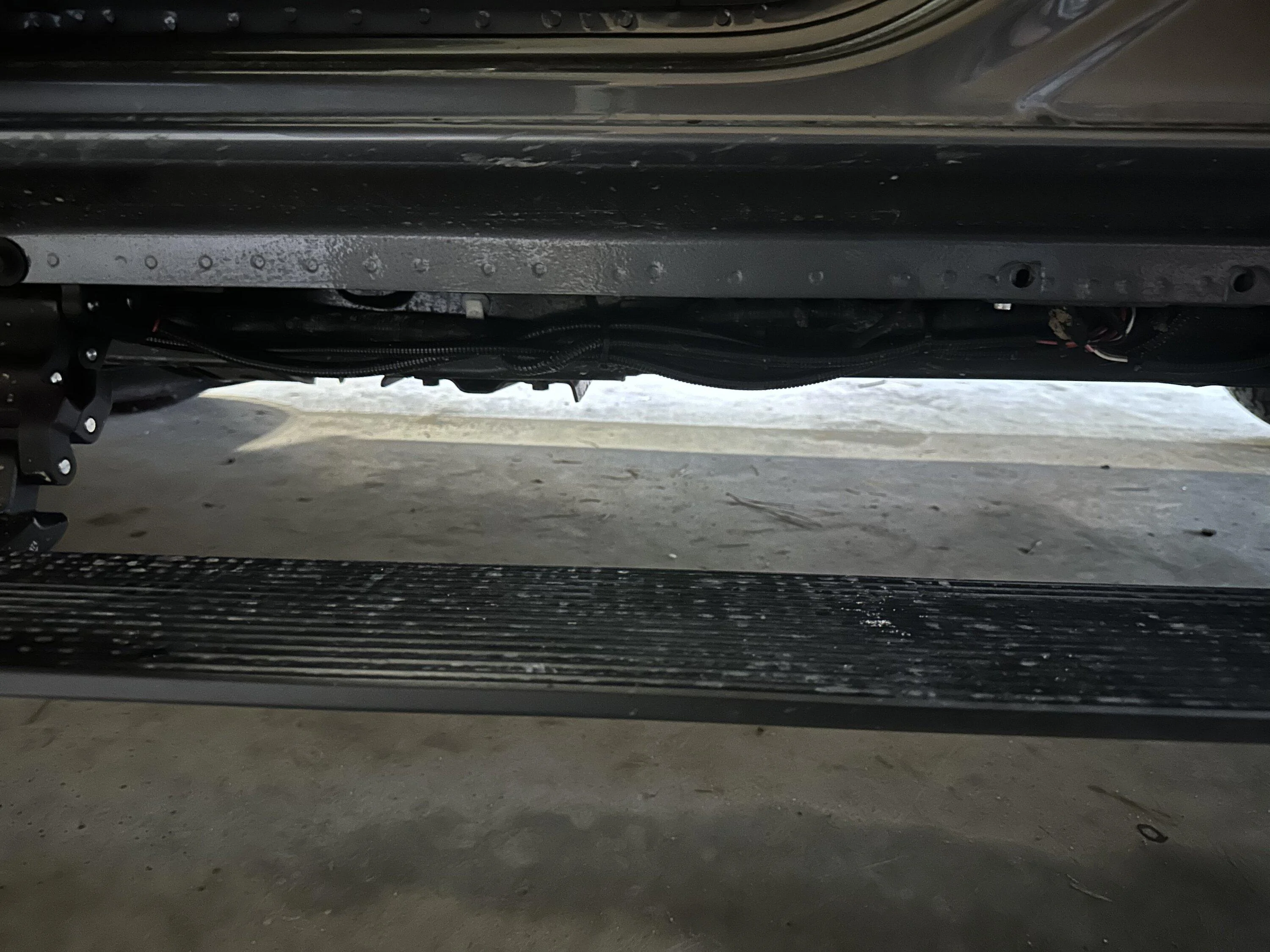

Any chance you can measure from the top of the deployed running board to the door sill and take a pic? I am curious how much they open and how tall the step in is.
8.5” drop & 7” extension.
Thank you. That's extremely helpful. Couldn't find that anywhere else.
I bought some cheap fixed running boards when we first got our truck. My wife deemed them "more than useless". She wants something much wider with much more drop. This will definitely make her happy without looking like a bulky hot mess.
