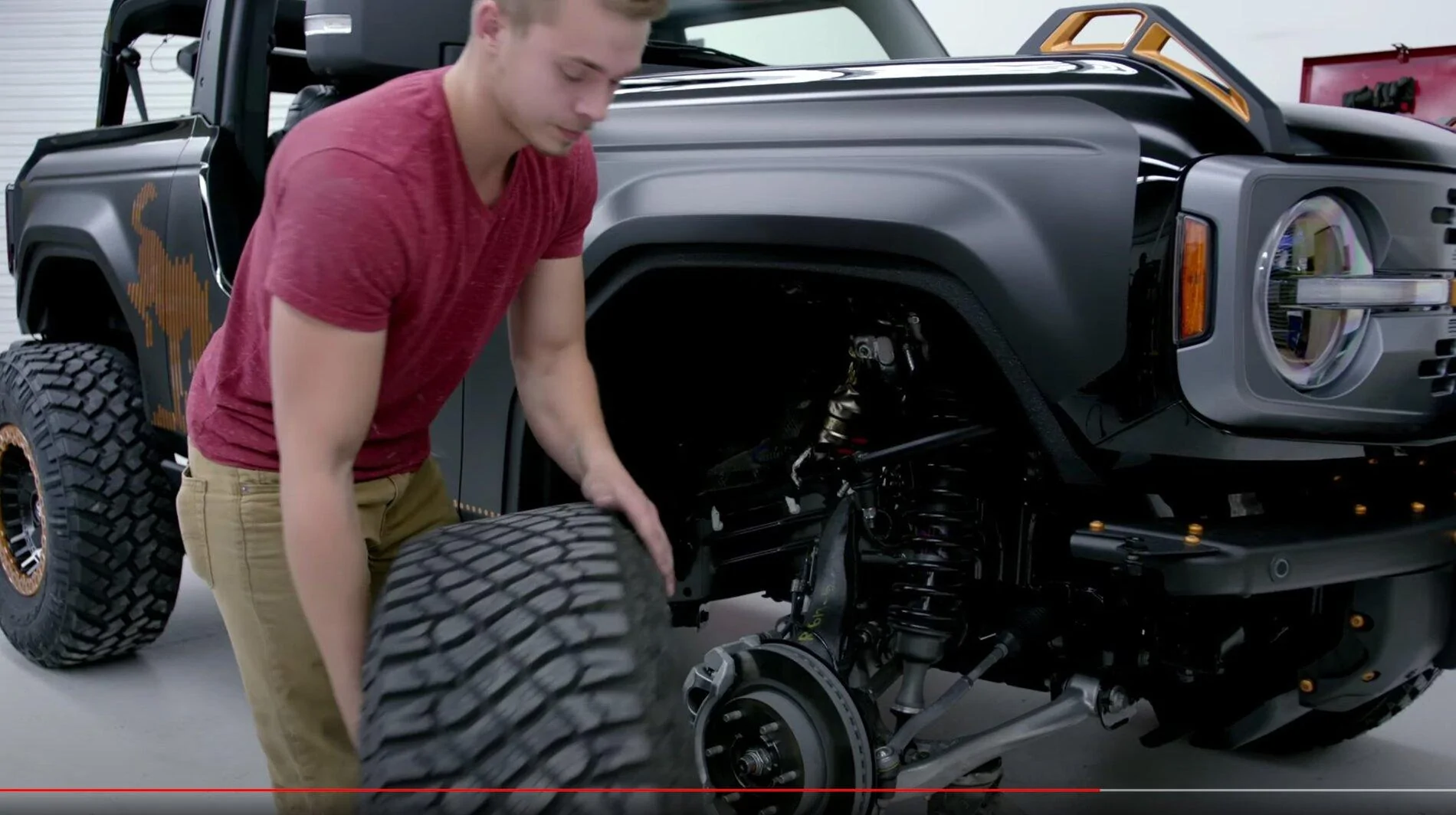

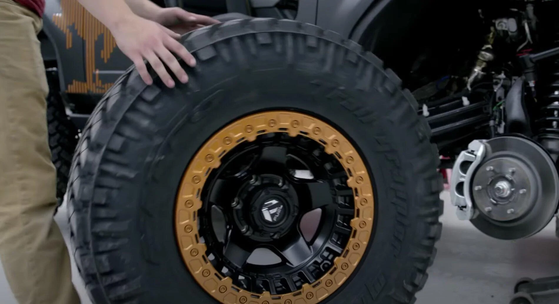

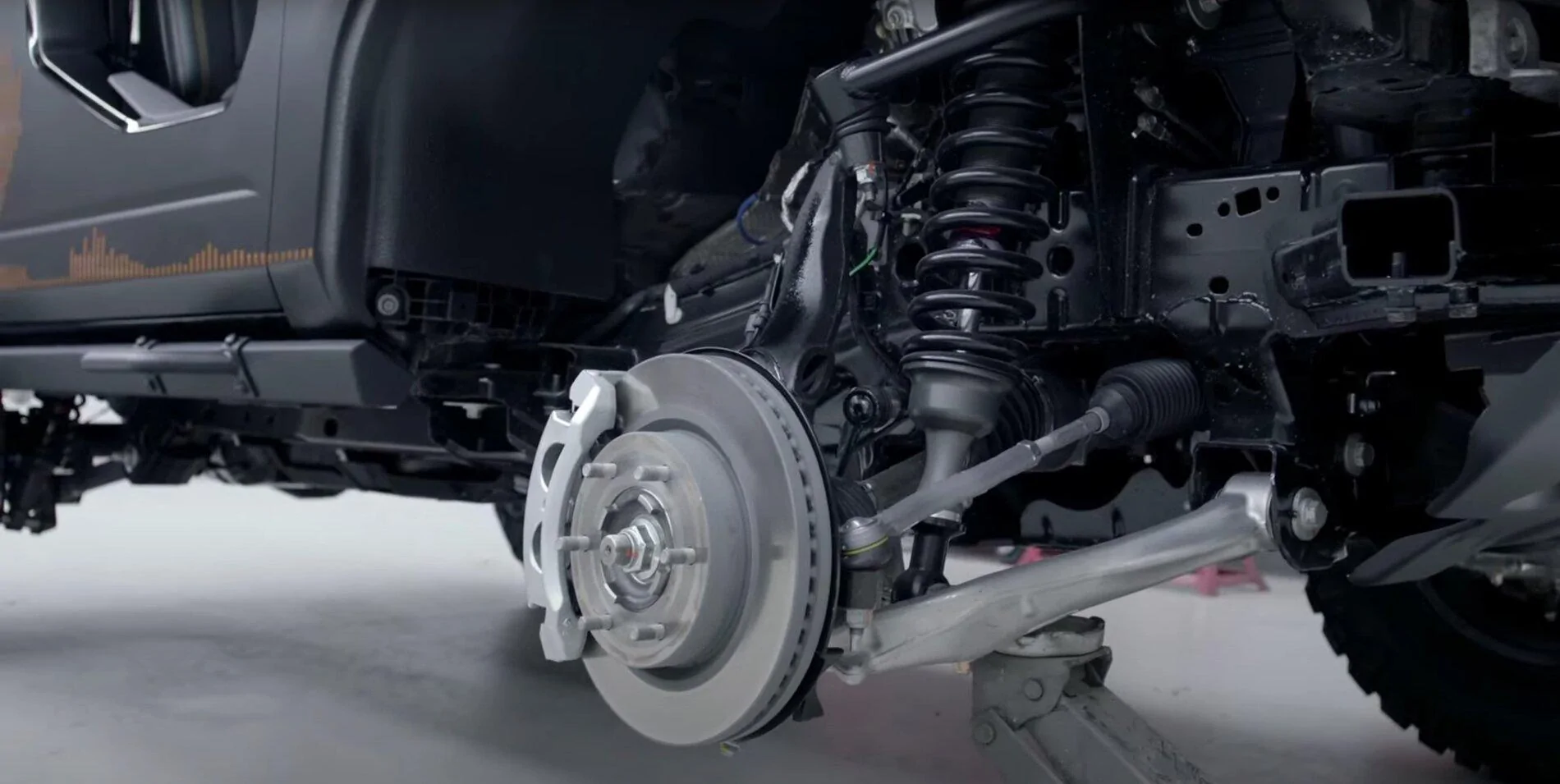

1. Best 60-0 braking distance is mostly tire limited. As long as your brakes can lock up the wheels, you're braking power is maxed out. Brake fade and it its ability to shed heat is a whole other discussion.
2. Largest diameter discs are wheel limited. With the largest wheel being 17", rotor disc diameter isn't going to be great. On the bright side, besides diameter, the disc thickness also counts. The Bronco seems to have very thick discs (at least on the upper trims).
3. From the posted pictures, it looks like the front calipers have 2 pistons each, clamping very large pads (i.e., large surface area). Good friction, good heat soak ability, possible good heat shedding ability from the larger vent vanes.
I myself am not going to worry about the Bronco's braking. This is not a track car.

Single Part Number for all models? Doesn't look heavy duty to me.
Photo Credit Bronco6G YouTube
