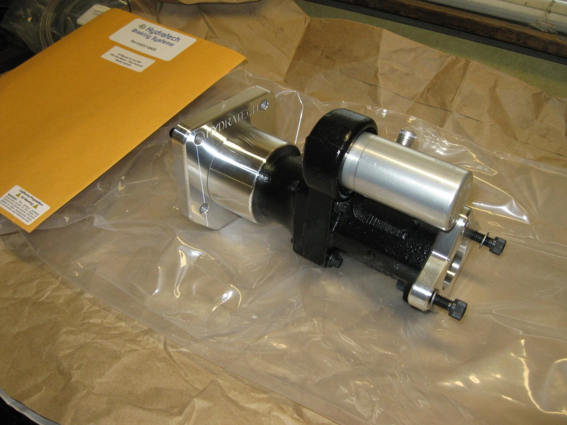

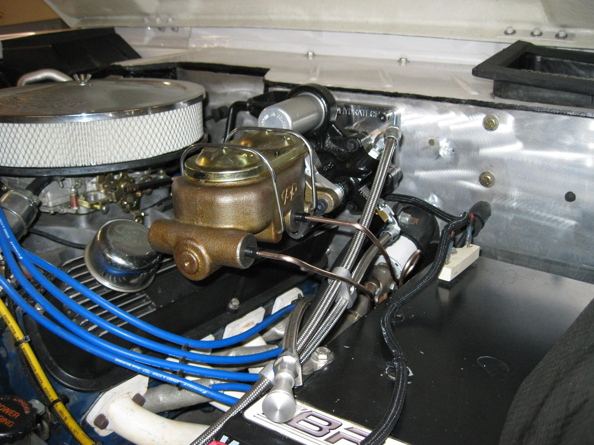

I went down the "better brakes" rabbit hole on my 74' w/76-77 front axle. I tried different master cylinders, vacuum boosters and calipers. Vacuum booster helped but the one thing that made a REAL difference running 33" tires on a vehicle designed for 28" tires was Hydoboost. This is where the brake booster uses the power steering pump to power the brakes.
It will now stop on a dime and give you change even with mid 1970's rotors and calipers!
