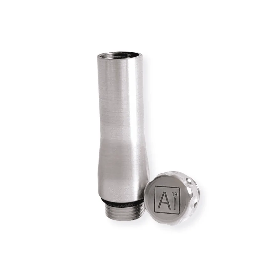

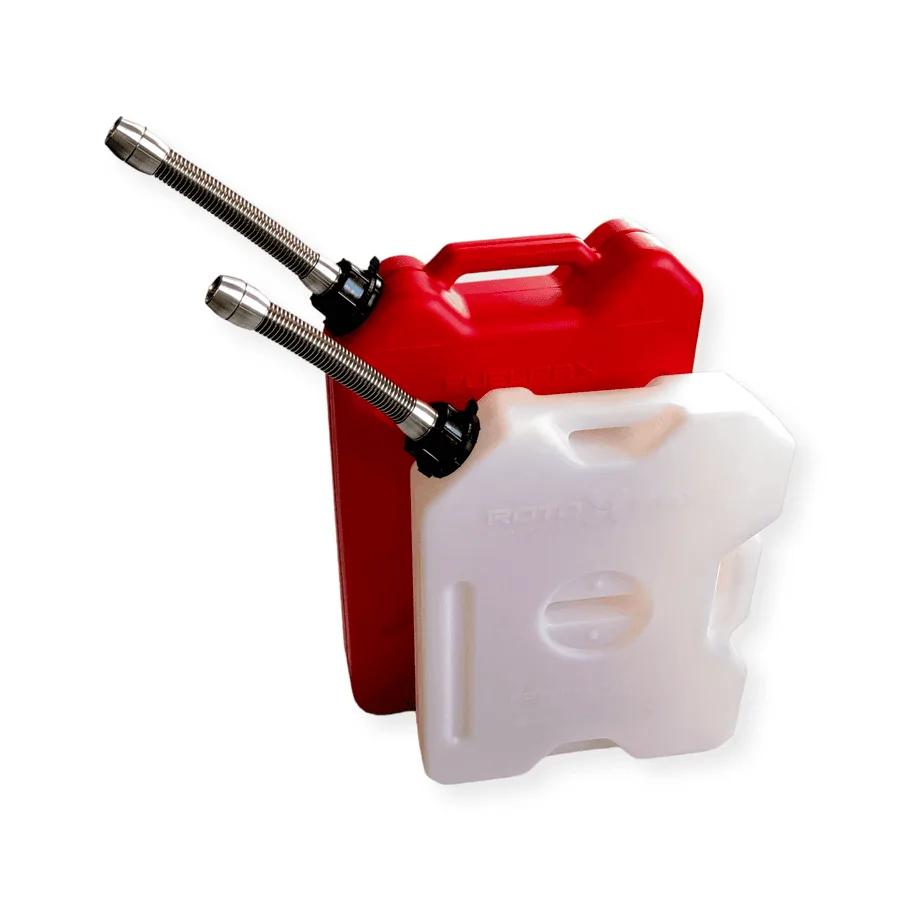

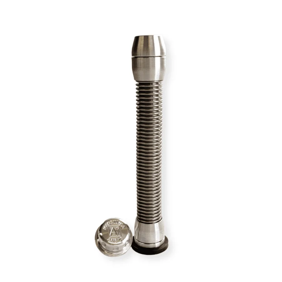

Just received their all metal nozzle for rotopax and the spout adapter for cap less fuel fillers.
Ford Bronco ROTOPAX Filler Nozzle PhotoRoom-20230104_160102_900x
Not sure how well it will work without a vent, but it looks very promising.

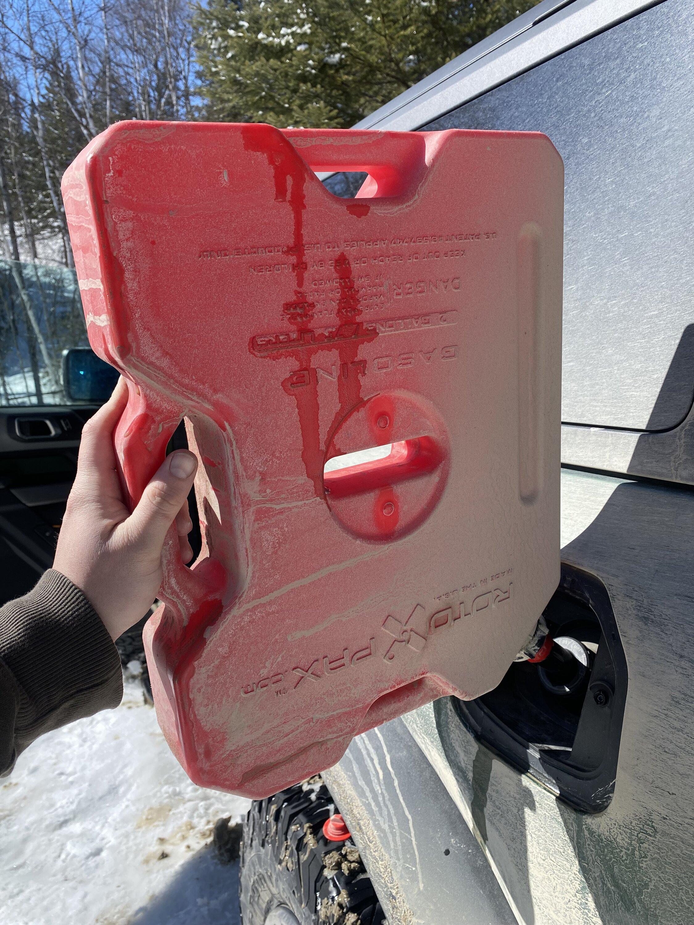

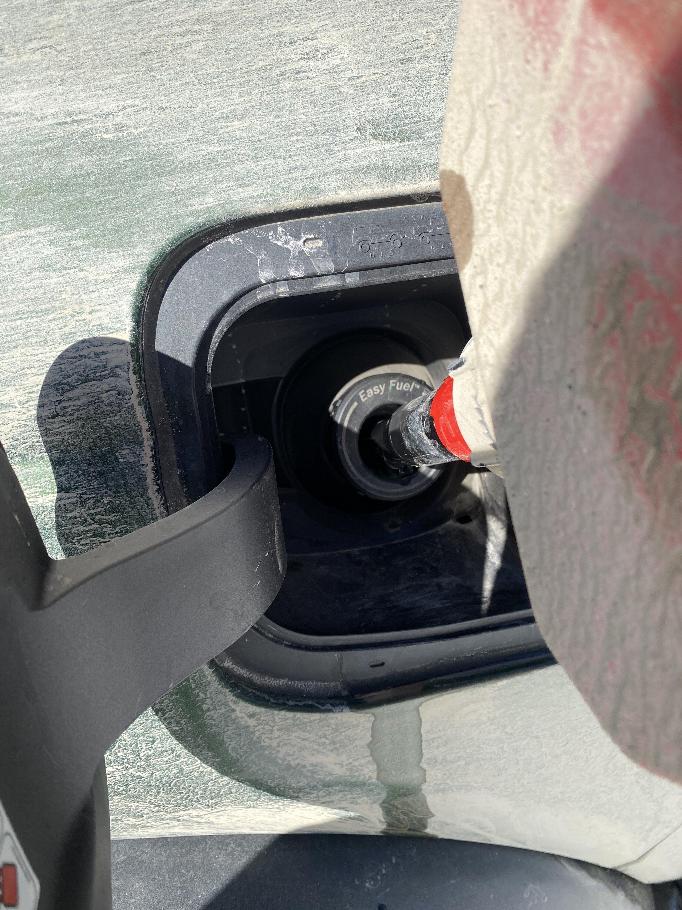

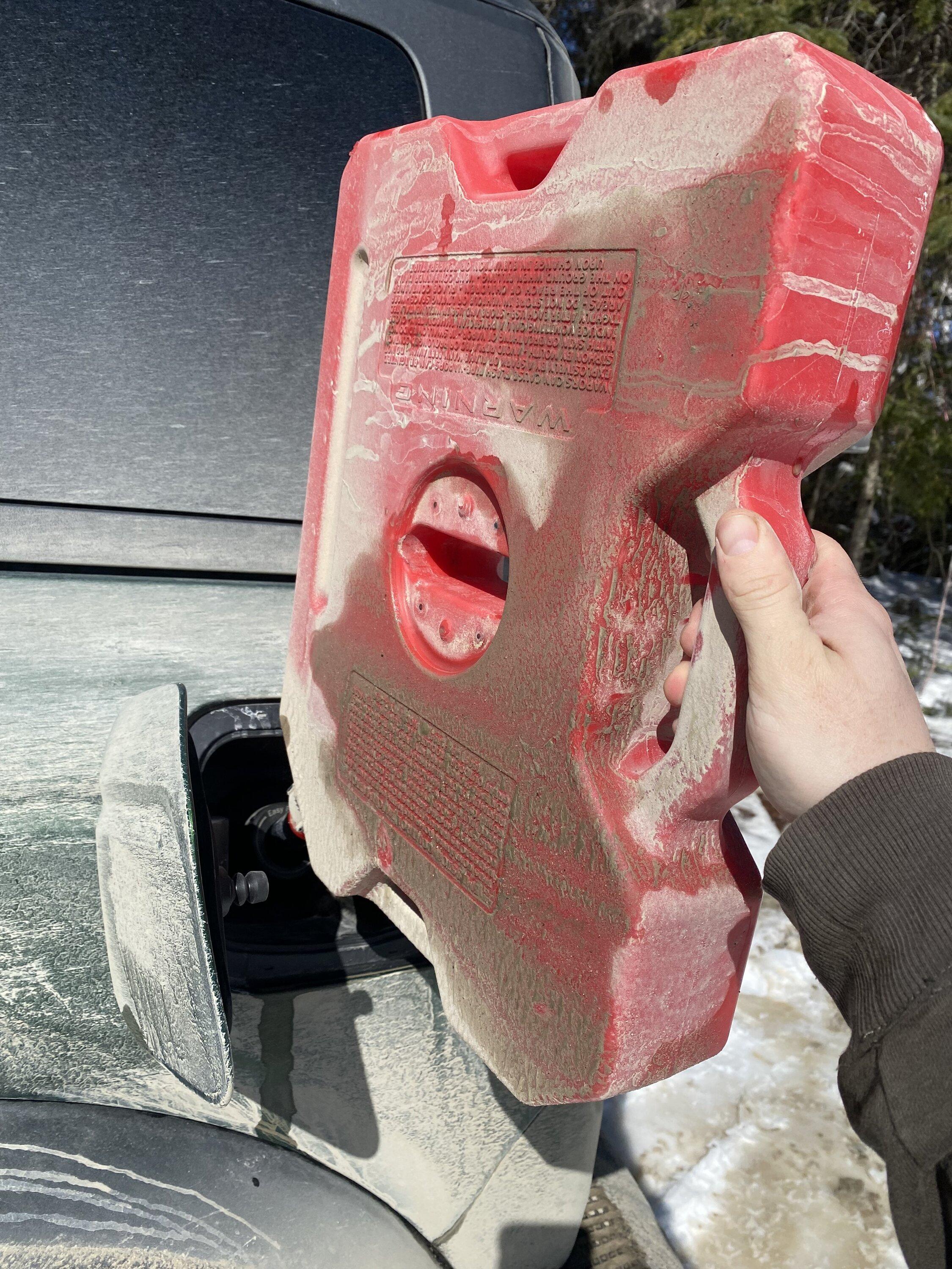

Set the nozzle with the tab up. Flip the pax over for prep for fitment. It takes a bit of angle massaging to get nozzle in through the second flap. But once it’s in, it’s very easy to pop the locking ring and let er flow. That tab should align with the divot at the bottom of the ez fill capless flap. Sometimes it needs the slightest of shakes to exit.

I used the same combo on my rotopax on my pony express trip and it worked perfectly.
