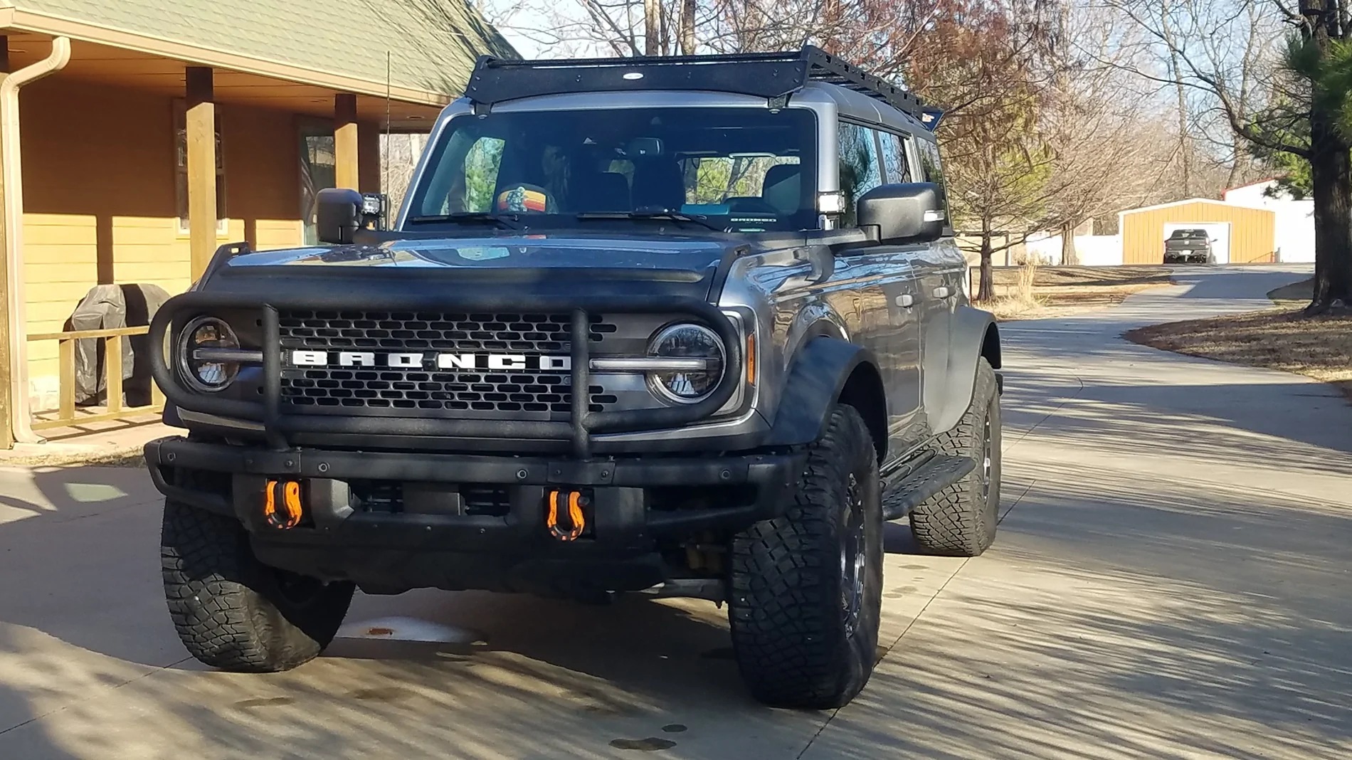

Installing a Hooke Rd 4d rack soon, and will be using a cargo bag and MTM hard cases to travel cross country, via highway. What kind of lessons learned and best tie down options/sys are out there? With the Bronco, I'd rather not use the hitch tray option due to the swing out tailgate with the 35. That option has been great for our Durango in the past. So.......we are goin up top! Klick klick pull!

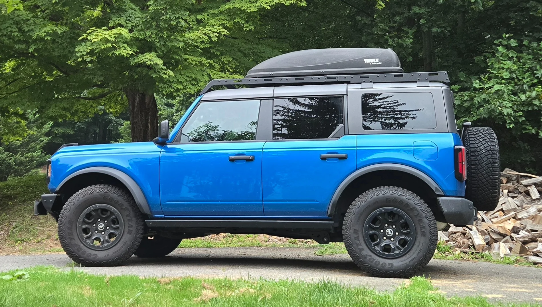

I use my Thule Cascade on my Hooke Road rack. The box is solid so I don't bother with ratchet straps on it. If you do, make sure you put a twist in the strap (look up a YouTube video) to prevent the straps from flapping and driving you insane. I learned that lesson the hard way many years ago.
The Thule dips low in the front, so I simply remove the 2nd bar of the rack to make space for it when I have the box mounted. Technically, you can remove the front bar and scooch the rack forward if you wanted to strap a bag/bin/storage box behind it. You'd likely have the room.
Be careful with how tightly you ratchet strap things to the rack. Some guys have talked about the possibility of over-tightening and damaging the rack and or the roof.

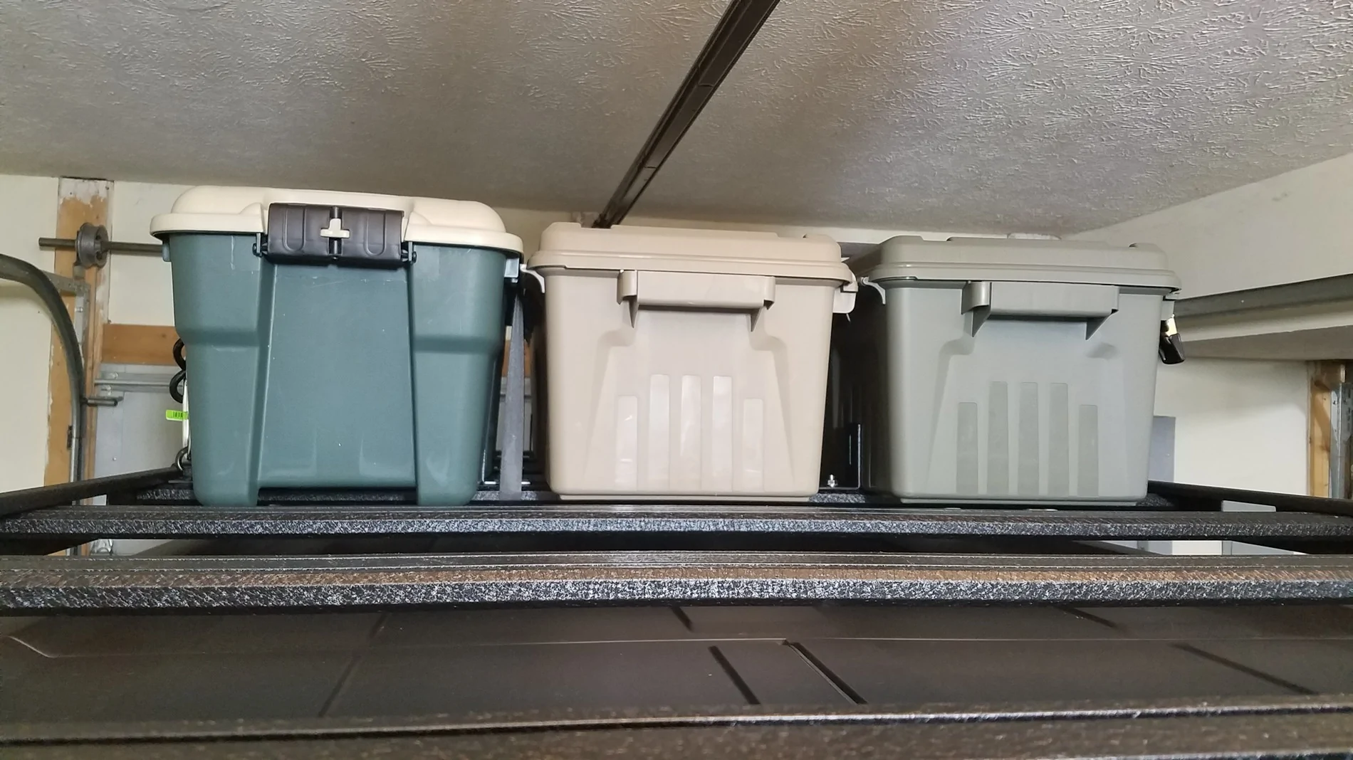

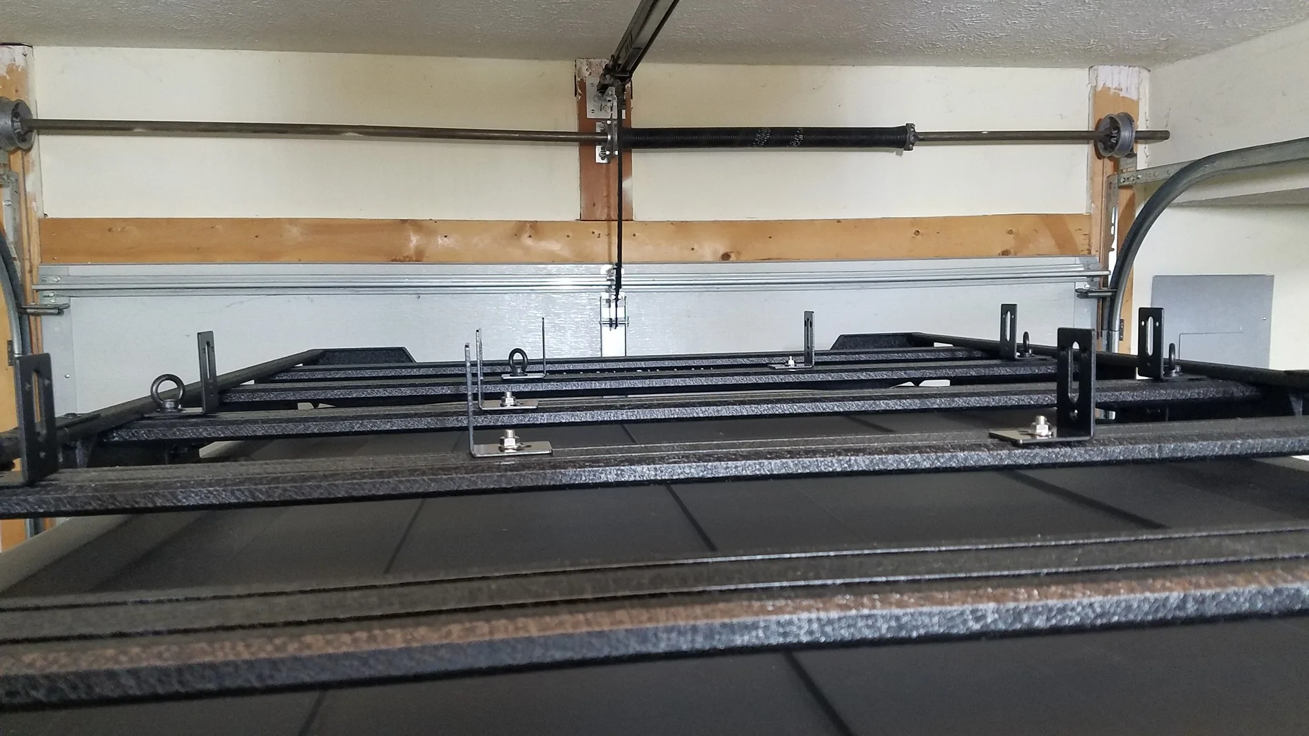

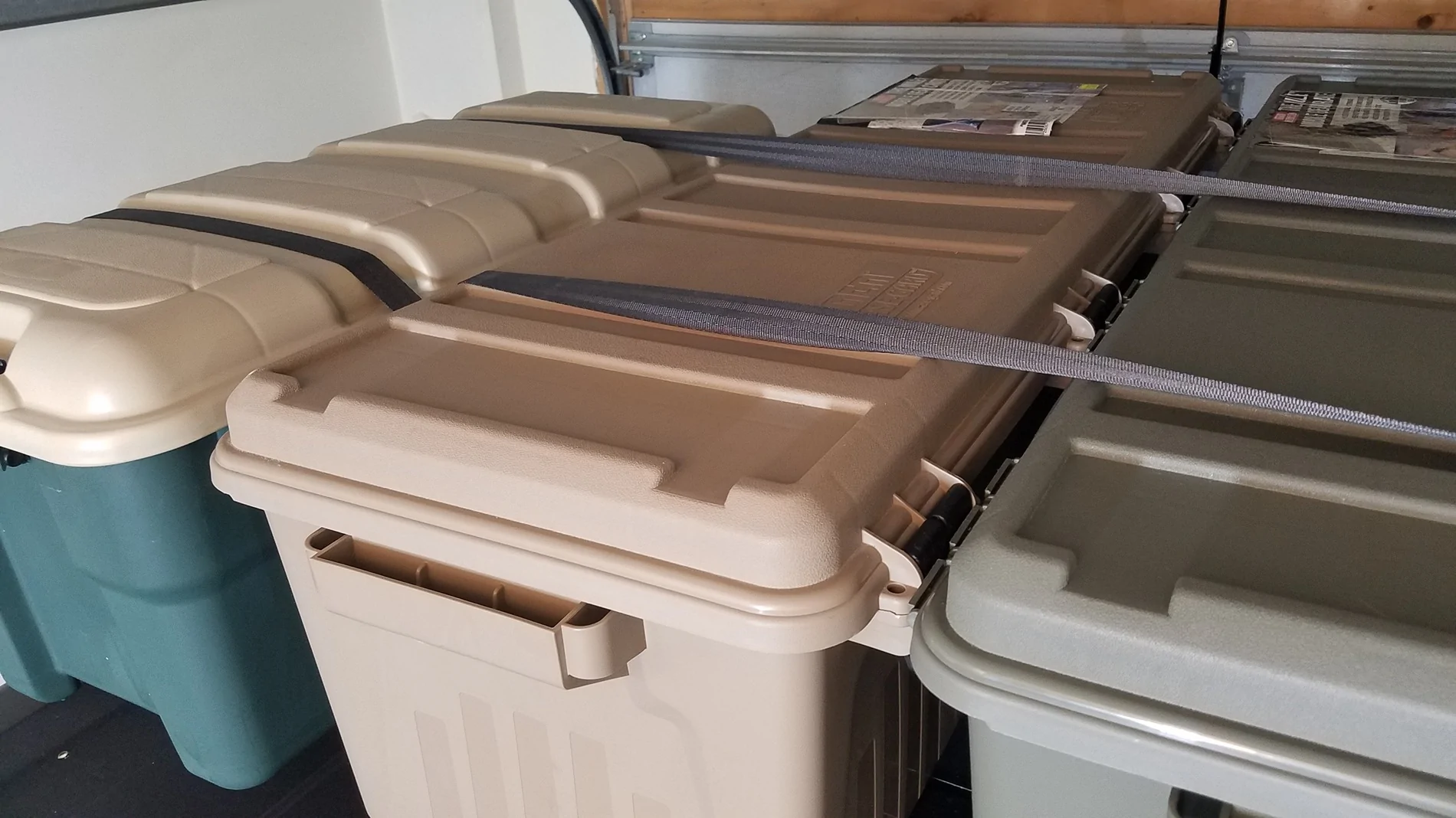

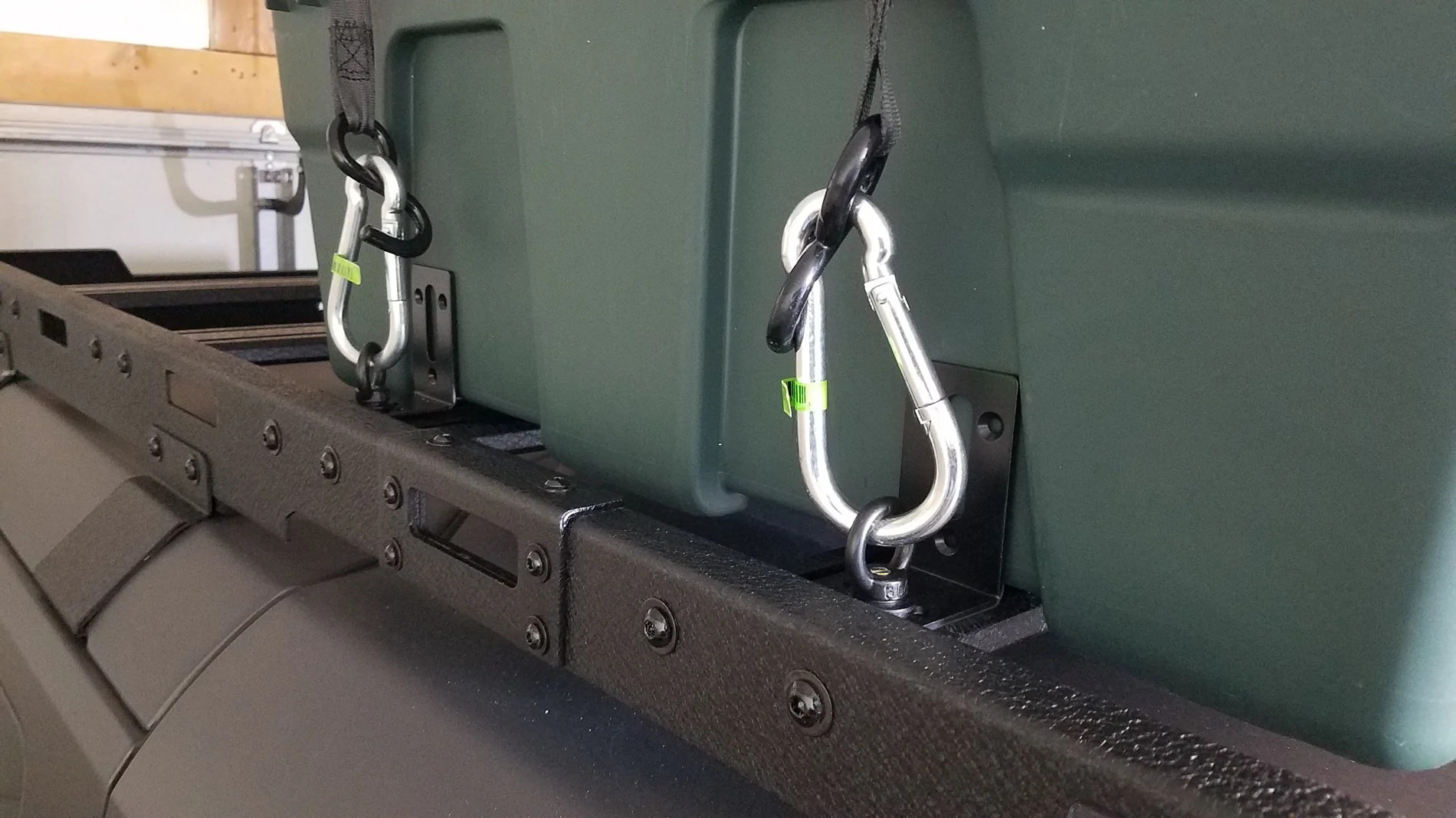

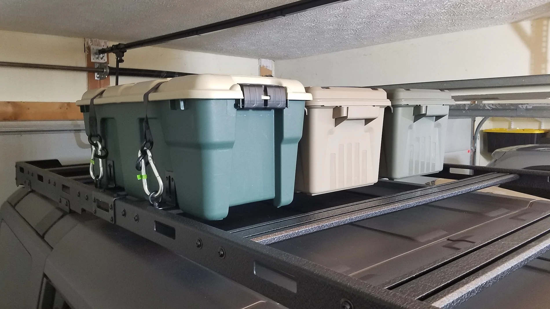

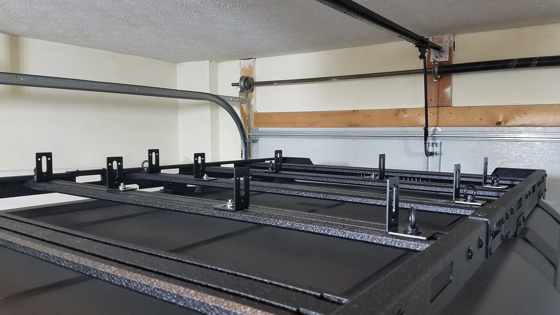

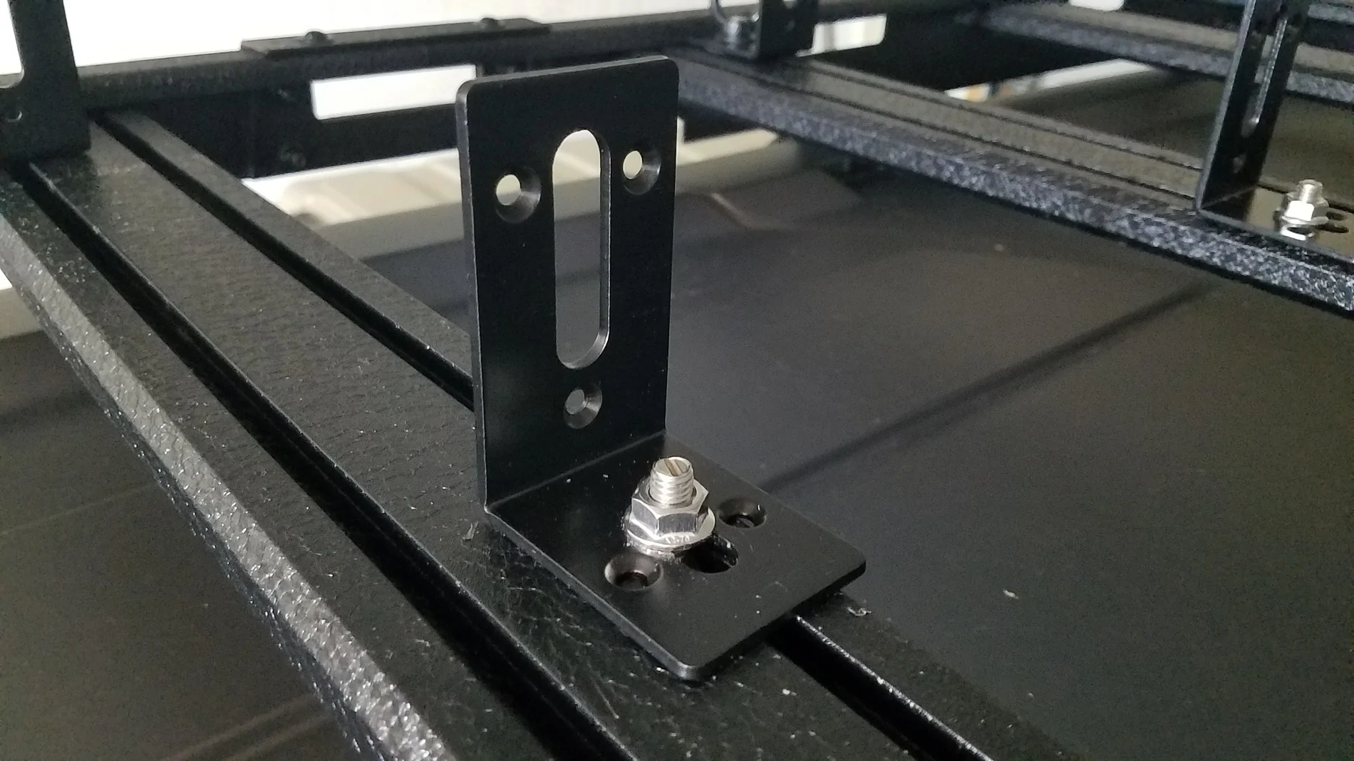

//UPDATE//

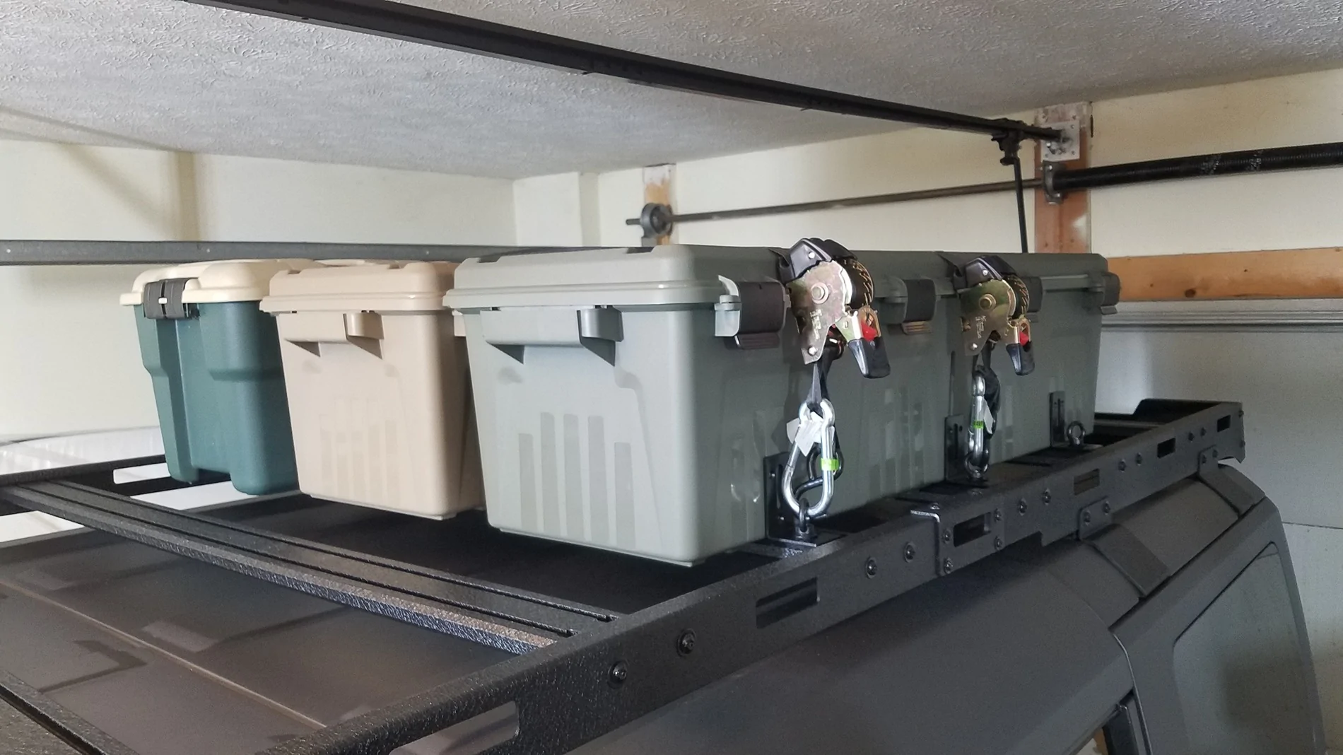

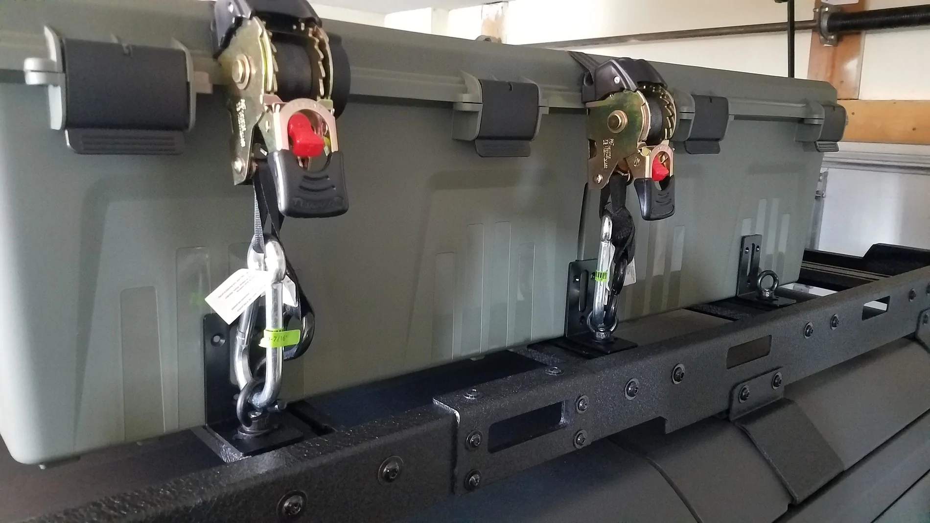

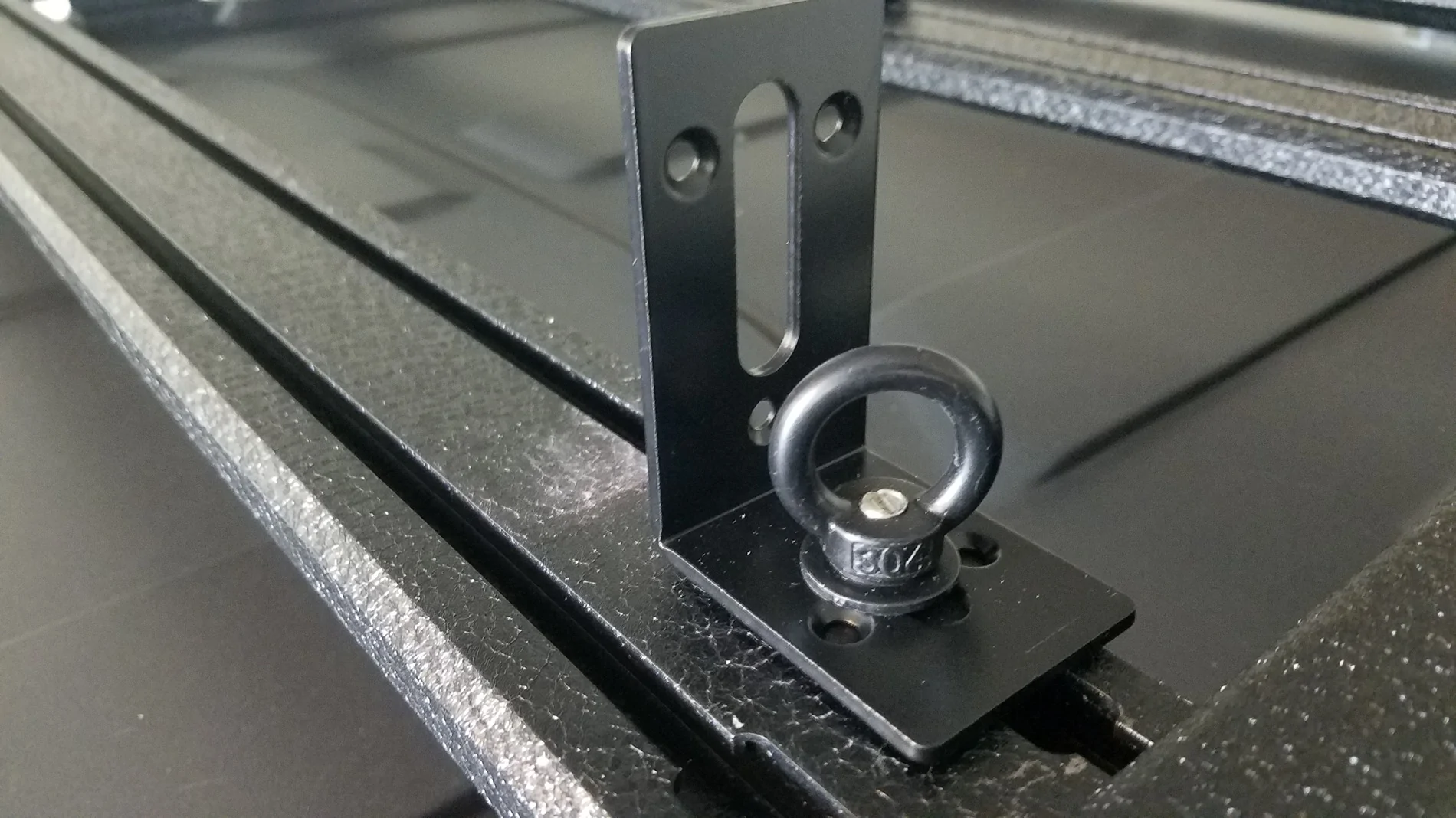

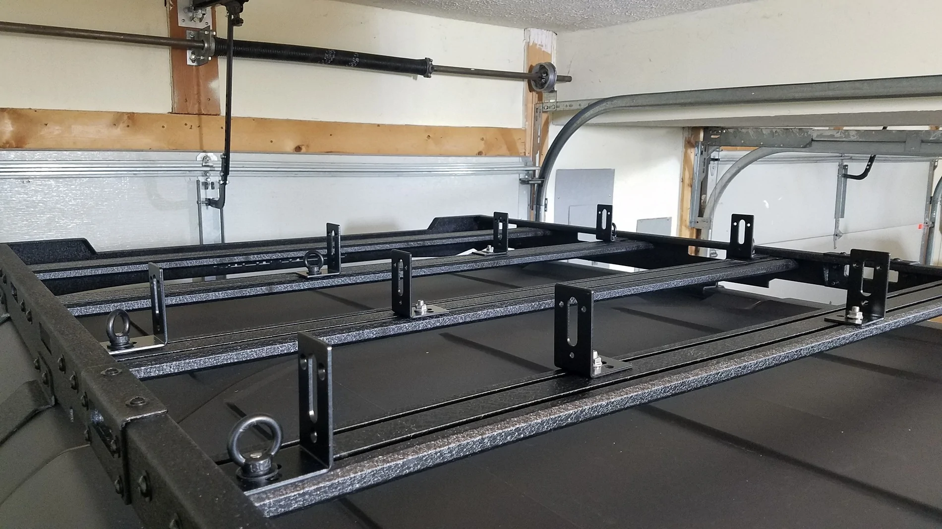

Thank you for all the suggestions and I finally put together a cost efficient and somewhat effective way to utilize inexpensive MTM hard cases and tie downs with the Hooke Road roof rack.
I am keeping the @not on the rug suggestion for the future. I know, I did get a set of 4 retractable straps, not Rhino, which I WILL get in the near future. I used brackets and a combination of two M8 eyelets kits to make this happen.
https://www.amazon.com/dp/B0CG9ZCFWC?ref=ppx_yo2ov_dt_b_fed_asin_title
https://www.amazon.com/dp/B0B3D9MG3L?ref=ppx_yo2ov_dt_b_fed_asin_title
https://www.amazon.com/dp/B0CZMQPYSL?ref=ppx_yo2ov_dt_b_fed_asin_title
https://www.amazon.com/dp/B0C1DHC3PN?ref=ppx_yo2ov_dt_b_fed_asin_title
I used the brackets to secure any lateral movement to negate the boxes from sliding inward, due to smaller base compared to the lids for clearance. This ensure no movement/role allowing the straps to loosen.
