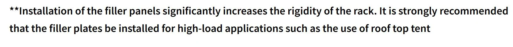

I don't know anything about the RCI rack in particular, but this is pretty prominently placed on their web site for the rack. Dunno if it would make a difference or not, but sounds like you just got too much lateral load for a long piece of railing there.
Ford Bronco Roof Rack Keeps Failing 1743260830428-mh
I don't see "Filler plates" as an acessory for that rack, or "Freedom Panel" - just the "extrusion stiffener", which may do what you want, I don't know
https://rcimetalworks.com/product/roof-rack-extrusion-stiffener/
I'd say it's worth another call into them, see what they recommend first, before you just potentially throw the baby out with the bath water.
Thank you for responding. Good advice, and I will call them to see what they stay, but this recent fails is AFTER having the filler panels installed. If they offer a NEW solution, that would be promising, but my concern is they offer a replacement rail with filler, this will become Charlie Brown trying to kick the football Lucy is holding for him.
