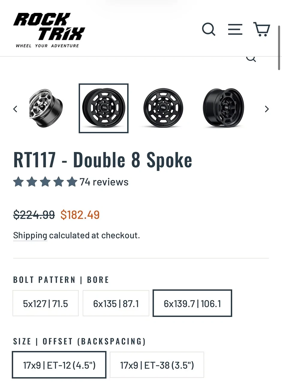

Here a lot of time later. Getting ready to order these and noticed amazon says they wont fit the bronco? Obviously based on this thread, thats not the case. Is it just the hub bore that is making amazon say this? Or were there other mods that had to be done to get these to fit?

These are the ones I ordered, and the same sizing. No issues here.

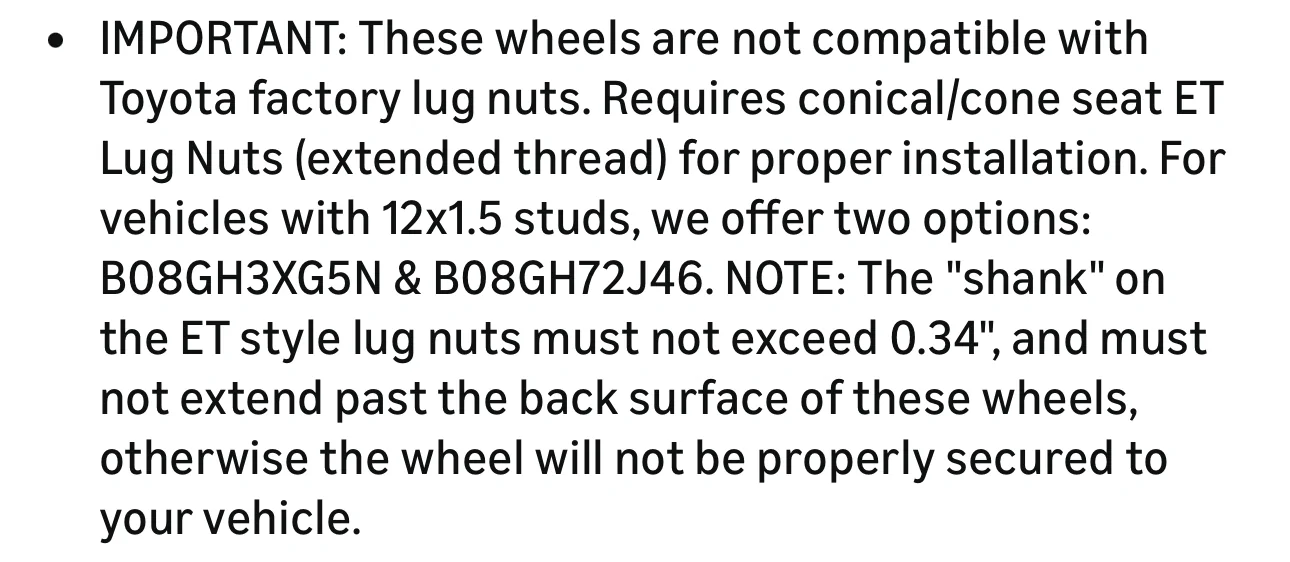

Appreciate the info. I ended up ordering some 93.1 ID to 106.1 OD hub rings to make sure they mount up nicely with the hub. Might not be necessary, but would rather have a clean mount to the hub. My only other question for you is did you have to get extended thread lug nuts to make these work? Im reading the description and it says they are needed for vehicles with 12x1.5 factory lugs, which is what the bronco’s got. (Pic below from amazon description for reference)

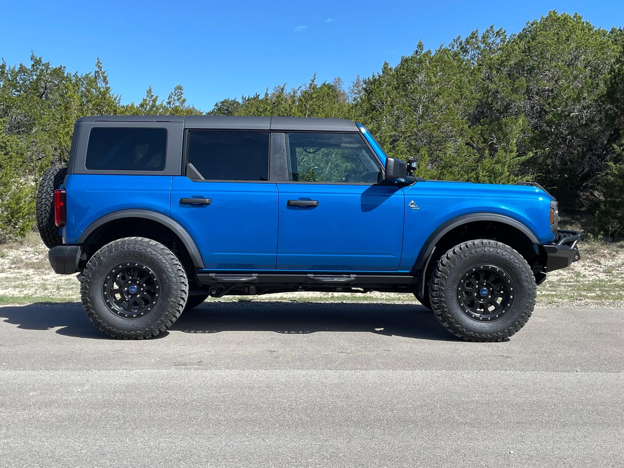

I used all of the factory parts. I didn’t need anything else. But, maybe it differs if you have the Sasquatch package?
I didn’t buy anything else.
Everything fit.

Awesome. I dont have the sas package, just find it odd that they call for all these different items needed for fitment. Weird, but sounds like I’ll just be reusing the oem lug nuts. Thanks again for the help! Sweet rig👍

No problem!
I think it might just be a flaw within the Amazon site.
