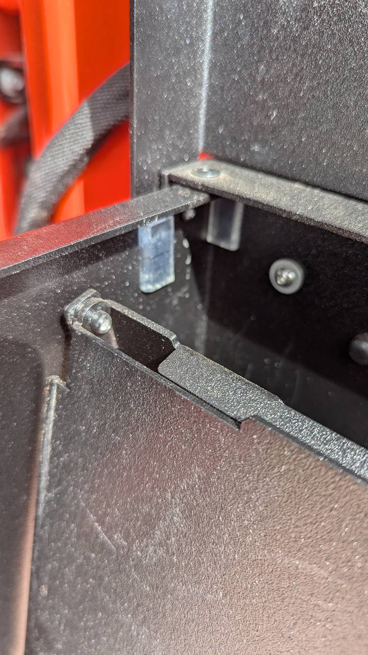

It fits. Here is mine. I mounted with rivnuts, way better than sheet metal screws.
https://bronco6g.com/forum/threads/swamps-code-orange-bronco-raptor-build.86194/page-4#post-2215306
Here is how to make it quiet, as it isn't, or at least isn't after a single hard wheeling trip.
These are clear bumpers, approx. 3/16" thick from the Home Depot, 2 per side. This arrangement stops the rattles both fore-aft and side to side. You'll thank me later :wink:.

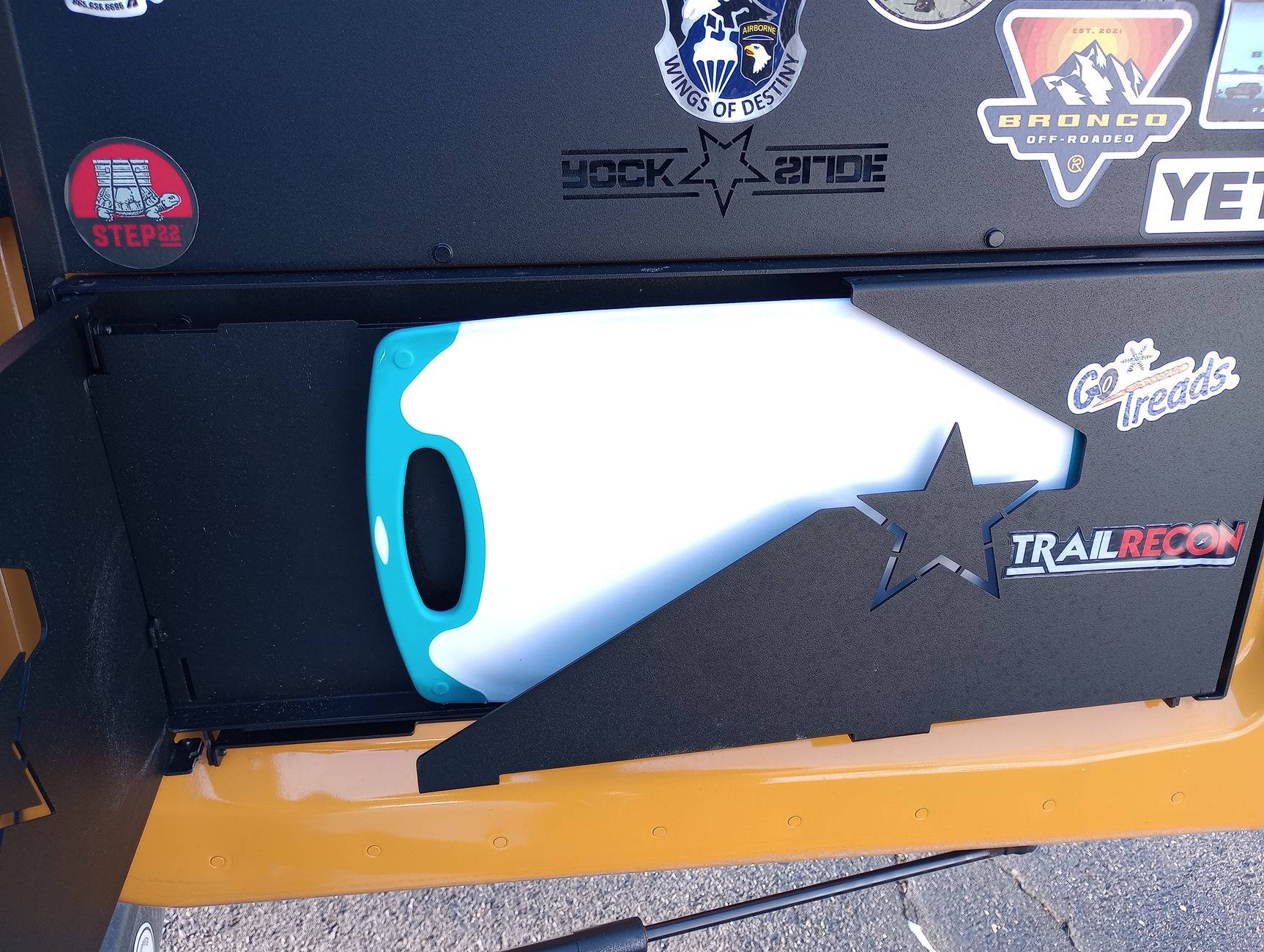

I love my table and agree that it can develop a rattle if the bumpers aren't in place. I added a thin full size cutting board when putting away the table, no more rattles.
FWIW, my experience was different. The table was quiet until just after 1-2 good wheeling trips and then, with all of the factory bumpers in place, became annoyingly rattle.
Rock Slide Engineering definitely has a design flaw. Unfortunately as customers we have to reengineer their mistake so that it works for us. I still like my table, and I took my savings over buying a more expensive table to the bank. I'm sure that you'll figure out what works for you to stop the rattle. I know that we shouldn't have to, but things happen.
