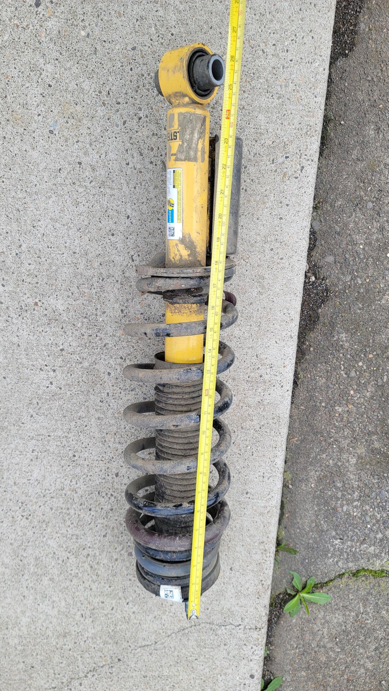

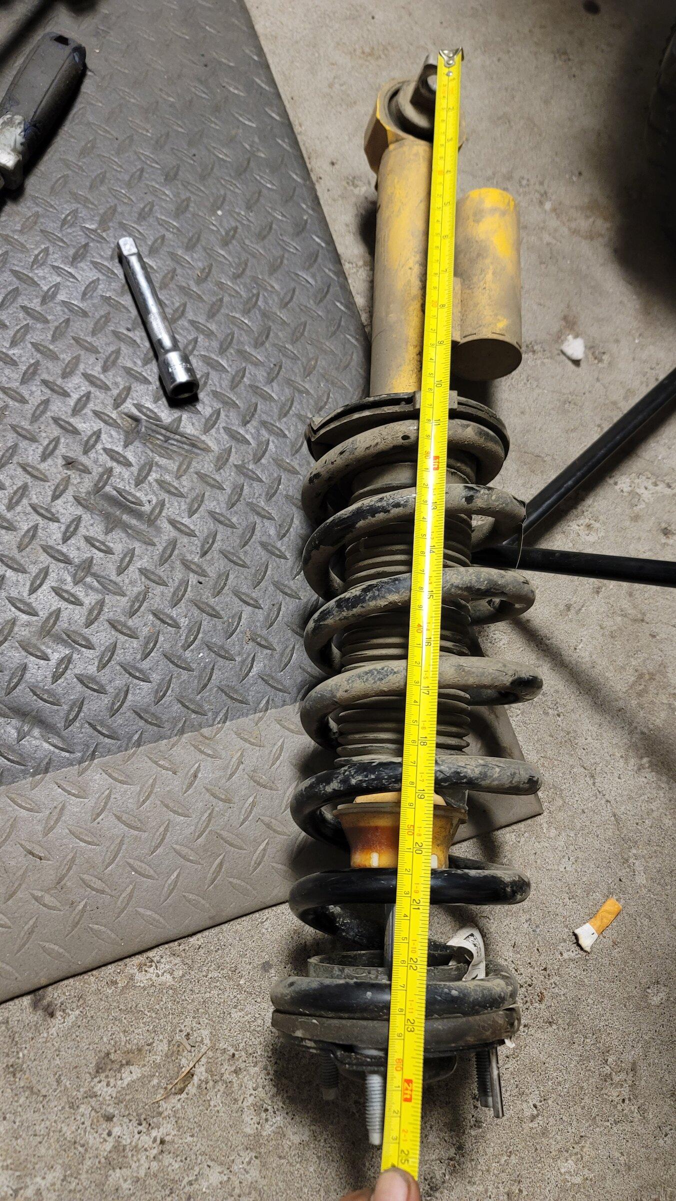

Do you have the length specs for the stock Coilovers ? anybody wanting to compare travel should start there.
I haven't found what the Icon setup length is, only travel but i'd like to know their actual length is. IFS travel depends on CO travel x motion ratio x tire height etc. Don't know what they doing in the front/ back to claim 11.5/14" travel. Extended IFS travel is typically 1" longer than stock, sometimes 1.5" long, but all manufacturers are constrained by the same IFS, so to say 11.5" travel with factory lowers is a big big stretch when the competition is close to each other in the front .
I Love Icons but their propaganda can be funny at times. Lets ask them about length and they'll claim they can't give out any specs numbers yet here they claim this much travel bla bla bla.
Anybody with the Icon coilvers can do the community a favor and measure base to eyelet center for both front/rear assemblies.
Same with the factory Bistein CO's. it's the only way for you guys to know what are you getting. I've seen the same movie again and again from vendors when they're introducing their stuff. King is King is all i want to say, then there is always the rest :)

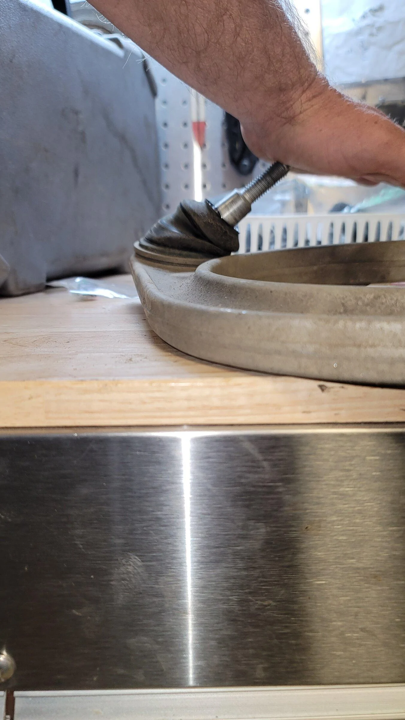

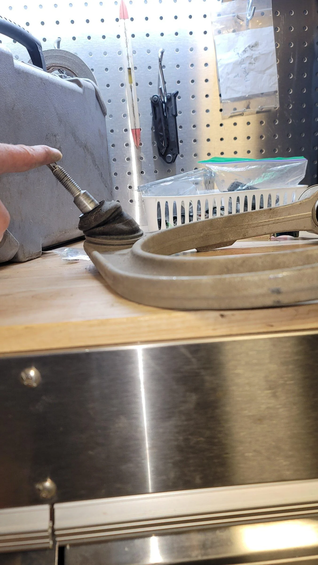

This is interesting, I see now what I suspected before could be possible. I plan on running the REAR SAS bilstiens on the FRONT!!! Same compression, but more extension! Perfect for getting more droop in the front!
Who has a set of rear 2dr OEM SAS coilovers for sale?
Measure there is no bind in any component at full droop. Check BJ's,tierods, CV axle angles etc. IFS is a different beast. You can only do so much with factory lower arms and geometry as a whole. When you want extra travel you have to look into long travel IFS. All race companies know a thing or two about travel, durability and performance as a whole. They know people will go a little crazy with the vehicle the moment they can keep their gas pedal down in dirt roads. :)
I wonder how different the valving is. The front shocks are on a 1.5:1. VS rear is close to 1:1
Buckin and bouncing along! Hahaha we shall see.
I'm sure the spring rate is different as well...but that's why I like to experiment.
Actually maybe you should look at the angles the factory UCA and LCA ball joints are capable of. Check out the pic for an example 😉
I DO already have aftermarket UCAs although I doubt there even needed. I already have achieved 11” front wheel travel.
Yep all that is on the checklist and diff drops already done...limiting straps needed too.
No biggie
