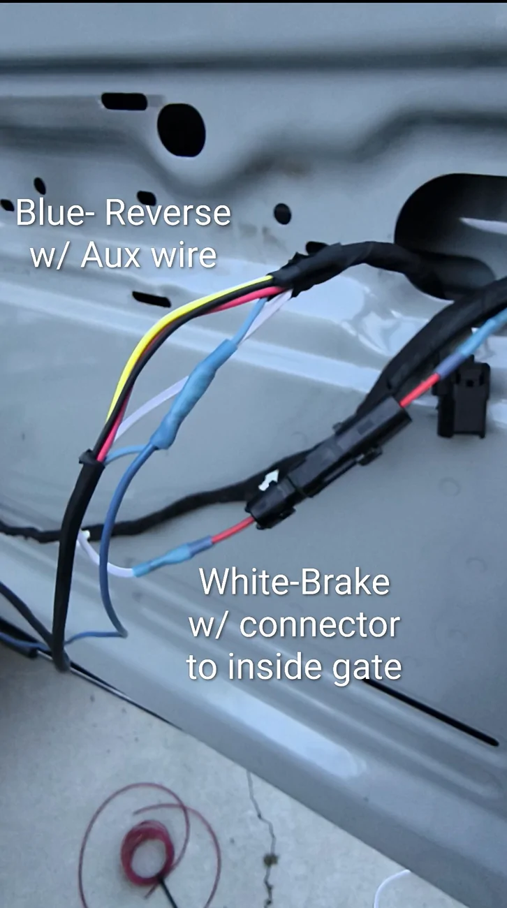

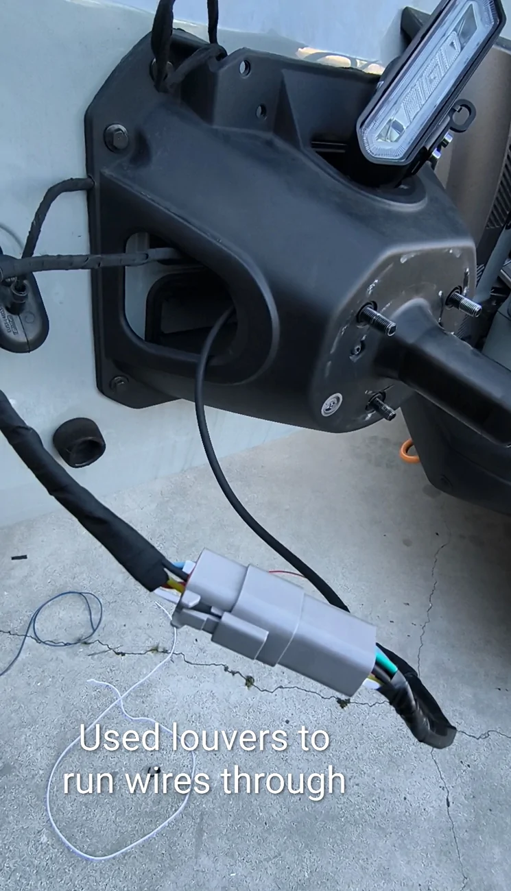

Just installed the RIGID Chase Light Bronco Kit. The kit only replaces the 3rd brake light, which means only the Brake light comes on.... the chase light has 5 functions: Running, Brake, Reverse, Strobe, Courtesy. I set it up for all except courtesy light.
I used a modified custom harness from SPV parts and I also wired two AUX switches for the Reverse and Strobe.

Yeah, I didn't like looking at that 3rd light above the tire. The Strobe is the only one that needs an Aux switch to operate. I also wanted to turn on all my reverse lights on a switch aside from the shifter. Flickering running light is only on the video.
RIGID Bronco kit - $399 (I got a 25% w/ free shipping at SoCal show)
SPV Taillight harness (modified) - $118

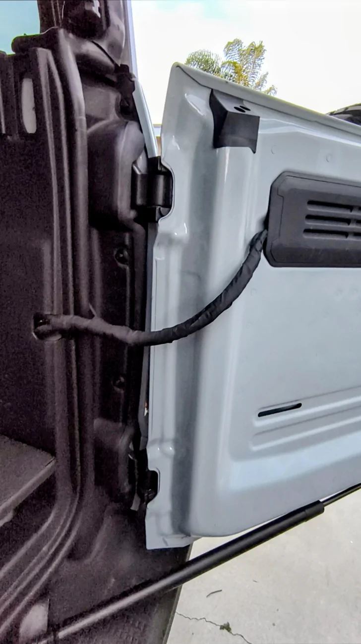

I ran two wires from the tailgate - behind back seats - driver side sill channel through the firewall plug to connect to the AUX switches.
The modified harness had a pigtail for the Strobe and I spliced into the Reverse wire on the harness.
Also I thought about the stock 3rd brake light wire like the RIGID kit requires but realized that wasn't going to work with the harness. I chased that wire to a connector inside the tailgate (larger compartment with removable panel). De-pinned that connector and and added a single wire connector to the harness for the stop light.
The waterproof plug lives inside the tire carrier. With the stock brake light removed, there's a small gap at the top where I can access the connector if I need to remove the spare tire.
