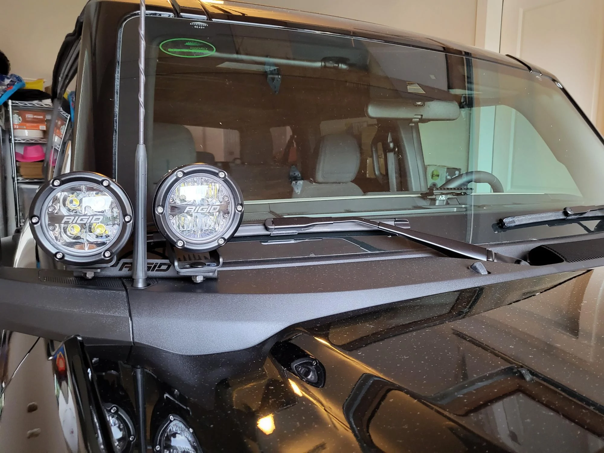

I see you got a 2-pin 16 gauge wire. Doesn't the Rigid light have 3 wires for hookup? Two wires for the light and one wire for the backlight? How did you hook up all 3 wires?
One of the wires is a ground, and in the Ford Performance instructions, they show that you can ground the lights on each side of the vehicles.
The left one on the left fender frame and the right one on the right fender frame, that way you only have to run two wires over to the power source in your case, for the backlight and the main light.
360 has three wires. One for back light, one for main light, one for ground. That wire is just wire. You can split the two wires apart and make your own length.

@ScoutandBronco I have to ask, did you try?? I just picked these up from the Ford dealer along with a 40" light bar... I'm going to install them this weekend, but don't know if I'll bother trying to get the backlight going.
Guaranteed won't work with Ford Performance version. I tried and spoke to Rigid it is disconnected internally. I'm running a dual rigid setup ford performance driving pods inside and rigid spots on the outside...spots (non ford) have backlights that work...performance does not. Also, different brackets so I had to paint the non ford version black to match. Non ford bracket sits a little lower. I actually don't mind that they are different since it shows a stagger in height. Also went to the local hardware store to get black stainless bolts/washers/nuts to match it all up. Came with bright stainless.
Thanks man! I like the setup you went with! It looks like I'll save myself some headache and forget about even trying. Not too disappointed since backlight isn't mentioned when ordering at all. I had a boatload of FordPass points saved up, so got $1700ish worth of lights for a couple hundred bucks so I'll just roll with it...
