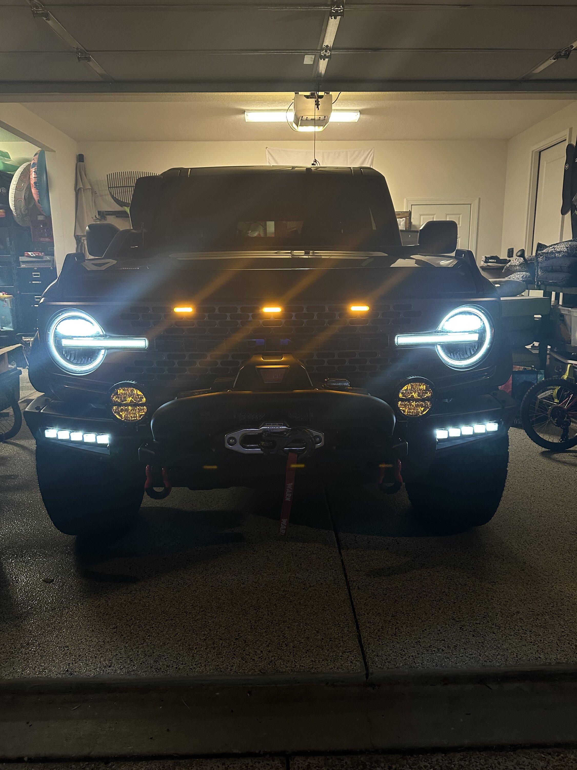

I’ve installed 2 Rigid 360 6” to aux switches. Backlight to switch 4 (10 amps) and Drive Beams to switch 5 (10 amps). Had the drive beams on for 5 min and they blew the 10 AMP fuse. Indicated to be 4.85 amps per light, does this sound about right?
Has anyone else had this problem?
My Aux switch 2 (15 amps) is available but was hoping not to need it for these two lights.
Appreciate any advice/ feedback.
btw, the backlights work fine, no issue.

Unless your fuse was bad, probably best to just move em to the 15a. It’s never the best idea to max out amp draw on a circuit anyways, leave a little wiggle room and at 4.85 per light you aren’t leaving any room

Thanks for confirming what I was assuming to be the problem/ solution. 👍🏼
