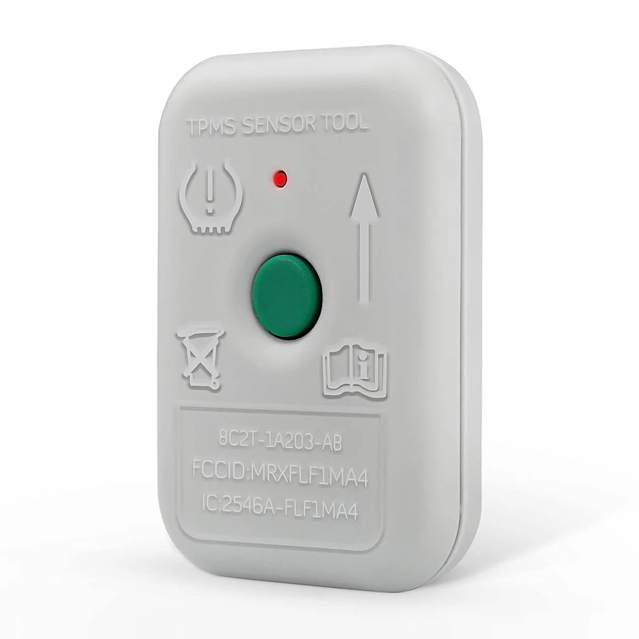

It seems that recent sub zero Temps caused a variance in tire air pressure that set off my TPMS warning. I added air, and tire pressure on all wheels is verified at 35 PSI. I can't get the dash light to re set. I tried youtube instructions. Everything goes as described but in the end, the TPMS icon just flashes, reads "train left front tire" but doesn't re set. Advice?
Do you have the TPMS-19 reset tool? I needed this when I first got my wheels/sensors and then when I rotated in the spare. You hold it next to the valve/sensor and hold the button for 20-30 seconds or until you hear the honk.
