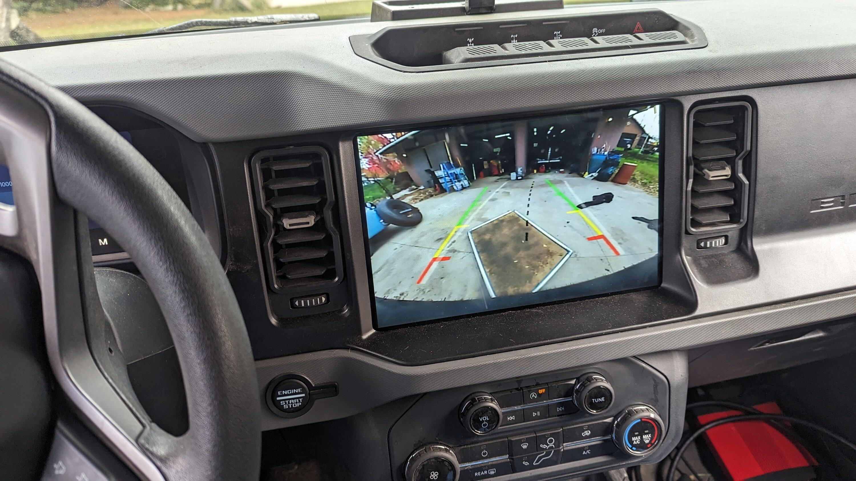

What’s the type of mounts? Got a pic from the back side of that to show how they are attached? Did you add a rail up there?
I hacked up some old mounts to connect with the BYOD hole and I used slightly modified Bulbhead fastball mounts to provide a magnetic mount for the cell phone and radar detector. The Fastball cups are magnetic, so they will hold a flat plate in place. No rail yet. I plan on doing that soon.

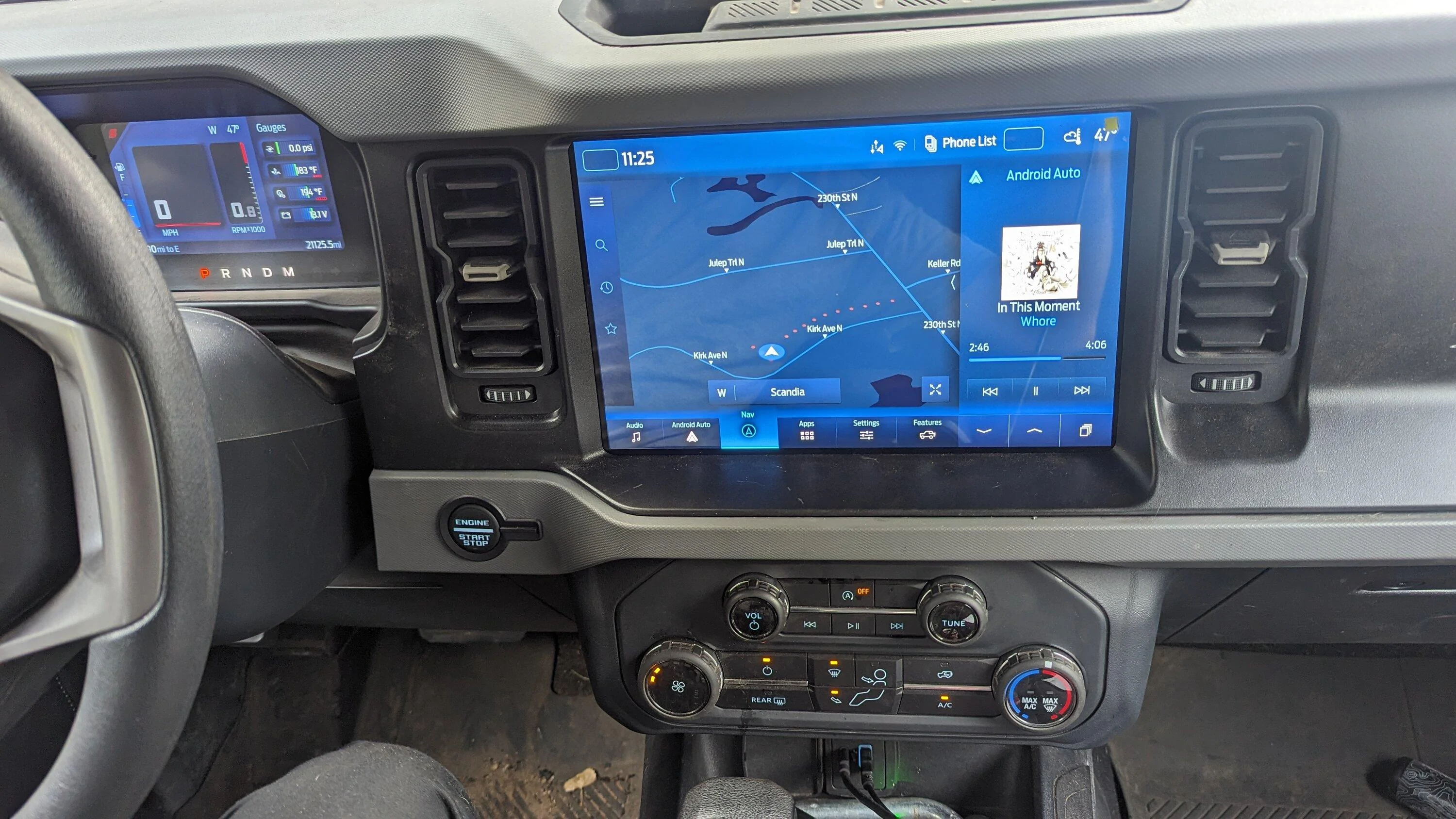

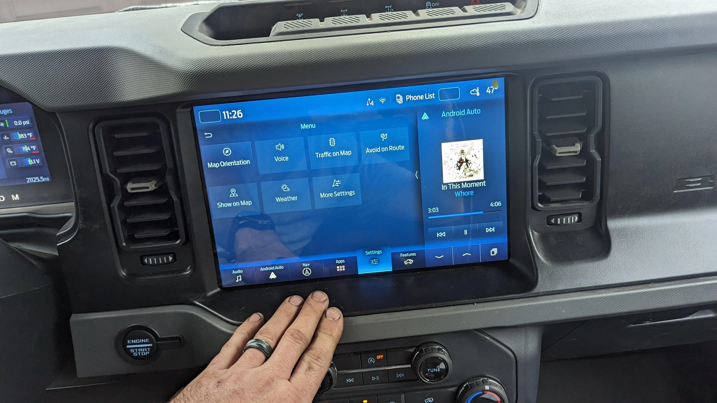

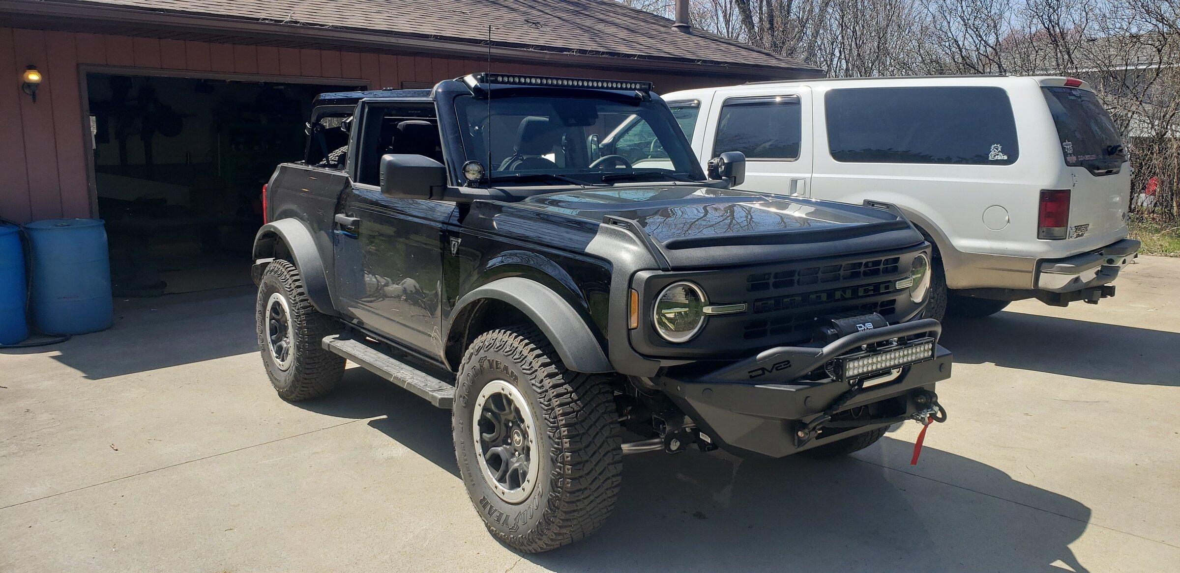

Here be Shadowmere, technically a Sasquatch next to my Yeti, the '02 7.3L Excursion. This is the testbed for the 12" once I have a final solution.

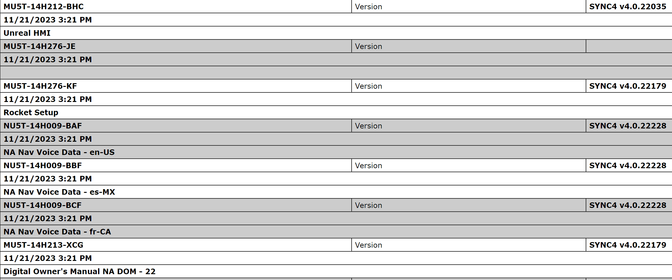

Ford Bronco Replacing 8" with 12" Screen? 1700501274306

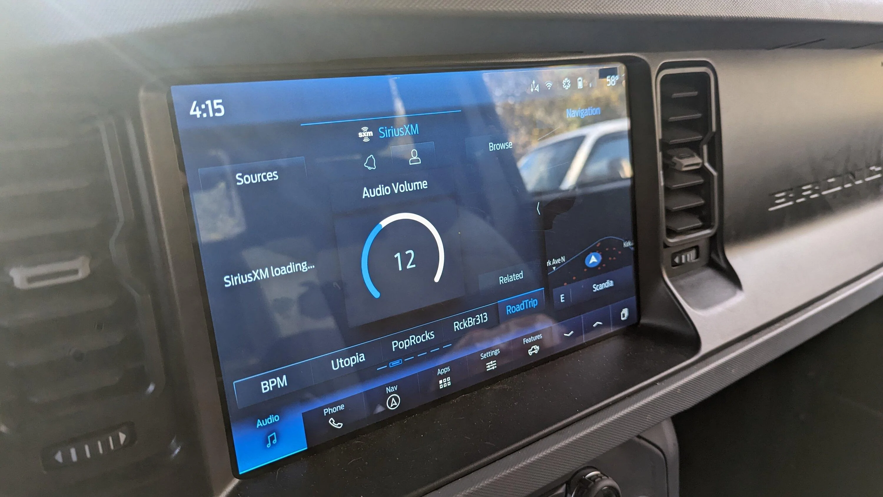

Update: Since SiriusXM quit working, and the Sync unit showing nada for Sirius except allowing me to select it as an audio source and never loads, and even trying to audibly tune to channel 0 or 1, I decided to take a much closer look at the programming on my unit that Brian may or may not have done at Ford. I sent it *somewhat* programmed, but without an active screen I had no idea *what* took... and apparently Ford doesn't show anything! So, I'm starting over with the software side.... Good lucky, everybody!
Just for clarification, I'm using a VIN provided by the generous, @mpeugeot with the "Mid/High" package, which shows NAV maps and all that fun stuff. For those who may not know what is required for this to take place, I had to use Forscan and access the BCM (Body control module) and change the 3 lines of VIN from mine to @mpeugeot VIN. Then, pay for FDRS $50/48hrs and select the donor VIN to use for programming. I'll add more later as the process completes, but feel free to message me and I'll reply as soon as I get the alert

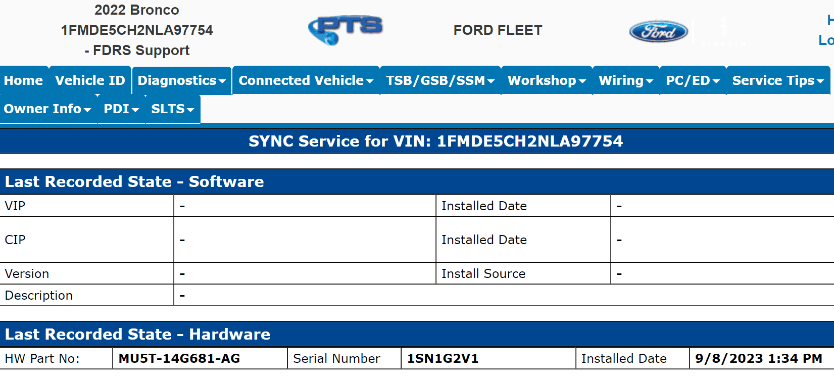

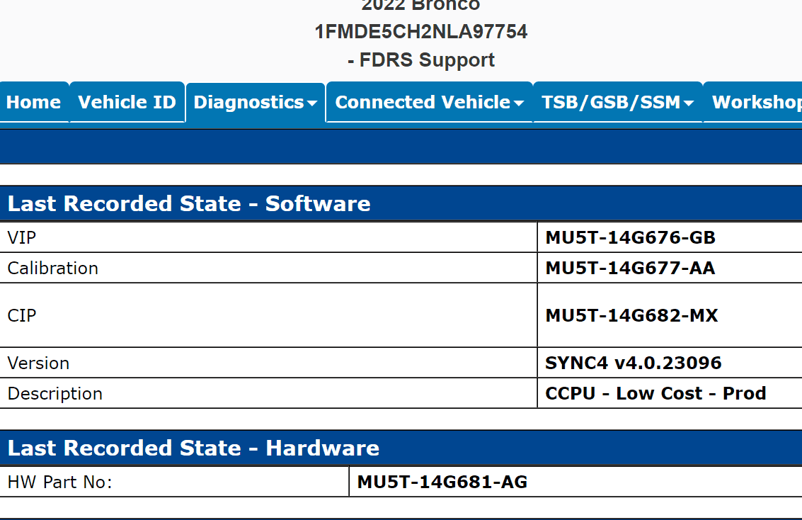

Ford Bronco Replacing 8" with 12" Screen? 1700700795822
Ford Bronco Replacing 8" with 12" Screen? 1700700850176
Well, I got that far, then called into work, so basically I got hosed out of my 48hrs of FDRS; that's okay- he can pay for my next subscription after turkey day.
For what it's worth, I have not once accomplished a programming via USB FLASH drive- only ever via CAN (OBD-2 port, slower than my laptop, which gives FDRS every chance to lock up and fail), or remove the trim panels from the transmission tunnel/below climate and hard-USB flash with the USB-mini adapter.
Seeing the blank lines and the fact there's NAV audio files, maybe it's just slowly been installing while I let the turbos warm up/cool down and/or idle time.
I'm no Ford employee or tech; just dangerous enough with service access, and years of reflashing new/swapped modules in older gens.
