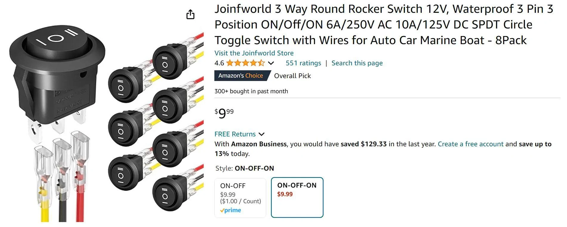

Upfitter switches is the "official" name.
Any reason you couldn't just use a 3-way switch mounted someplace else? Say under the steering column on that piece of trim, or under the HVAC where that lil cubby is, or on the center console by the window controls? Those are all common locations.
Seems like that would be a better solution than trying to hack up the upfitter switches, or tying up 2 switches.
Just an example:
