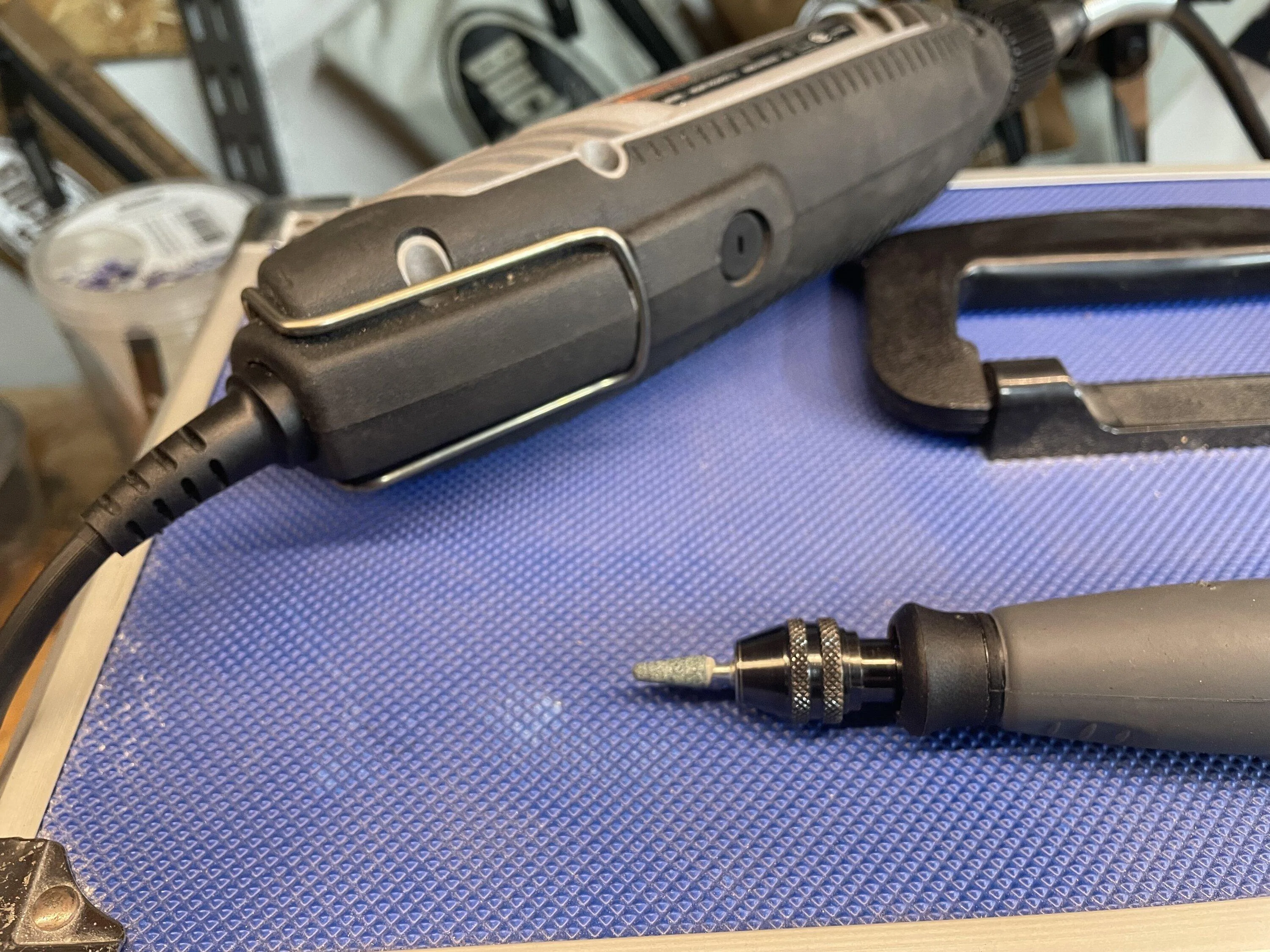

Using my Dremel, I removed the Ford label which resulted in an area 1/2” x 3/16”.

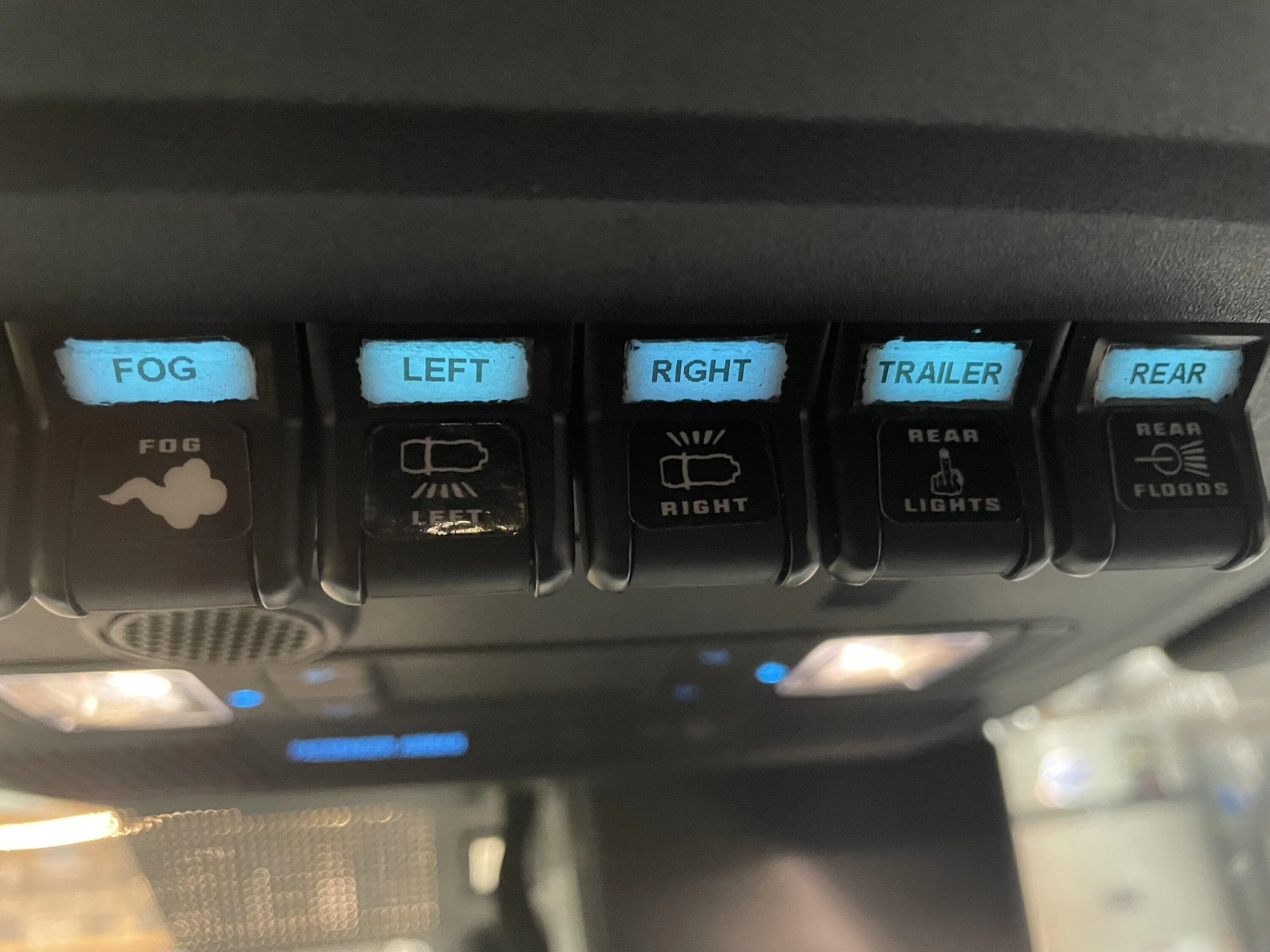

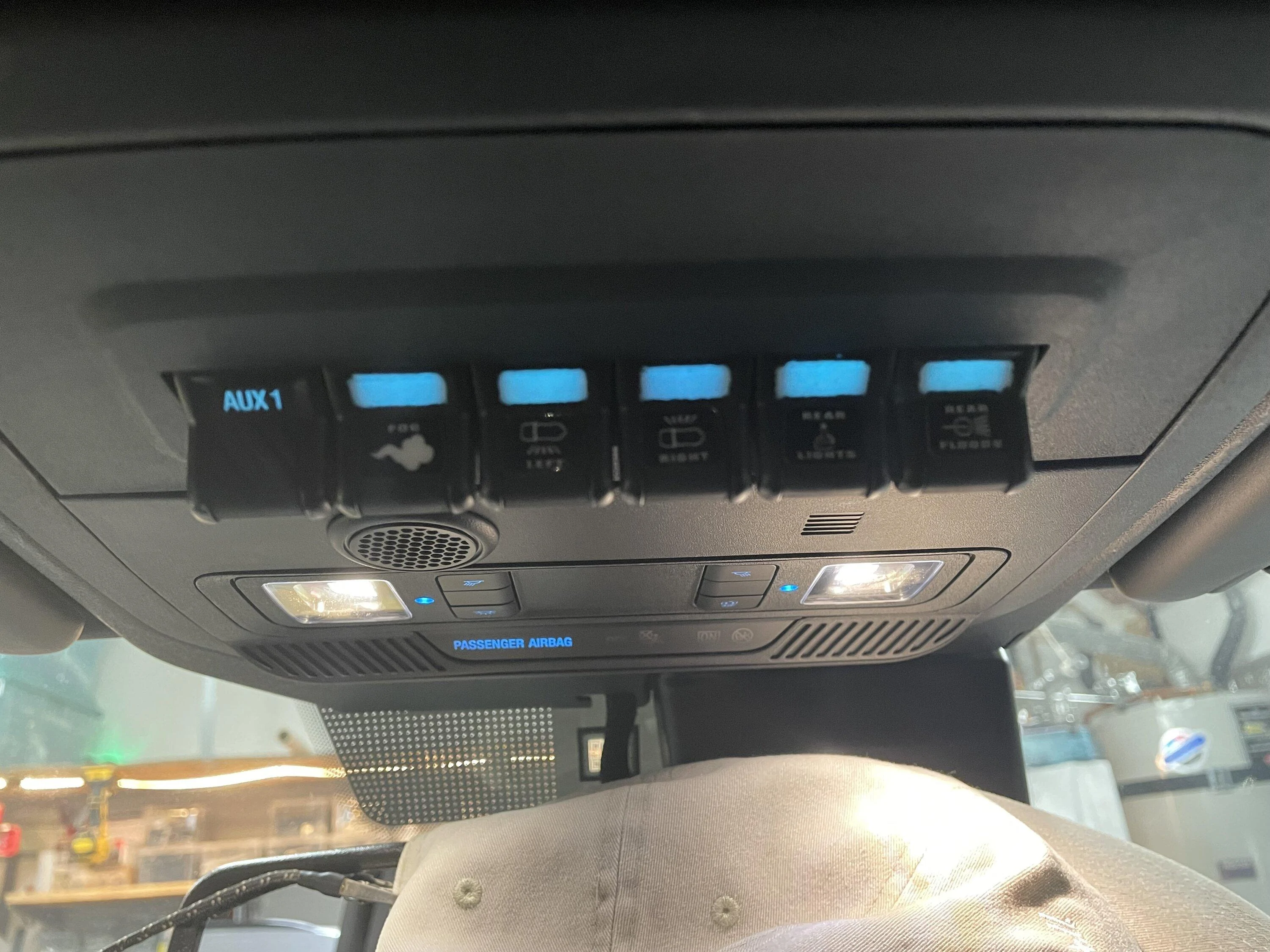

I then used my label make with black on clear, set to 10point font to make my labels
Ford Bronco Auxiliary switch labels (DIY) IMG_1730
this isn’t perfect due to shaky hand and poor eye sight, old age……..
But now I have labels that leverage the vehicle lighting
