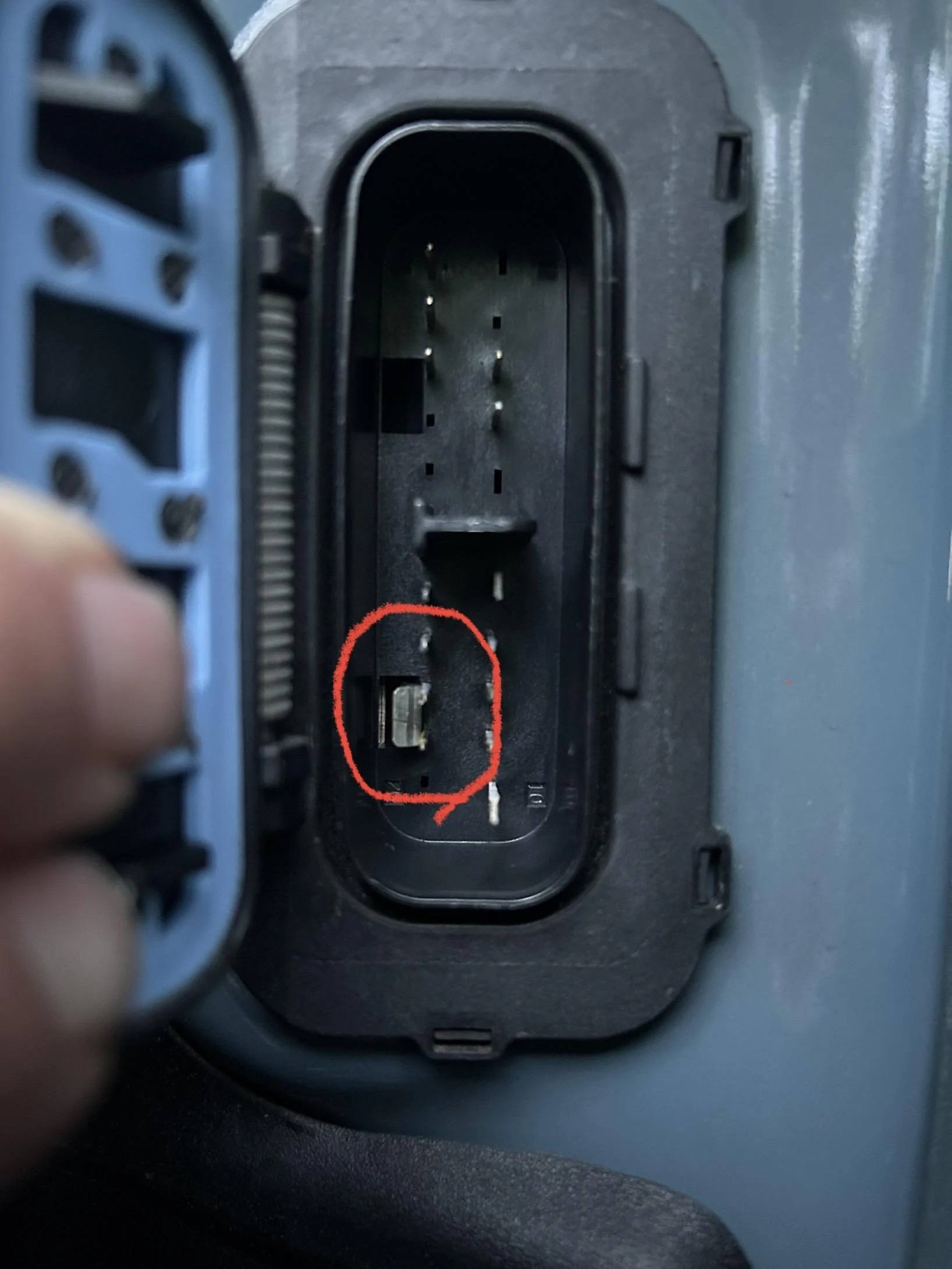

any idea why driver side door open light is on after doors are removed? is there a latching sensor somewhere? Suggestions?

Fiddle with this thing.
Ford Bronco Removed doors, driver side door open light is on? IMG_4994
It appears to close the connection between those two pins when the connector is removed. Worked for me.
And fiddle with it on the drivers side door since it thinks that one is open. When it makes a connection to the pins it lets the vehicle know the harness has been removed and the doors should be off. Since it thinks the doors are off it disables the door ajar warning.
