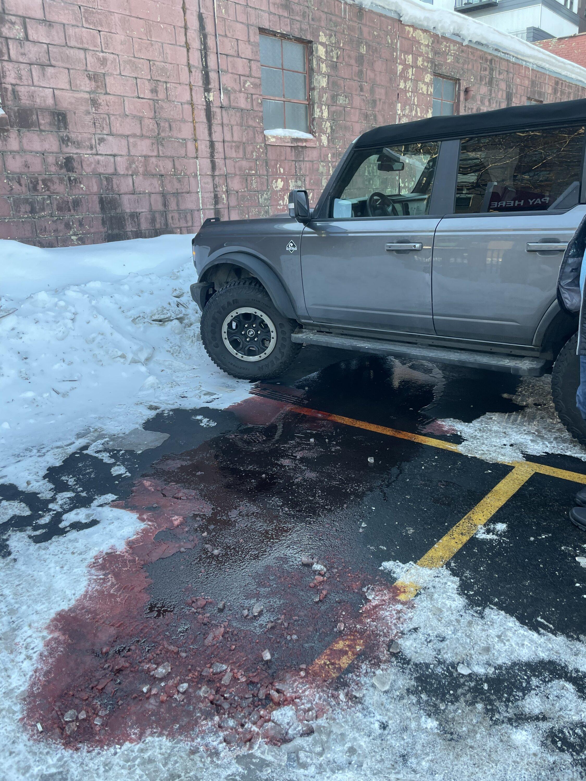

Red fluid leak. Transmission fluid?

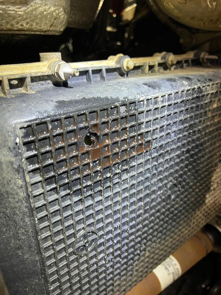

Update on this:
Not sure what could have done this.

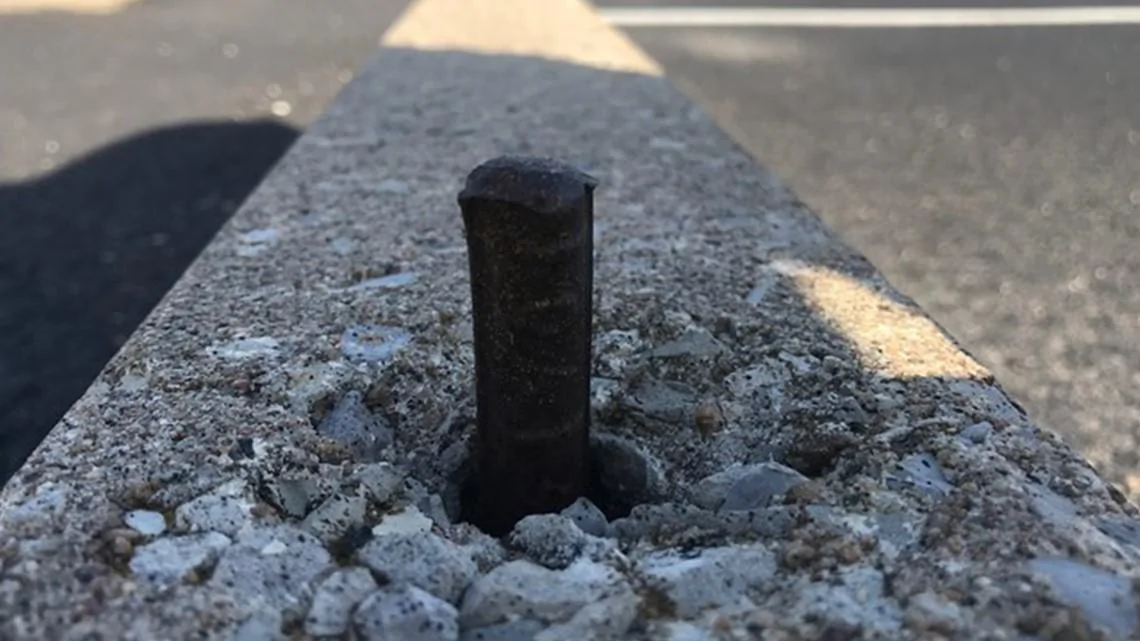

By chance, did you happen to run over one of those parking barriers that may have been covered in snow? The rebar sometimes freezes out of those things. Makes a nice hole puncher.

Update on this:
That's a helluva perfect hole, did you piss someone off in the parking lot?
Good though. But no I was in a pretty clear spot.

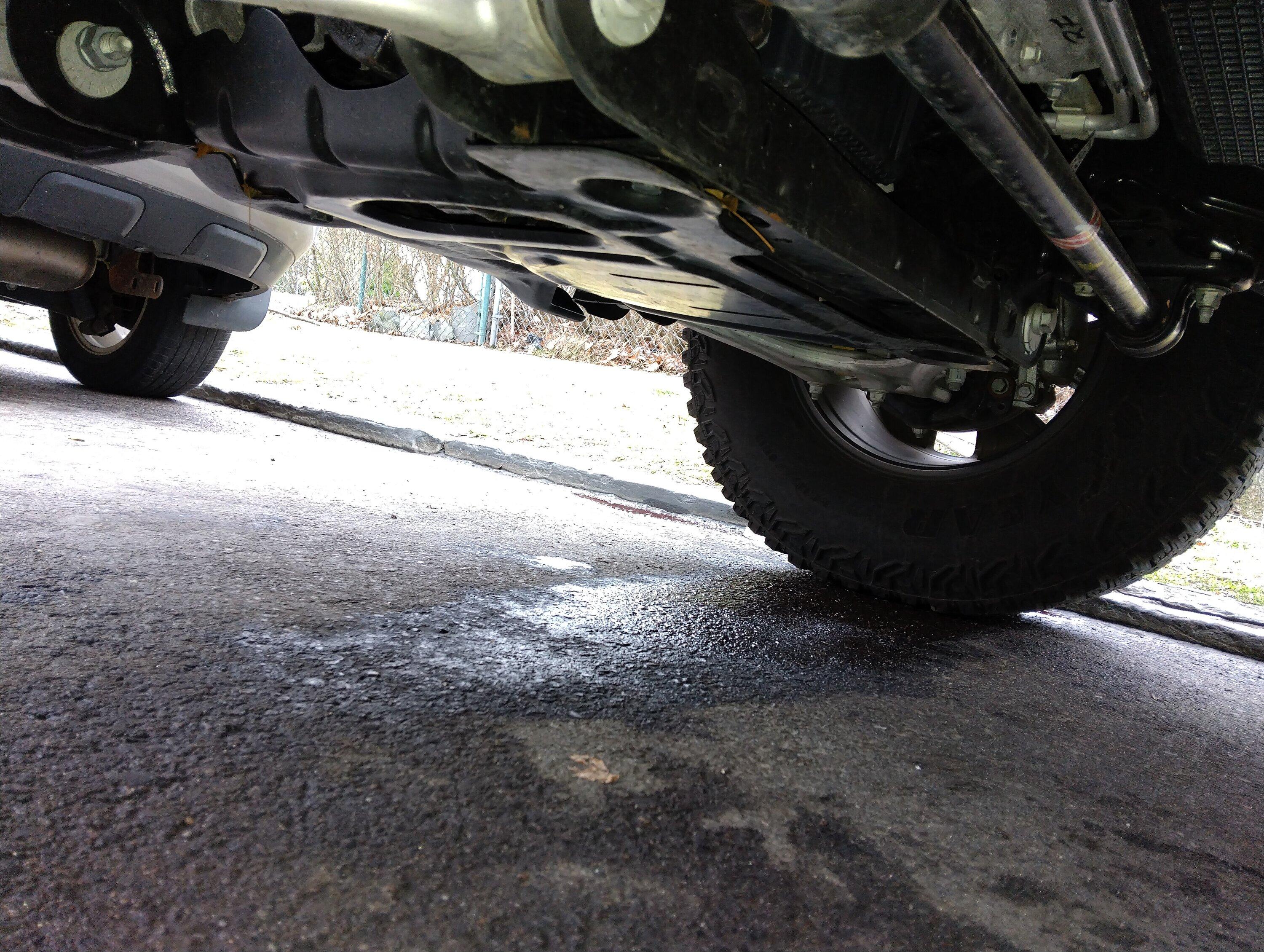

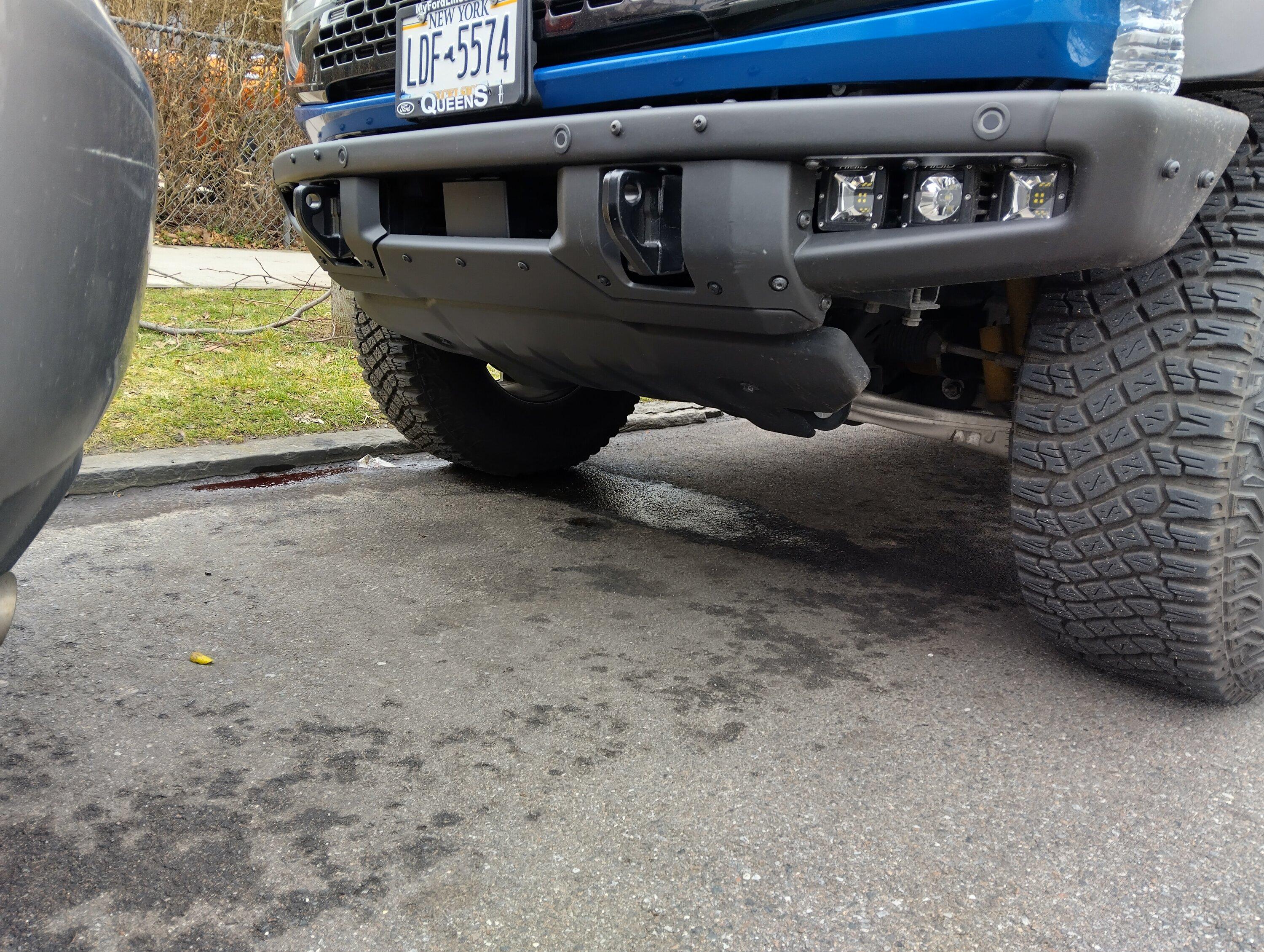

Walked out to my car in the parking lot and found what I think is the transmission fluid leaking.
Anyone had this issue?

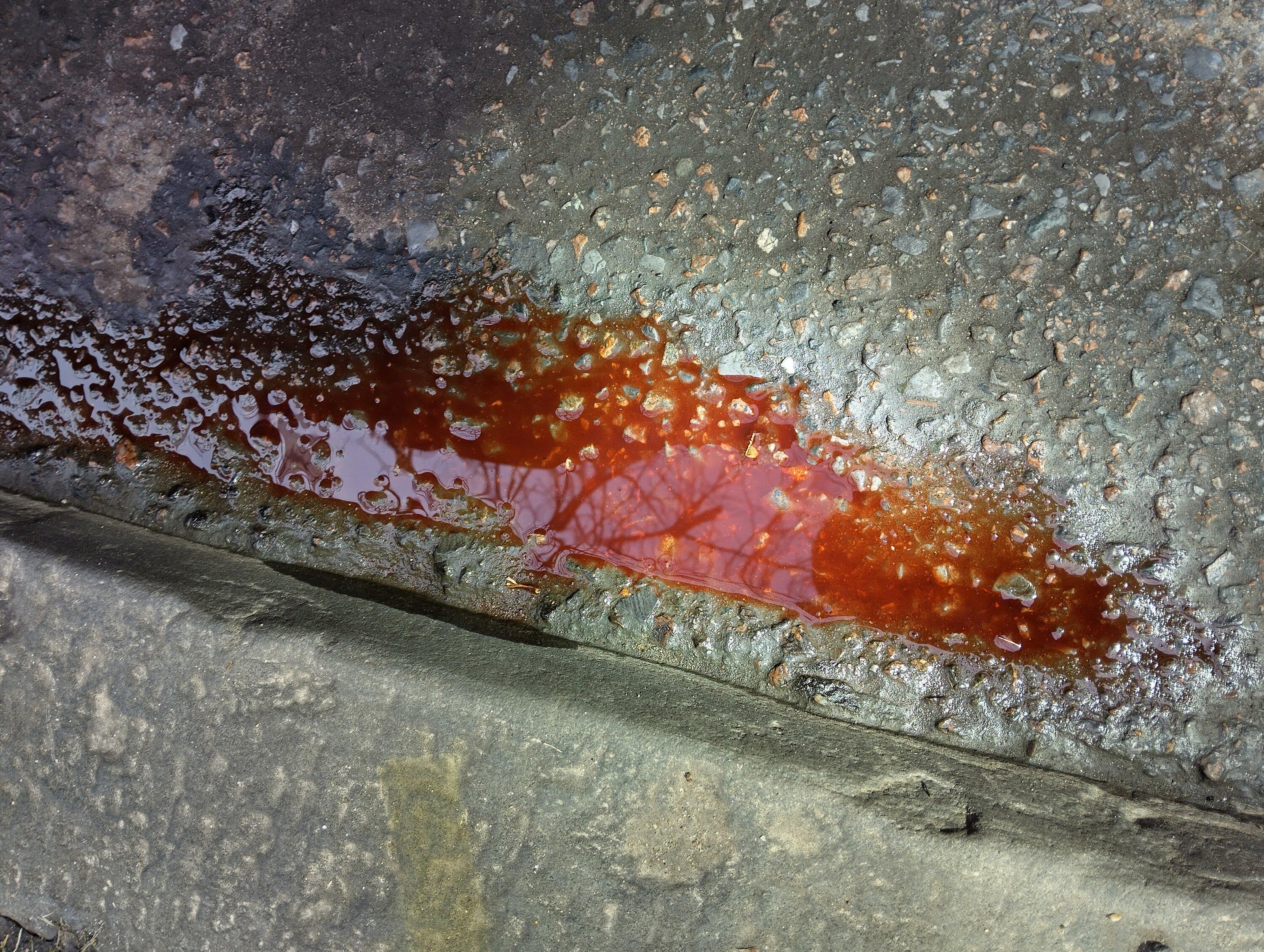

Yeah I parked my bronco at 2am it was good I went to get something out of my bronco and I have the same looking oil but not so much

Obviously not the way you want to have to/be forced to do it, but looking at the reddish chocolate color of the fluid on the pan itself, it needed to be changed.

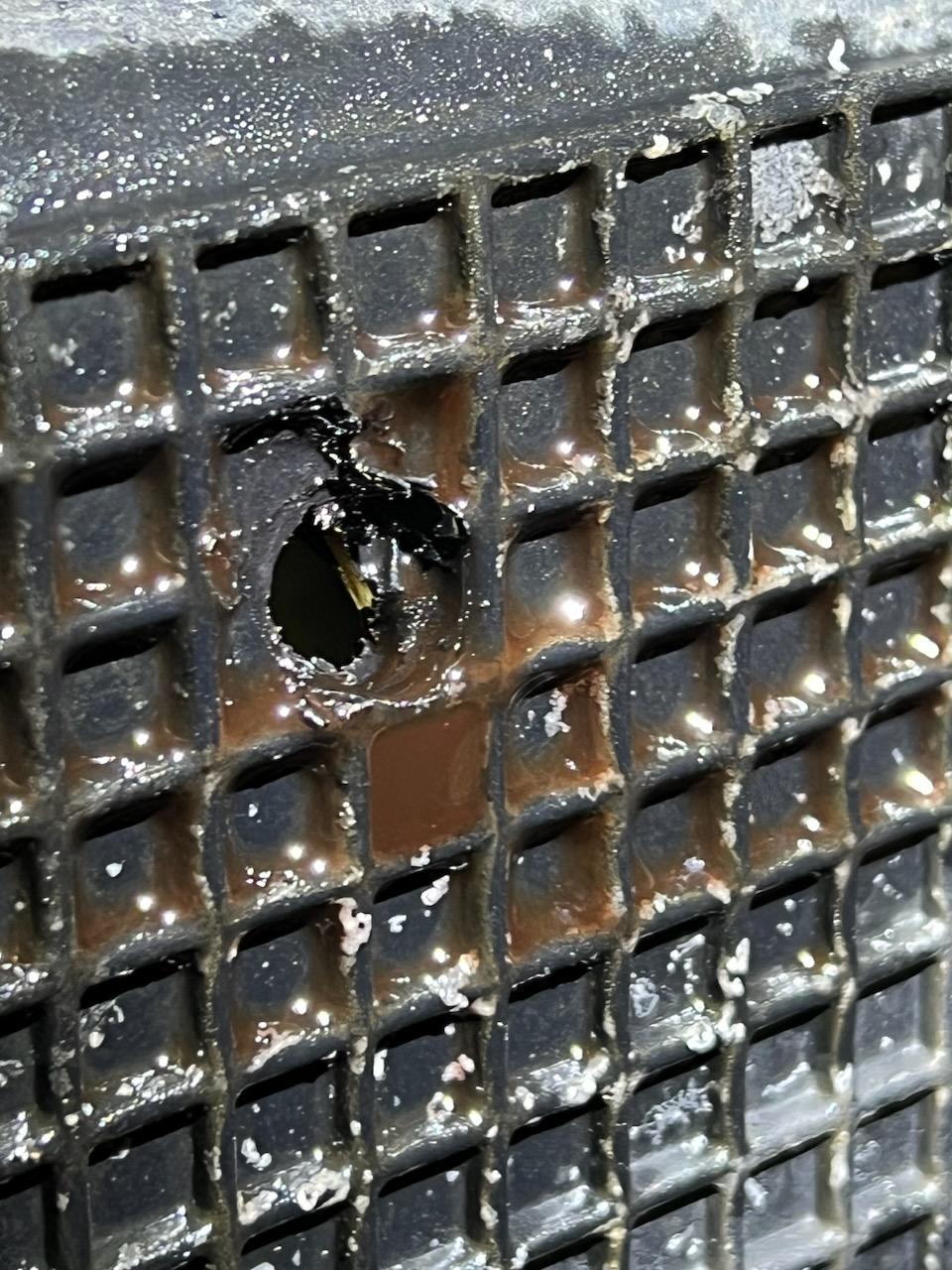

Definitely looks like a hole saw to me….I’d say about 3/4ā€ā€¦ā€¦u can see what looks like the shavings when hole first breaks thru , not completely finished….that’s what it looks like to me😬
