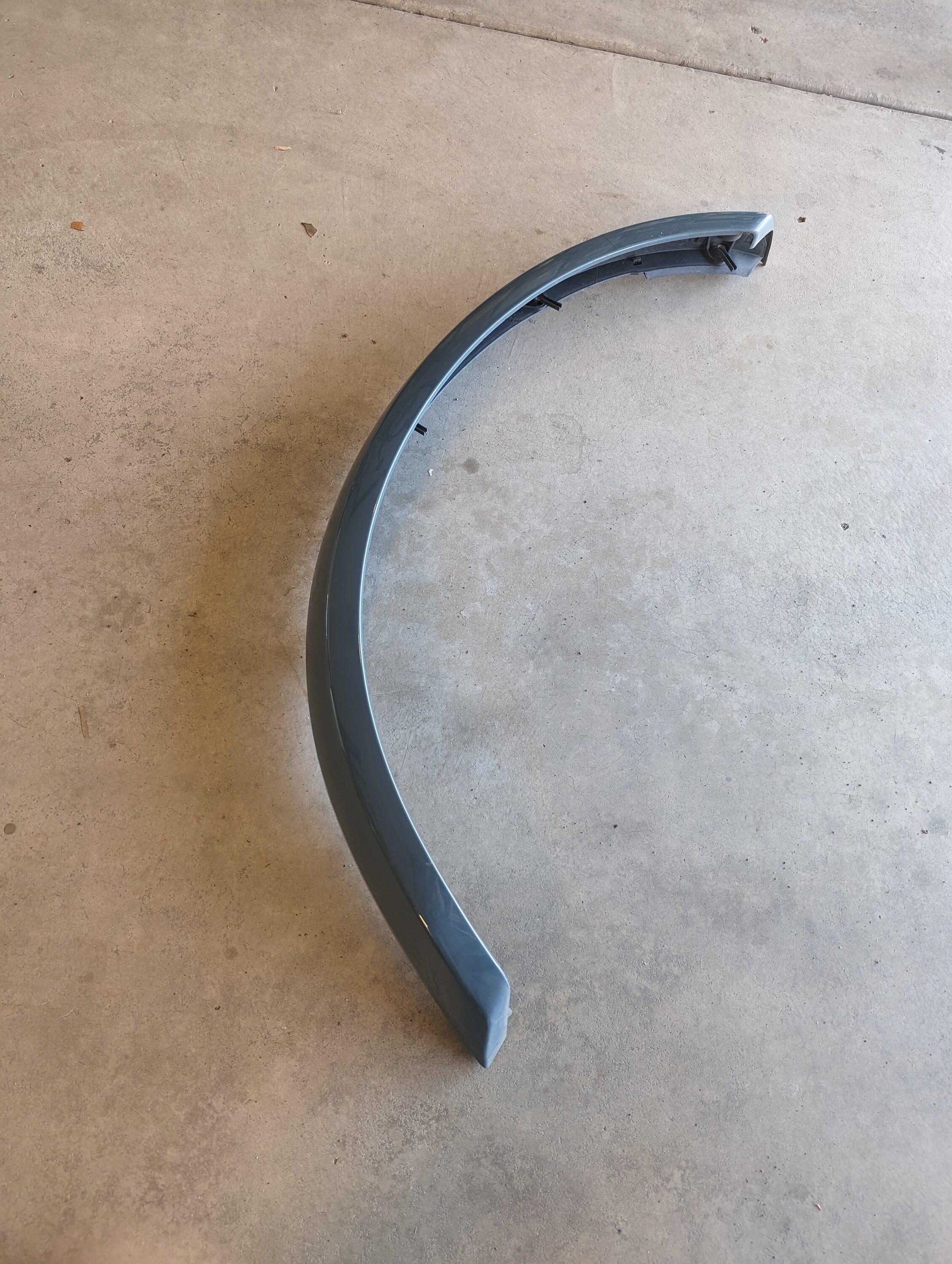

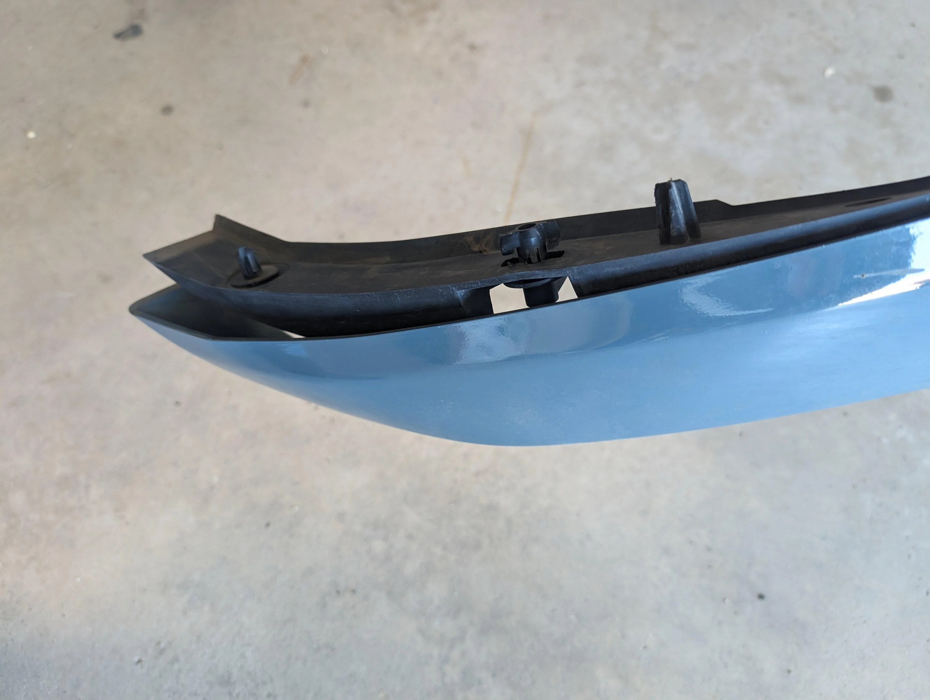

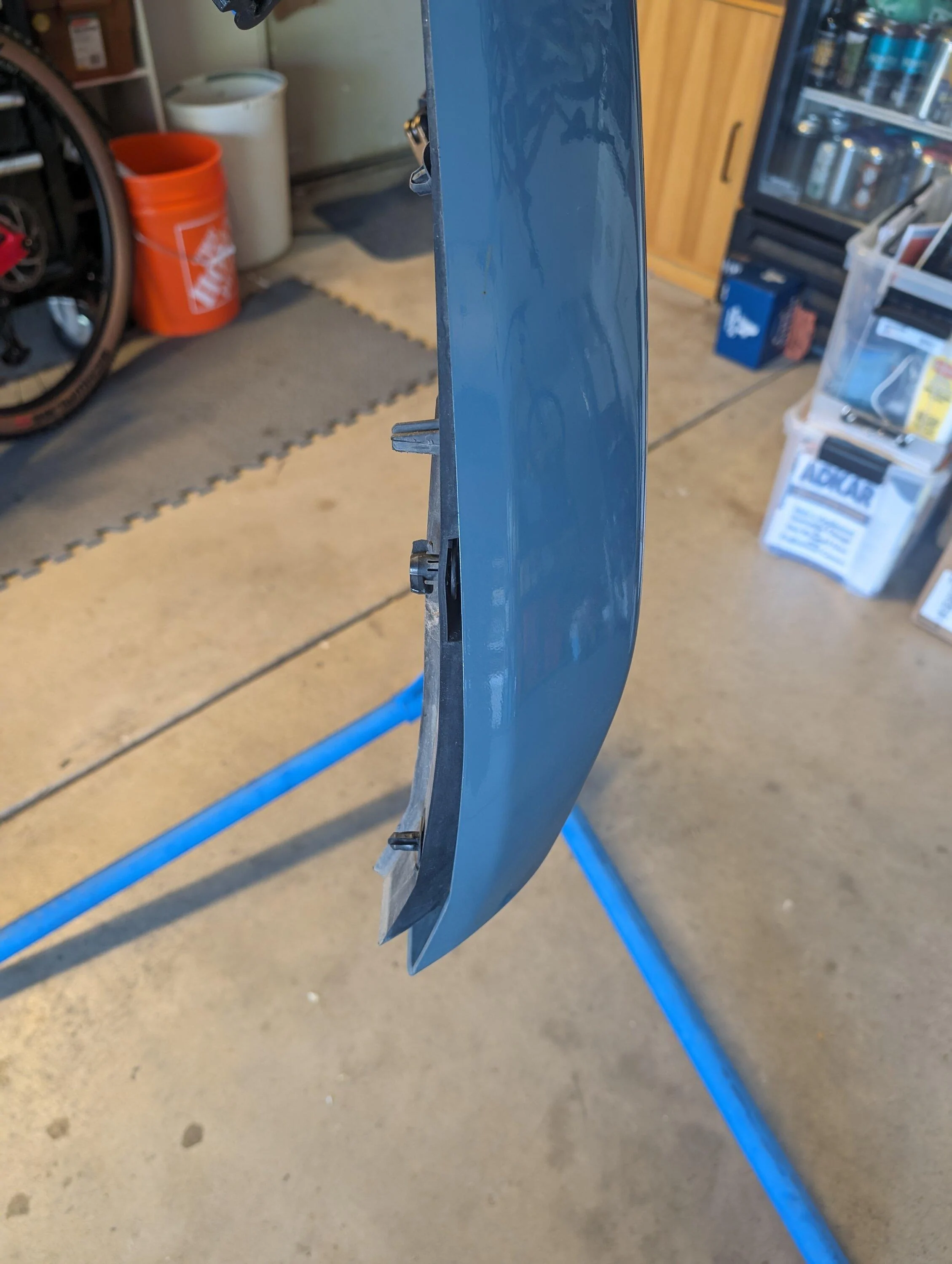

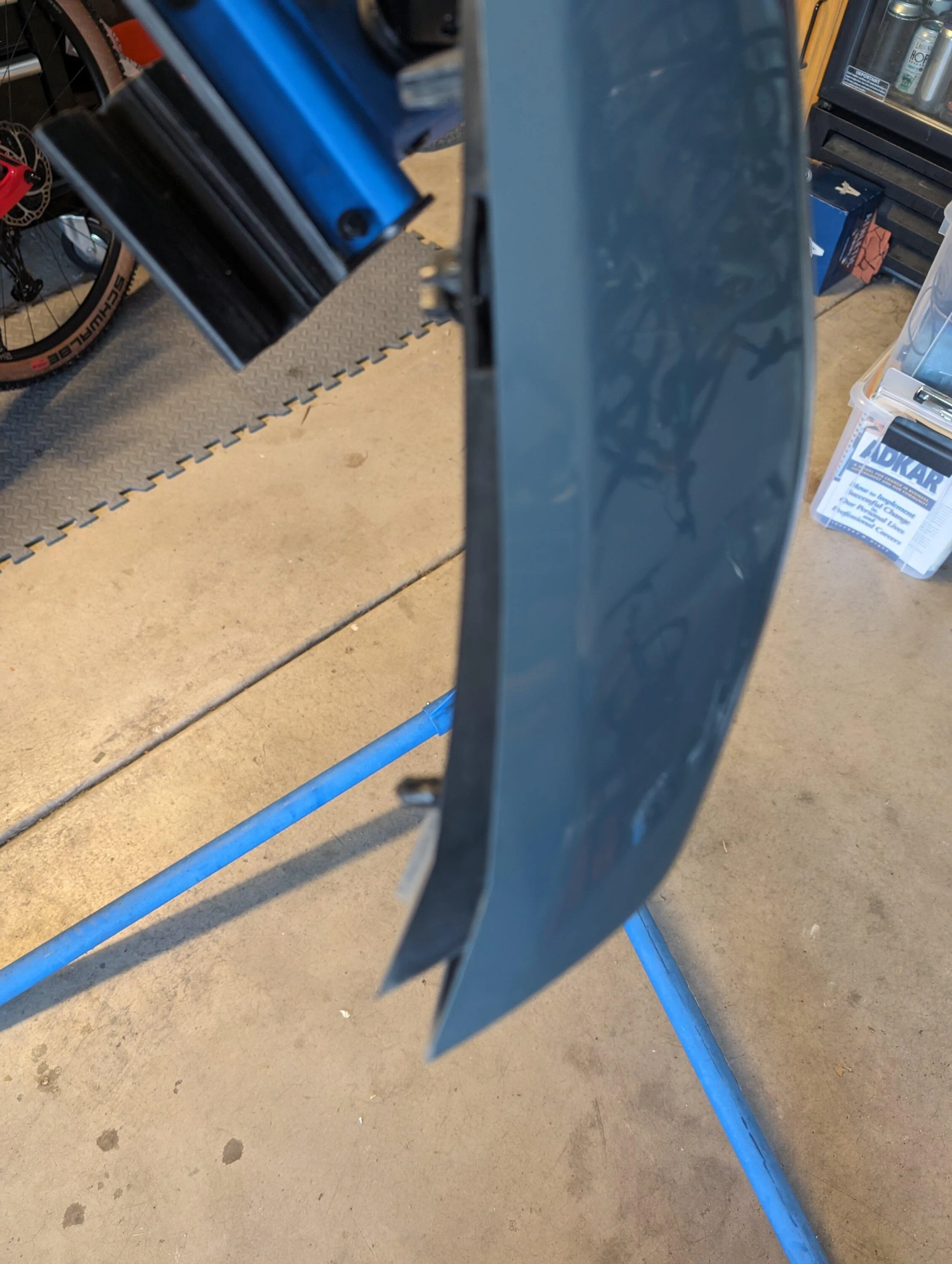

My right front fender flare started to separate. The outer body color matches (OBX) is starting to separate from the inner piece that clips to the body.
What is the best adhesive to glue the two pieces back together?
Ford Bronco Reattach fender flare? PXL_20240523_185626338
Ford Bronco Reattach fender flare? PXL_20240523_185602097
Ford Bronco Reattach fender flare? PXL_20240523_185609676
Ford Bronco Reattach fender flare? PXL_20240523_185548488
