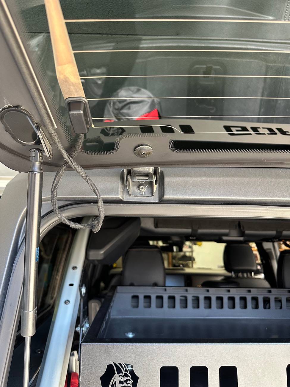

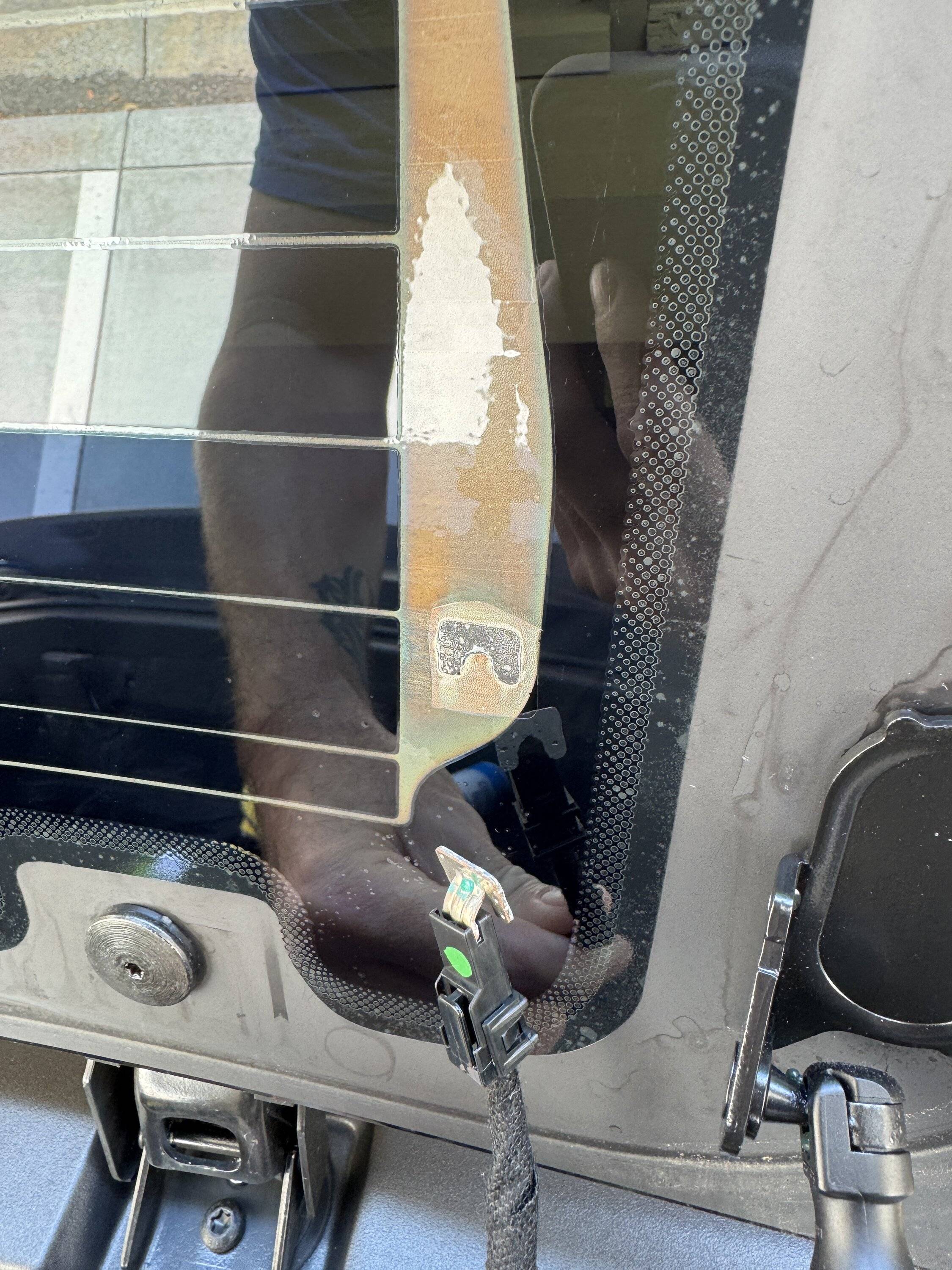

I accidentally knocked this off while cleaning my window. Or maybe the window tint guys did it a month ago and were able to kinda stick it loosely back in place, cuz I barely touched it and it came off. Is there any easy fix? Solder it back on?

Ouch, had something similar happen but not as bad.
I was able to fix rather easily using this kit, other similar products available.
https://a.co/d/2EWwTrB
To prevent future accidents I put some covers on the connectors as well, easily available on Amazon etc.
Ford Bronco Rear Window Defrost Wire Attachment - Came Off IMG_3033
Hope this helps.

Yes, thanks!
