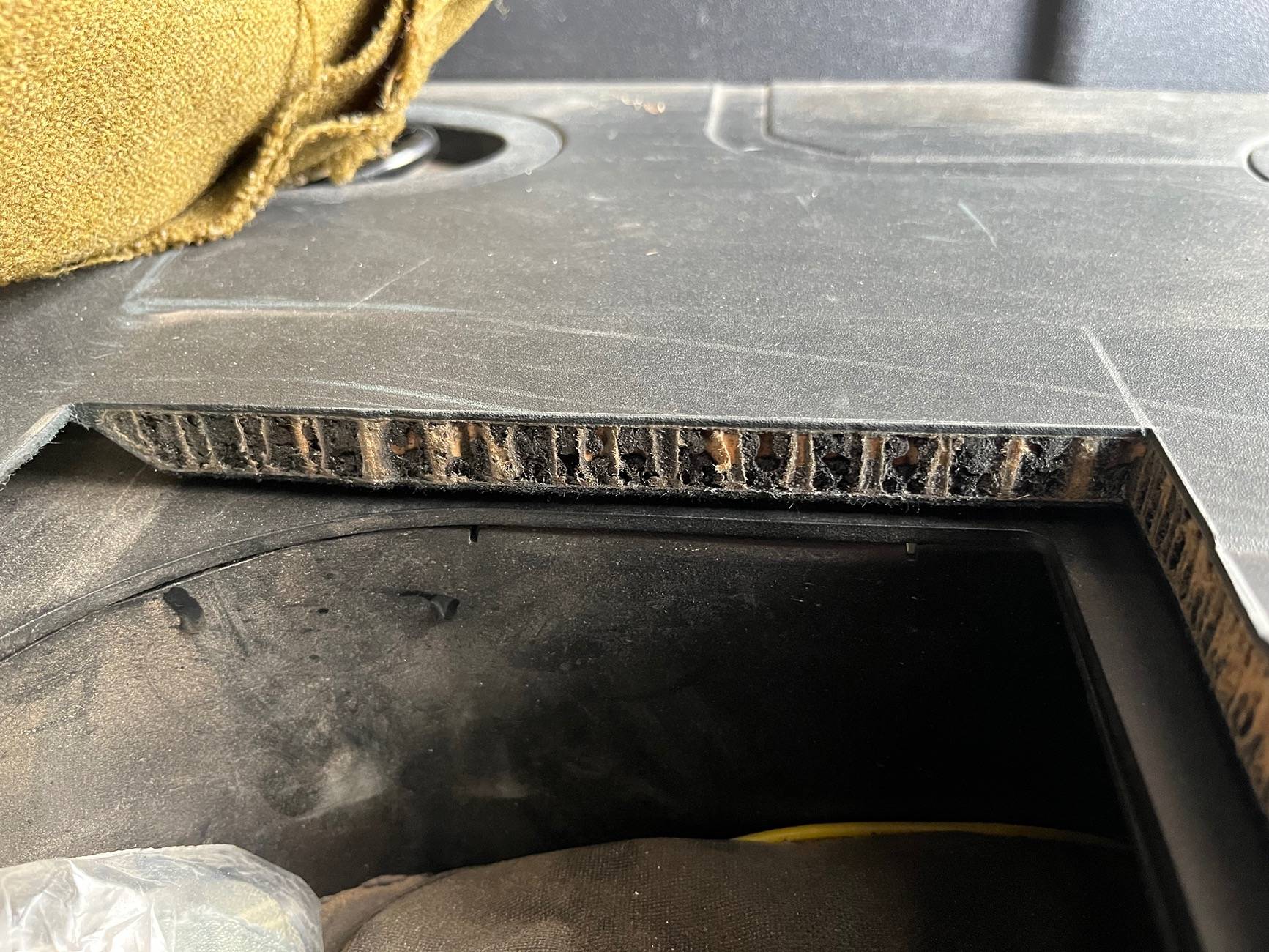

Little unclear. ABS plastic. Score with razor and snap it. Sharp saw blade. Not too high a speed. Dull or small tooth blades running fast just melt it.

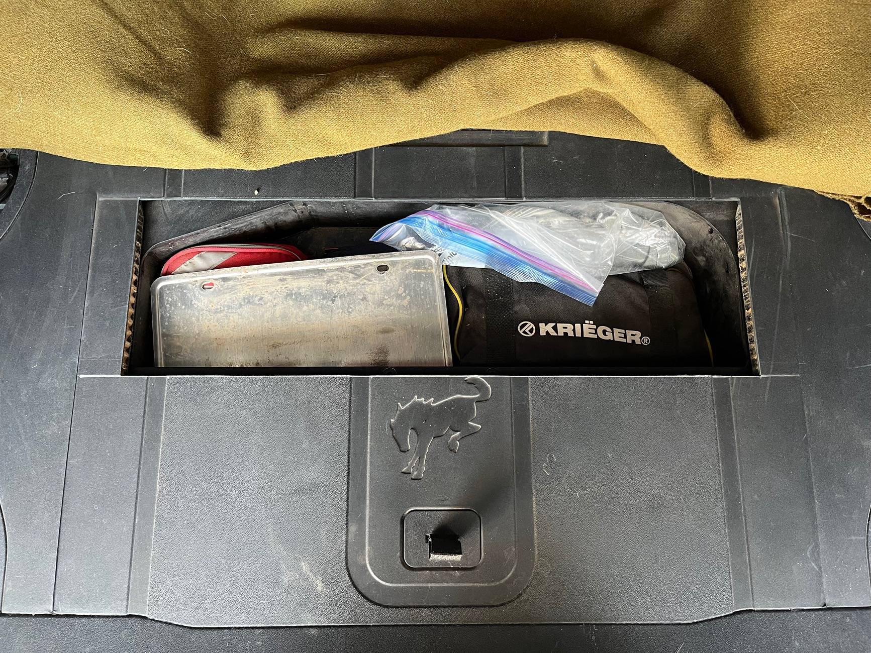

I found a thread in B6G (forget who at the moment) where another member built a seat delete and trimmed his cubby hatch.
I trimmed mine with a jigsaw, no drama. It’s just more fiberboard (cardboard) filled with foam.
