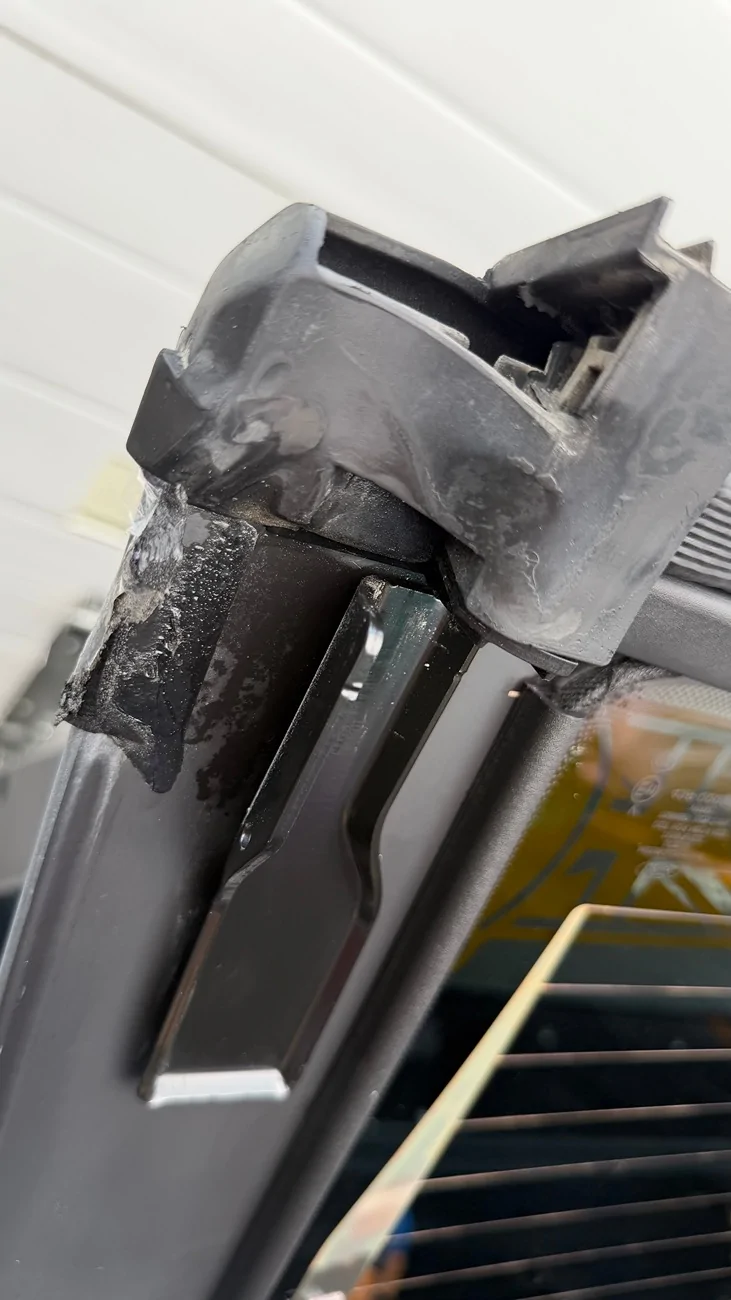

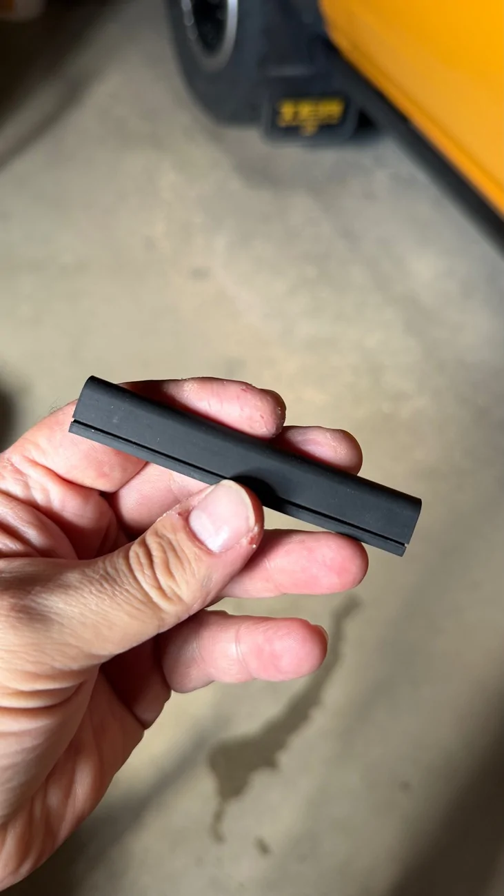

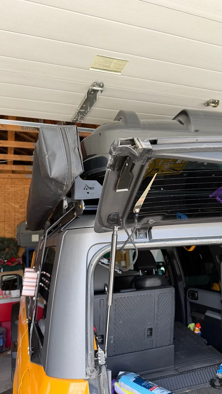

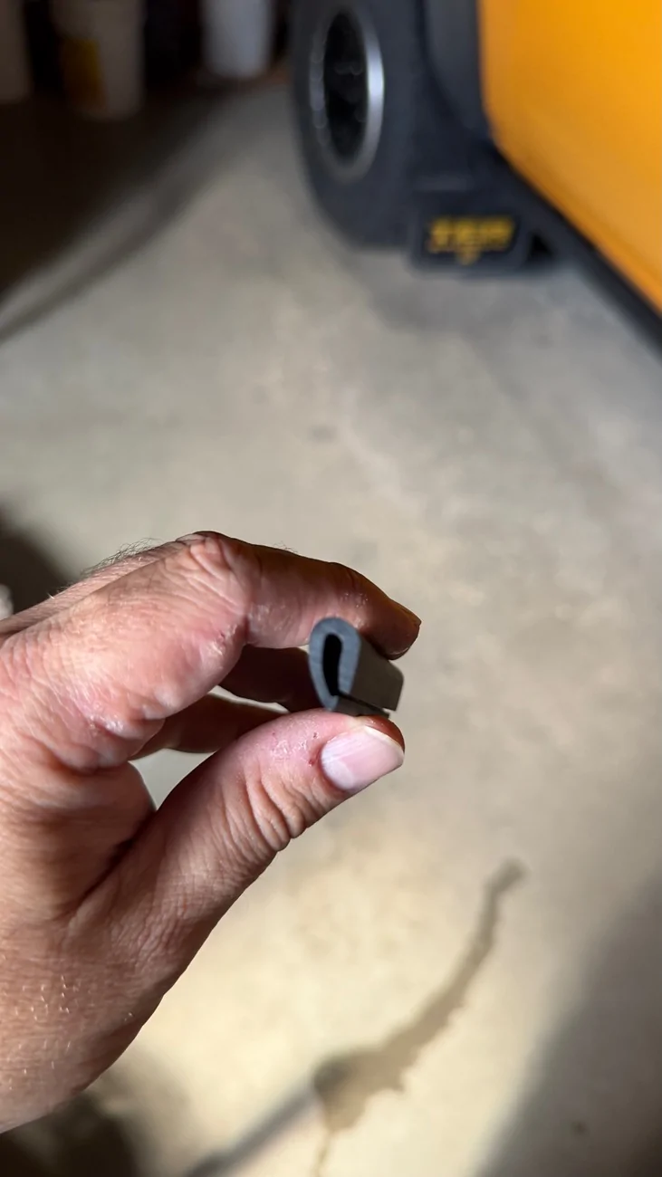

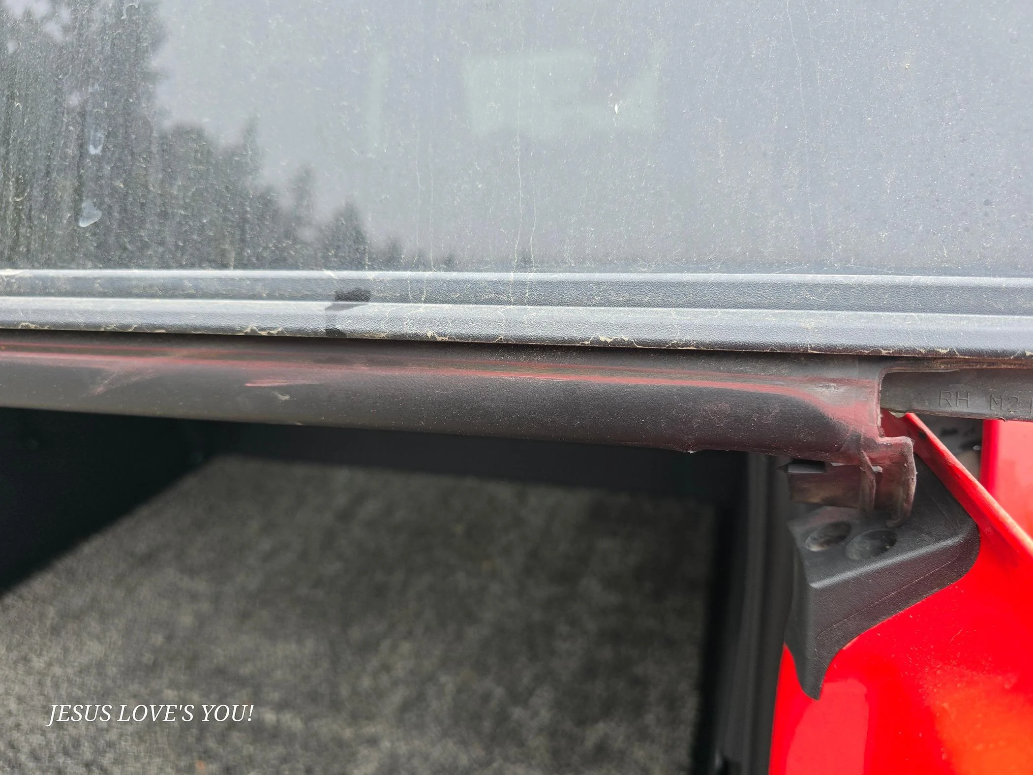

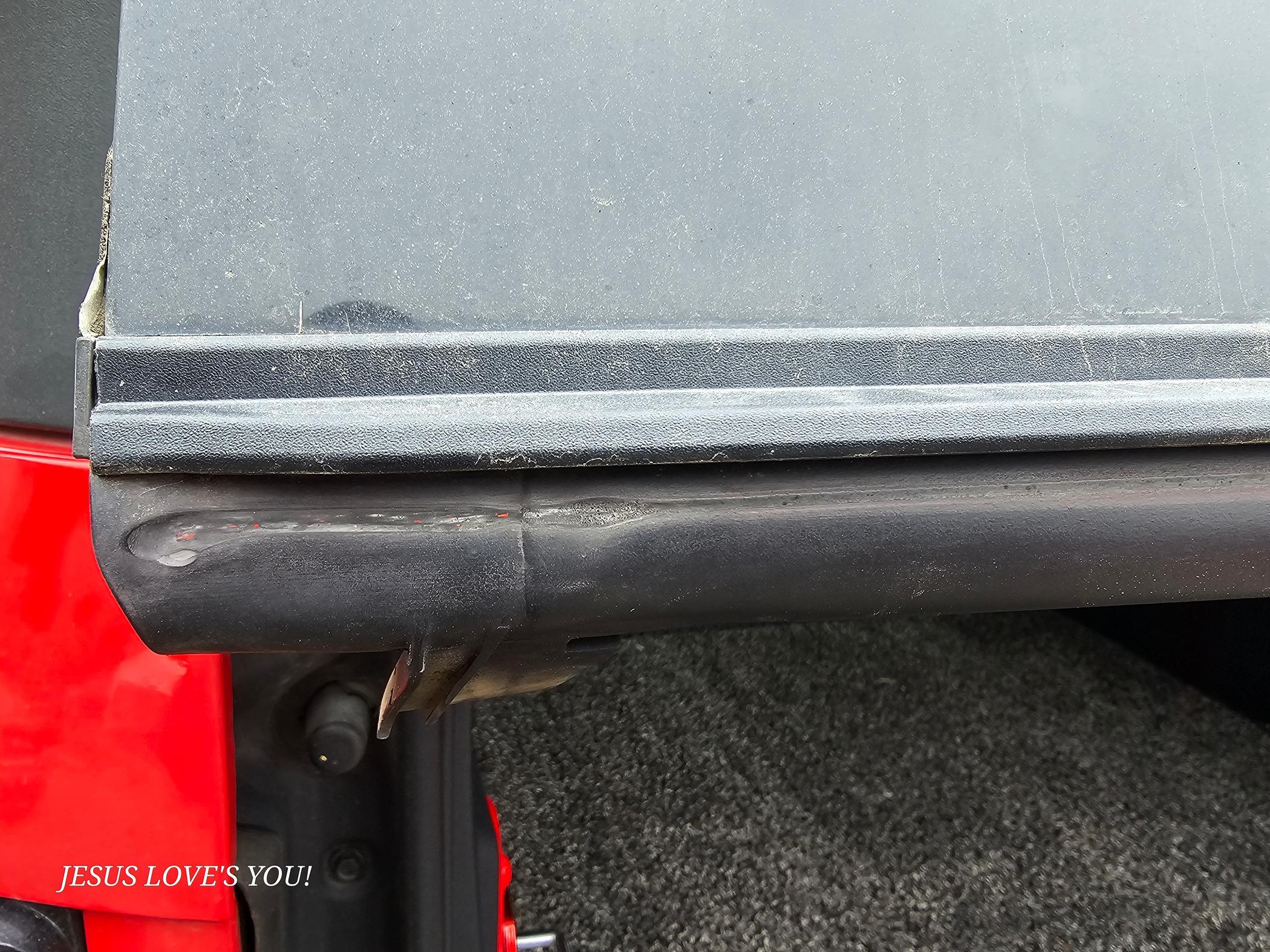

Update on rear tailgate door paint rubbing off. Ford paid to have rear tailgate door repainted and 3-4 months later it came back. Took into my local dealership and they said I needed to deal with the body shop for warranty worm. "To there surprise I had stopped by the body shop before going to the dealership and was advised to take it back to dealership as there is a defect.
Was able to get a copy of the TSB 23-2355 dated November 20th, 2023 which happened to come out just before the first repair was done on the rear tailgate door paint rubbing off.
Ford Motor Company provided financial assistance for this second repair "great". I shouldn't be having to pay anything except for all the rear tailgate seals I chose to replace due to wearing and grooving in the window seal at the bottom were it makes contact with the tailgate. Under warranty coverage should have taken place for all of this issue and having a TSB is my life saver as it came out just before the second repair under the warranty guide lines. Which, in return should have had rear tailgate door and hinges replaced and repainted.
If anyone can reach out to me in a private message and knows someone who can do a Algorithm showing how many Broncos are there having this similar issue it would help not just me in my situation. Everyone else going forward with the same issue as they don't want legal issues or more recalls.

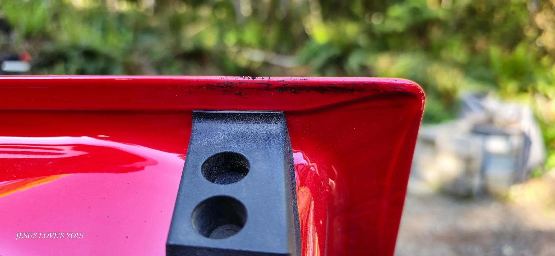

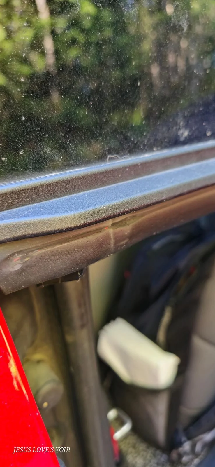

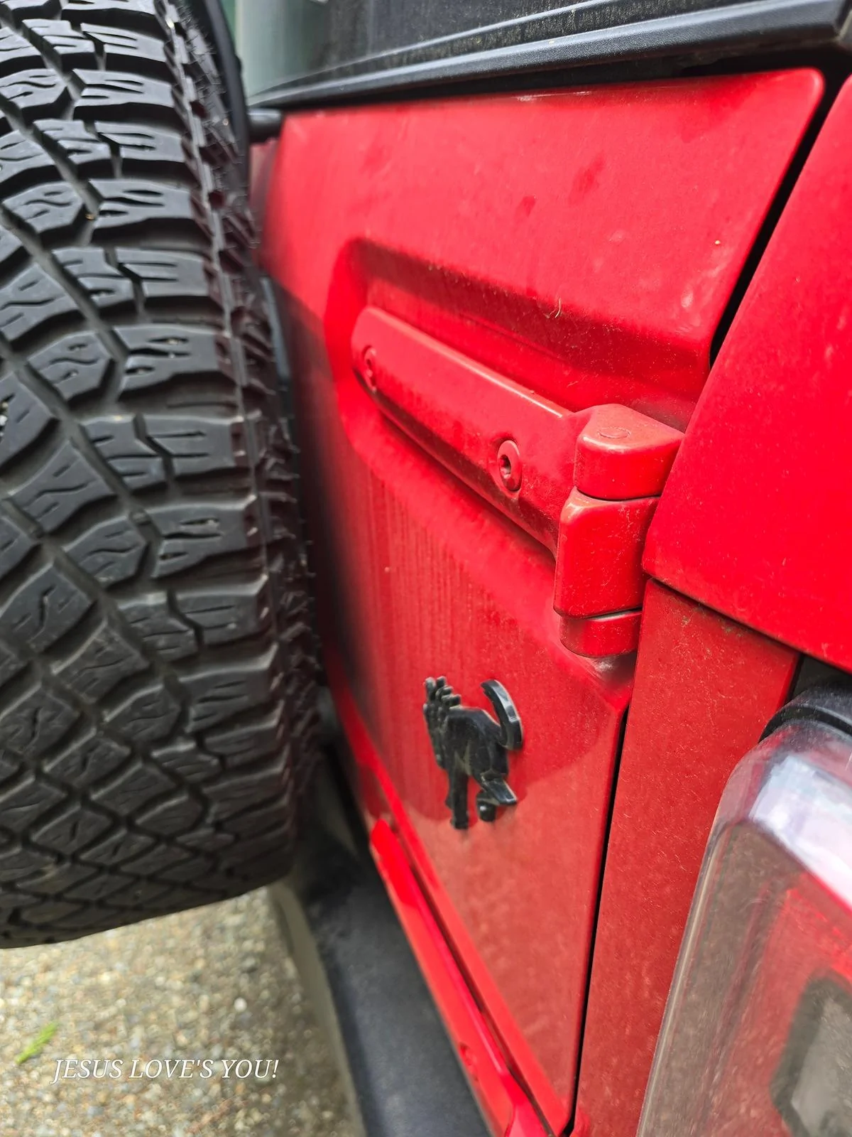

Are you referring to the rub marks on the weatherstripping with the red? Has that actually rubbed off the paint off the back of the tailgate? There is a clearcoat that should be between the paint color and the seal, but that paint looks like overspray not "rubbed" paint. The middle picture shows obvious rubbing marks in the seal, last picture is overspray.

It is all caused by rubbing, yes it ward off the paint down to primer and metal.
I will try and provide a picture of the rear tailgate door before it got replaced and repainted. There is no over spray!
Thank you for your response and question.

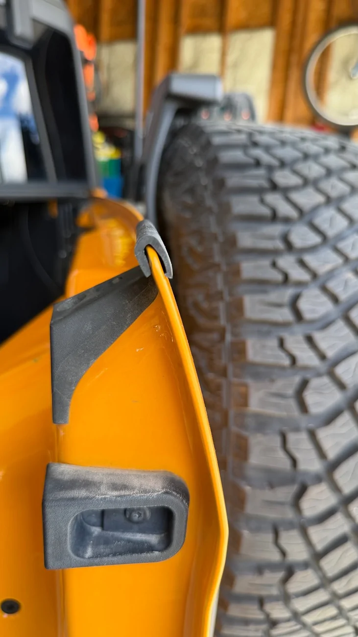

Ford Bronco Rear tailgate door paint rubbing off! 1000000791
Ford Bronco Rear tailgate door paint rubbing off! 1000000792

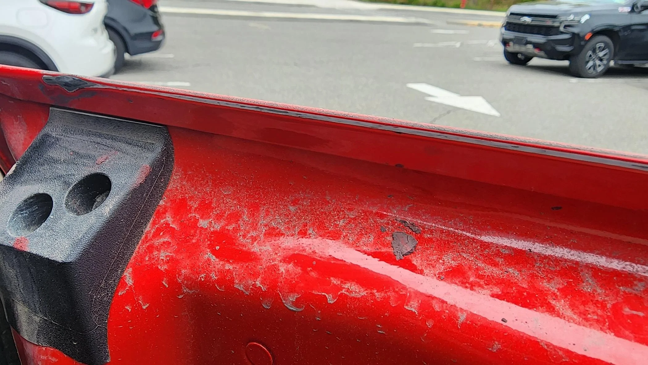

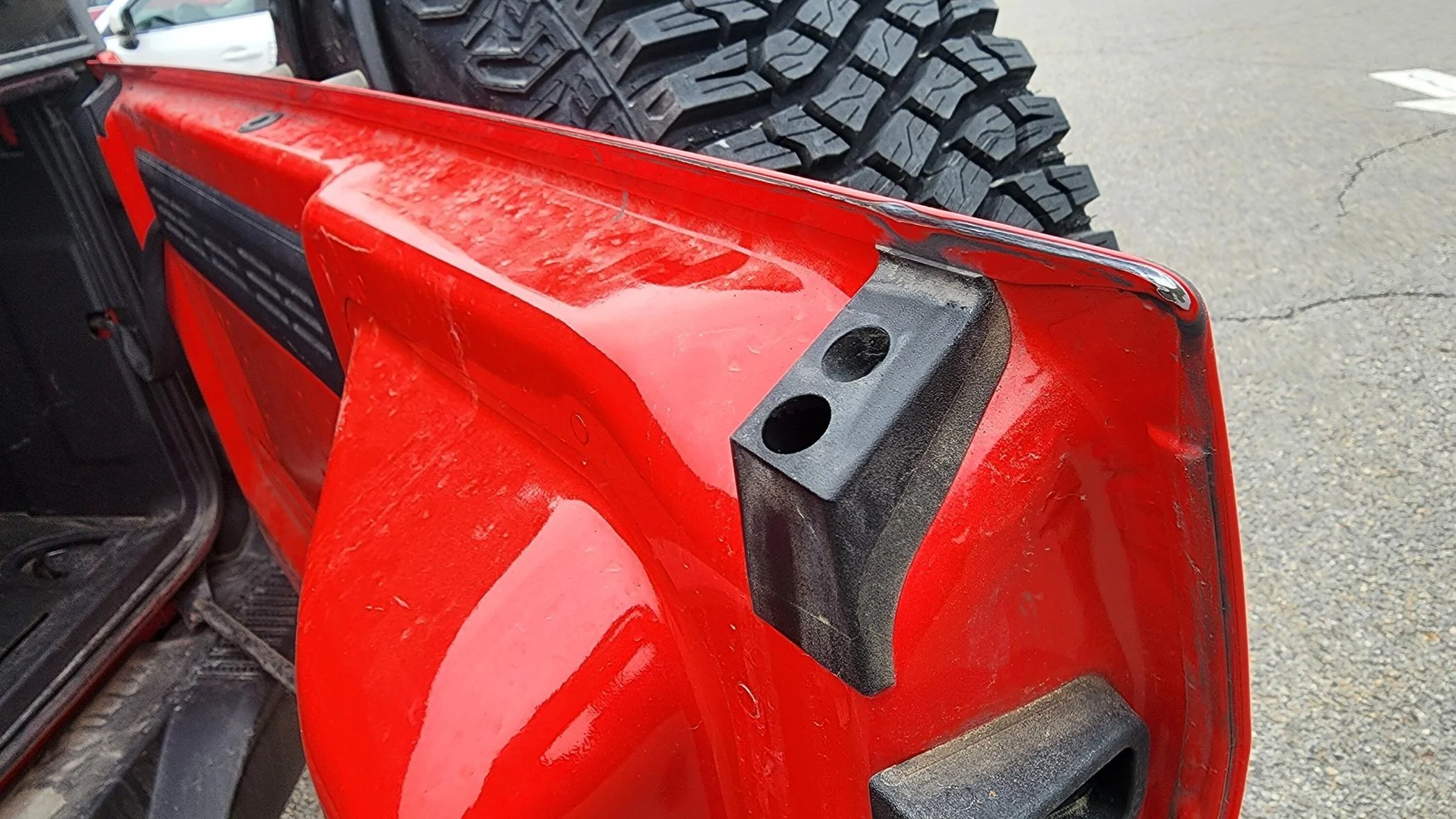

These are identical pictures of the issue I'm having and found them in a thread on this website. I'll, try to get pictures of mine posted soon.

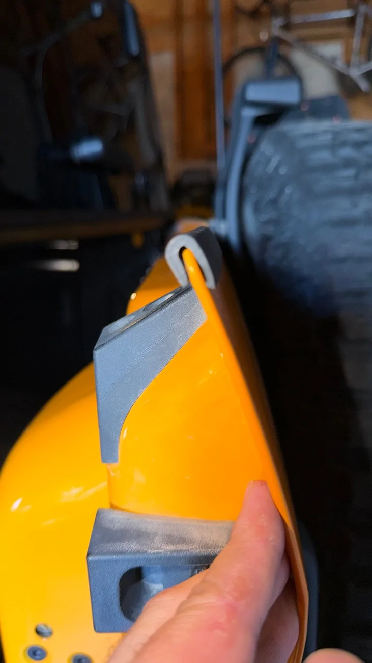

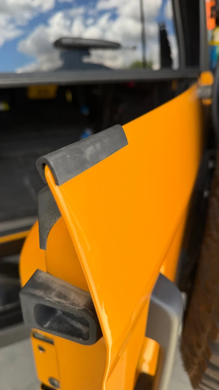

Here's my .02. Take all of the hard top panels off and remove the locating pins on the cap. Reinstall the cap with 2 hold down screws loose. Move cap forward slightly, snug the two screws and notice if there's any difference in pressure on the rear seal. Continue this until there's some pressure on the seal but not smashing. Ideally, you'll have a new seal on before doing this.
I put a hard top on my '21 and transferred it to the '22 and now on my '23. The seal is smashed more on the '23 than the previous two but I've been too lazy to mess with. You may end up having to slightly slot the hold down holes on the cap and upper brackets but I think your issue is due to some tolerance stacking between the cap, glass, seal and gate. Looks like the gate adjustment is good so need to go after the other stuff and maybe try to split the difference.

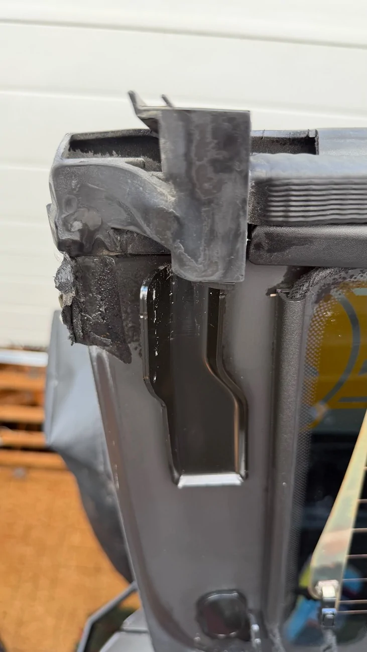

Silly question. I assume they checked the top lip of the gate to make sure it wasn't assembled incorrectly or that the gate itself isn't messed up?
