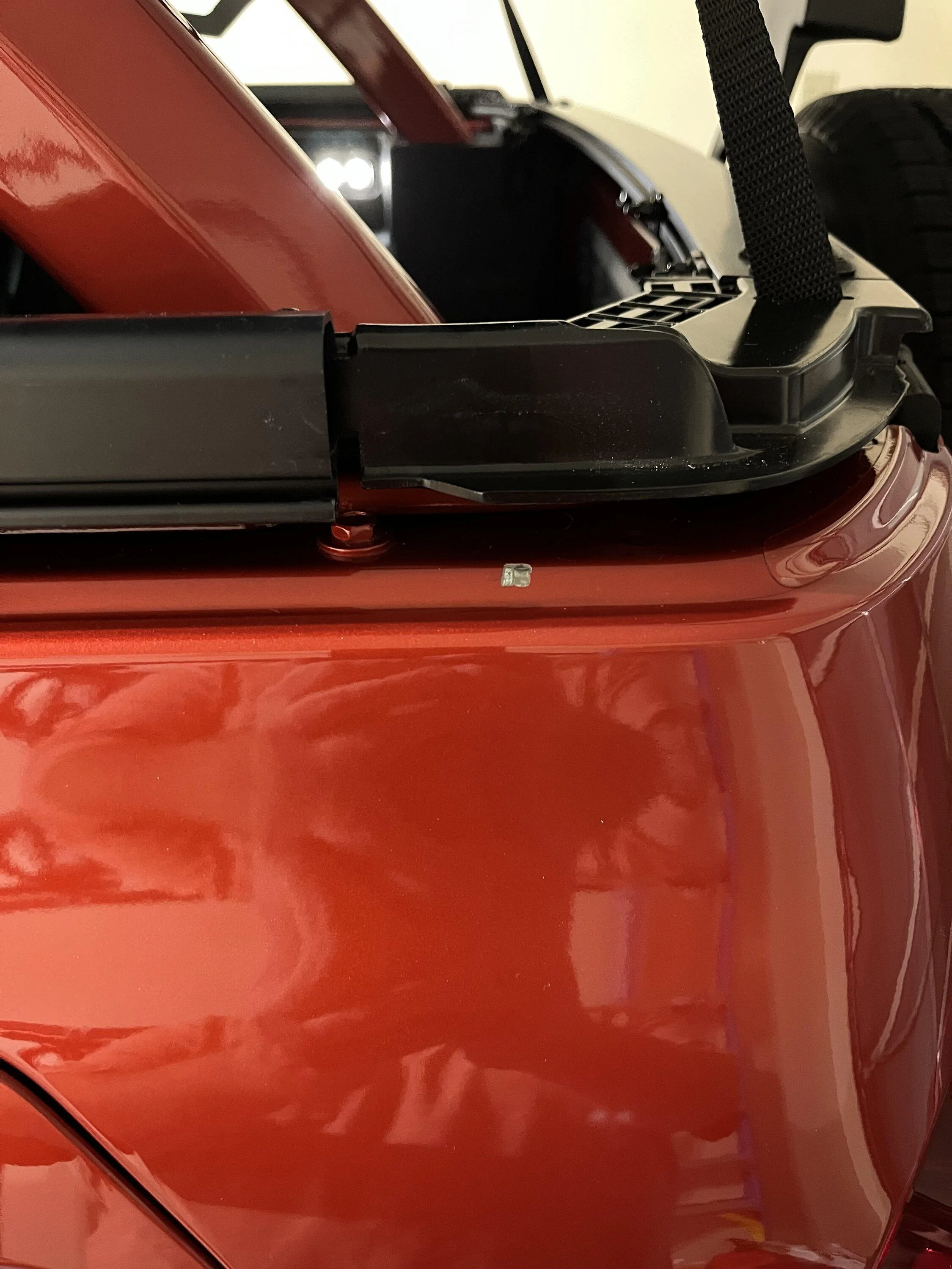

I flipped my rear hatch of the soft top up a couple weeks ago for the first time when I was cleaning the bronco and noticed two wear points in the paint “same spot on both sides. This is at the far rear where the side vinyl window comes together with the back section. Has anyone else had this issue or found a fix? For the time being I used some 3m felt over the wear points, but it already looks like it will wear though over time. I had throught about bed liner in a small section. 🤷‍♂️

Mine isn’t rubbing the pillars, it is rubbing the top of the fenders. It’s almost like the frame goes down too far allowing the contact. I was thinking about trying to adjust it, but I have my first service coming up and will probably just let the dealer deal with it.

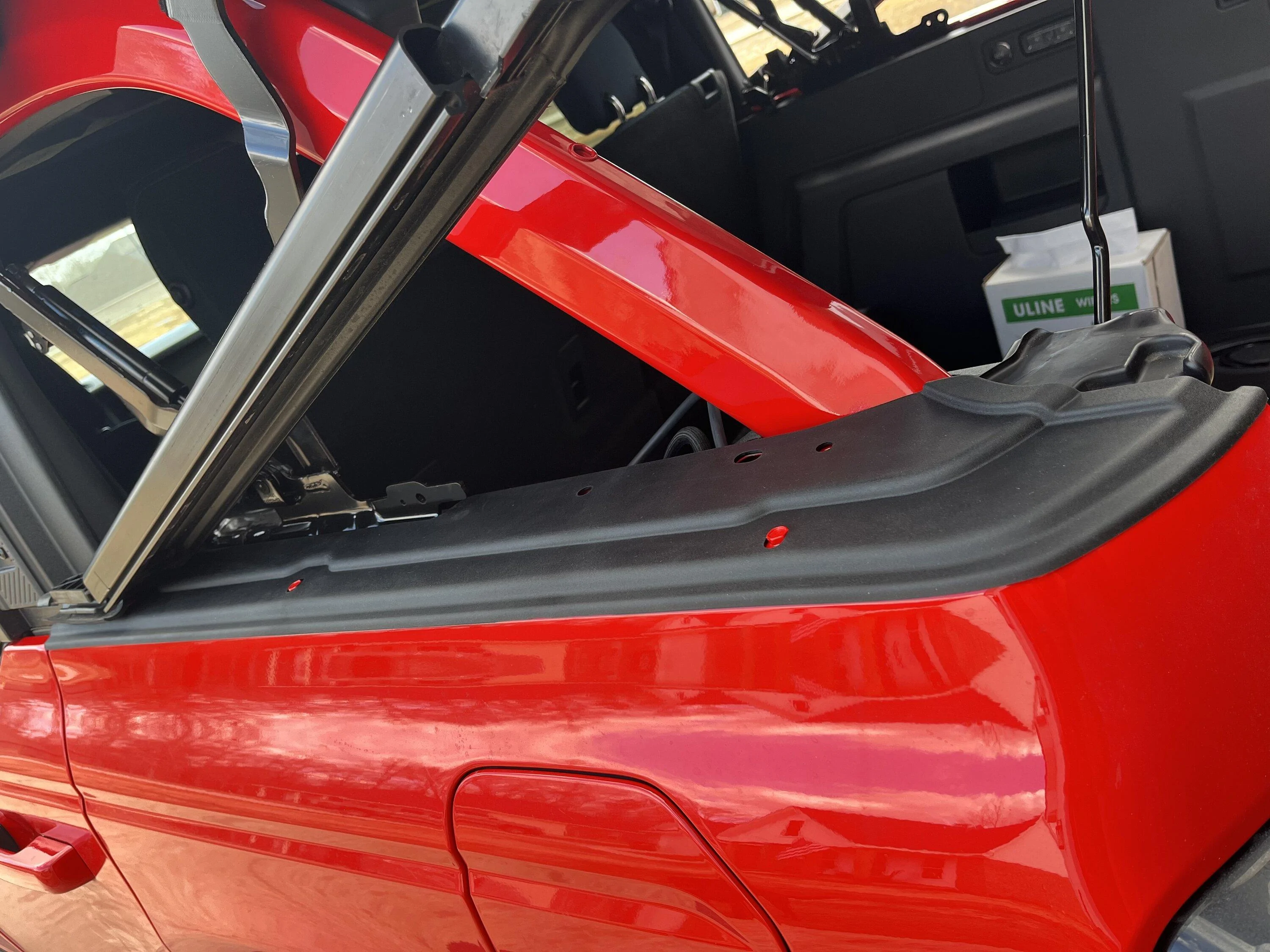

I have the exact same problem with mine Did you find a solution to the problem? I noticed on mine the rear window corner inserts have metal tabs and the bottom metal tab rubs the paint completely off down to the metal.

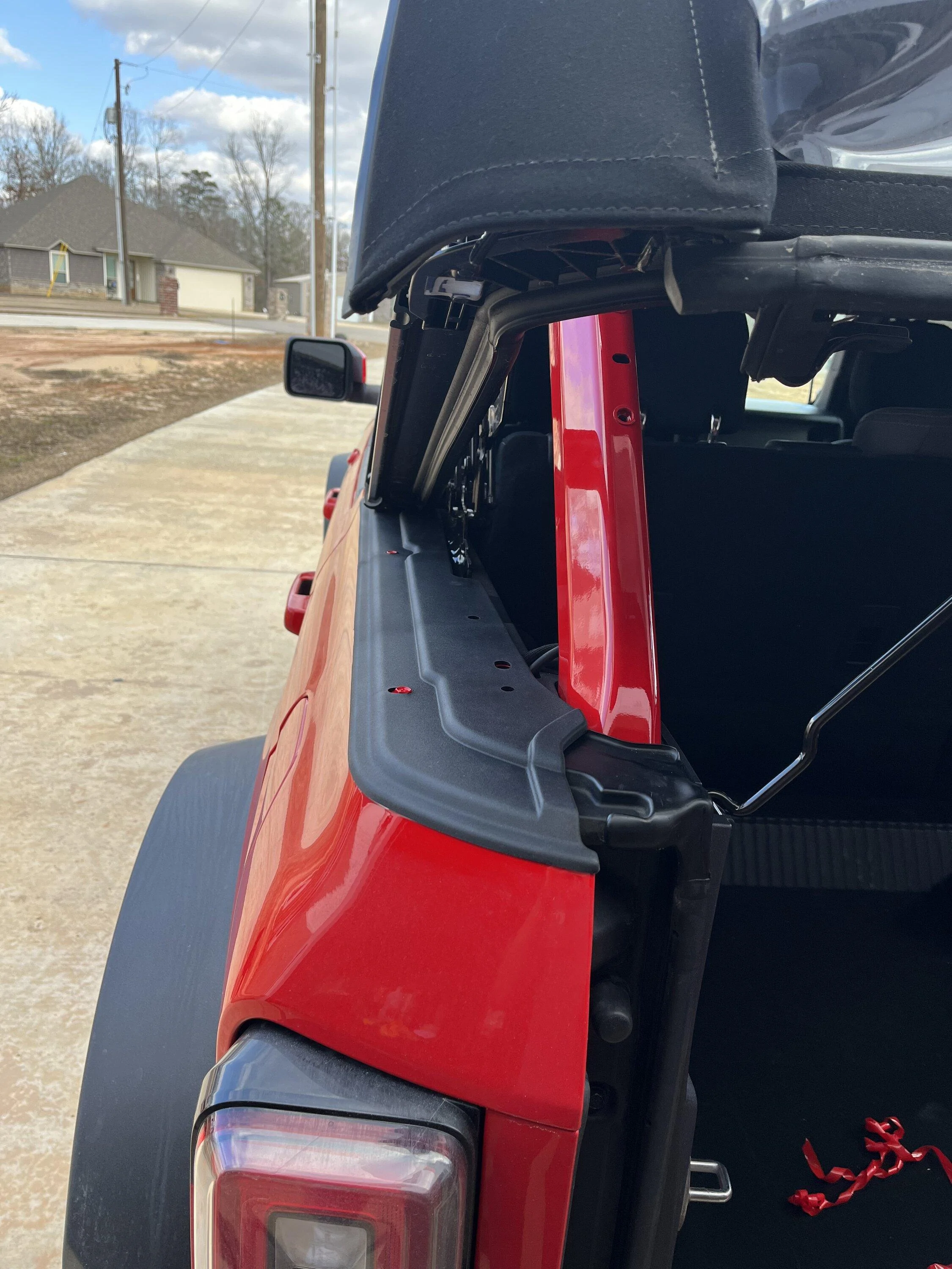

There was an early (in 2021) TSB on rubbing with roll bar and the fix was clear 3M tape. Some peeps fixed on their own with felt tape.
Rubbing on the top of the fenders would call for 3M tape along fender top. Think bug shield or spray on plastic coating like we used to coat bottom foot of vehicle bodies in the 70s
Add additional rubber or foam weatherstripping at bottom of top frame. Maybe what's there isn't there or not where it should be

Mines rubbed through the driver fender In The same spot. If I go to the passenger side there is a pretty nice gap between that piece your talking about and the paint but on the drivers side it’s 1/16” or less away from the paint. I temporarily put some ppf there but I believe the soft top needs adjusted to fix the issue. I was also looking at gas struts that lift the soft top as they seem to hold the soft top up against the latch instead of resting on the body which might give some extra clearance too.

My dealer ended up replacing my entire top/subframe. They replaced every piece. I honestly haven’t even checked to see if the rubbing has been resolved. They wanted me to drive it for a month or so and see if the damage worsened. If this resolves my issue they will then repair my fender corners in the paint booth. I will inspect later today and keep everyone updated.
