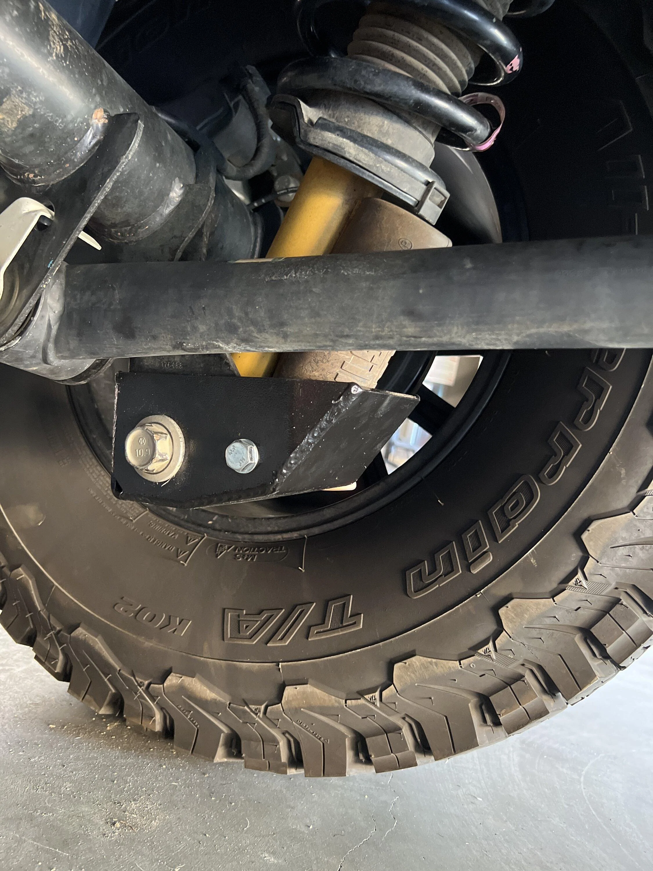

FWIW the Valkyrie versions have drain holes for salt, sand, mud, etc.
Ford Bronco Rear Shock skid plates 73CBC49F-37A9-429B-B207-18D22C81E270

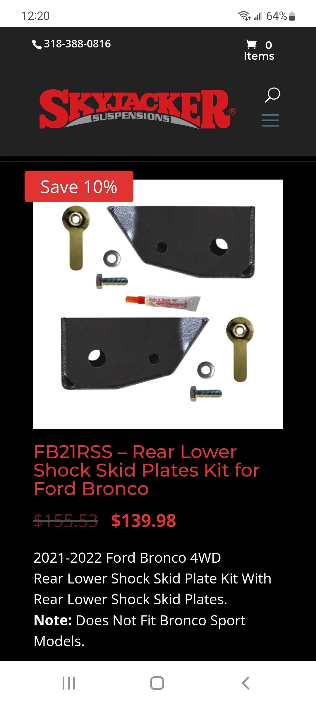

Skyjacker released theirs at a reasonable price and the skid fully covers the back. I may purchase
Ford Bronco Rear Shock skid plates Screenshot_20220515-122010_Samsung Internet
Just received mine today. I will head outside to install them once it cools down a bit this evening. I'll post some pics later tonight or tomorrow.

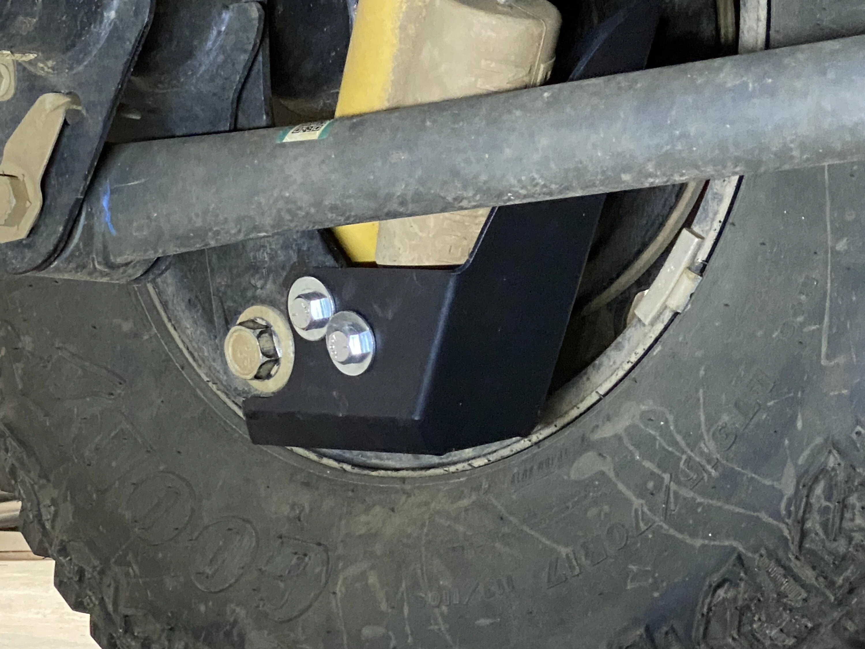

I went with the @JcrOffroad skids, too. Very happy with the 3/16” thick steel and the reservoir protection. (y)
Ford Bronco Rear Shock skid plates DEC44037-6152-41F1-BBED-484115091E81

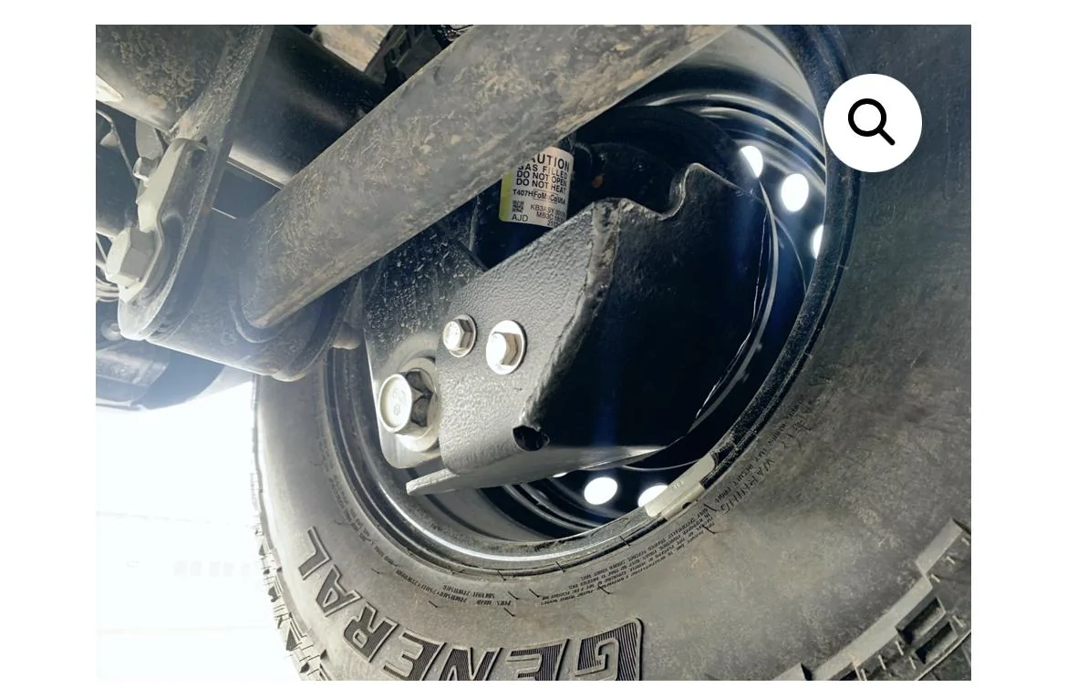

I also went with @JcrOffroad skids, Full protection of the reservoir, angled bottom surface for drainage, .120" thick steel.
I was already pulling the shocks out to add a lift, so it just made sense to install a skid plate at the same time.
