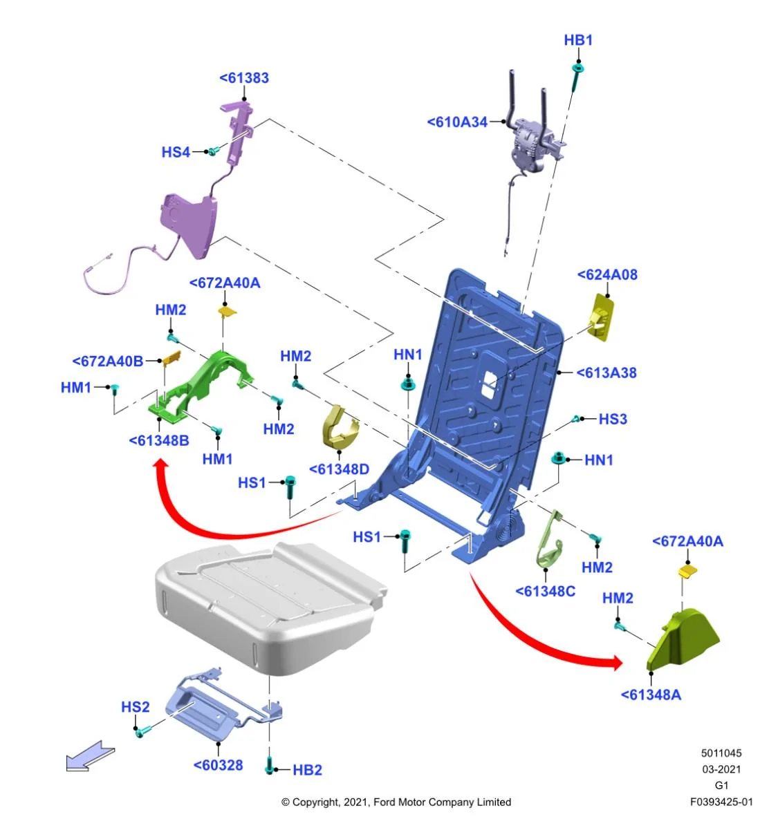

Going to add to this. Looking for diagrams or videos. 2 dr rear driver bike cable came undone. I move my rear seats up and down often. If I just move carefully I can fix this? Looking at seat from front the cable is under rear driver side seat on left, detached at an obvious connection, little silver hook looking part. The plastic covers pop off? Under warranty but I rather fix if can.
Soulstice
Bubba
Mar 27, 2025
43
just shy of heaven
Ford Bronco Rear seat fold down release broke IMG_7580
Not easy to navigate, for me anyway, but finally found this. The clips are a pita to remove with junk tools from internet, end up cutting them out and replacing, and I do like the oem clips, whatever, save money doing the work myself I guess. The 61383 wire, looks like a key, had fallen out, goes in key-hole, wire holder had fallen off, press that back into tiny welded wire holder, 5 clips to remove cover, pop it all back together, buy a few new clips, seat fixed. I would love to just have money sometimes and have everything done for me, but, it’s cool, does feel good to get into this Bronco and mess around and really learn about her. I hope she appreciates it and runs forever…
