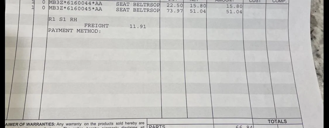

I ordered the buckles in preparation for my seat delete project. I bought from Ford OEM Depot. It is interesting that one buckle was much cheaper than the other. Not sure if I could’ve just bought two of the cheaper one to use.

I ordered the buckles in preparation for my seat delete project. I bought from Ford OEM Depot. It is interesting that one buckle was much cheaper than the other. Not sure if I could’ve just bought two of the cheaper one to use. View attachment 609566
For destructive purposes to only use the sensor harness, it shouldn't matter which buckle assembly is ordered. AFAIK, the assembly is specific only for the orientation of the anchor and the buckle itself.

That’s good to know. Pretty cheap then.
