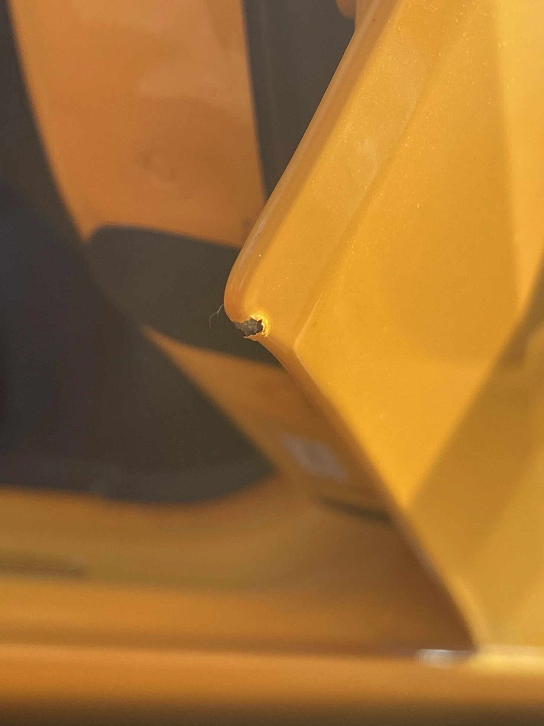

Just checked mine and yup, I have the same chips on both passenger & driver side rear doors. I’m guessing this is an issue with every bronco. I’ll probably just throw some touch up paint on it at some point

Well this is fun. Dealer can't provide an ETR as they had to outsource the fix to a body shop who only went off the photos I took, but thinks due to how deep the chip is they need to repaint that area vs just doing a little touchup. I'm starting to regret taking it in. I should of just touched it up myself @Ford Motor Company

I noticed this last week my 2 door bronco paint is chipped in both corners too

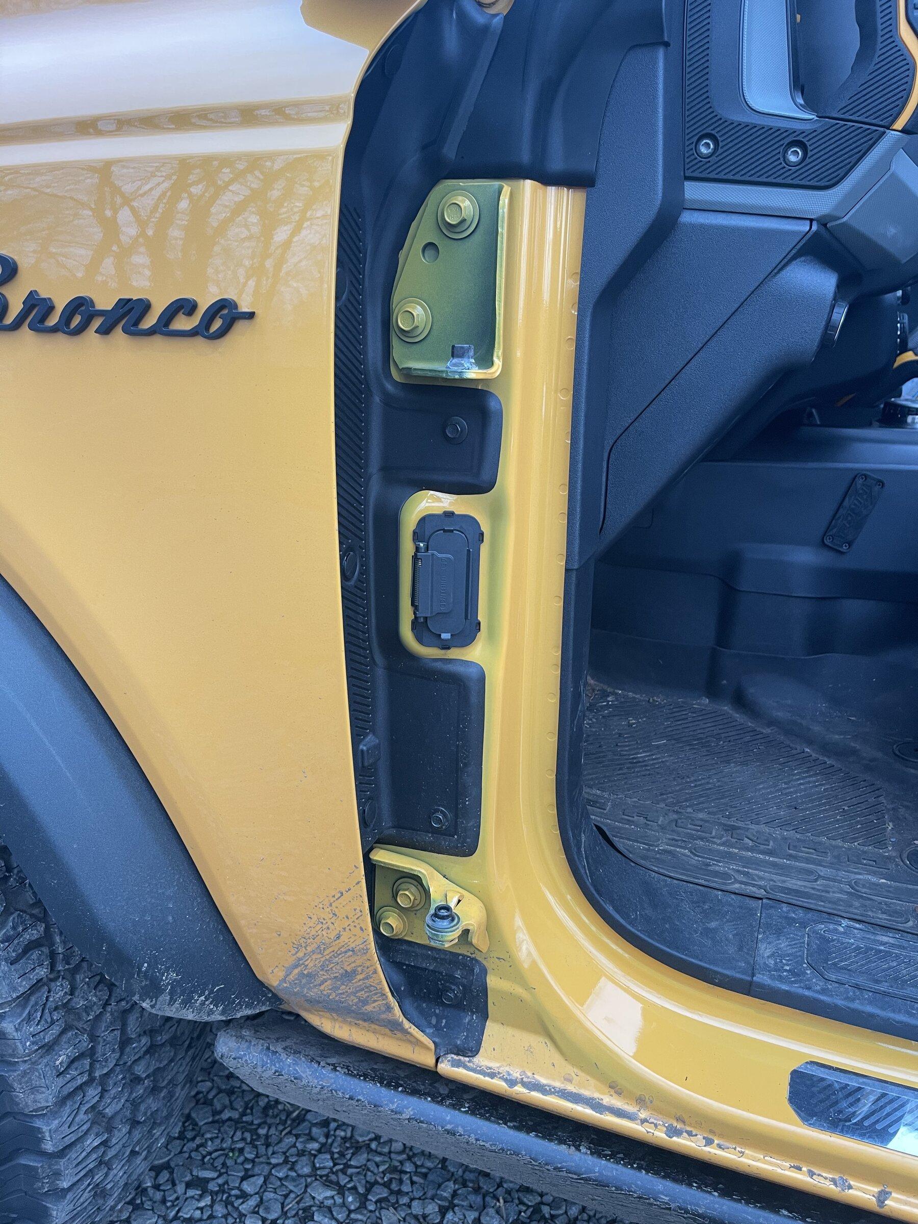

I noticed mine a few weeks ago when I was detailing and putting on a ceramic coat. I’m taking it in tomorrow to have it looked at. I’m also going to press the issue of the front door hinges not getting a solid coat. My argument is if they give you a tool kit to remove the doors (and will sell you bags to store them), the obvious areas should be fully painted.
For the record, I’ve only removed the front doors, not the rear, and both of them have the bottom corner chip - one worse and bubbling.

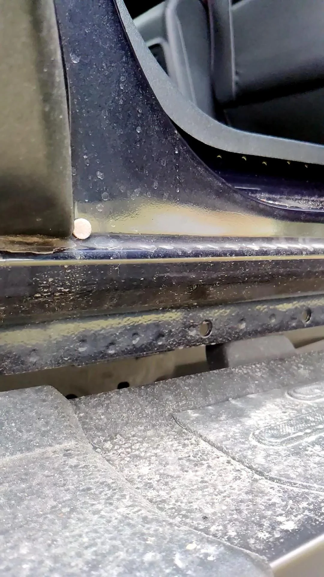

I’ll go ahead and eat crow lol. I was putting on door sill protectors today and noticed a line wearing wearing where the door contacts the sill. I’ll have to get some extra ppf down there as well. So my apologies lol.

I looked at this again and noticed that all my doors seemed to be in very good alignment. What I did notice is that the bottom corner of the door has pretty bad flex issues. When shutting the door the entire bottom corner flexes and strikes the door sill area. I recorded shutting the door in slow motion and you can really see the bottom corner flexing and vibrating. I put some stick on pads, where the corner was striking, but it's not a proper fix.
Added video. And after watching more the entire door flexes and bounces
Still if you only have a scratch in ppf it might self heal. You may want to look into door alignments to prevent additional damage.
