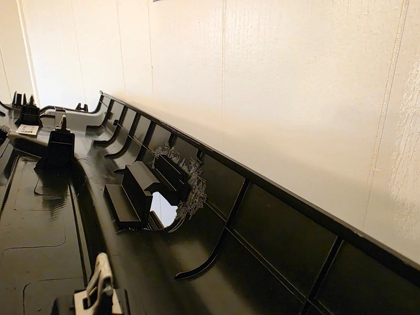

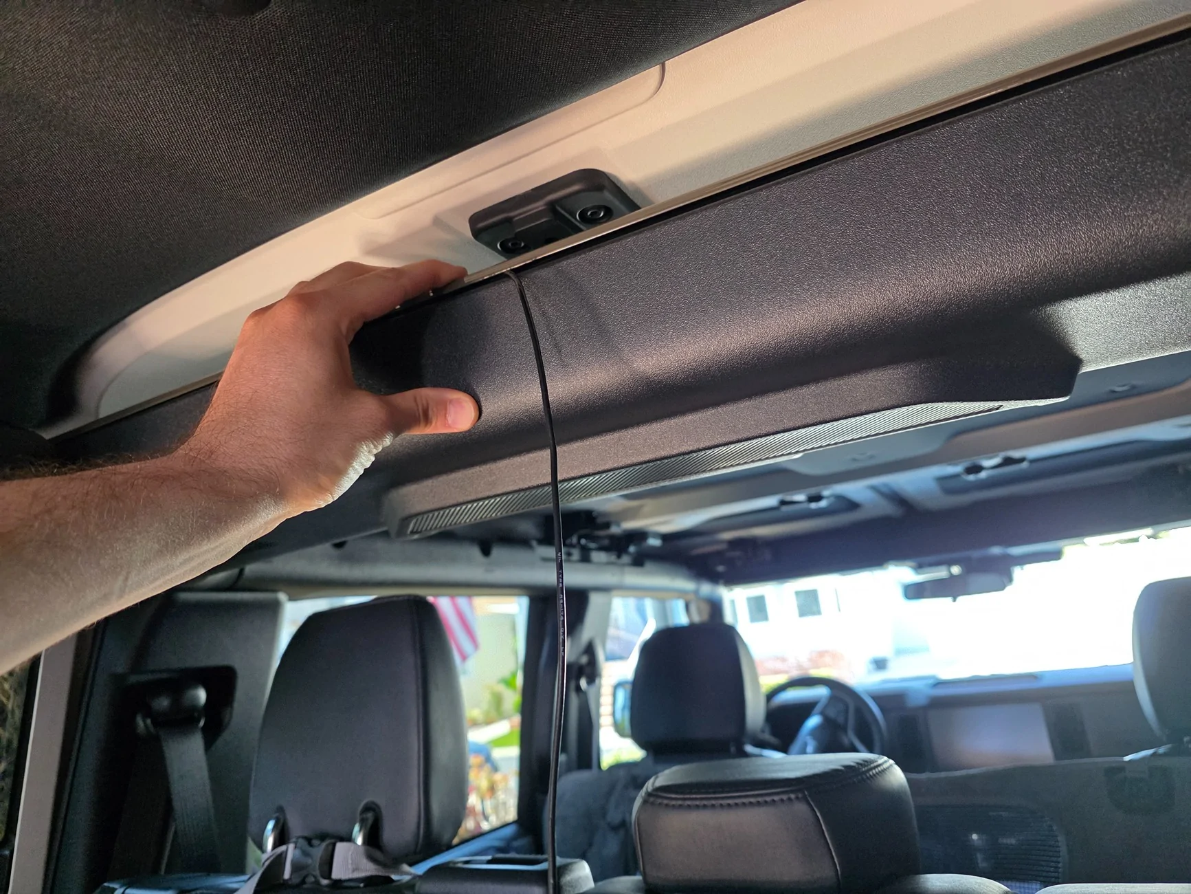

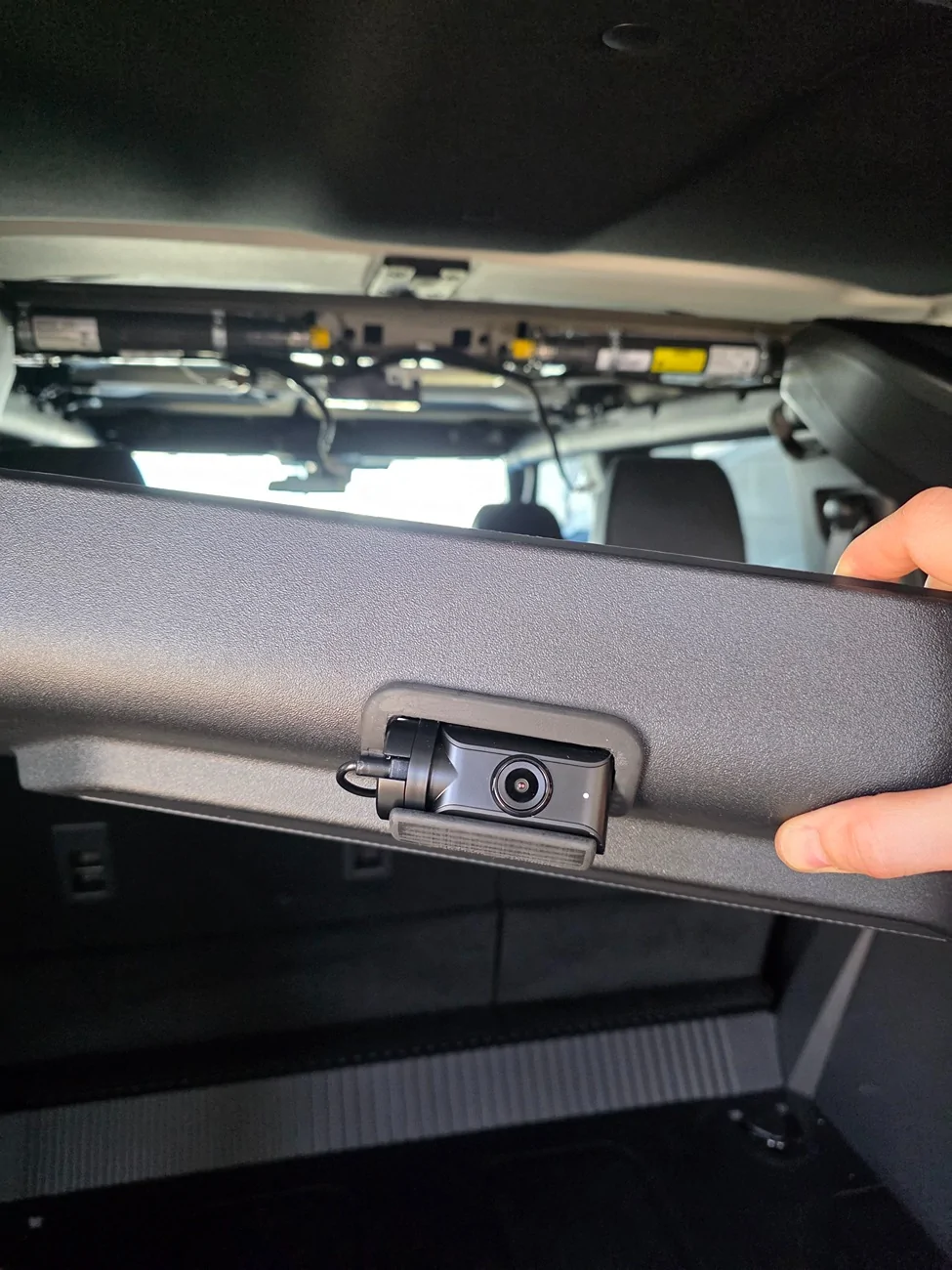

Here is the piece of trim with the dashcam wire run to it:
Ford Bronco Rear Dashcam Holder/Mount - 3D Print 20260525_141504

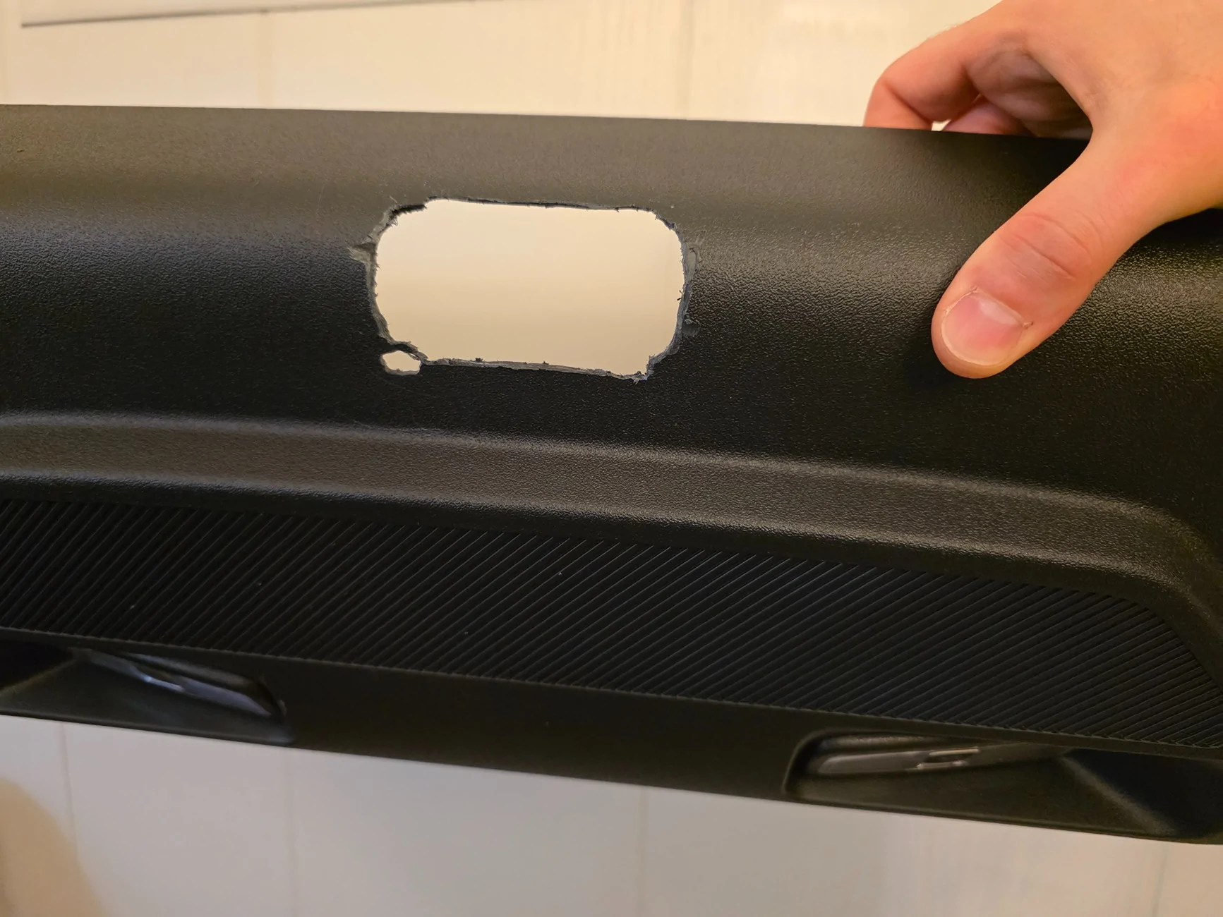

Here is the dremel cut (the least fun part):
Ford Bronco Rear Dashcam Holder/Mount - 3D Print 20260531_201514

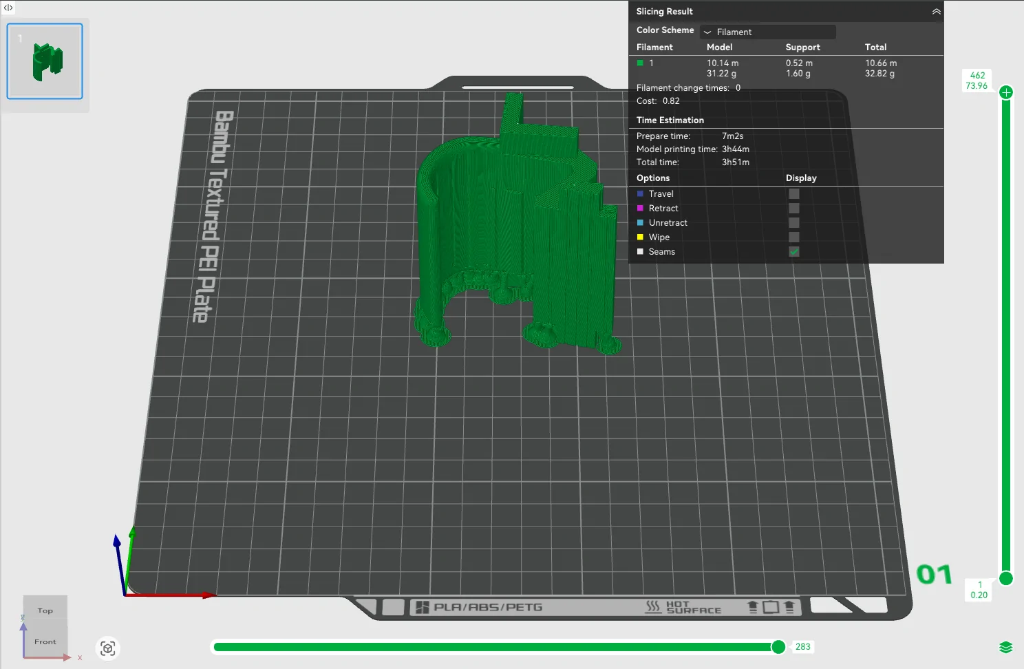

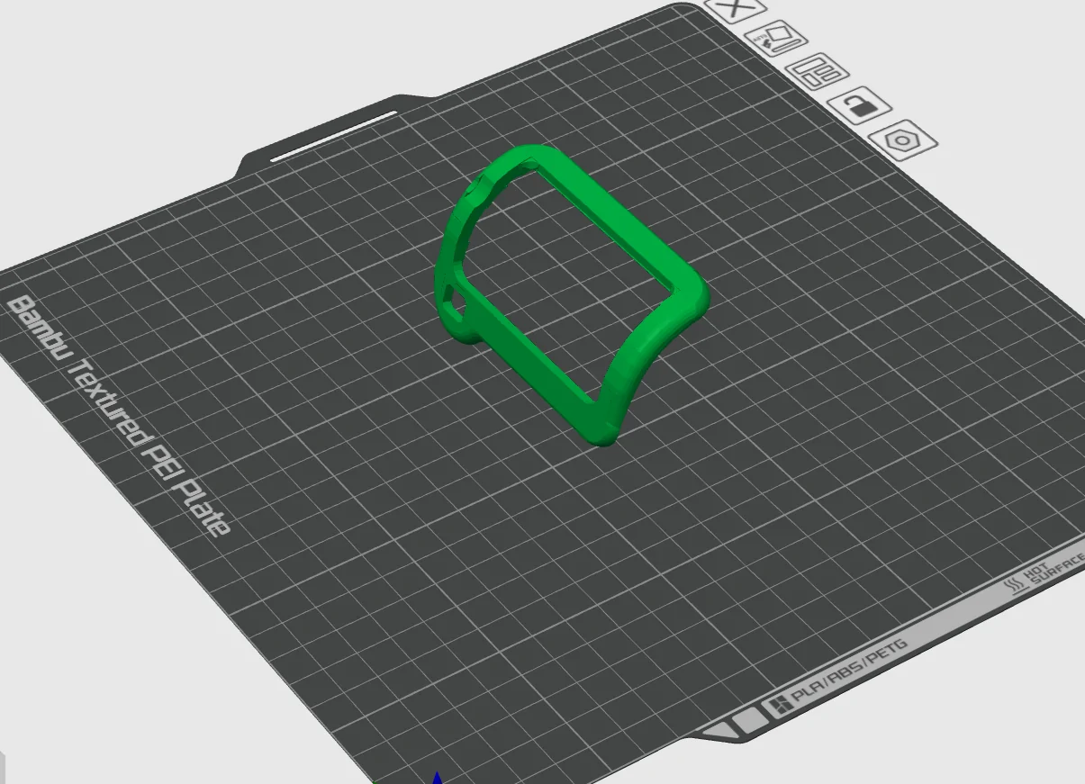

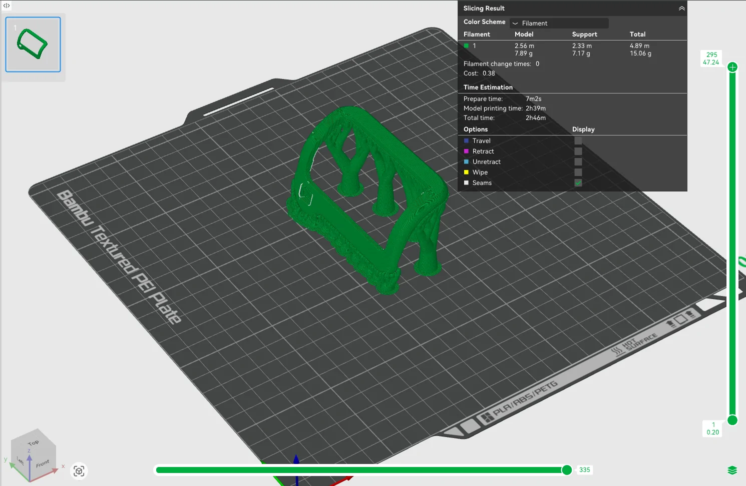

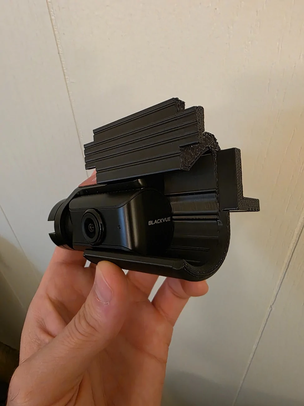

Here is the 3D model ready to print (you can see it cost $0.82 in filament and took 3hr51m to print):
Ford Bronco Rear Dashcam Holder/Mount - 3D Print Dashcam Holder Print

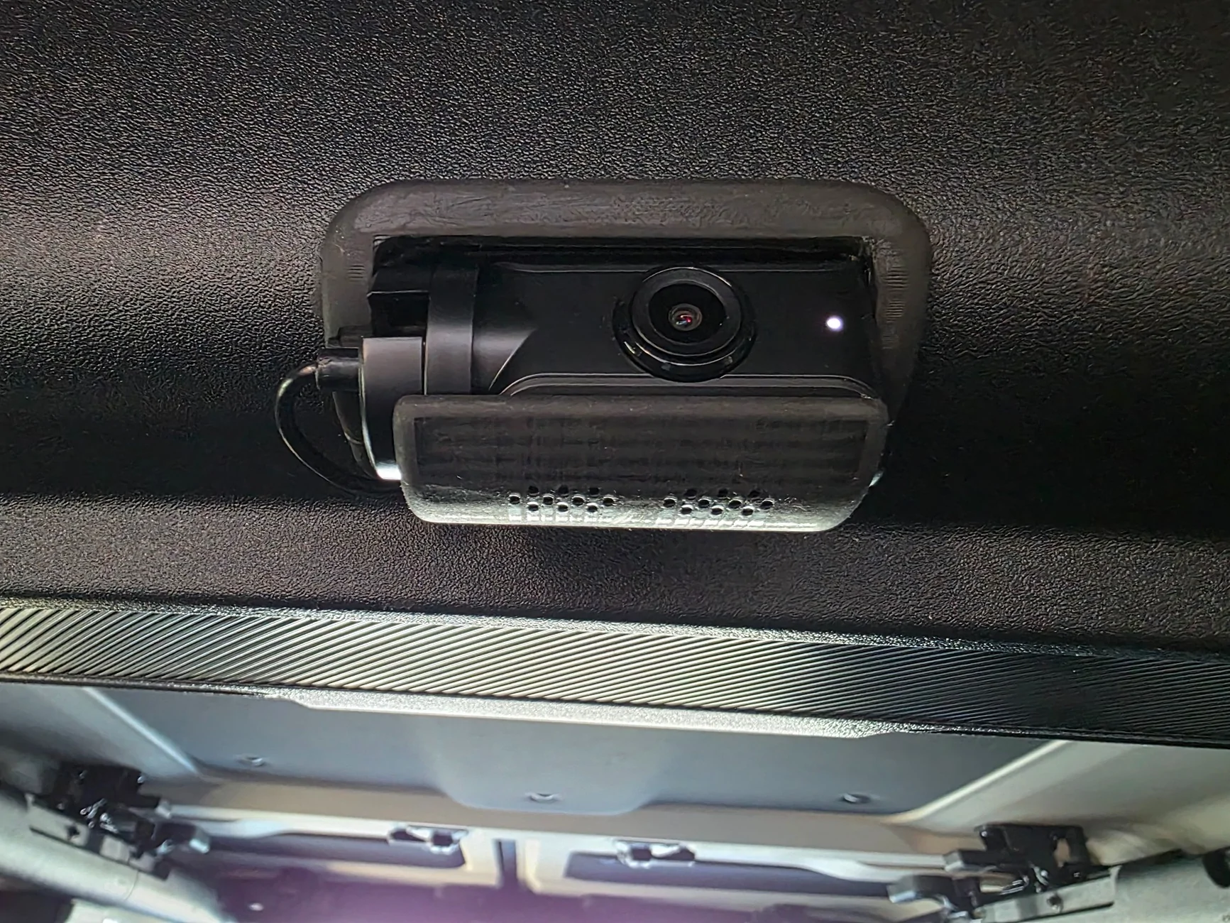

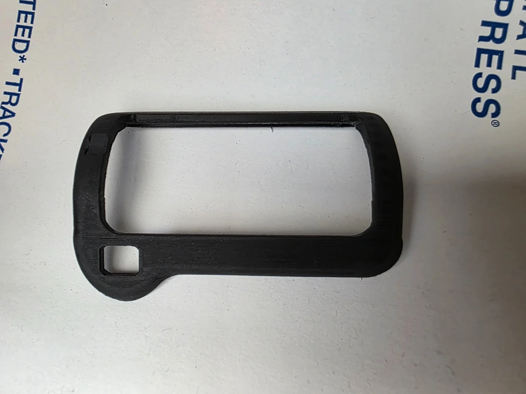

Bezel:
Ford Bronco Rear Dashcam Holder/Mount - 3D Print 20260601_130805

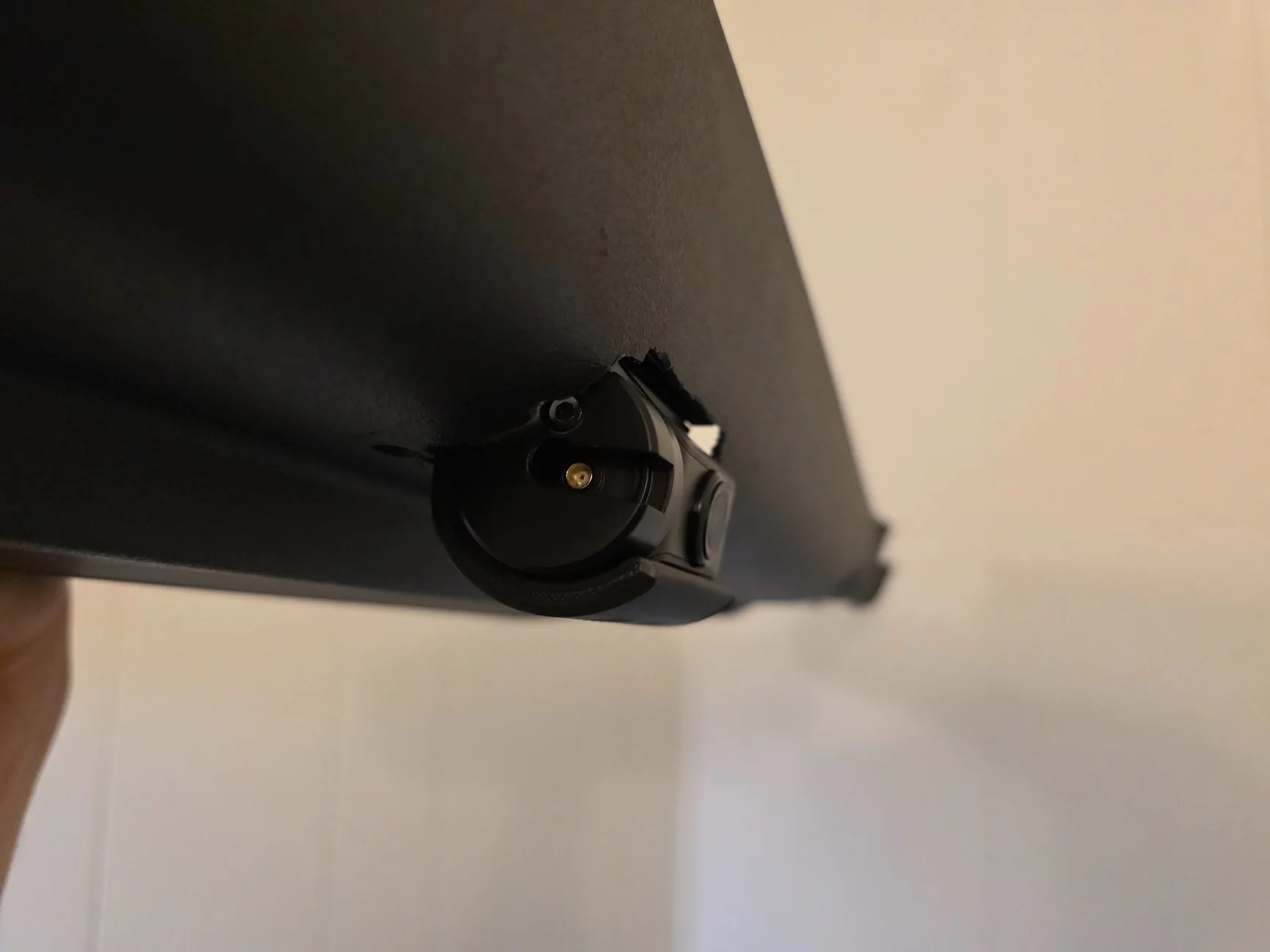

Camera in the holder:
Ford Bronco Rear Dashcam Holder/Mount - 3D Print 20260531_201205

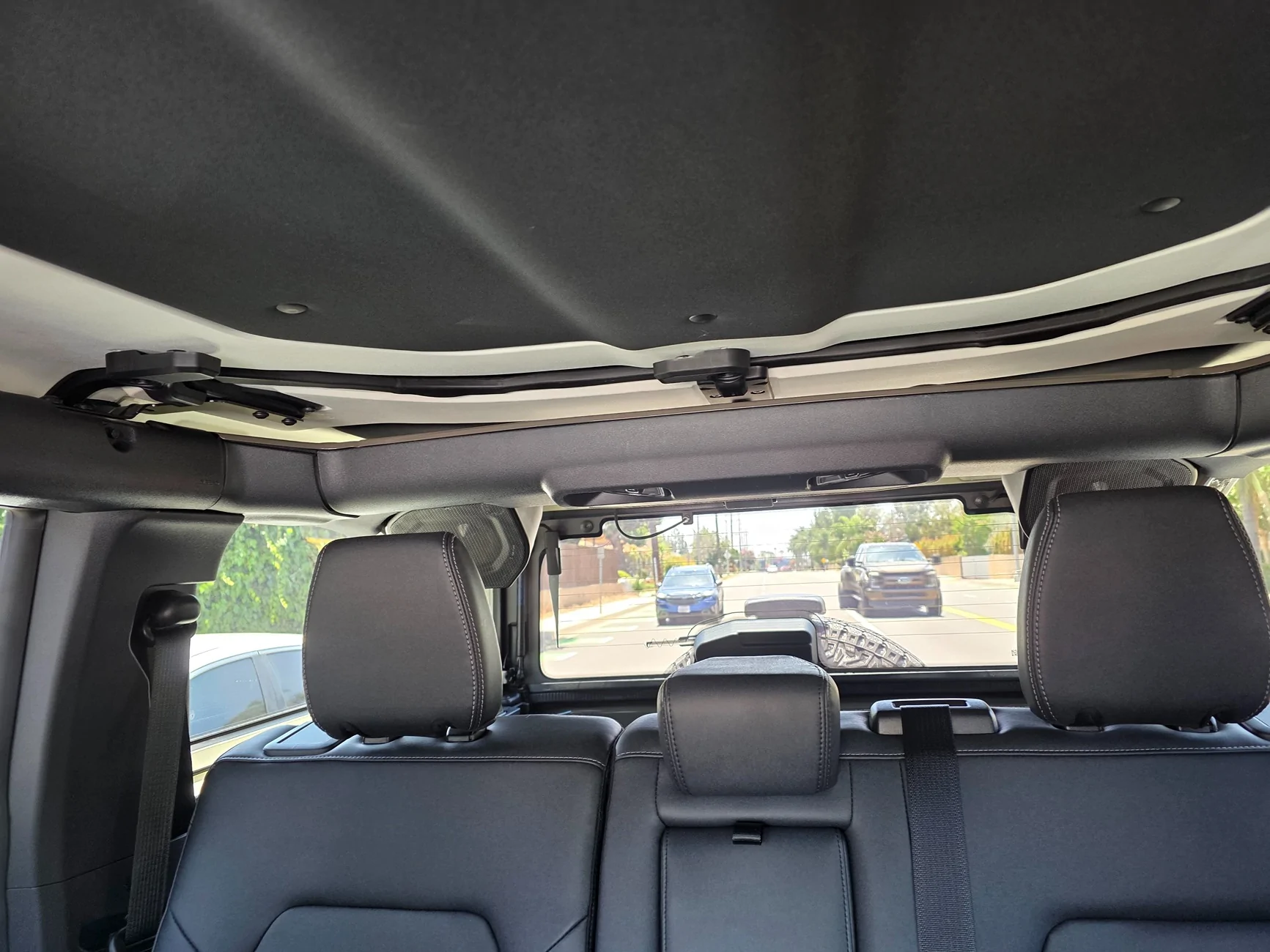

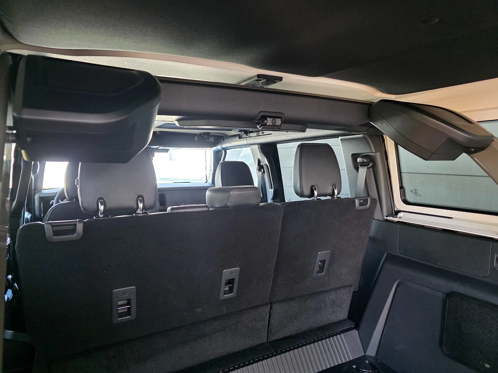

Install:
Ford Bronco Rear Dashcam Holder/Mount - 3D Print 20260604_114323

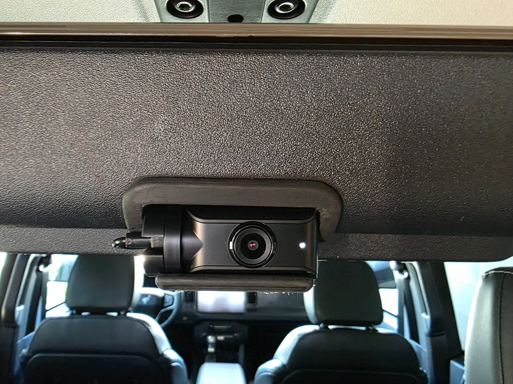

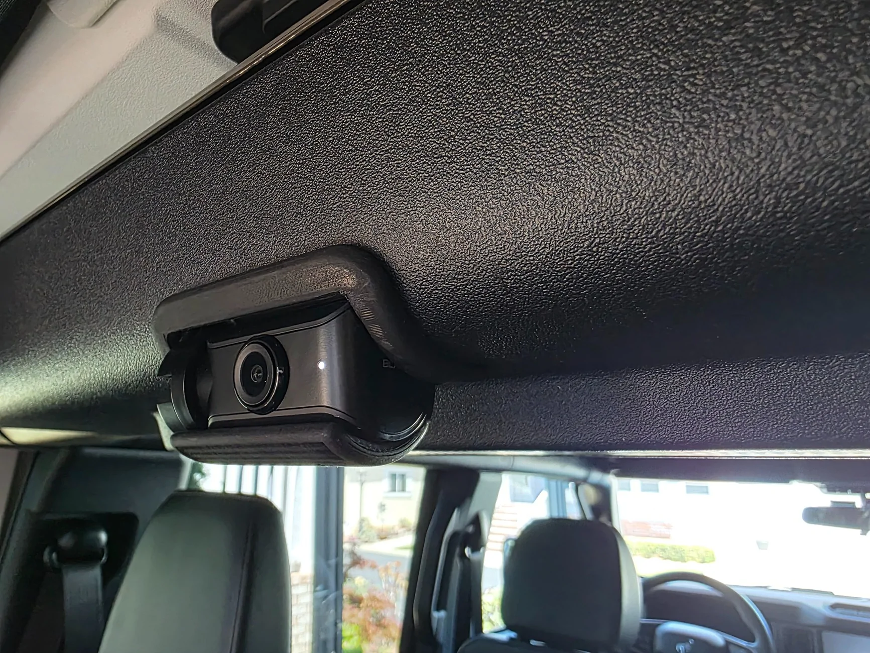

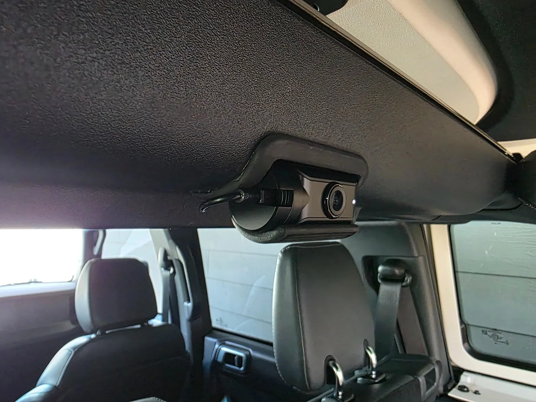

Finished product:
Ford Bronco Rear Dashcam Holder/Mount - 3D Print 20260604_115519
Ford Bronco Rear Dashcam Holder/Mount - 3D Print 20260604_115602

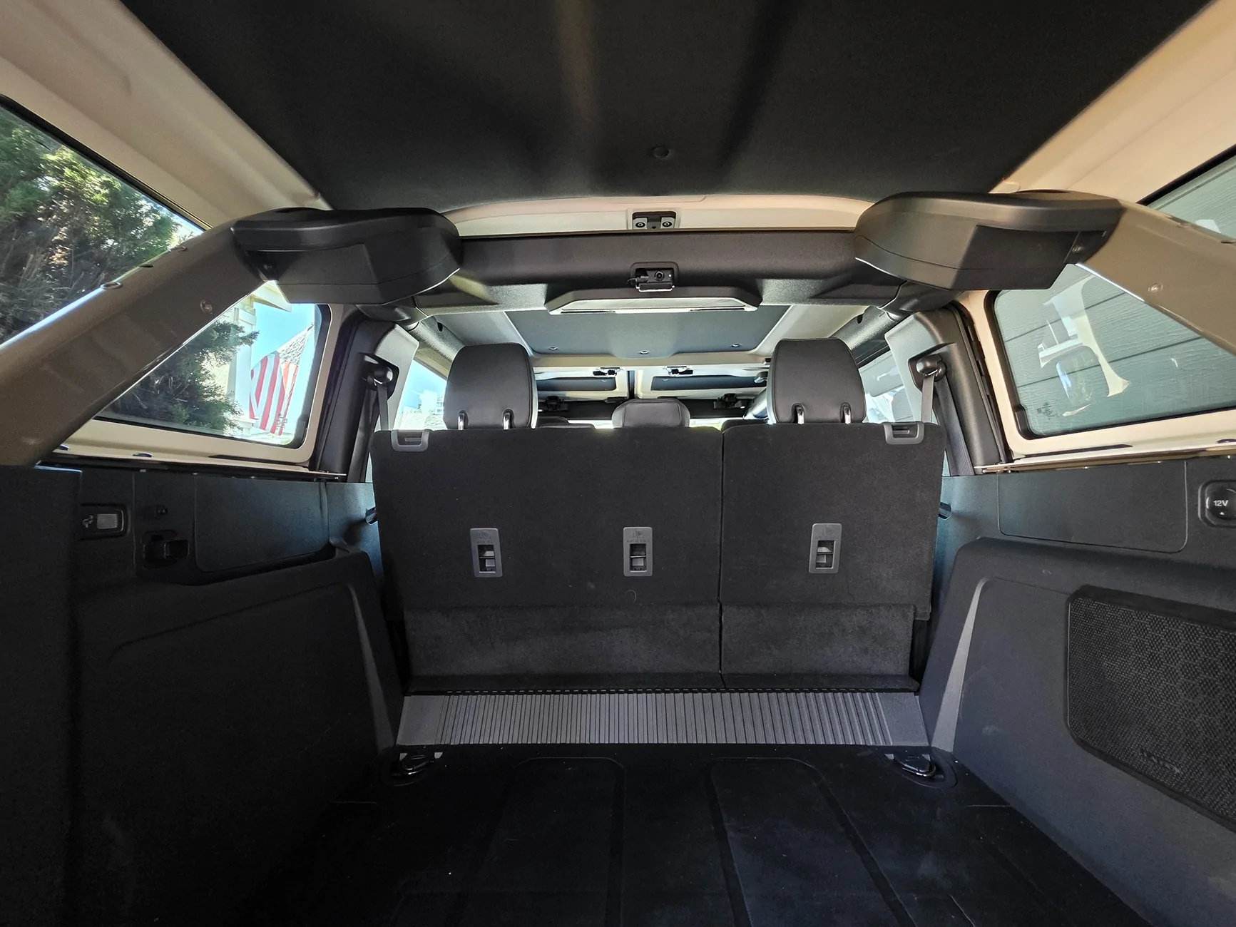

View from the front:
Ford Bronco Rear Dashcam Holder/Mount - 3D Print 20260604_123855

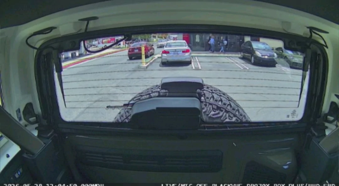

View from the camera:
Ford Bronco Rear Dashcam Holder/Mount - 3D Print Screenshot_20260528_130451

Wow great job op. My '22 has a semicircular cutout there that I used to mount mine, it's interesting to see what they've done in the newer models.
