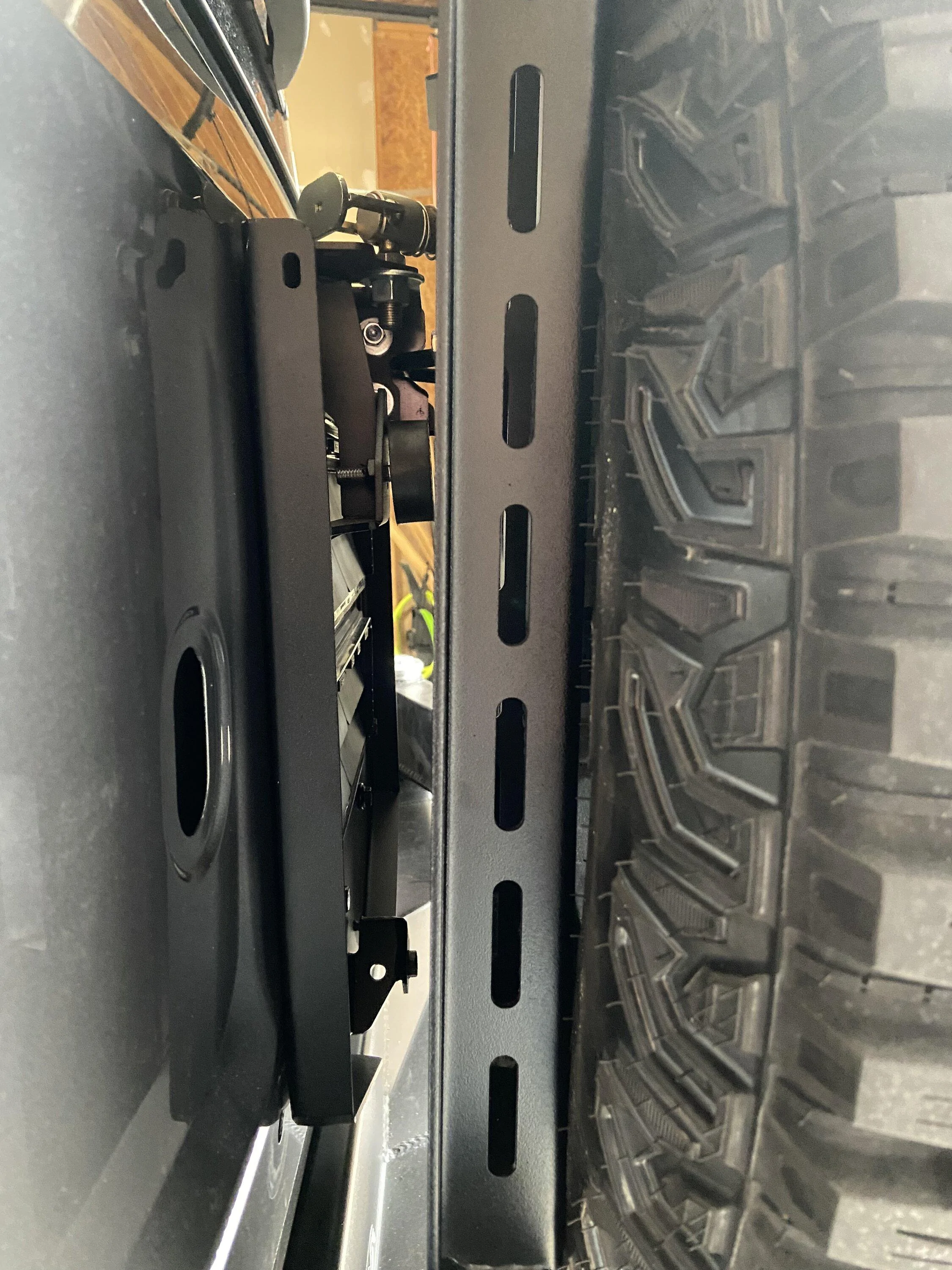

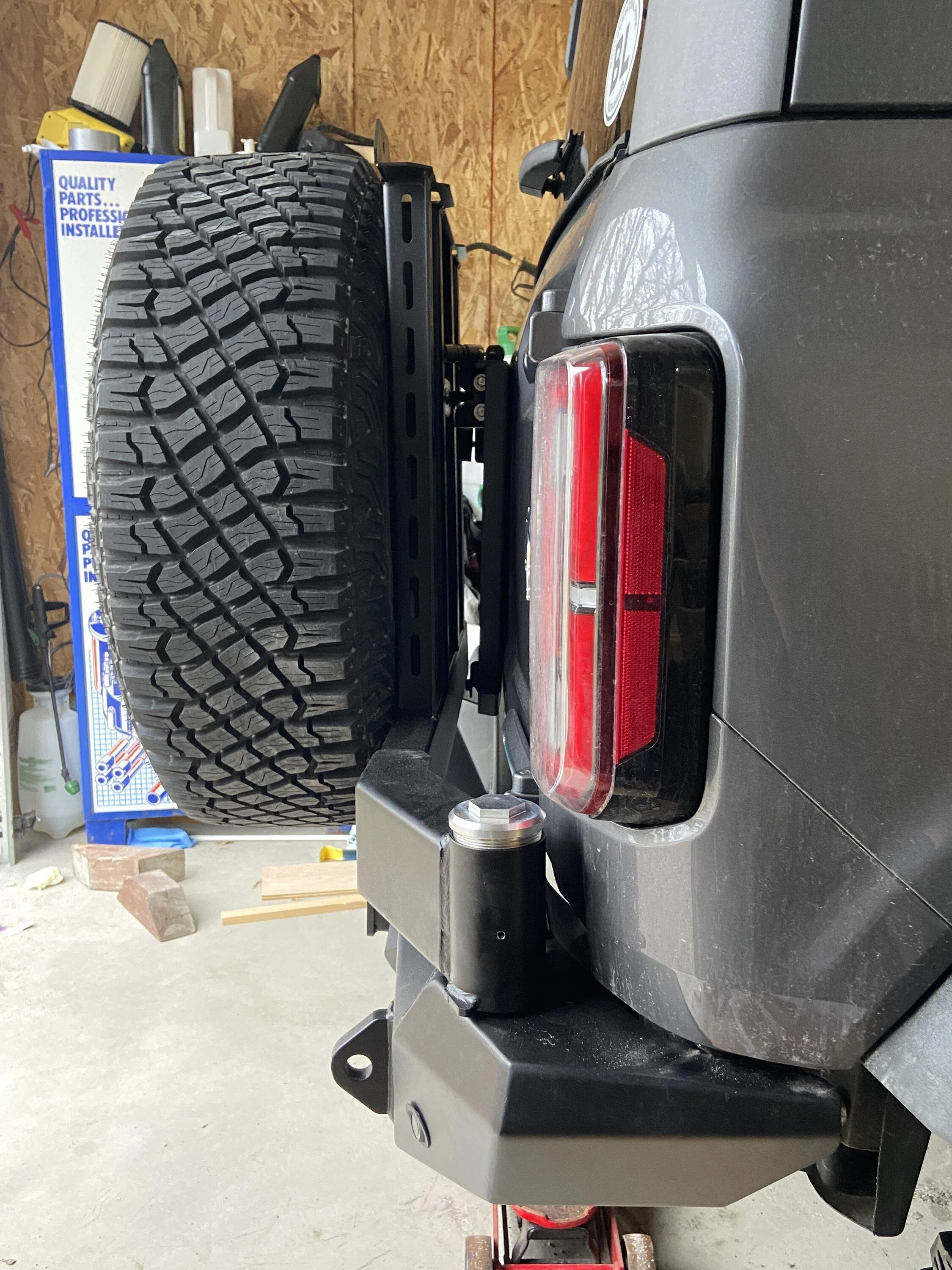

Got the tire carrier on and started final adjustments. I ran into a snag, even after “shimming” the bumper I am finding it difficult to get the tire carrier parallel to the tail gate. I spoke with support and sent a video of the tail gate latching correctly and showing the carrier sitting away from the vehicle. It should be parallel or leaning toward the vehicle slightly.
In my mind at this point I think I would have to “shim” the spindle to get it to lean towards the vehicle. Since the spindle is the critical part and due to some prior comments of concerns I would want to avoid that if possible.
(The lower bump stop was removed intentionally to shut the tail gate correctly for the video I sent)
I’ll wait to see what they suggest. Perhaps they may see an error in my installation.

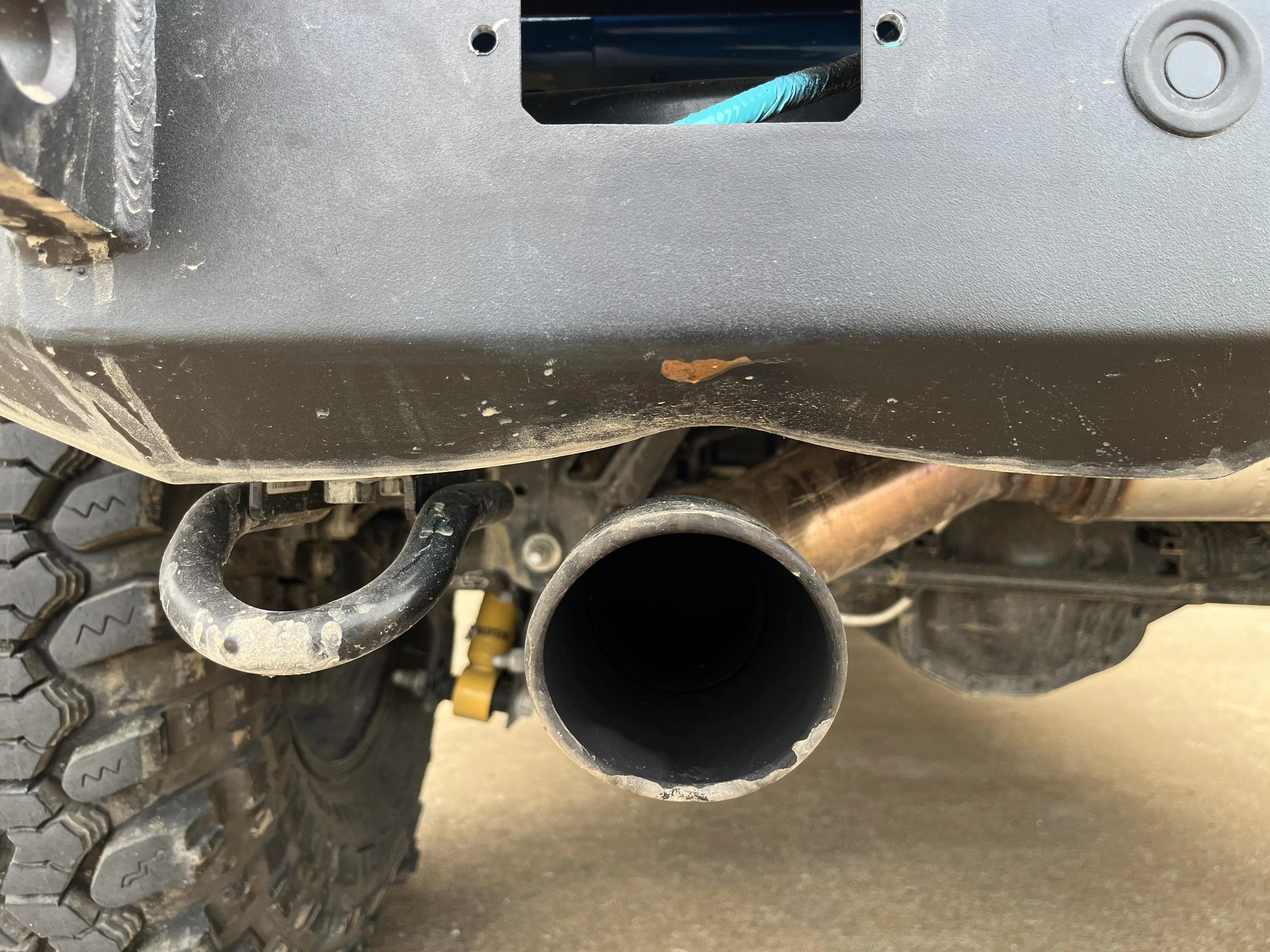

I went with the Havoc steel bender rear bumper. Great price at under $500 shipped. The metal might be a little thin though as my Flowmaster muffler tips dimpled the bumper on a rock drop.

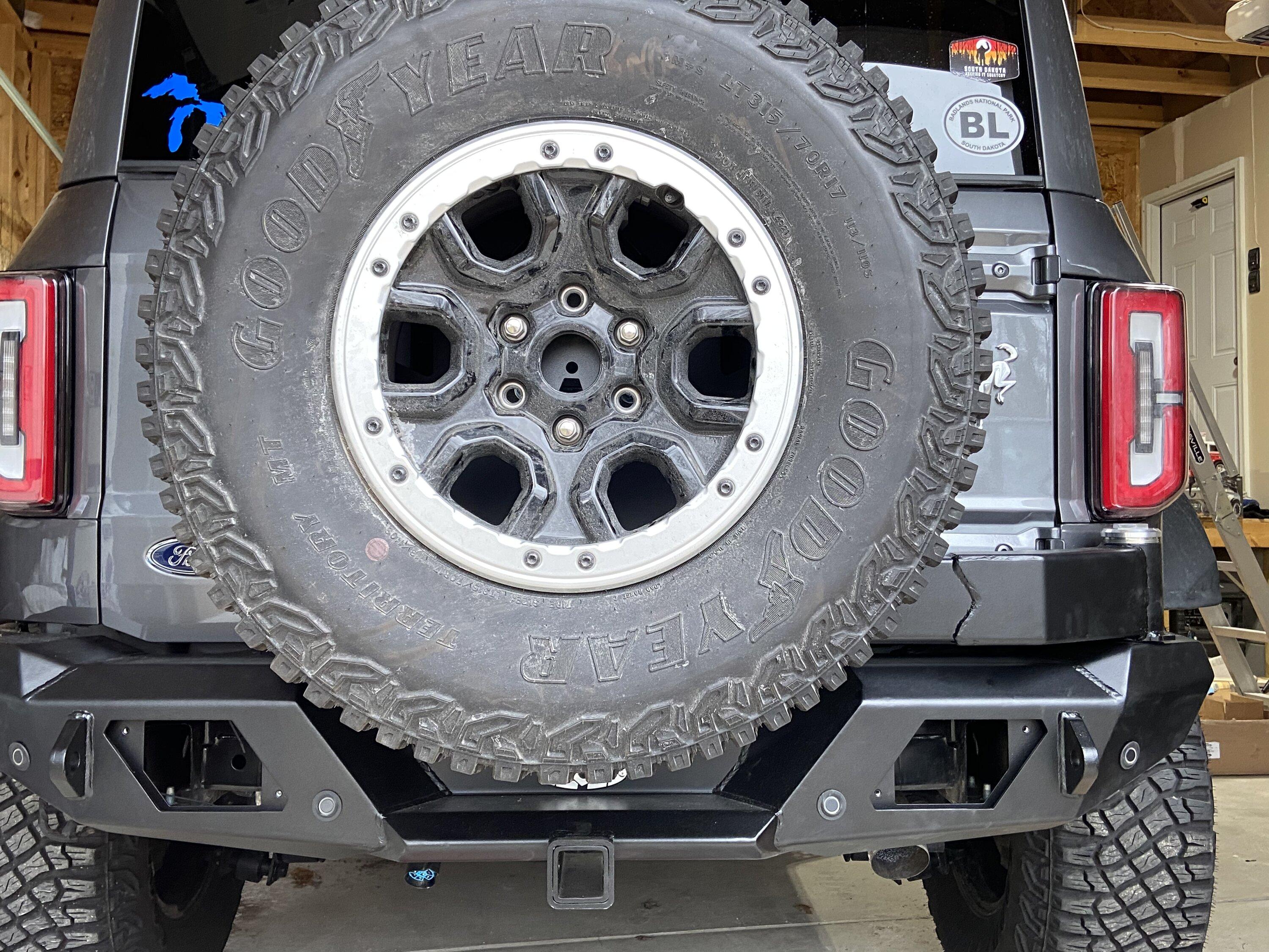

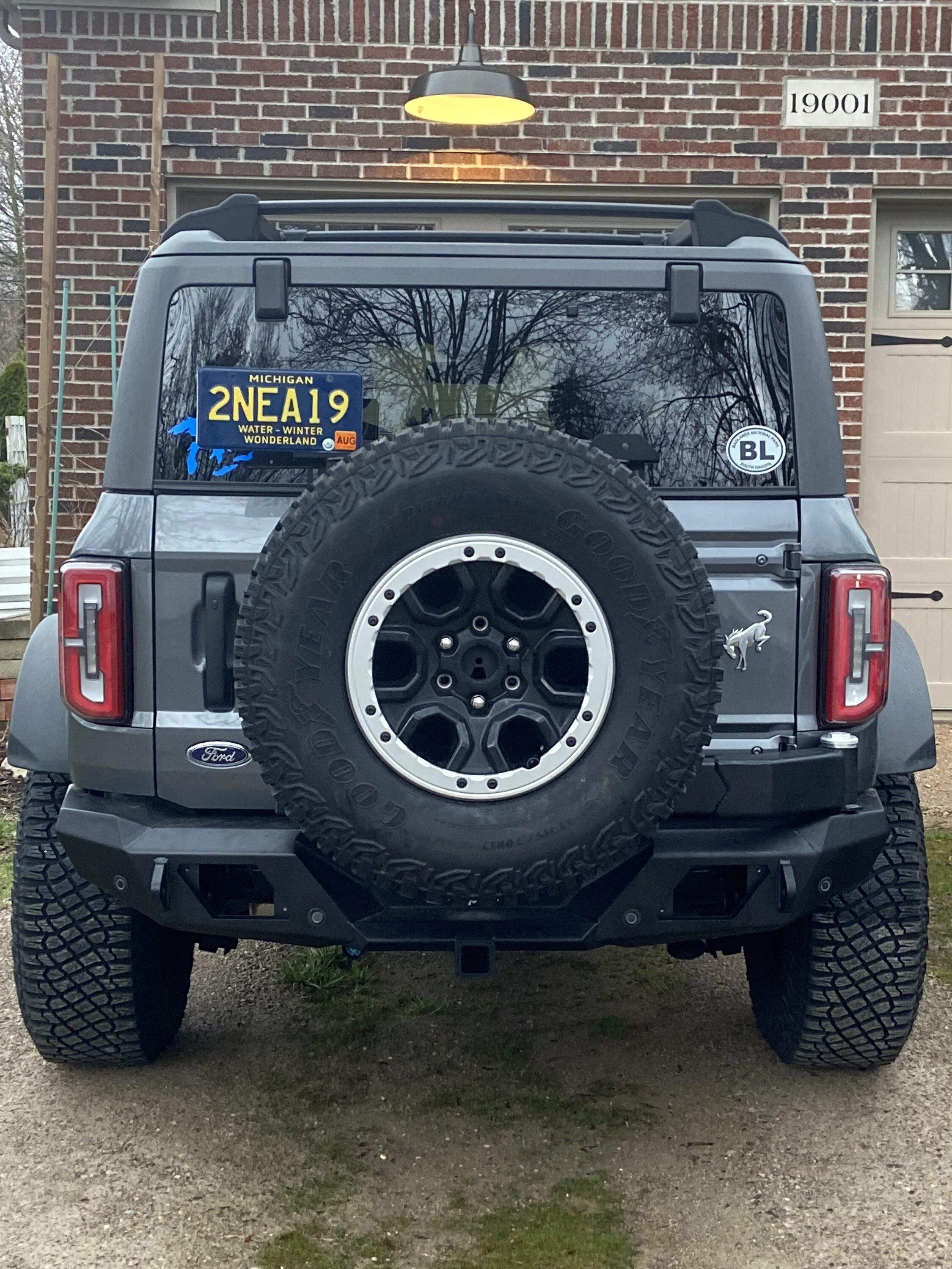

Ok! I took the spare tire back off and loosened the spindle and added a couple washers under the spindle at the top. That took care of the tilting back of the spare tire. It is now parallel with the tail gate. Now in terms of being parallel or level with the bumper, I have the wedge in a bit more and the drivers side is slightly higher. I am going to leave it like that for now to see if there is any “settling”.
All in all once you figure how how the tire carrier is suppose to close along with the gate it really is not that bad to adjust.
I am done with what I considered the difficult part. Now to finish the camera and brake light… no biggie for that.
Since the same scenario occurred with myself and “Tex”. I would recommend anyone doing the install to add a couple shims behind the top of the spindle right off the bat. If the angle is too close to the tailgate you can just remove the shims. I think it would be easier to remove than pull back apart to add.

So you had to add washers between the spindle plate and where it bolts to the bumper to push it forward? That didn’t cause any issue with not having enough tension on the wedge? Or maybe I’m missing where you added the washer? Mind taking a pic or pointing out where you added the washer per an install guide pic?
Looks proper now though, hopefully everything stays good!
bronco_ed
Ed
Feb 22, 2022
141
205
MICHIGAN
I added the shims (washers) at the top side between spindle and bumper. (top)
wedge is at bottom of spindle...
Shimming the top tilts the spindle toward the front of the vehicle.
It would be best not to add shims but if you have to this is the best place to do it since it is not near the wedge.
I put lock tight on all of the bolts that hold the spindle on. I have not seen any comments from the jeep community on things loosening up.
I'll look again but rather than weld you could possibly drill and tap a hole or two and create a custom sized plate to bolt up and back up to the wedge as another way to prevent any movement of the wedge. Just another precaution. To hold things tightly. Hopefully not needed.
I also made LOD aware of the two installs that seem to have had the same scenario. Perhaps they can look at the angle on the mounting pad they have welded onto the Bronco Bumper or look at the spindle for possible issues. Also provided input regarding additional license plate mount options.
Tex made a good point that it probably is good to have the drivers side slightly higher anyway if you plan to add the additional gas cans or rack. (There will be additional weight from full gas cans, storage, etc...)

I do not think that would happen with LOD bumper…. I think tail pipe would have been crushed. Between bumper and rock…
I was just busting chops with the comment. I am in the same boat. :LOL:
I could not spend big bucks just to chop on it. ;)
