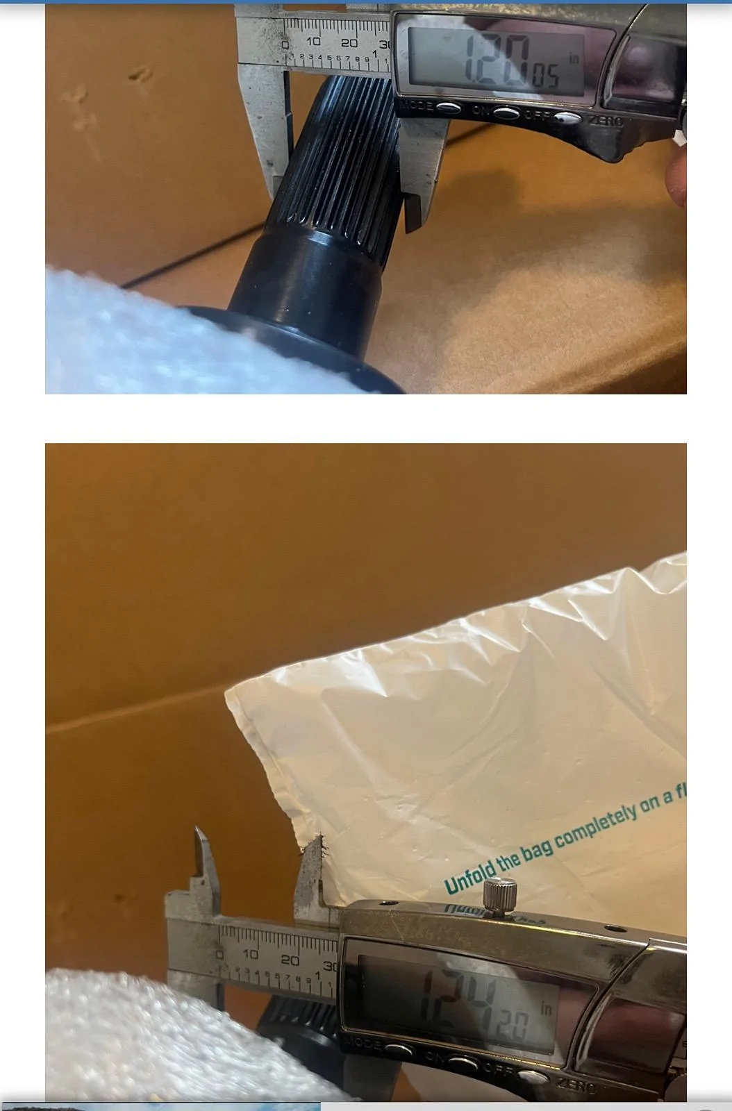

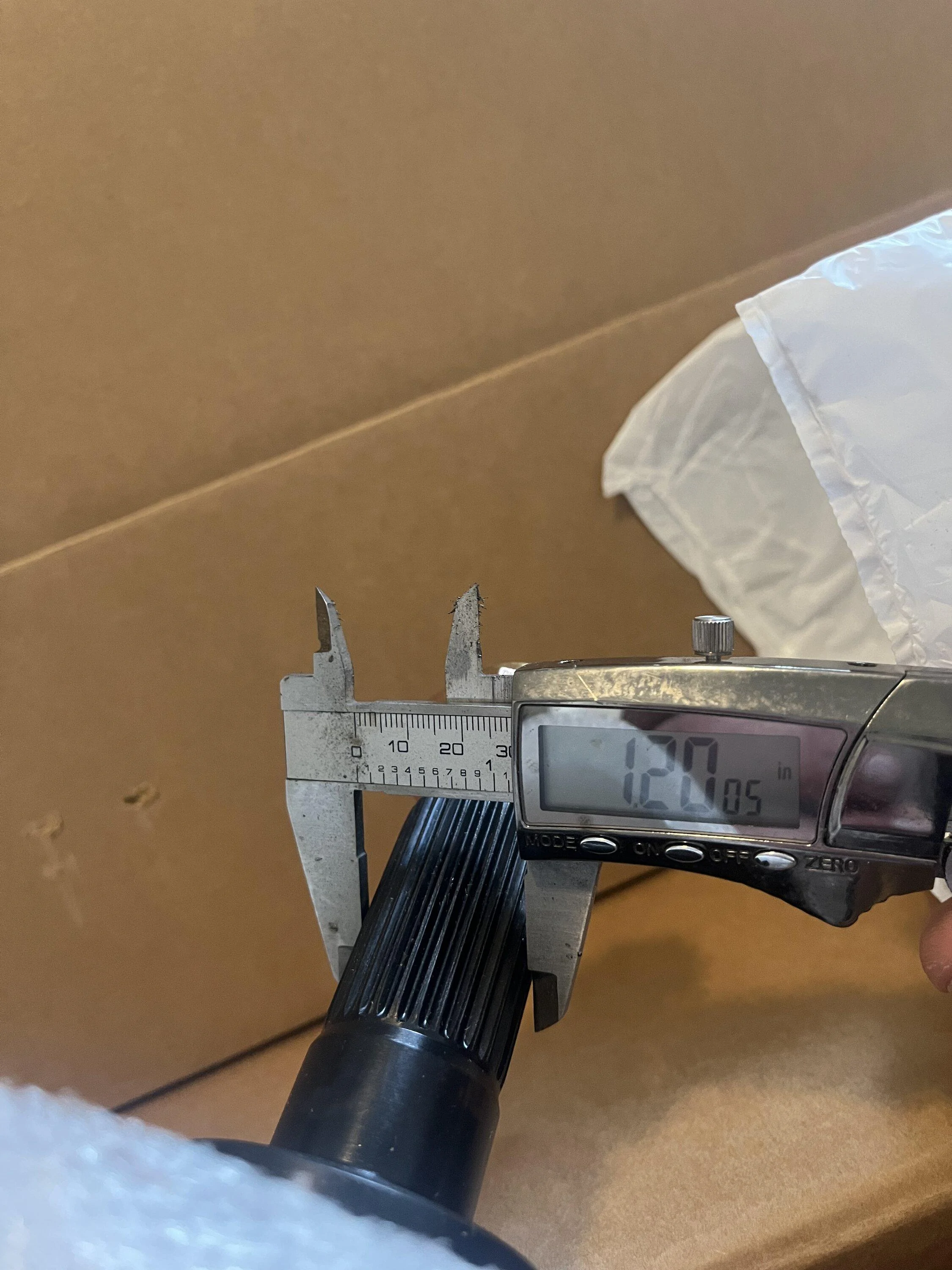

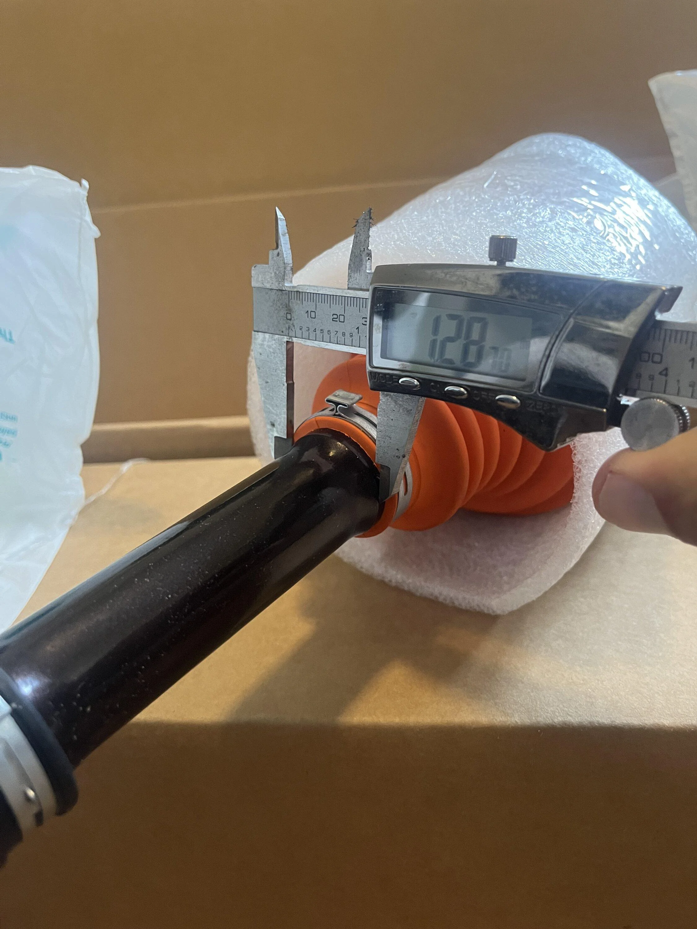

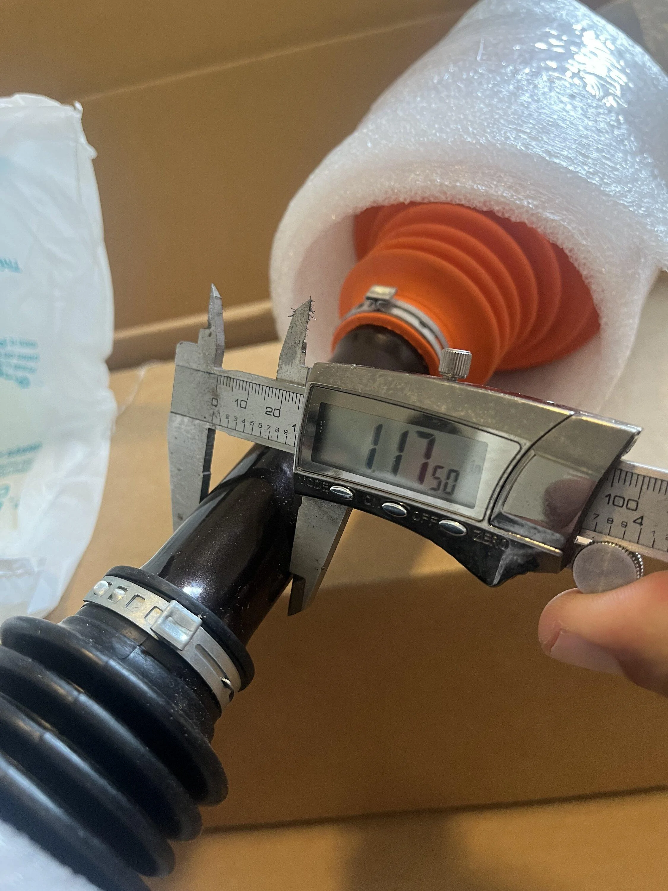

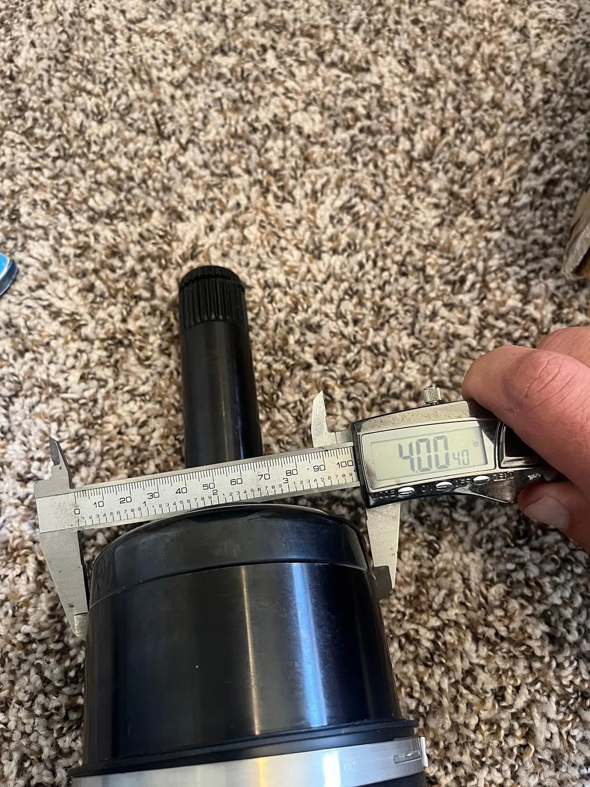

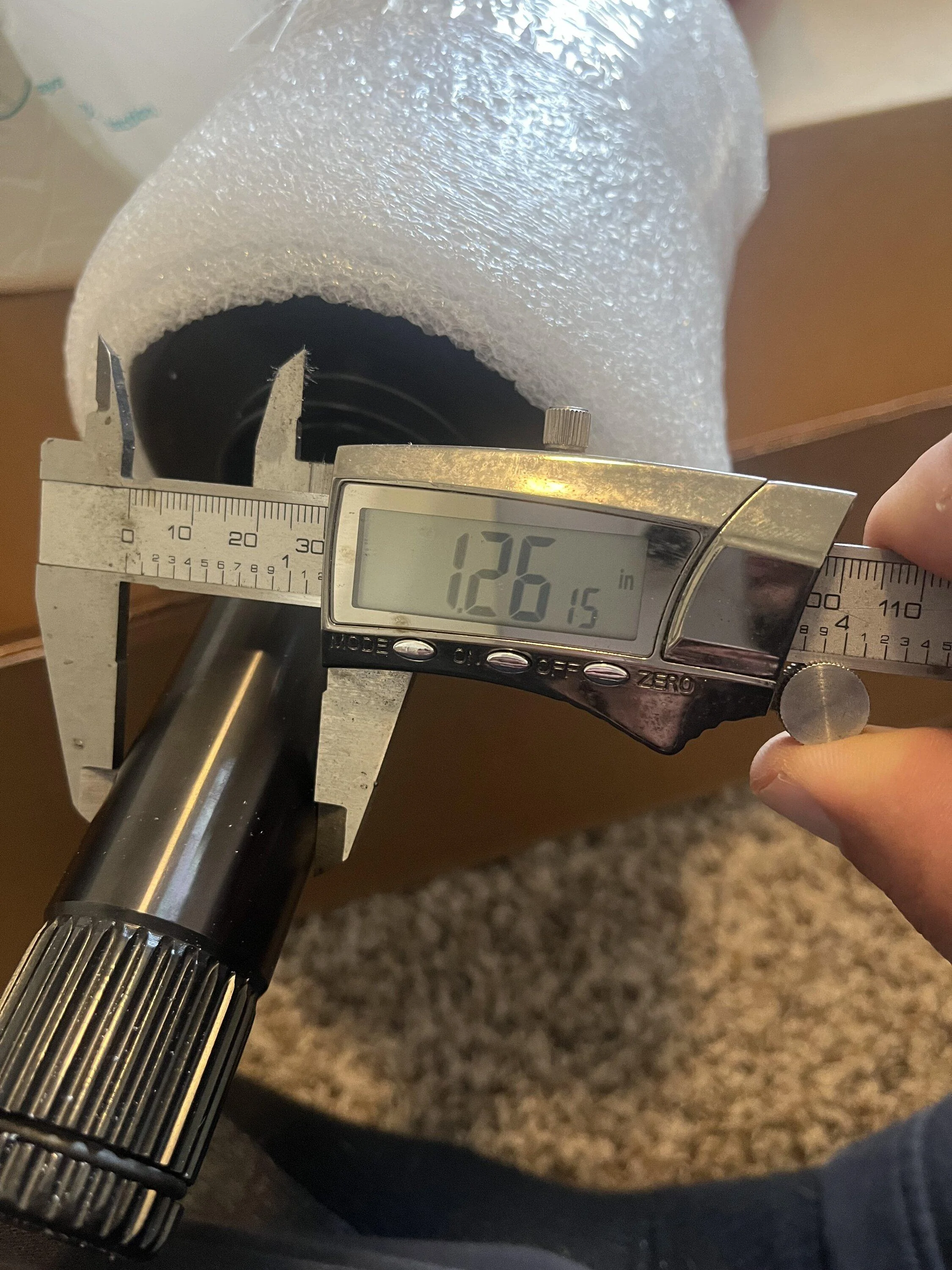

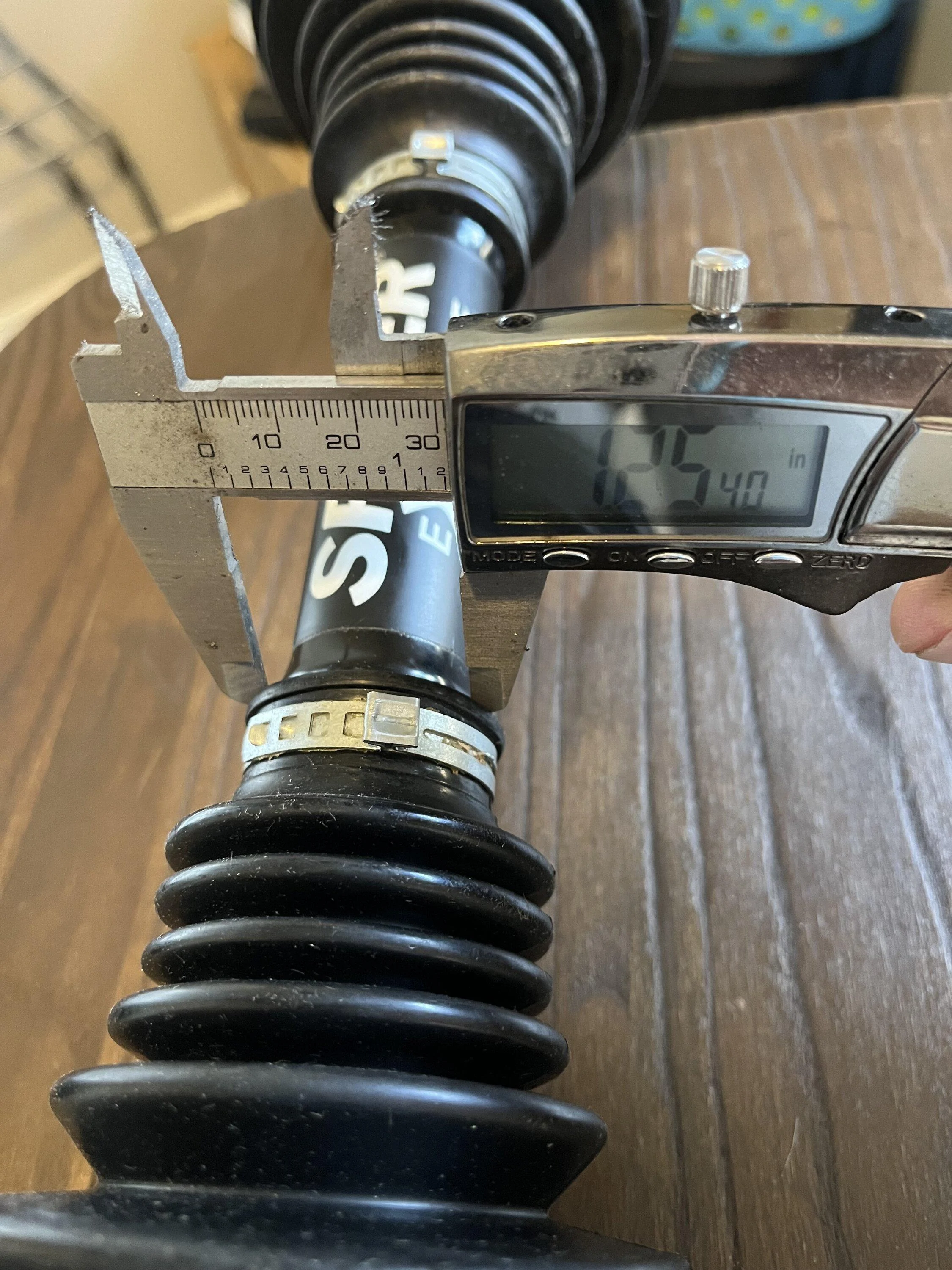

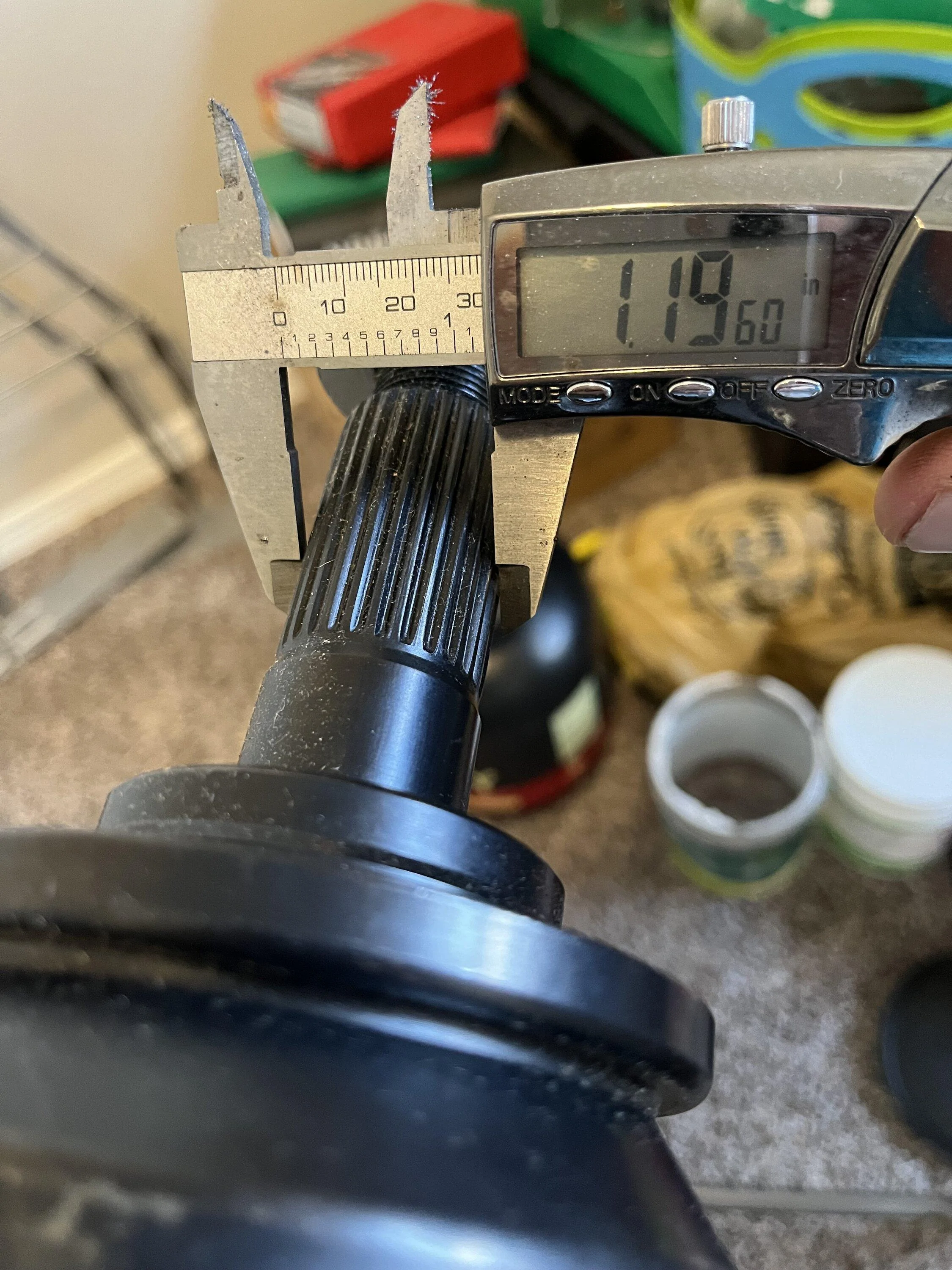

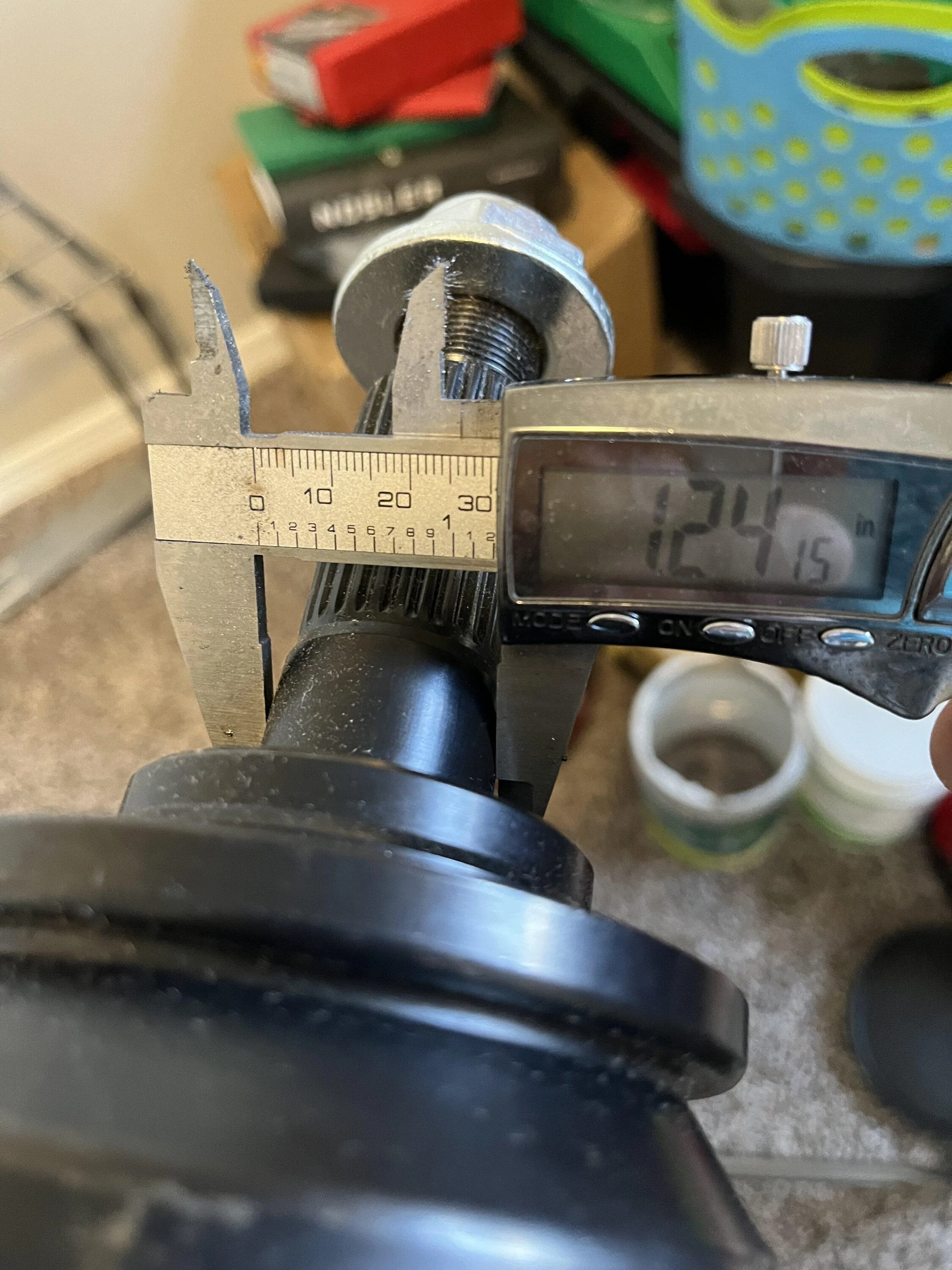

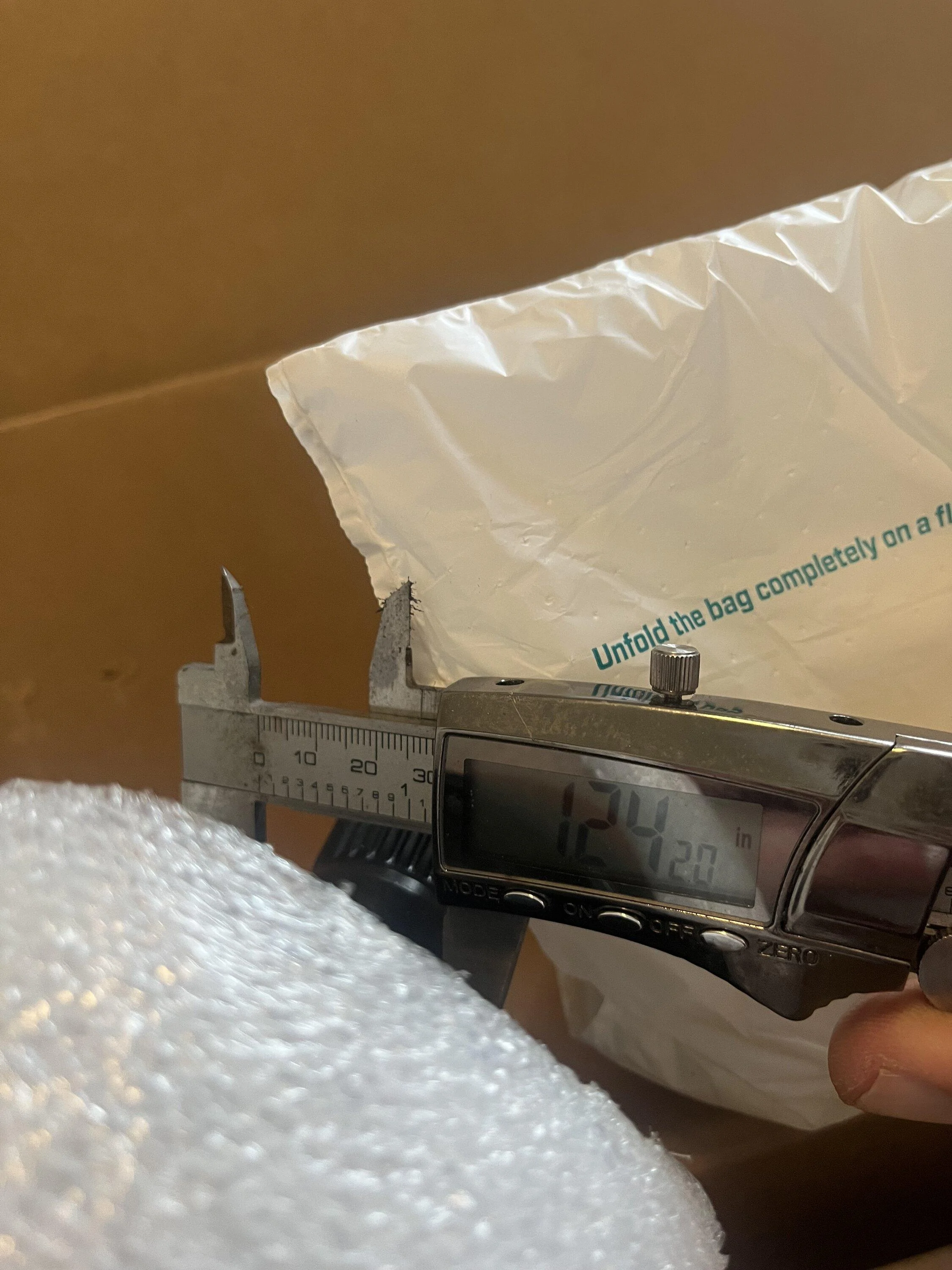

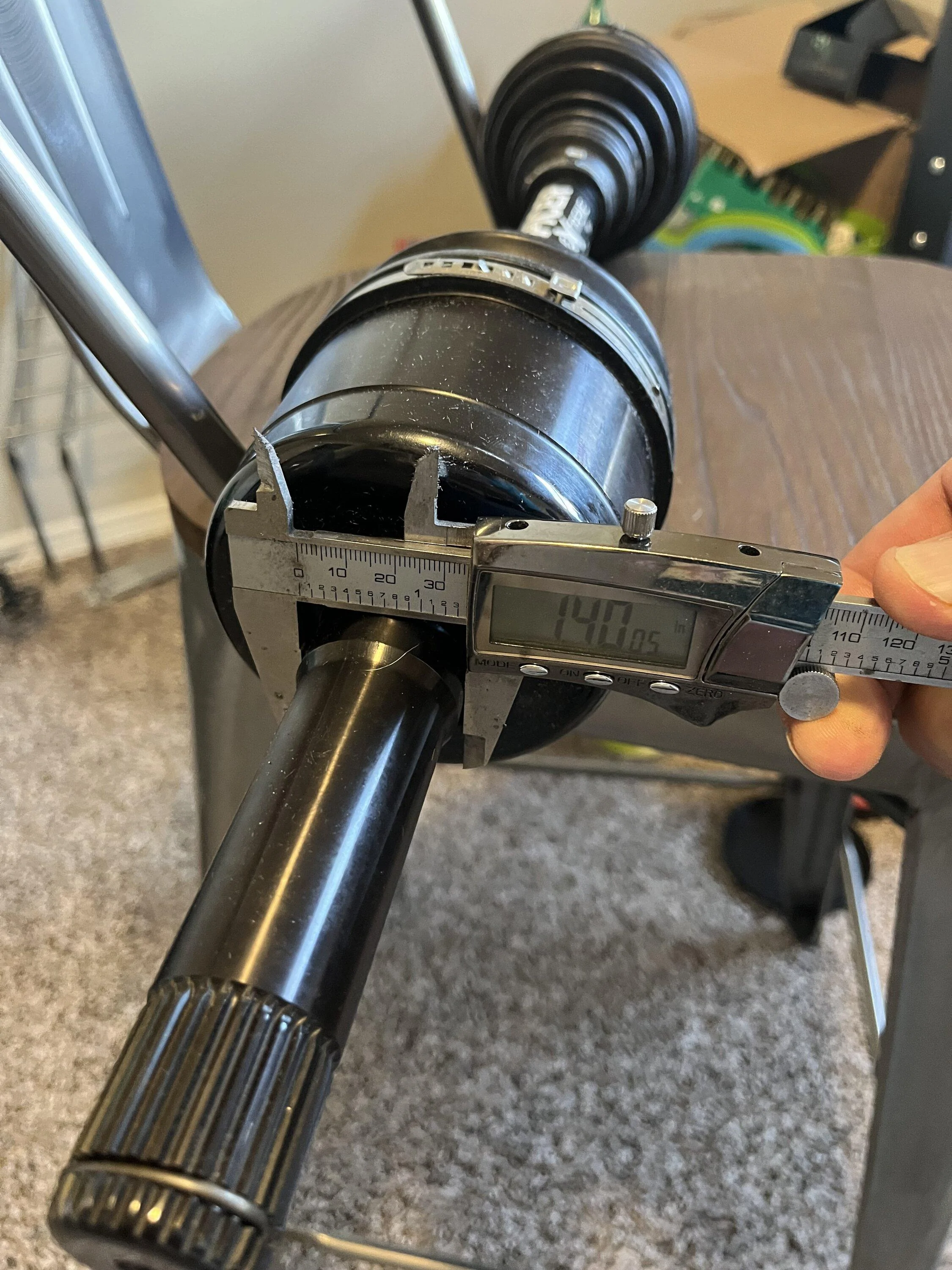

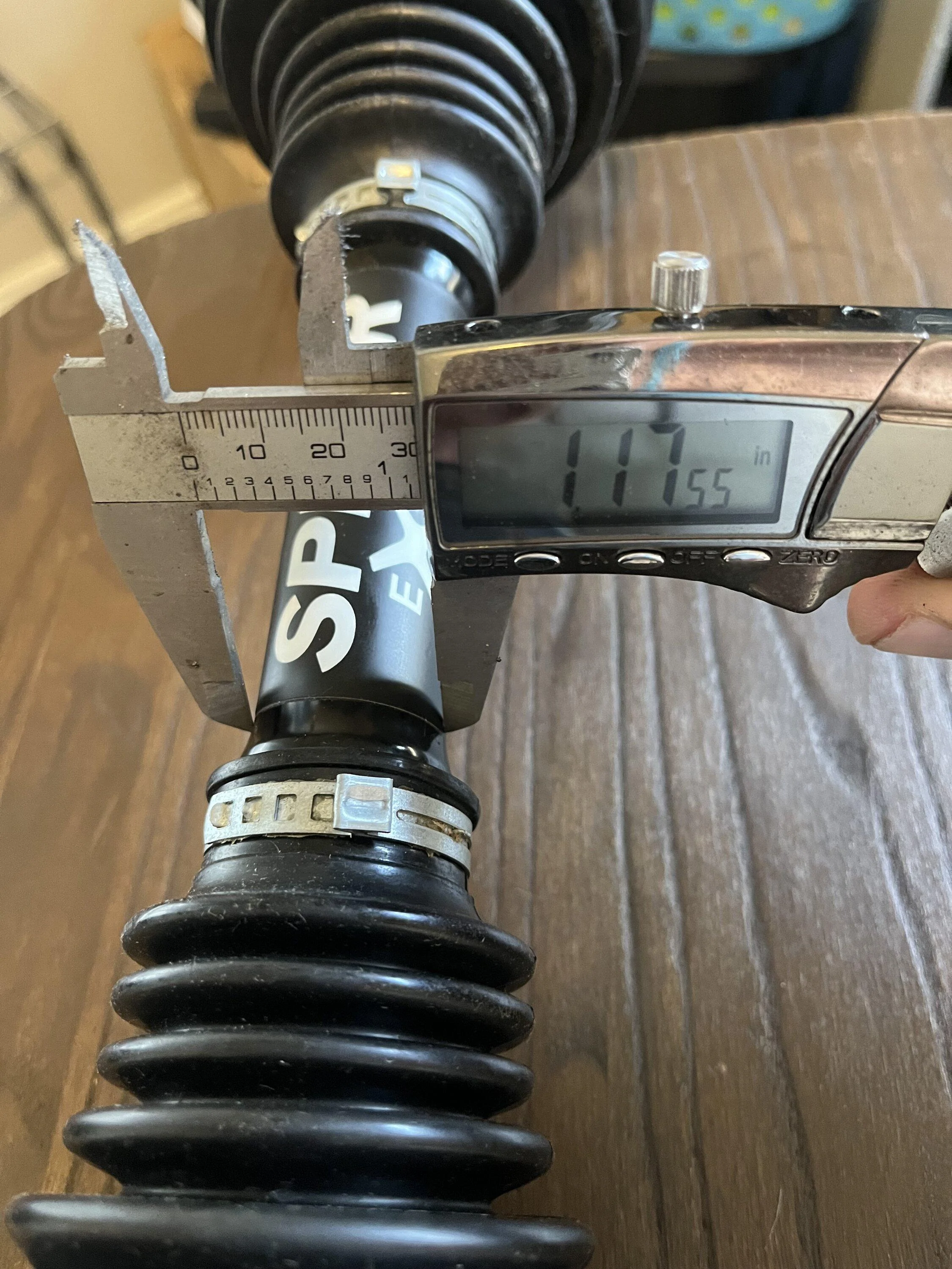

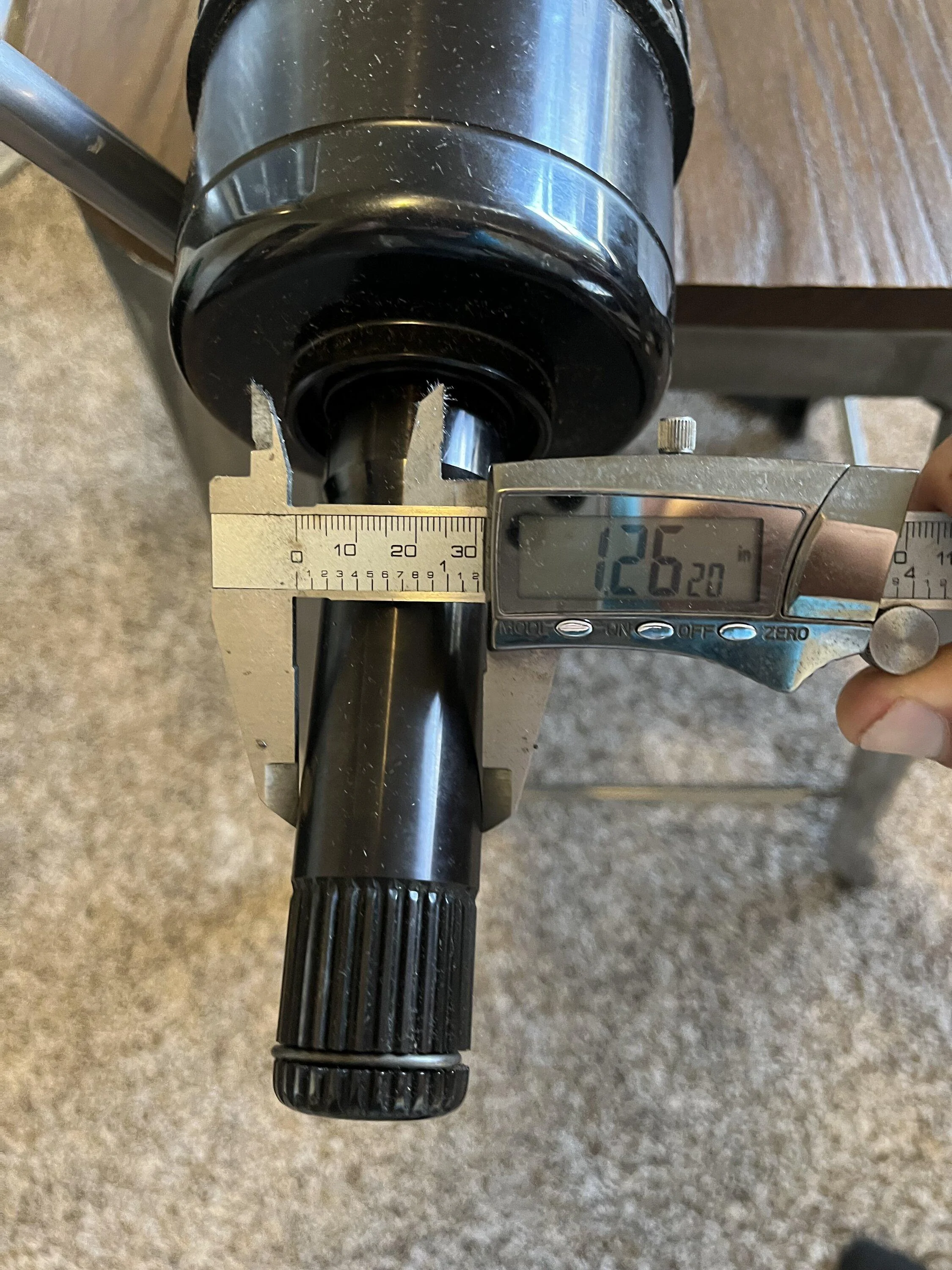

Since I had both sets of axles (RCV delivered theirs the day I called to cancel upon deciding to go 32 spline, and @Northridge4x4 accidentally sent 29 spline instead of 32 with the diff. Not saying that to discredit them or anything-I was actually very impressed at how they handled everything and will definitely use them again) I thought why not measure and compare some diameters? Calipers aren’t crazy machinist tolerances but good to .0005ā€ so take that for what it’s worth. Starting after the splines from the differential-
SPICER RCV
1.2620 1.2615
1.4005 1.4025
1.2540 1.2870
1.1755 1.1750
1.2415 1.2420
1.1960 1.2005 (measured on splines as I was curious)
I really hope this formats the same on the post the way it looks on my phone as it was kind of a pain to do šŸ˜‚
I’ll include the pictures so you can see where the measurements were taken. Not certain how useful this information will be due to different coating methods and whatnot, but now you know!

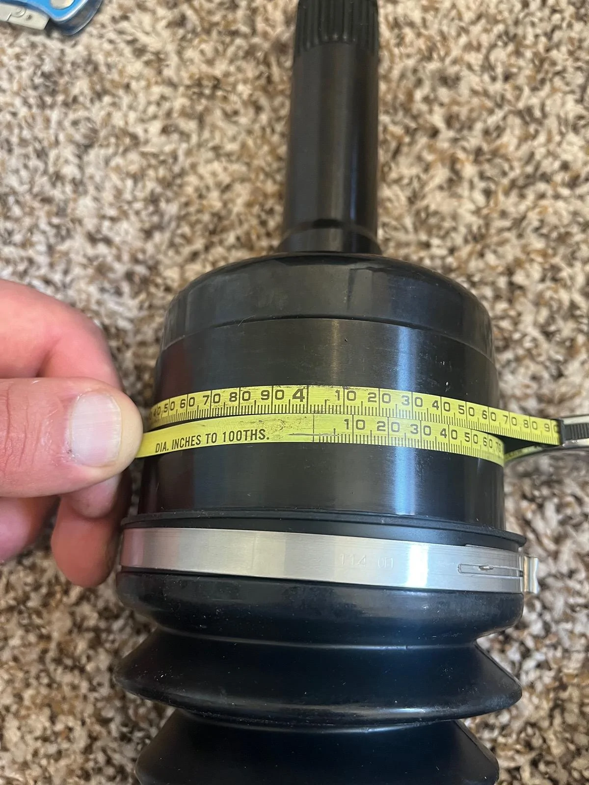

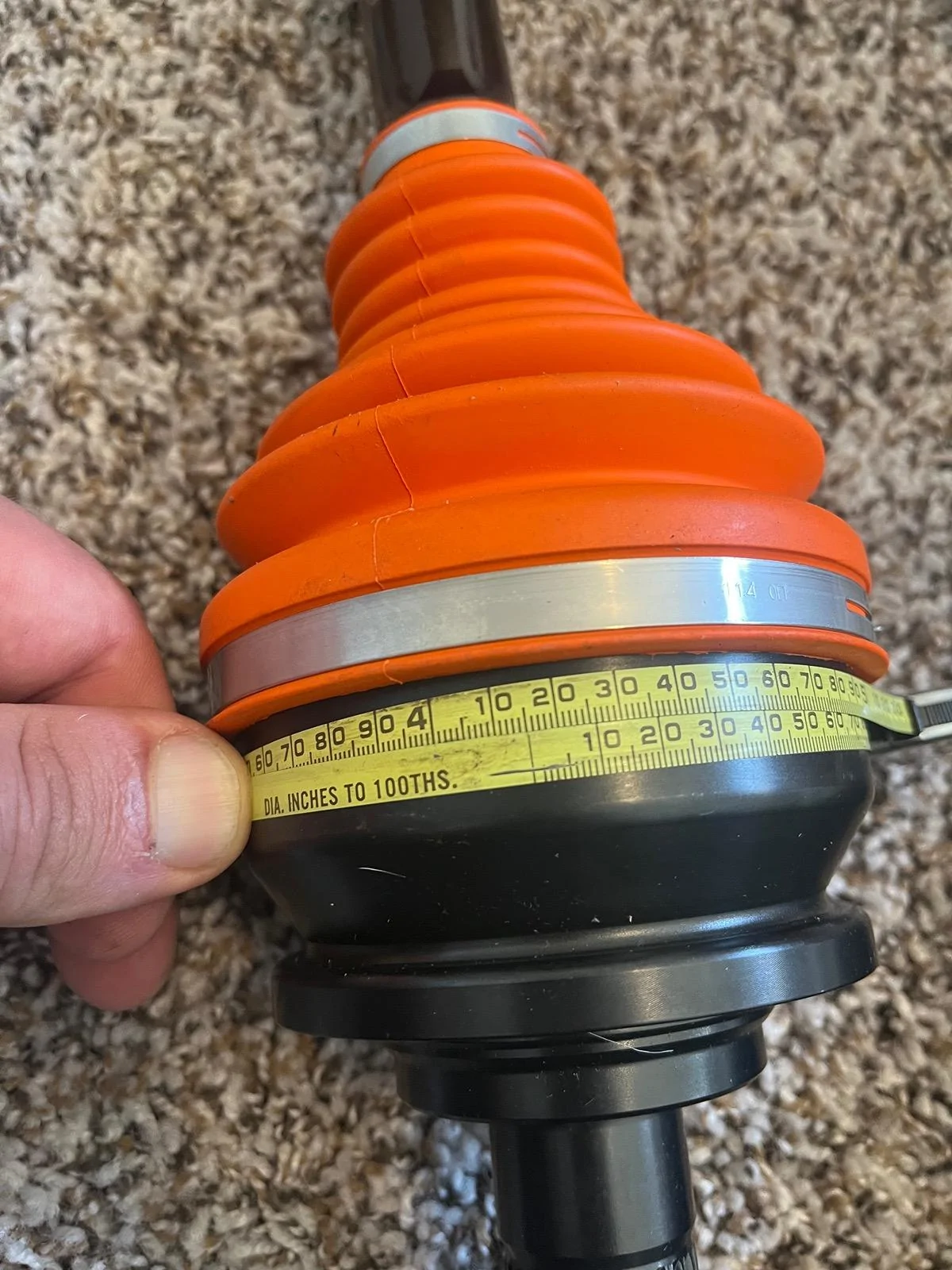

That's great I appreciate you taking the time to post these measurements, however most of them cannot be changed without changing or altering other parts for example the inside of the diff splines. Better places to measure our inside of the star in the CV, also the inner diameter of the Bell would be nice to know. I know that the Spicer 32 spline uses 1 in balls which are the same as the Porsche 934/935 series. It also uses the full 35 spline 1.5 in diameter shaft inside the star. What I need to know is what the inside of the Bell is on the RCV shafts on the outer CV? Will the Spicer unit be compatible with the RCV unit if a person wanted to mix and match parts?

Can you measure the outside diameter of the CV Bell or housing on both units on the outer CV? thanks
Specifically I'm trying to compare the RCV 29 spline and the Spicer 32 spline diameters

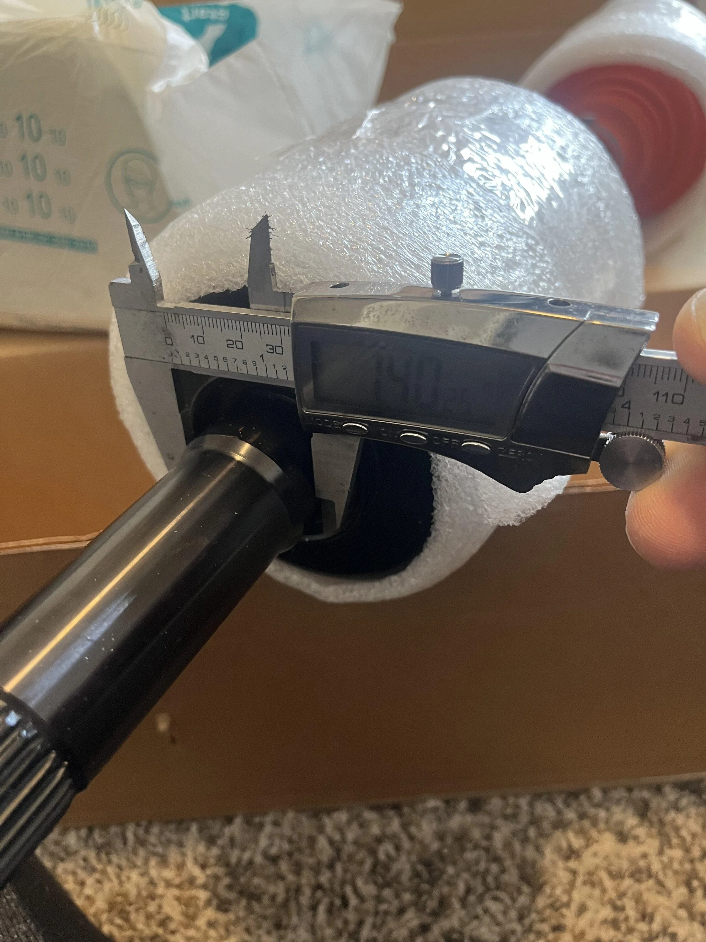

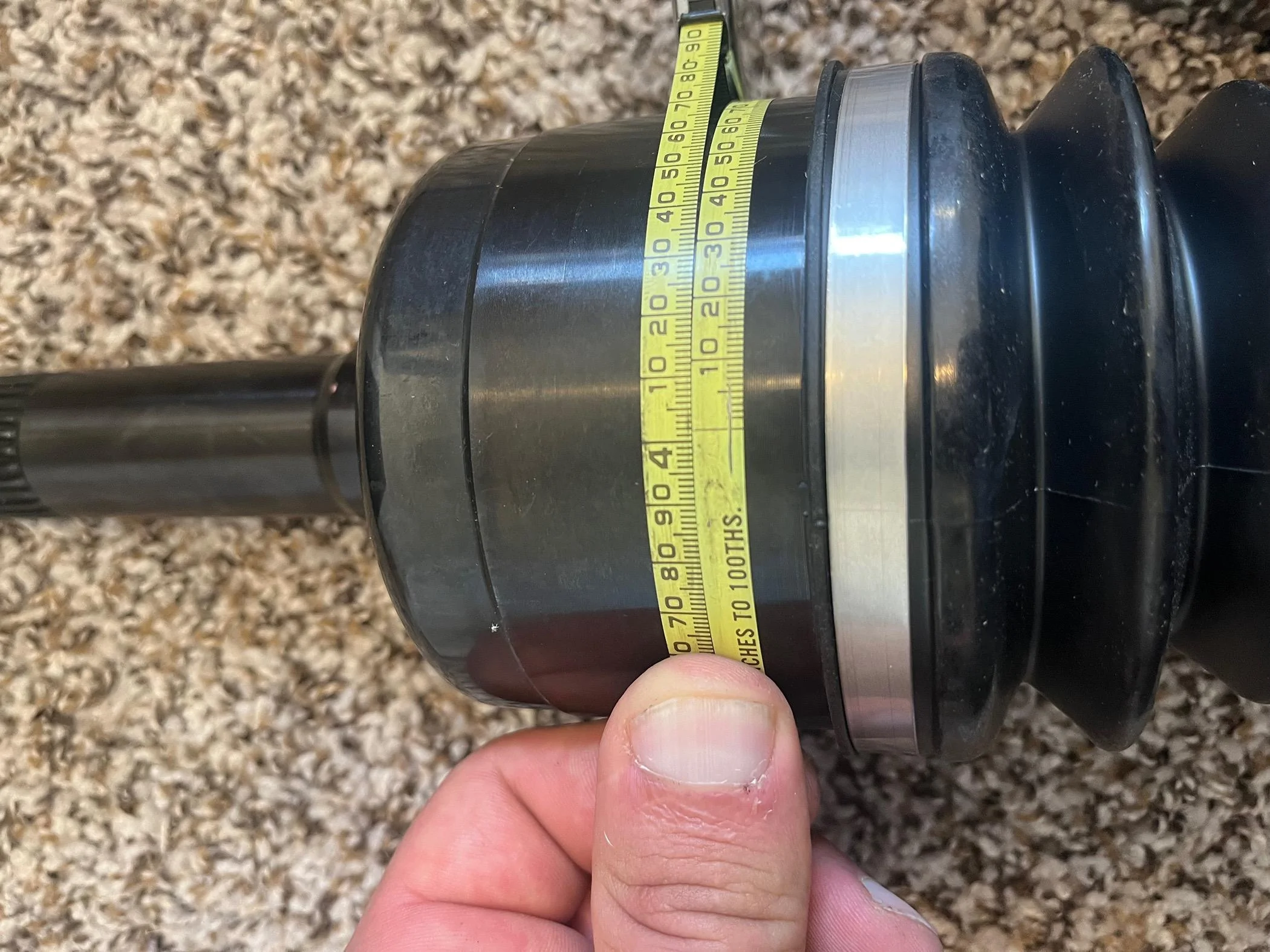

Couldn’t quite get everything with the calipers so swapped to OD tape

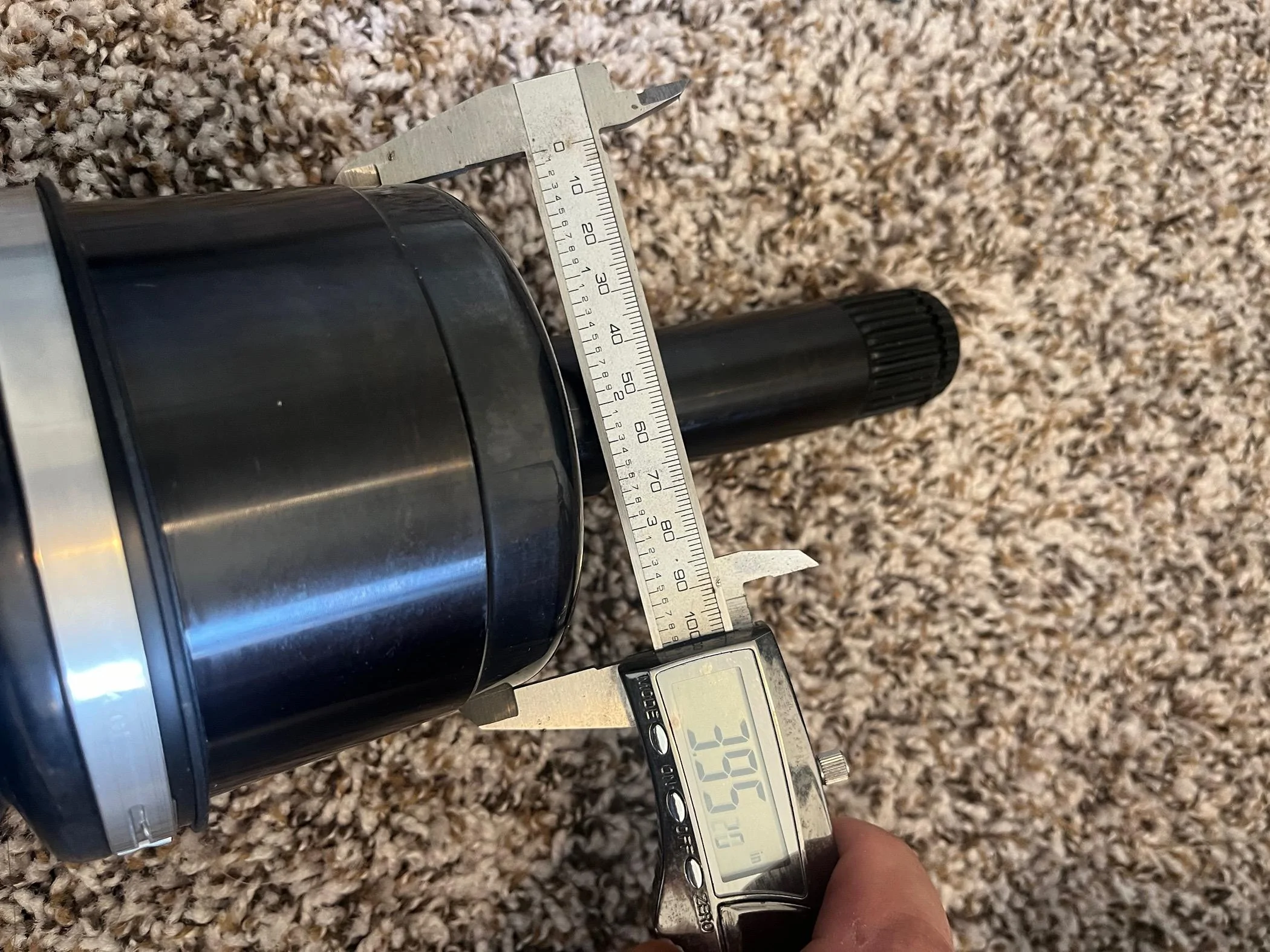

That's great information but I'm actually looking for the other end of the CV where it goes into the wheel. I'm looking at blending Bronco Raptor CVS from RCV with Spicer normal Bronco 32 spline units. This would be one way to run the Bronco Raptor front suspension knuckle. It is different because it has the iwe which is super stupid.
Assuming what you’re looking for isn’t under the boot the best I can do is these two measurements
