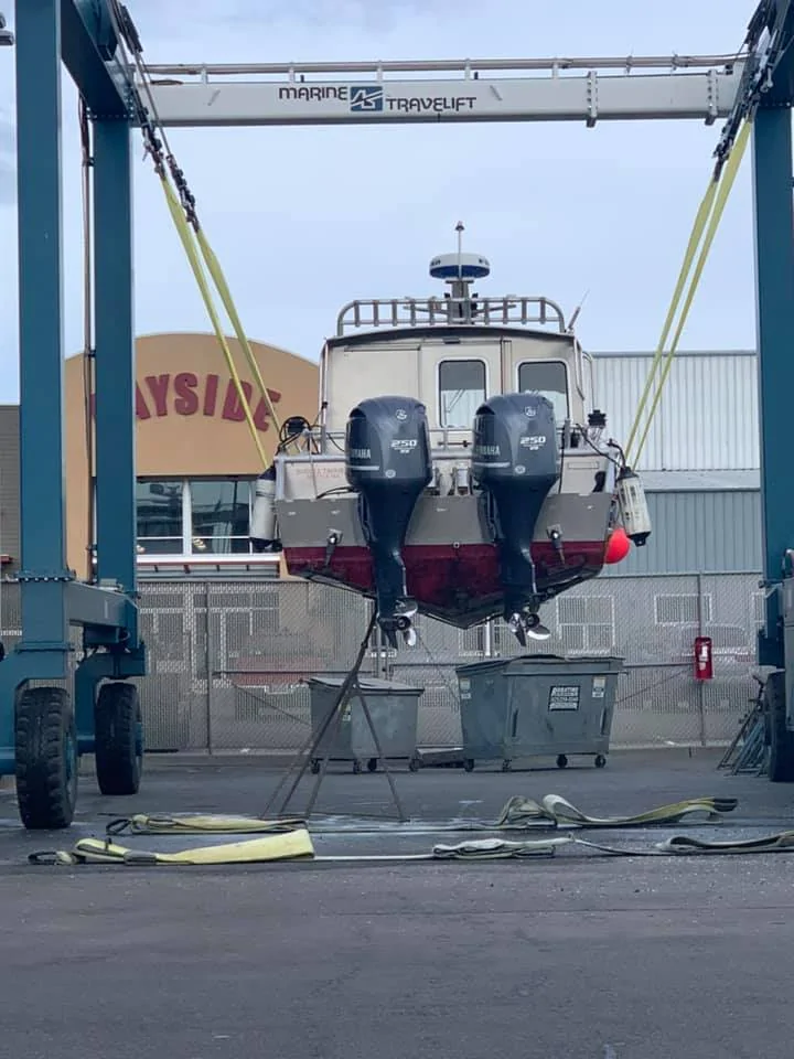

I've decided to go with Sharkhide. It's used widely in the marine industry, cost effective, and is simple to apply. Touchups are also easier than even paint.
Agreed, I have had it on my boat for 7 years and just got the kit to redo next month or I may wait until next spring as it still looks good.

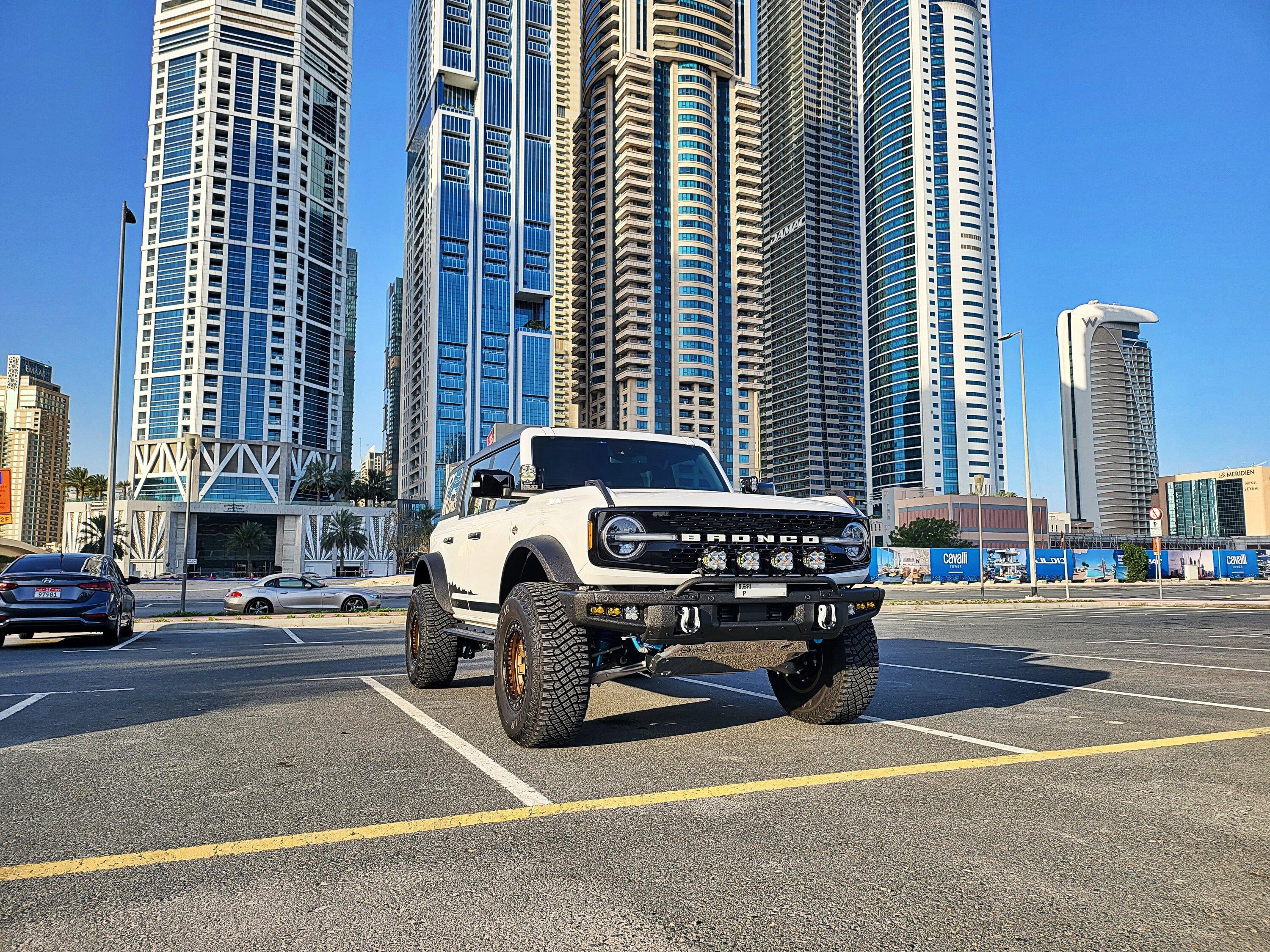

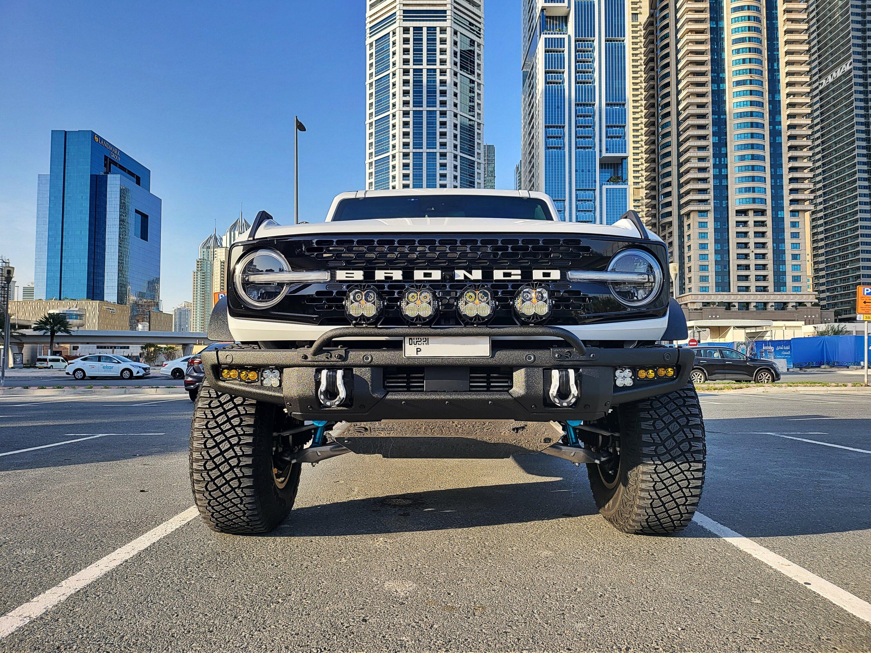

I got mine polished to a mirror finnish and then wrapped it in PPF. Looks cool and reflects the road.
Not sure how long it will last but lets see. We dont have much rocks here so the main use is in desert environments.
We live a wild and crazy world where skid plates are getting polished…. To each his own, but to me that is like putting armorall/tire wet on your tires before you go rock crawling.

Gotta make that staging area air down shot!
Still, looks kinda awesome and makes for a clean street look. At least his wheels are still the off-road functional kind.
