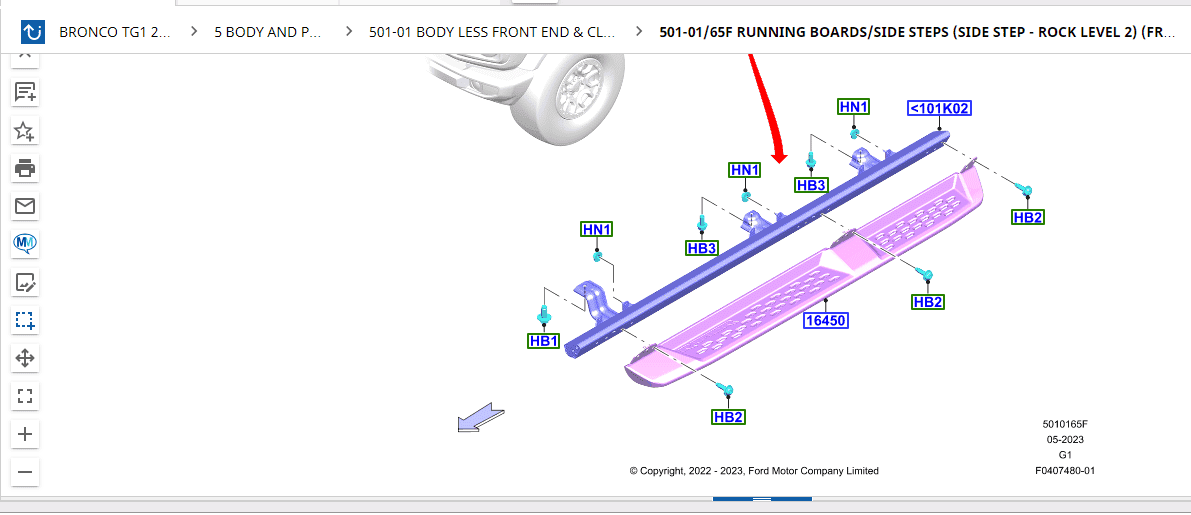

Thanks for this.
The brackets that are bent that I need are still in pink showing a light blue bolt (HB2) going thru them. Does that mean that the brackets are part of the removable step? The brackets are removable from the bottom of the step and are removable from the rock rail so I would think that they are able to be purchased separately.
