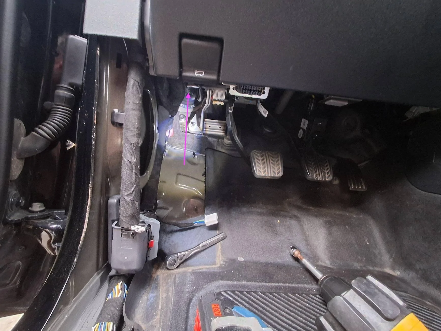

Good afternoon, if someone could share a quick tip. I have a manual transmission and I'm trying to run my amp power wire through the front of the car. And I cannot find dad blank grommet space that everyone is using. Is it different on a manual? Or am? I just not looking hard enough. Thanks in advance.

You can see it in your pic - immediately behind where the hood latch is. Almost exactly where you have the flashlight aimed
The grommet itself is like 1 1/2” across and it has a nipple in the middle about 1/2”

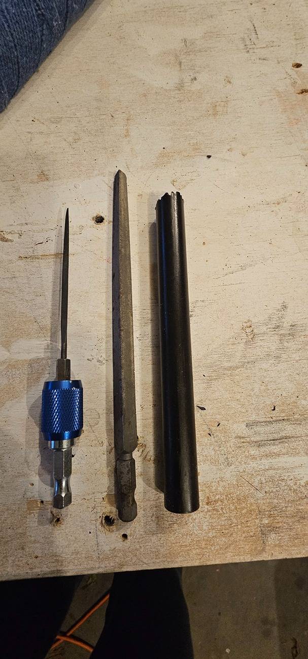

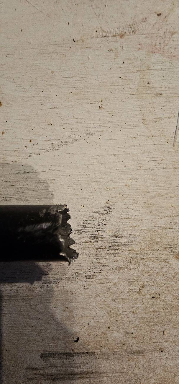

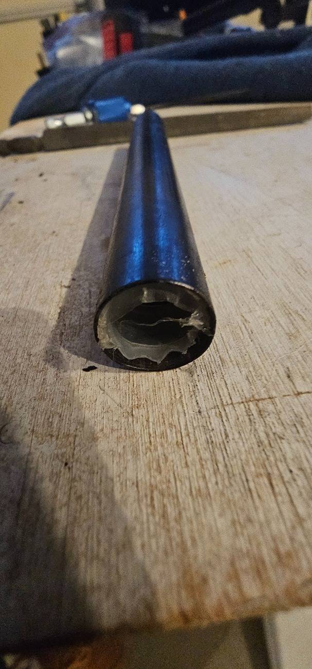

I was actually able to get this sorted out pretty quick.
I have an old file set from Lowe's with an interchangeable handle. I used a really fine file to start a pilot hole stepped it up to a larger file, and was able to push it all the way thru which sucked in the little "nipple" part. Then I found an old curtain rod "half inch pipe" cut it down to about 6 inches and then filed teeth into it. Lubed it a little slid it in and then when I felt resistance, I slowly turned with a little bit of pressure and it popped right thru. I left it in place and then slid the wire thru the pipe. Went inside pulled the pipe thru and then pulled all the wire thru. This ended up working way easier than I expected.
