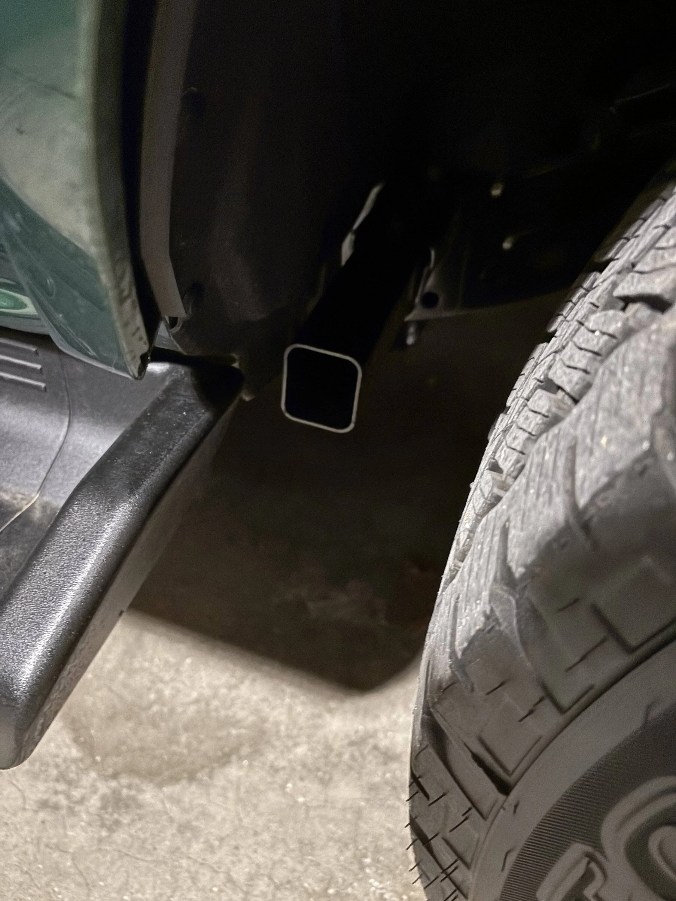

- took a picture behind front when, should this frame have a cap on the end? Seems strange to be left open. I can imagine a lot of road grime going inside. Pic below

Don't know if that's an Outer Banks thing, a 4dr thing, or a model year thing, but I don't recall ours having a tube there? I guess I'd have to look again because I haven't noticed it. As for if it's missing a cap, I would say that it probably is, but I don't know for sure.
That is correct from the factory. There are plastic caps you can buy online to close it, but obviously if moisture and gunk gets trapped behind the plastic cap it may cause rust issues. Up to you ultimately.
If you do want the caps, search something like "Bronco crash bar end caps" and a bunch of options will pop up.

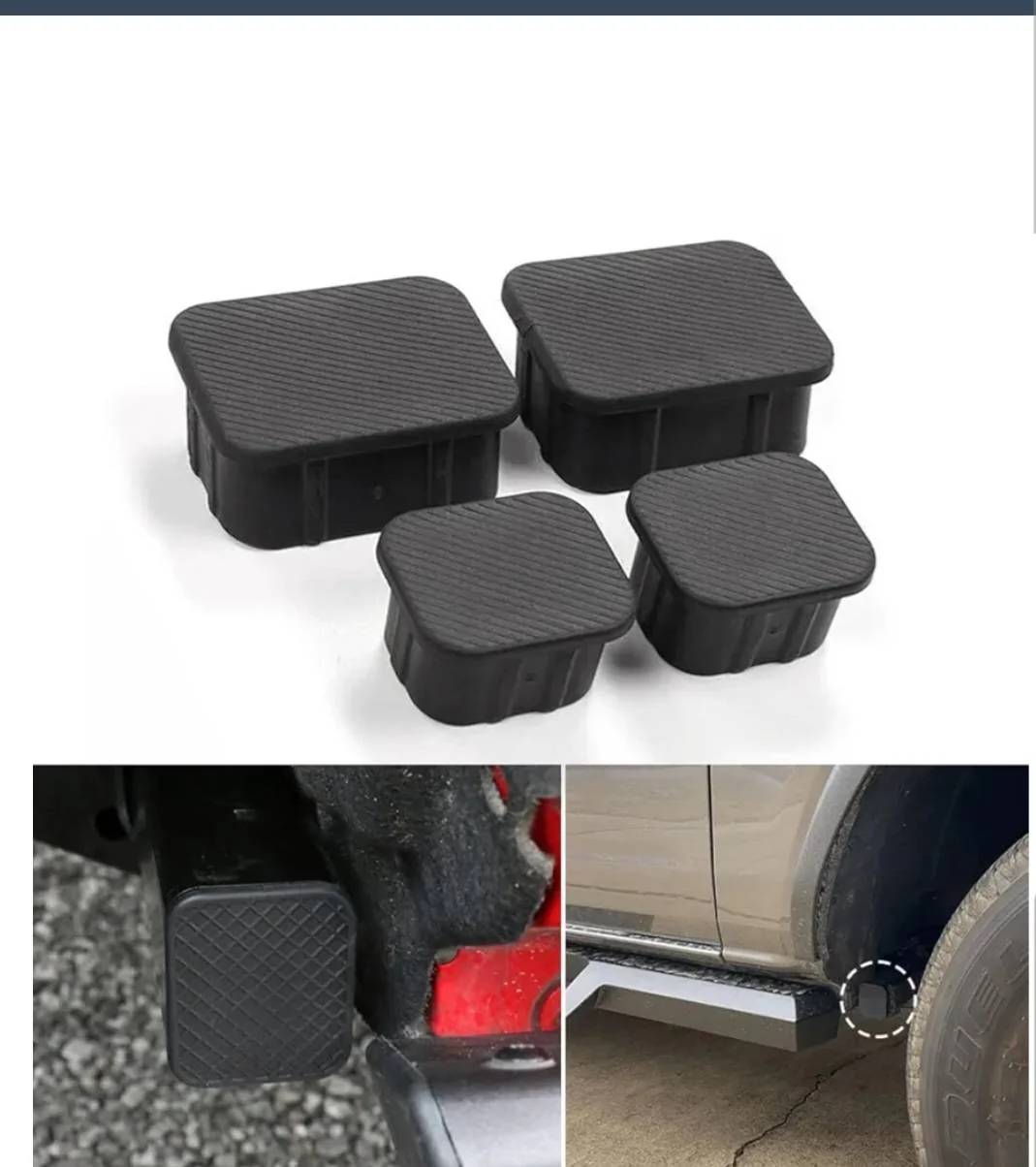

I've purchased two Broncos and never got a checklist.... that would be a nice touch in sales or finance but don't hold your breath. Although both models I purchased didn't have this open bar problem because of my rigs' beafy tire size, this is what you are looking for....
